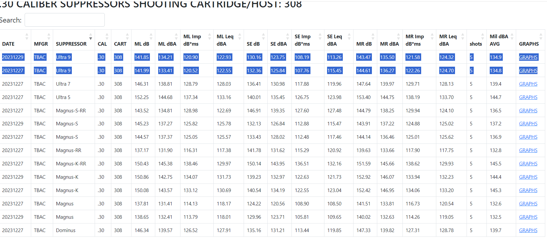

Excellent write up. Brain is still fried trying to read and understand the data but is there a way to sort by DB reduction per OZ then again by price? aka "bang for the buck"? :)
You can download the CSV file, import to excel, and add whatever columns you want.
We had to draw a line of how many more columns we could add to the online tables to keep it at least somewhat manageable.
no worries, I was being sarcastic anyways. Still best write up so far. None of this marketing b.s., just facts and numbers with variables controlled as much as possible.

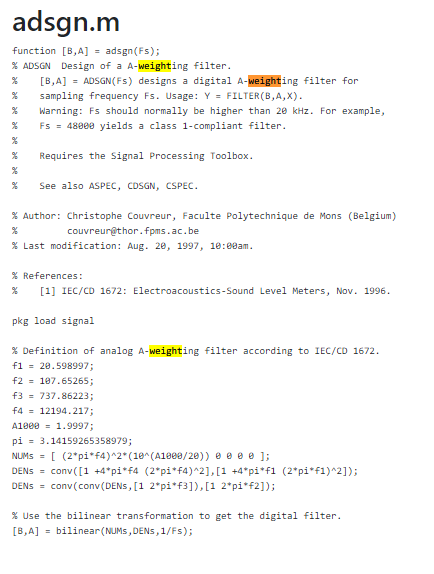

"d. dB vs dBA – In this document, dB is used to refer to unweighted dB. dBA is used to refer to A-weighted dB."
I was struggling to find what the A-weighted actually is too.
This is at the bottom
but its nerd speak for something I dont understand.
More easily
You take a signal, convert it to frequency, then add the value from the a weight curve to each frequency, finally, convert it back to pressure, or whatever, and run your analysis.

Easiest way is to go to "UNIFIED RESULTS" and then put "308" in the search box, then sort on whatever column you want.

I probably missed this somewhere, but Zak can you explain why there are multiple entries for the same suppressor in a given set of data like what I have highlighted?
