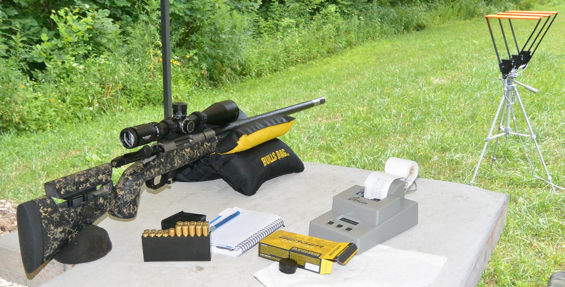

Garmin Xero C1 Chronograph
It’s confession time. I hate my chronograph and basically only take it to the range if I’m developing a new load or specifically need the data for a review or article. The rest of the time, it sits at home. It’s not that the Oehler 35P I use is problematic. For a light based chrono, it is the best from both an accuracy and usability standpoint. It’s just still a huge PITA to lug it to the range, set it up, and align it so that I don’t shoot the thing. A few years back, I thought the magnetospeed might be the answer but after trying a buddies out I gave up that idea. It certainly effected the harmonics when on the barrel, was actually a little fiddly to set up and not shoot itself, and required a lot of effort, aftermarket parts, and a rifle with side rails if you wanted to set it up not on the barrel. I also thought the price was way high both for what it was, and for what it required you to add to it to not mess with your harmonics. So, I basically sat on the sidelines with the already paid for Oehler missing out on data on a whole lot of shots because I almost never used it. This year the Garmin came out and is supposed to be the greatest thing ever. Given how much data I need to take for articles this year I figured I would try out the Garmin and write something about it. Who knows, maybe it will be great enough I will regularly take it to the range and have a bunch more data on my shooting.

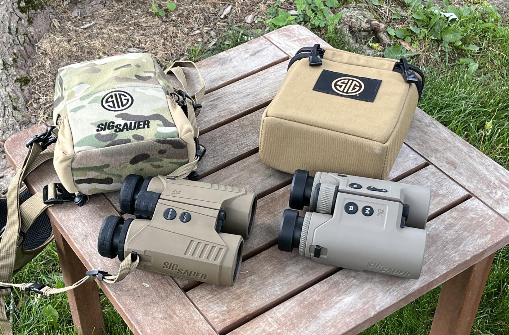

Sig Kilo 10K-ABS HD Gen II laser rangefinding binoculars
It’s been a couple years now since Sig set the new standard for consumer laser rangefinding by releasing their Kilo 10K-ABS HD binoculars. These rangefinding binos at least doubled the effective range that any particular target could be ranged at in any particular conditions with the best 905nm rangefinders of the time. On top of that, in some conditions, or with some targets, the 10k’s far exceeded an effective doubling of range such as with large, highly reflective, targets or with any targets in snow or fog. They did this while still being a class 1 laser product and without using substantially more battery. In fact, given their low energy AMOLED display, they used far less overall energy than most, if not all, competing products. That AMOLED display also offered excellent in-bino menu navigation, full rangefinding and ballistic solutions on one screen, and the ability to precisely align the laser with the reticle (a general issue laser rangefinders have.) The 10k’s also included Applied Ballistics Elite as well as the ability to be used in Sig’s BDX Smart Scope ecosystem which I did a review of at the same time I reviewed the 10k binoculars in 2022.
Sig KILO10k-ABS HD Gen I (left) and Gen II (right) laser rangefinding binoculars
This year Sig has released the second generation of the Kilo 10k’s. The principle changes in this generation are the removal of the noticeable blue tint that users found objectionable in the first generation units and faster access to manual wind entry with direct wind input buttons allowing users to quickly change wind direction and speed. The Weatherflow wind meter included with the first generation 10k has also been removed from the Gen II unit. I expect this may have a lot to do with the upcoming Applied Ballistics Eite ultrasonic wind meter integration at that will be a substantially better wind metering solution than prop type wind meters were and it is my understanding it will be supported on all AB elite devices.

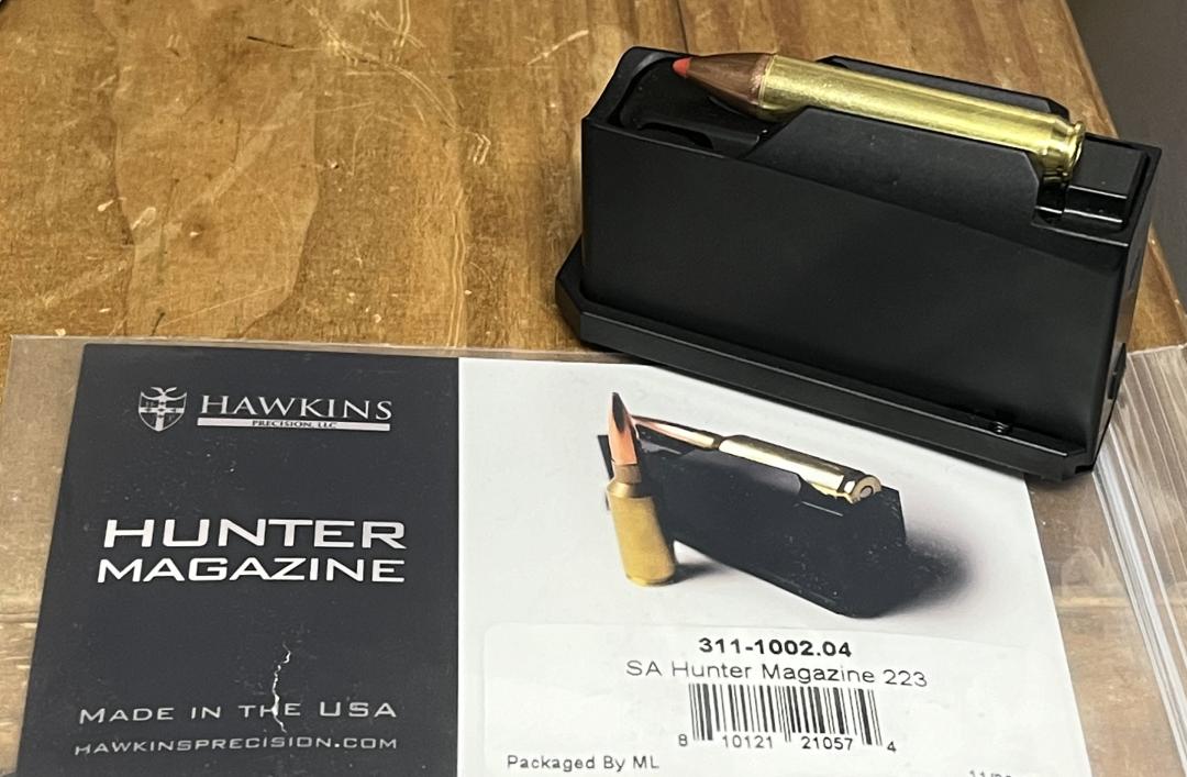

On the review front, pieces continue to trickle in for the 350L build. The Hawkins hunter flush mount .223 / 350L mag that fits with their Hunter DBM came in a couple days ago. For those who didn’t catch it in my Shotshow 2023 coverage, this is an M5 inlet AICS bottom metal that is flush with the bottom of the stock instead of having the extended mag well now common in AICS bottom metals. The magazine is designed to work in conjunction with that flush fit bottom metal and likewise fits close to flush with the stock providing the clean look of an internal magazine with the convenience of a DBM. The magazines are machined from solid bar stock, are double stack / single feed, and hold 5x .223 rounds or 4x 350L rounds.

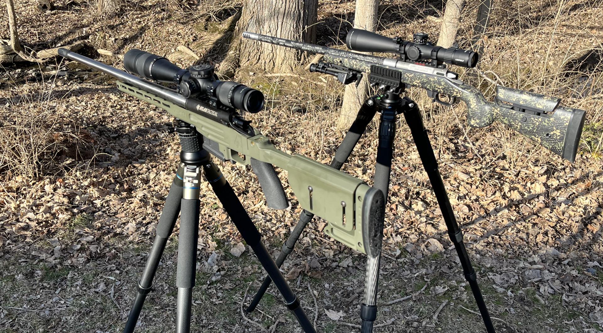

In other news, a couple of Field Optics Research tripods I purchased arrived a couple days ago. I don’t think I had mentioned this yet but I actually spend a good bit of time at ShotShow last year looking at shooting tripods. The concept of shooting long range off of a tripod has absolutely caught fire in the last few years and I was thinking of doing a series of reviews surrounding this. I changed my mind partially because I had a whole bunch of other stuff in the que, partially because I don’t think I really have enough knowledge and experience on the topic to be the guy who does those reviews, and partially because of the products themselves. The products were a difficult mix of price, features, and a great deal of blatant intellectual property theft (not this brand on that count BTW), to combine into a cogent series. I still picked out a few things I wanted though and bought them when I got around to it. After I get some experience shooting with the Field Optics Research stuff I will write something up on it. For now they made a very nice stand for some photos I needed to take for the bubble level article. The tripods I have are the Hunter 32DT ASFPL and PRO39-MIL ASFPL and I also have some FM-570 GunPOD gun vices and should have an FM-300F gunvice coming as well.
Field Optics Research PRO39-MIL ASFPL tripod system with a friends Kelbly Atlas rifle and Hunter 32DT ASFPL system with my PurePrecision crux.

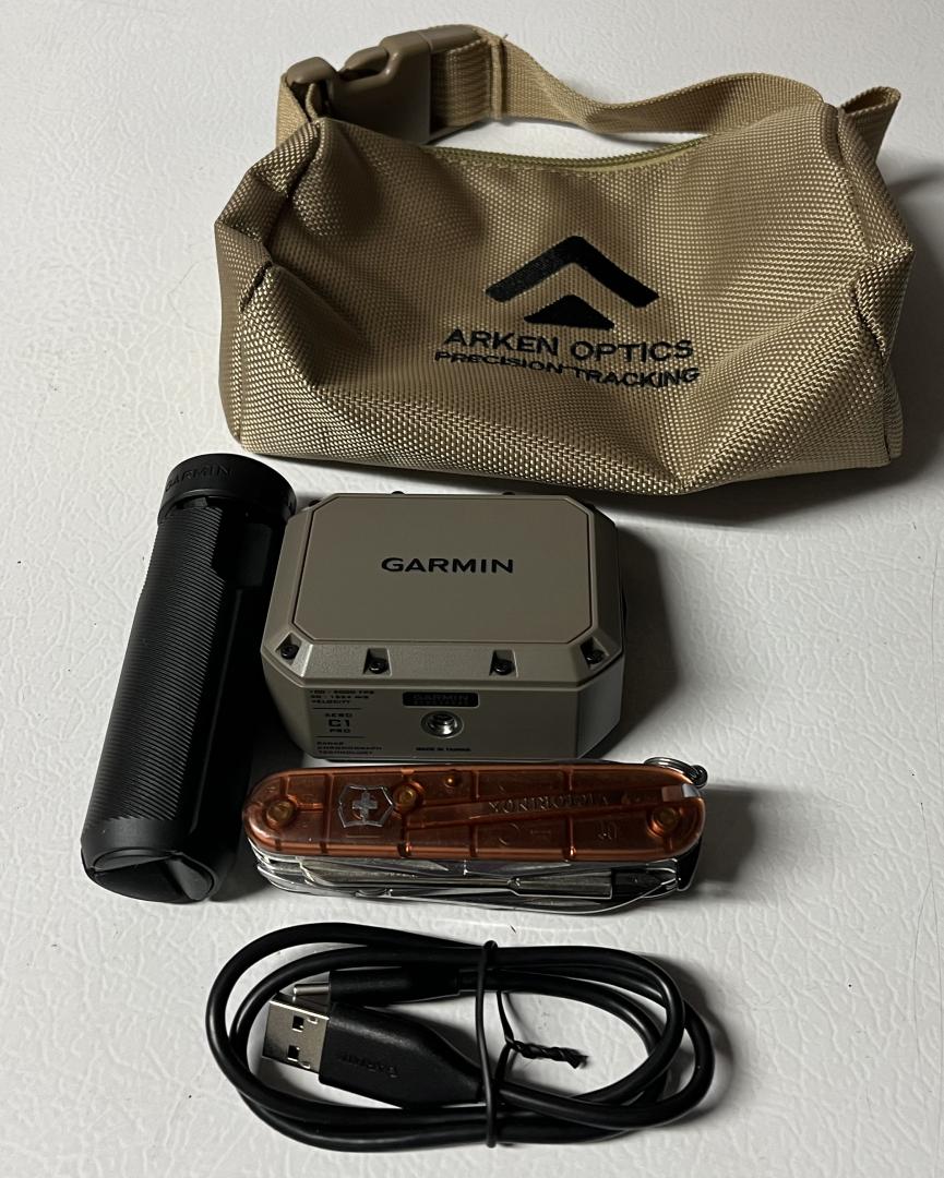

Despite the initial 6 week shipping estimate when I ordered it, the Garmin Xero C1 chrono arrived last week. I guess I haven’t even mentioned it yet. There are a few products that I will be reviewing that I haven’t put in this thread. This Garmin is one of them and there is another big one that I’ll be able to talk about next week. That one is under NDA whereas I just hadn’t gotten around to mentioning the Garmin. Anyhow, man is it small and light. I took a pic of it next to a swiss army knife to try to put it in context. It’s not like I hadn’t seen pics of if but somehow they did not convey the size accurately to me. It’s absolutely tiny. Given the cost, I’m a bit disappointed in the complete lack of the inclusion of any case. I guess I found a use of the little ditty bag Arken includes in their accessory set with the rings and bubble level. Still, the chrono is $600 guys, you can’t put it in a nice case? I’m pretty sure there would be plenty of profit left.
Garmin Xero C1 Chronograph with a swiss army knife for scale

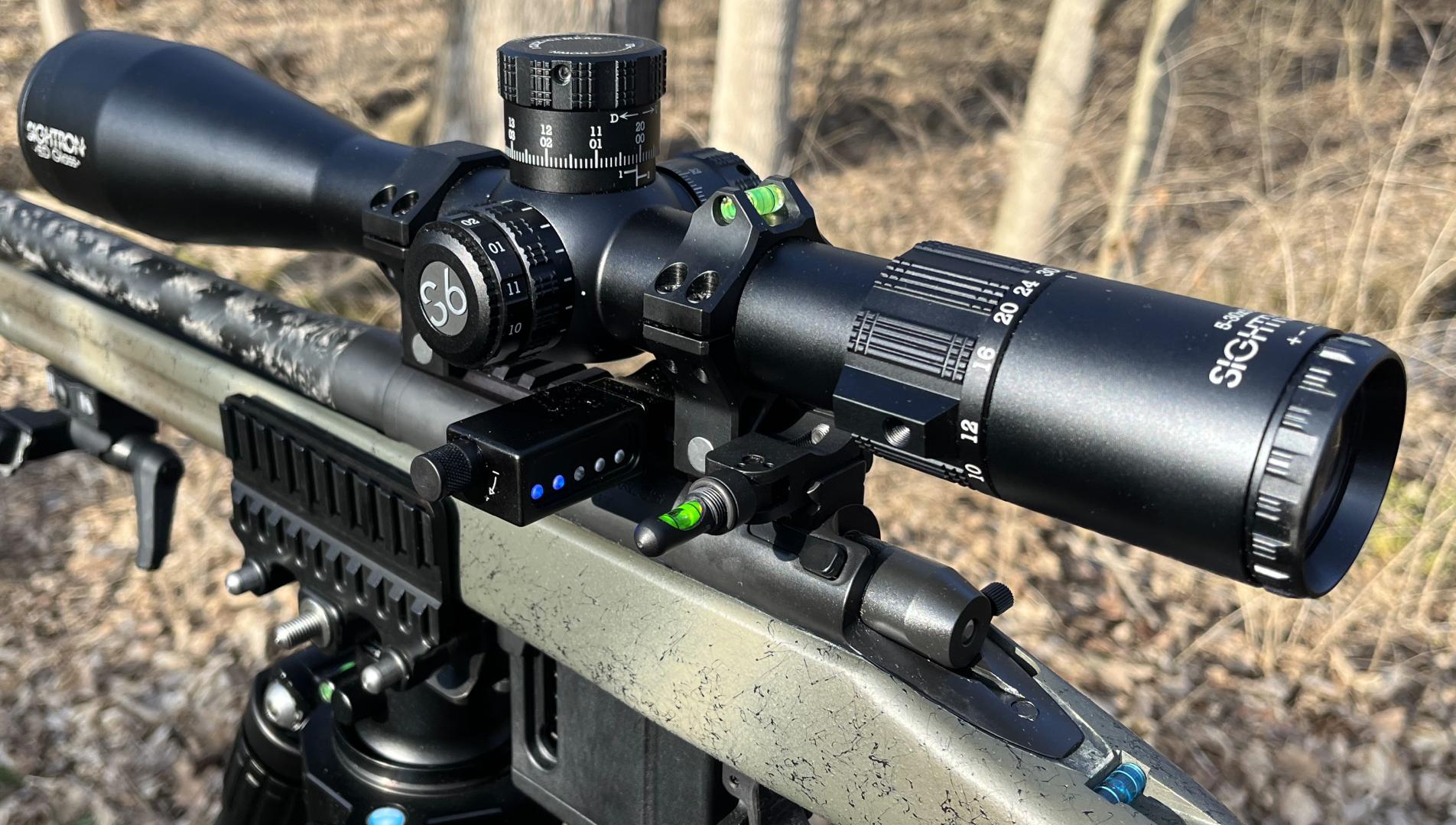

Lastly, the article on levels is done being written. I should have it proofread and up in week or so.
Update 2-28-2024
The article on level use in precision rifle is now live. This sort of ended up being three articles that I have divided them up as such into three clearly delineated “parts.” I went back and forth about actually dividing it into three articles but ended up thinking this middle ground with the big, obvious, divisions was better than making three articles that felt a little incomplete on their own. Anyhow, the first part has a lot of numbers on level use and a good deal of general information. The second part is about scope mounting with a level and the third is some discussion of different level types and mini-reviews of some level products. I do expect to add a few more images and diagrams to this article over time but I didn’t want to hold it up any longer for that since it may be a few weeks before I get out to the range again to do those photos.
The leveliest rifle ever lol

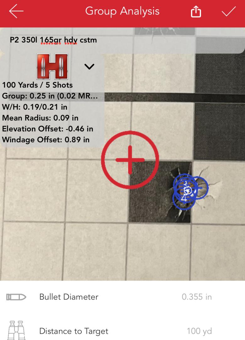

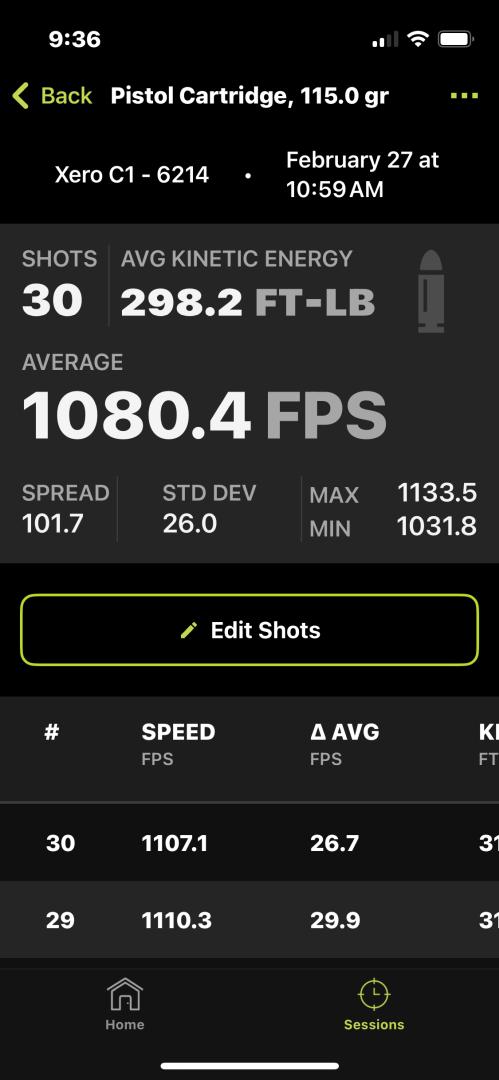

On a different subject, I took the Garmin Chrono to the range yesterday and mistreated it. Basically, I stood it up on the little table plank thing indoor ranges have in the lanes with the Garmin much further from the bore line than it is supposed to be and then gave it just 21ft to pick up the shot on top of that. In short, I set it up how it was easiest to set up instead of what the directions said to do and then just expected it to work. Than, to my surprise, it actually did. I think it only dropped two 9mm shots and a handful of fairly rapid fire .22lr shots the whole range session. This was easily a better than 90% shot pick up rate despite my complete disregard for the instructions. I felt that was pretty amazing. I have some work to figure out the Garmin ShotView app use though. My data showed up on the phone but I failed to figure out how to control the device with the phone. Anyhow, here is a random phone screenshot from the day and a group I shot with my buddies new P365. The group isn’t germane to anything but I want to brag about it. That is a damn good group at 21ft. I am not the best handgun marksman so it’s surely not about to happen again.
9mm shot string in the Garmin ShotView app.

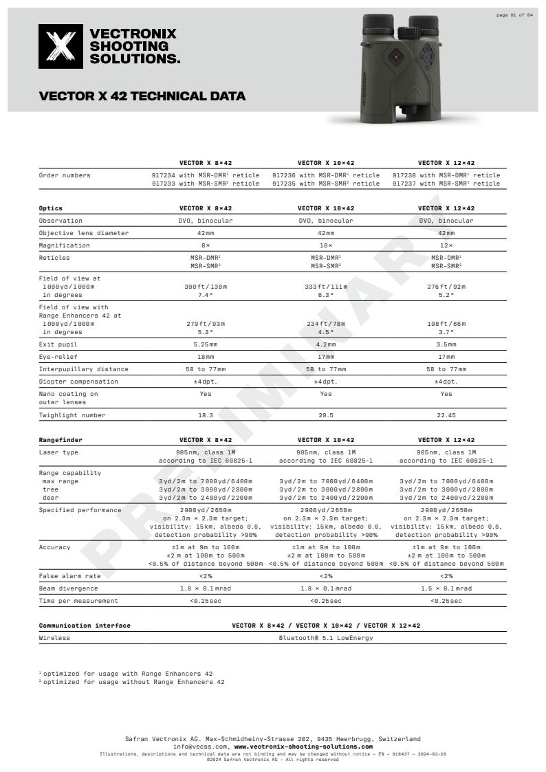

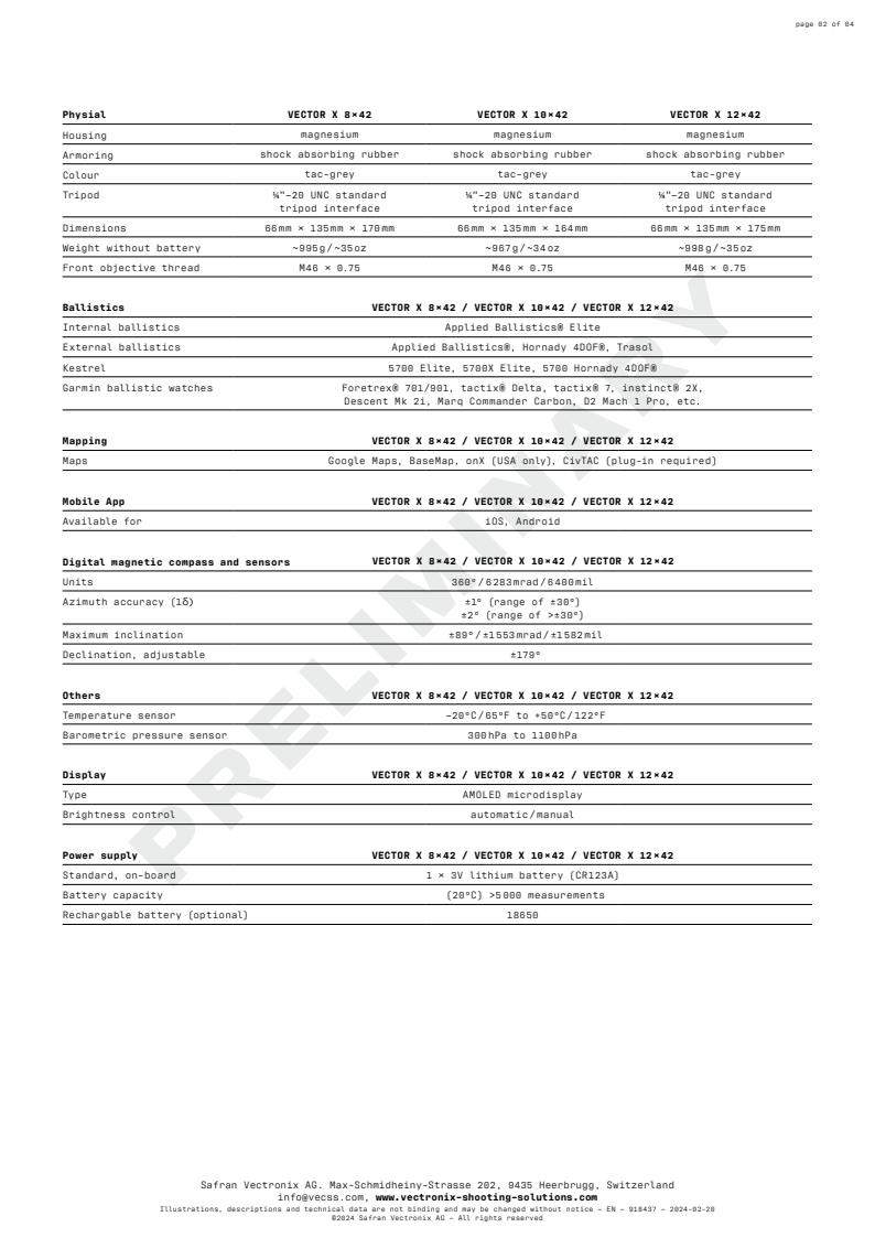

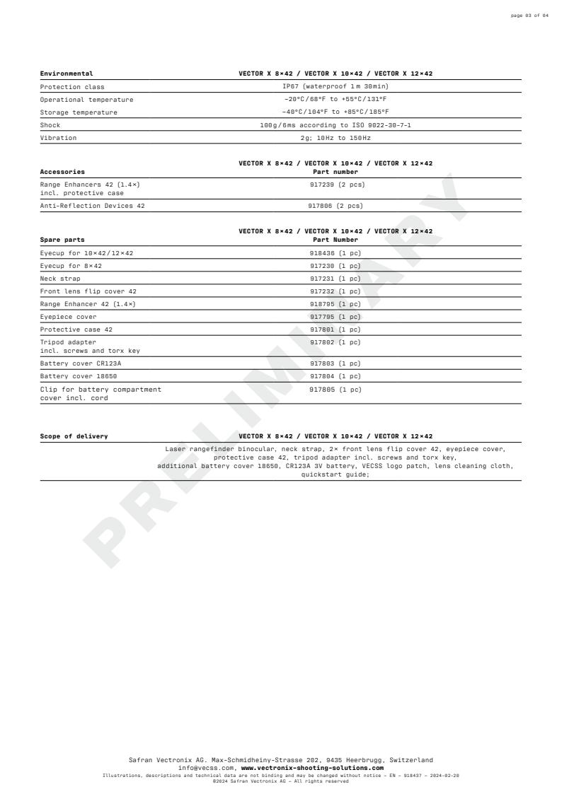

Vector X preliminary specification sheets:
Link to the big SnipersHide thread on the Vector X which will probably be pages long in no time.

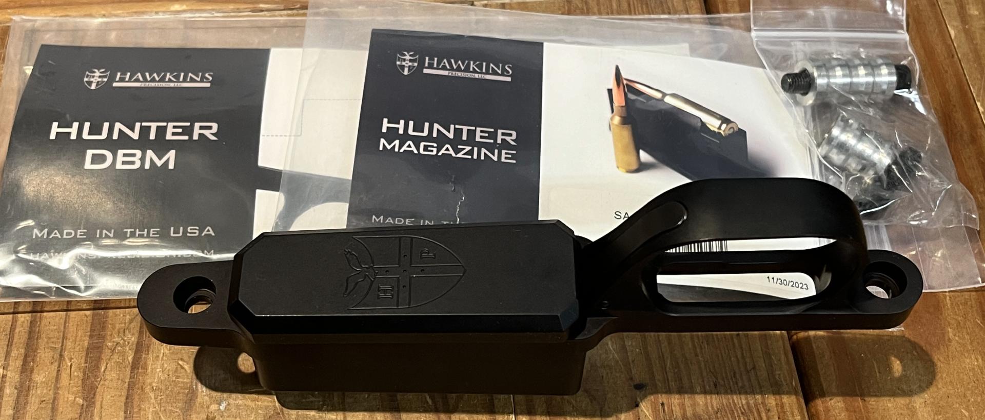

Update 3-21-2024
The Hawkins hunter bottom metal came for the 350L build. As I expected the machining is excellent and it looks great with their flush fit magazine. It’s off to the PurePrecison guys for the final assembly and testing now. Shouldn’t be long.

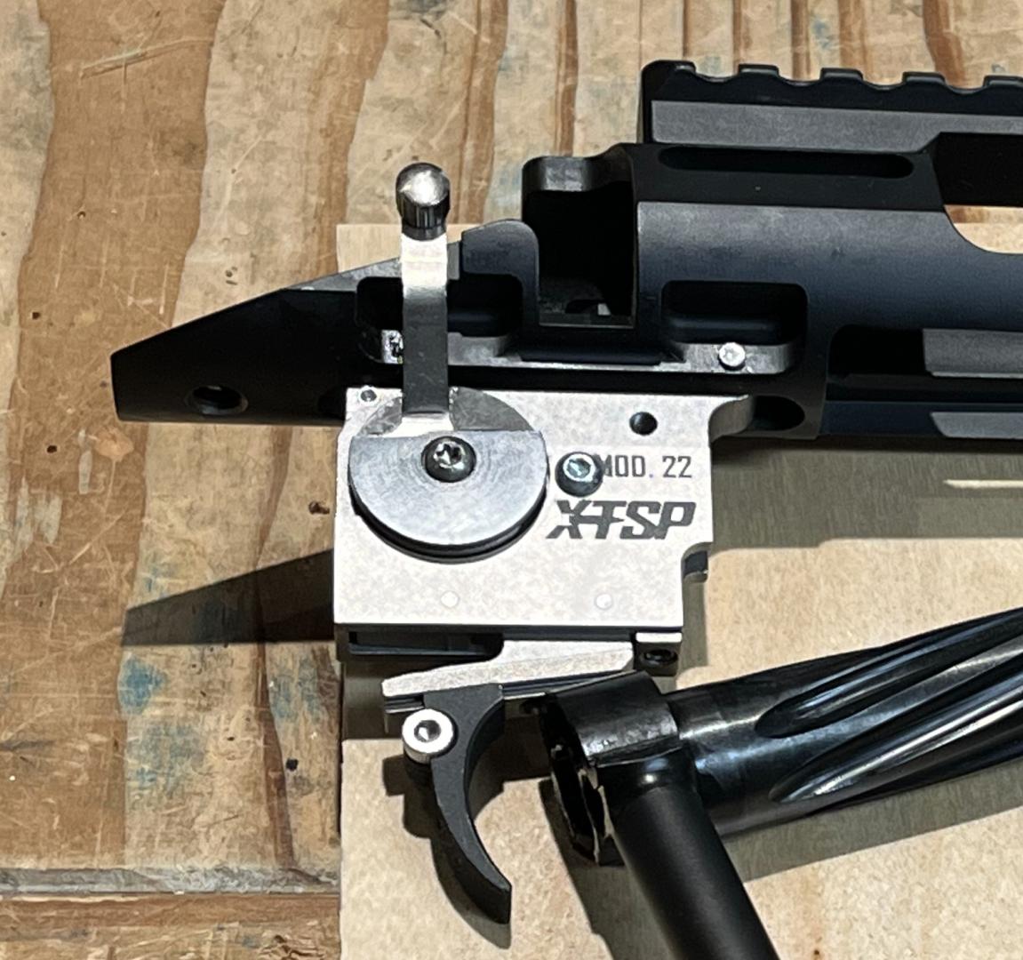

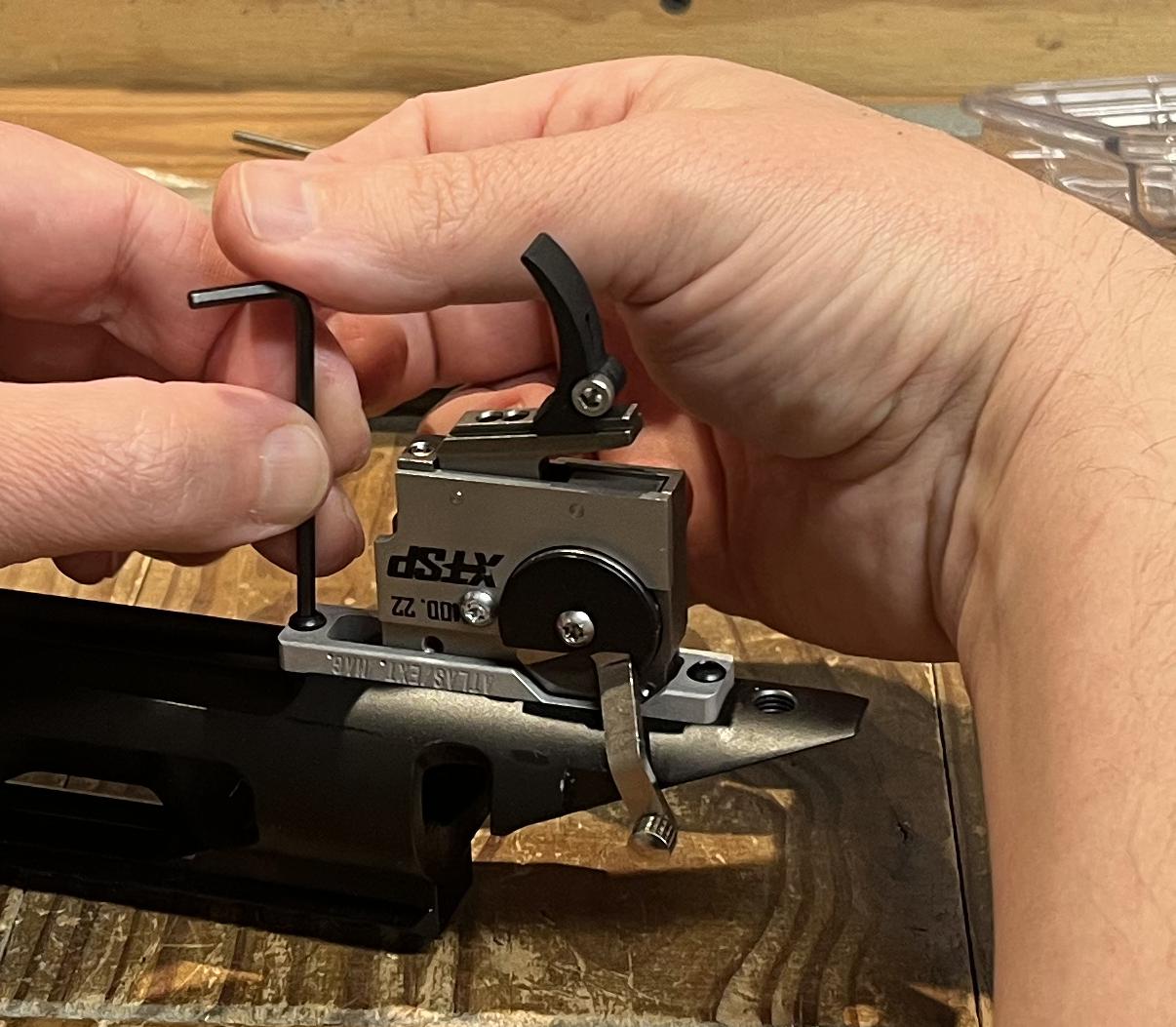

The XTSP MOD 22 trigger arrived this week and I have been running it through the “lab” type tests for break weight consistency, min pull weight, and such in the Kelbly Atlas Tactical action before the PurePrecision 350 Legend rifle it will eventually go in arrives. This is for consistency as the TriggerTech and Bix n’ Andy triggers were also tested in this action and with this gauge. It is also pretty easy to do the testing in this action as Kelbly actions use a trigger hanger so you aren’t having to pound away at the receiver pins to swap out a trigger for testing.
Mounting the XTSP MOD 22 trigger in the Kelbly Atlas Tactical action for testing.

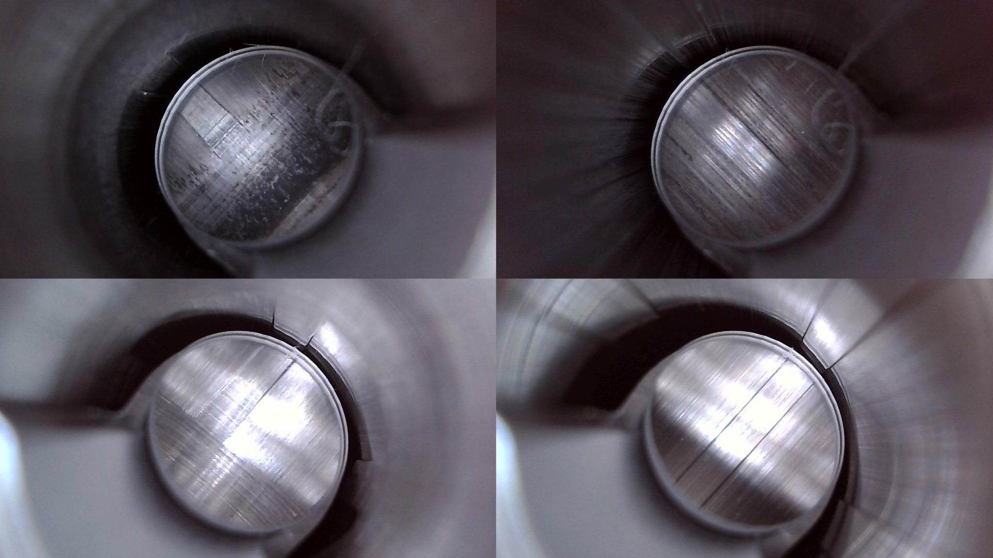

On another project, I finally broke down and spent the $55 for one of the Teslong bore scope. It might be the best $50 I ever spent on shooting stuff. I have learned so much so quickly. Turns out, I was spending too much time cleaning my Vudoo .22lr. That thing is clean as a whistle after only about 3 patch and brush cycles. No need to continue. The rifle was pretty dirty too. It had a least 500rds since it’s last cleaning before I scoped it for the pics.
Before and after cleaning my ~500rds dirty Vudoo .22lr. Shown is the throat and early in the lands.
On center fire I also learned a good bit about carbon rings, hard carbon, copper fouling, and what it takes to deal with each. I am no expert here but I think I had some things wrong and further, that most advice might even be more wrong. Anyhow, it’s the borescope era people. Drop your $55 bucks and get one already. Be happy, it is about the cheapest tool in all of precision shooting.

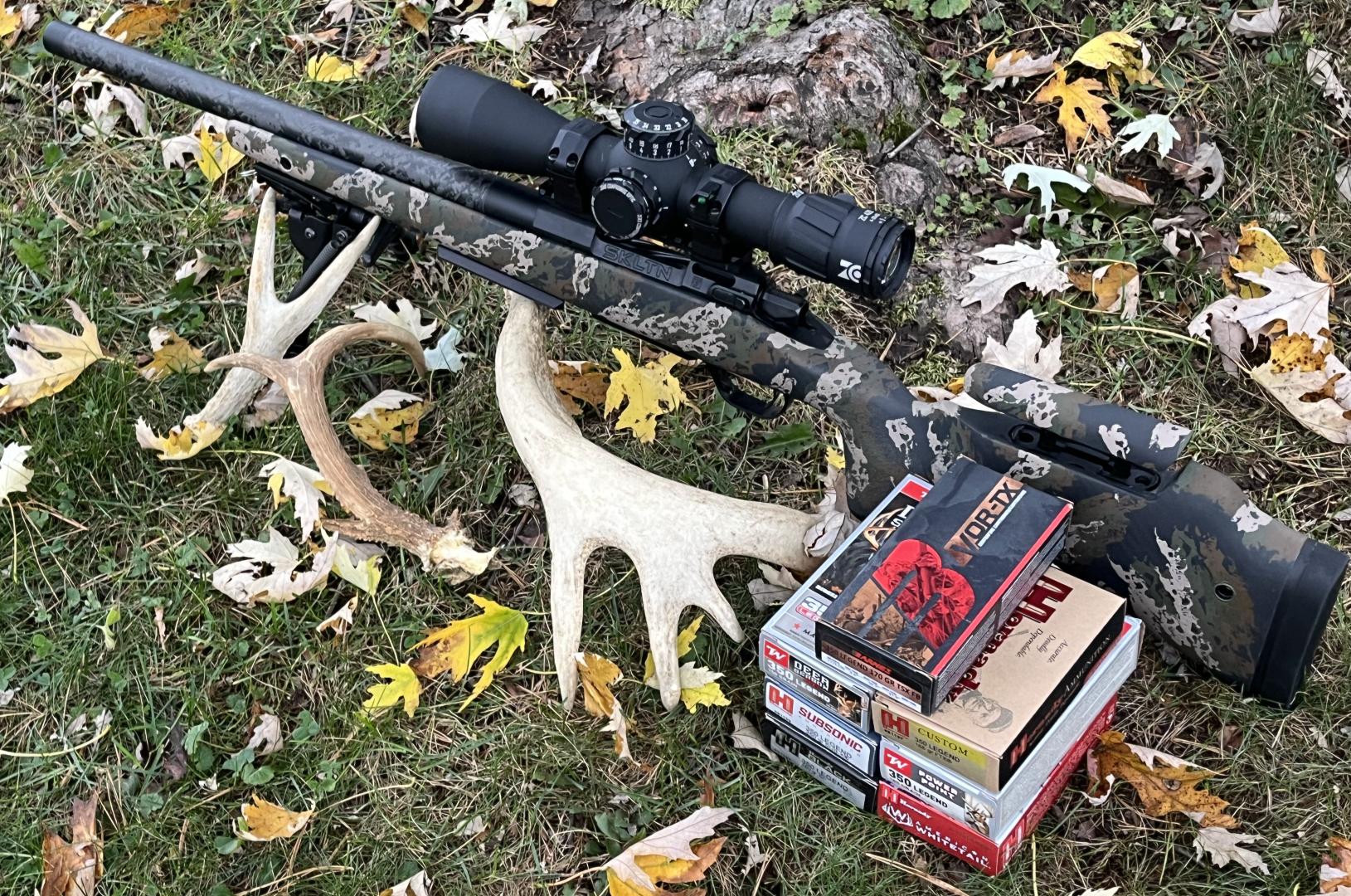

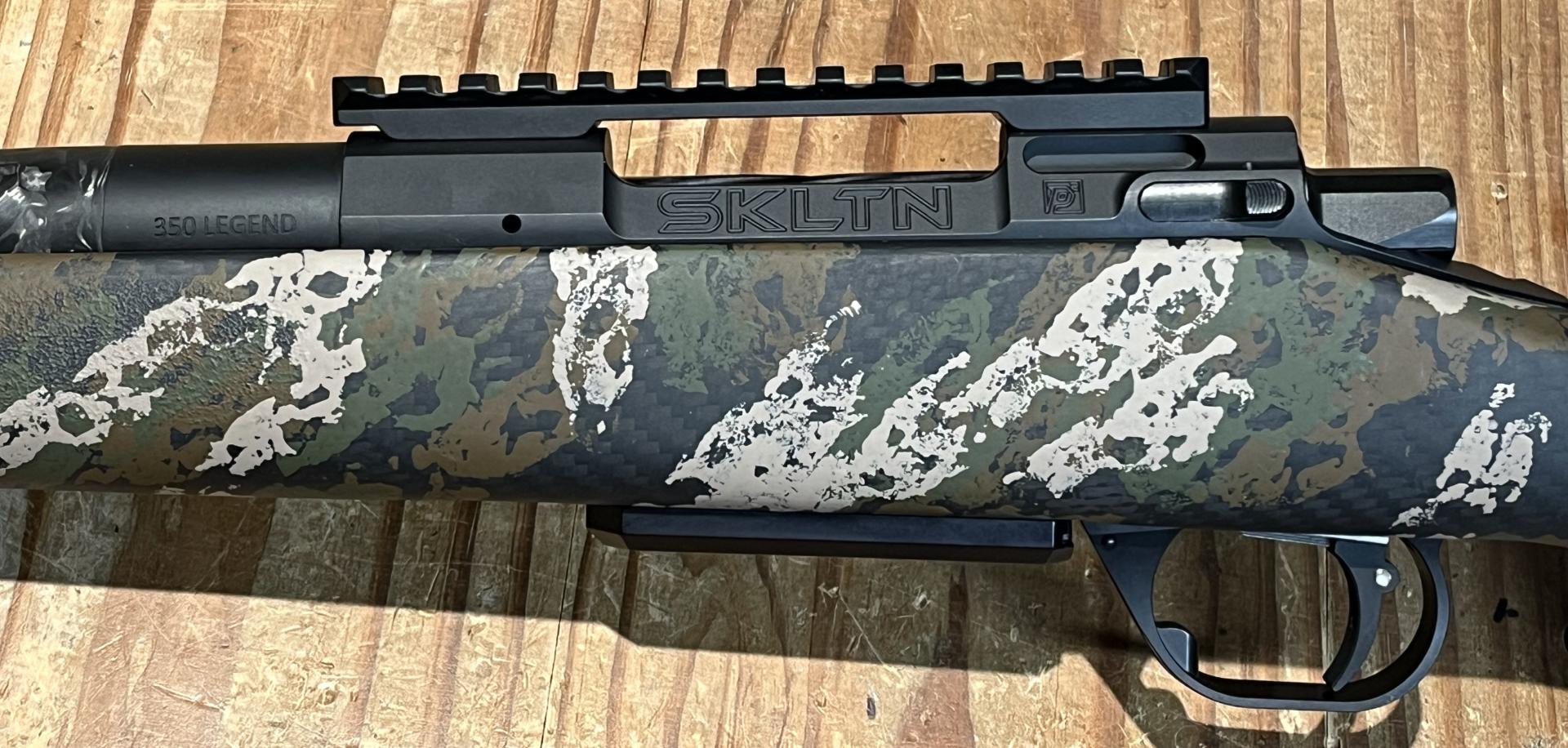

Guess what’s here…. It’s the PurePrecison SKLTN in 350 Legend. I spent some time this evening fitting the XTSP trigger into it. Tomorrow I’ll break out the bore scope and take a look down the tube as well as try to get some nicer photos with some natural light. Sure looks good in person though. The Matte look of the PurePrecision Altitude stock and the flush mount Hawkins Hunter mag really come together well. I have a range trip coming up next week and I’m excited to see what a straight-wall hunting cartridge can do.
PurePrecision SKLTN 350 Legend AICS DBM Straight-Wall Hunting Rifle

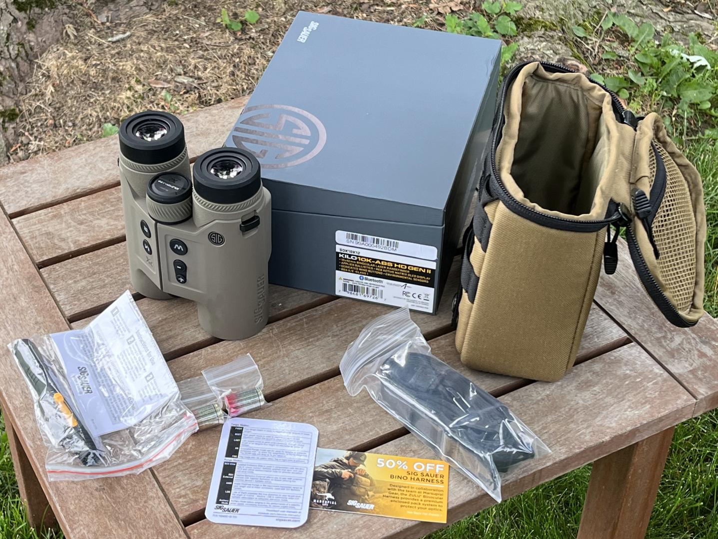

Well, that was quick. The Sig KILO10K-ABS HD Gen II binos arrived yesterday. I didn’t have a lot of time today to do any rigorous testing but I can say that the blue tint present in the first generation units is absolutely gone from these. I’m interested to see how that effects the overall optical performance as well as how the three new buttons that facilitate real time user wind inputs alter the overall experience. It has also been a while since I updated or used Sig’s software as I haven’t needed any new profiles for a bit and the 10k’s in bino profile storage and menu system is so good that I haven’t needed to interface with the app in probably a year. I’ll be interested to see what changes have been made in the interim.
SIG KILO10K-ABS HD GEN II Laser Rangefinding Binoculars Unboxing

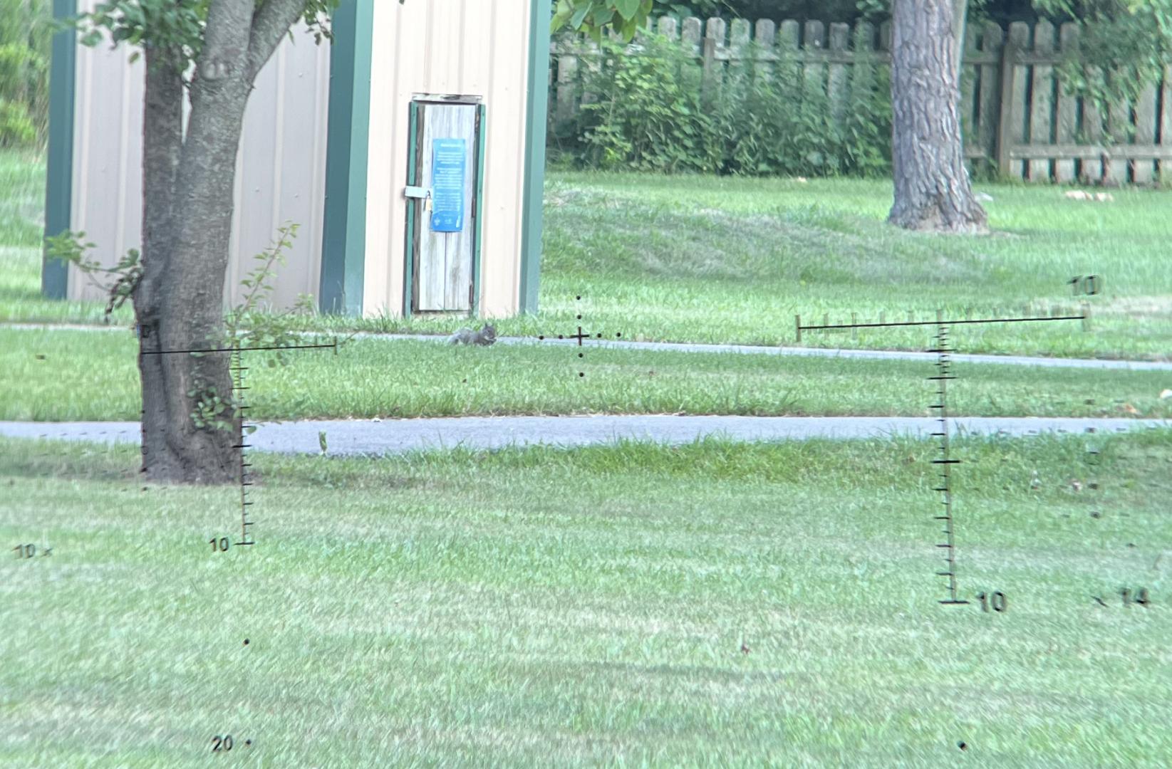

A squirrel @133 yds through the 10x42 Vectronix Vector X binos with range enhancers attached. This photo is a little more blue in tint than any real world image will appear to your eye.
Speaking of that reticle, it is nice and sharp and I’m very excited to try these out in the role of spotting scope replacement with the 1.4x magnification range enhancers. Usually, I go with 8x over 10x on my binos as I prefer more field of view and steadier image over more magnification. I went with 10x on these though as I think it's the best compromise between tripod use as a spotting scope replacement with range enhancers and hand held use without the range enhancers. Those range enhancers have impressed me so far as well. I’m not seeing a massive fall off in optical performance with them strapped on for the extra magnification. I need to contrive a few tests to refine my thoughts but so far the concept seems like a next level feature especially when coupled with the rock solid integrated tripod mounting point directly on the barrel of the bino. This is a big win over the various bridge type devices I have encountered for attaching binos to tripods. In the past I have been more inclined to drop a shooting bag on the tripod and use that to steady the binos than to use any mount but this mount system is an upgrade. It is small, rock solid and the binos still fit in the case with it attached. As all my Field Optics Research tripods have arca clamps on top of them and leveling features built in, I went with the Area 419 plate. The RRS plate is similar but with an added leveling feature I didn’t really need. Both of these are aftermarket add ons. A tripod adapter is also included with the bino that fits a ¼” stud instead of an arca rail. All three of these adapters screw onto the same mounting point on the binos so, you have a lot of choices when it comes to what to go with.

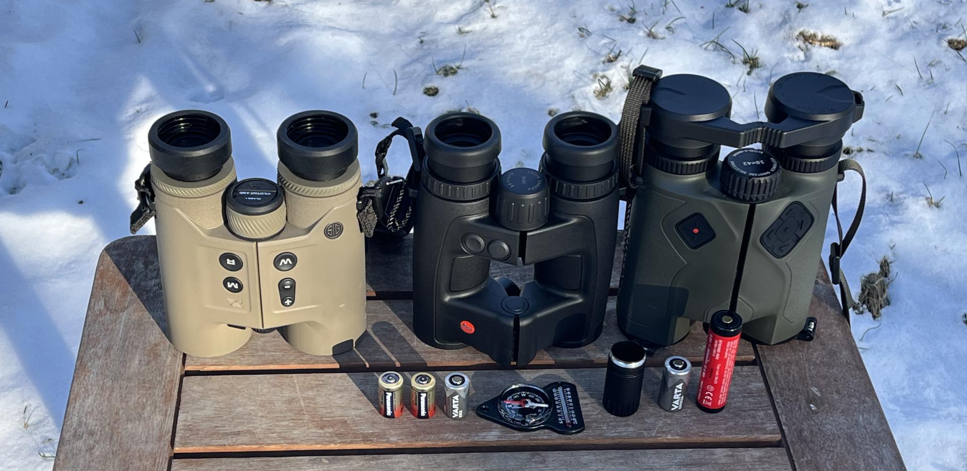

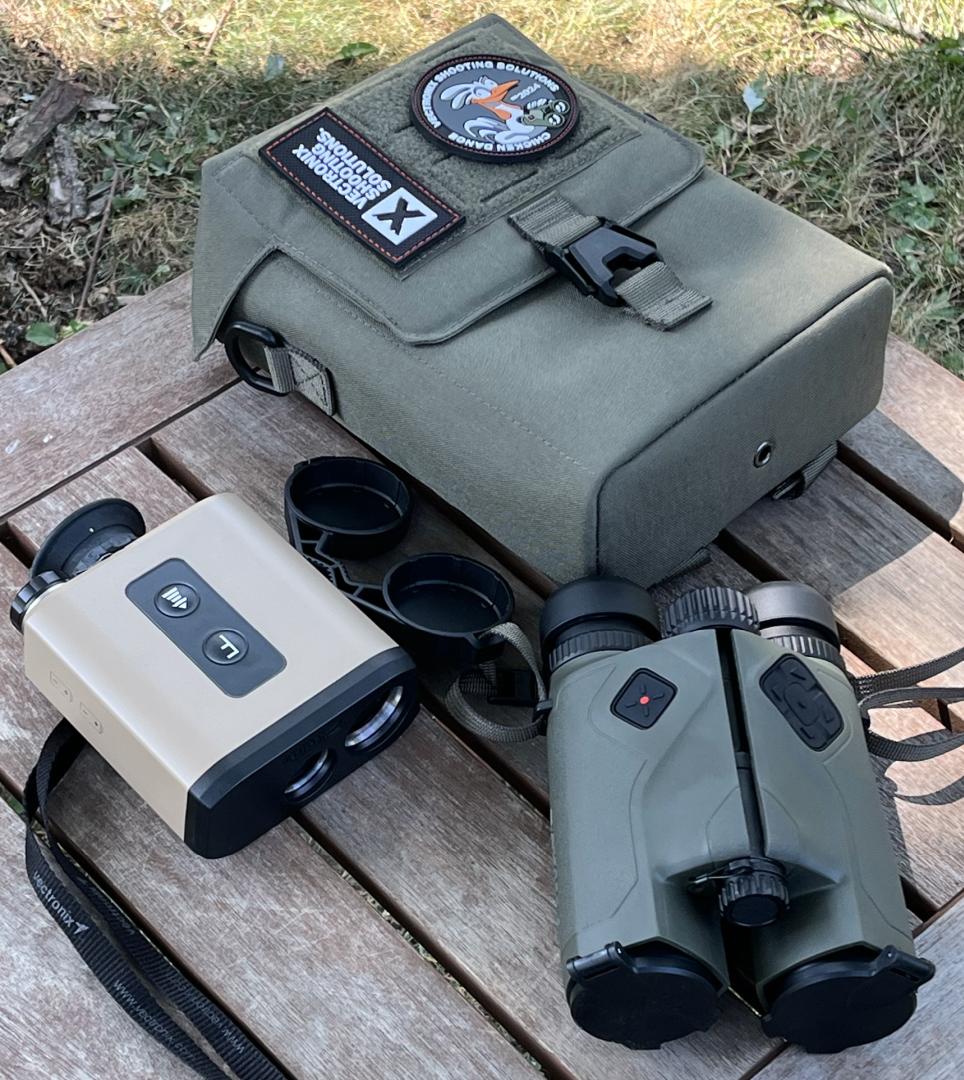

Looking through the Vectronix Vector X’s as well as the Gen 2 Sig 10k’s on my Field Optics Research tripods.
Those are my thoughts for now. I expect I’ll dip into the software next as well as get to know the menu systems. I’ll probably have to do that chicken dance then and earn the patch.

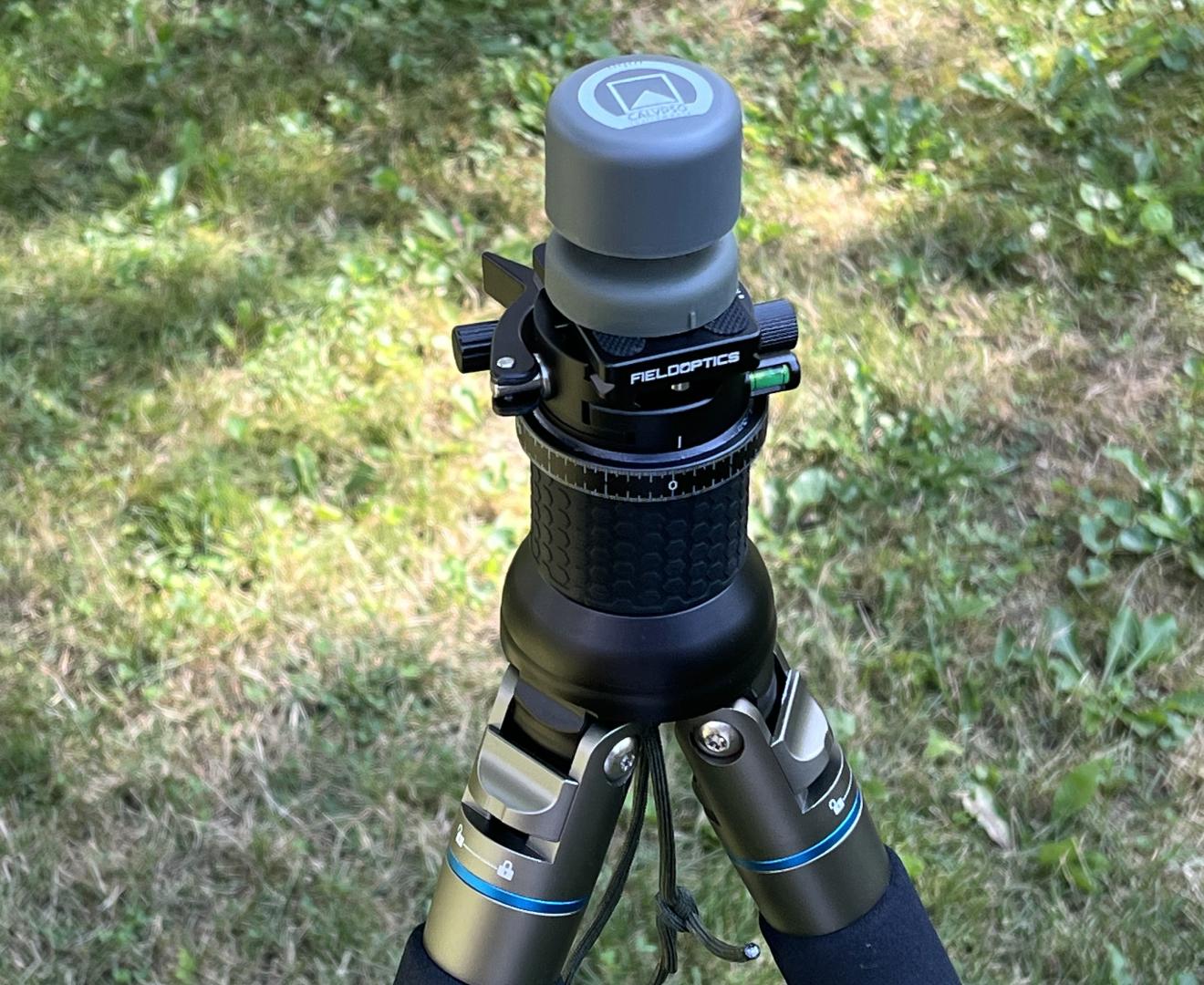

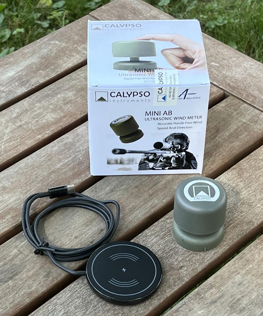

Look what showed up yesterday….
Calypso Mini AB Applied Ballistics integrated ultrasonic wind meter.
I have been talking for a couple of years now about upcoming support for ultrasonic wind meters in the Applied Ballistics ecosystem. Some of you will no doubt remember the EDS podcast Frank and I did early last year about range finders that touched on future wind meter developments or the prototype of the AB Calypso from ShotShow two years ago. We must be close now as I was able to get a hold of a Calypso AB pre-production sample to utilize in conjunction with the Vector X bino review. These are not yet up for sale but judging from the packaging, we must not be far off. It should not be surprising that the timing between these two products is closely aligned, as Vectronix was one of the partners involved in pushing for this integration in the AB ecosystem. Anyhow, I’ll talk a look in the next couple of days to see how the meter integrates with the AB software, whose apps are currently ready for it, and the release details on when the mini AB will be available and if this special version is the only version you can integrate with AB.
Calypso Mini AB mounted up on the tripod

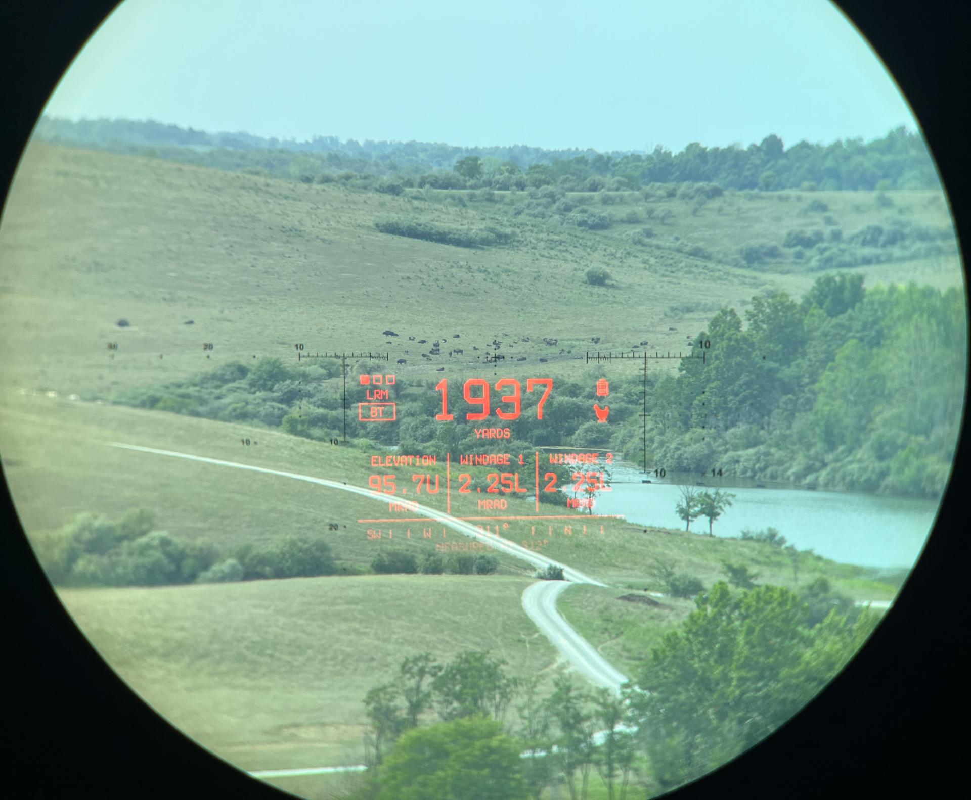

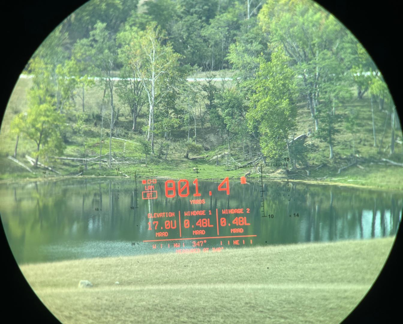

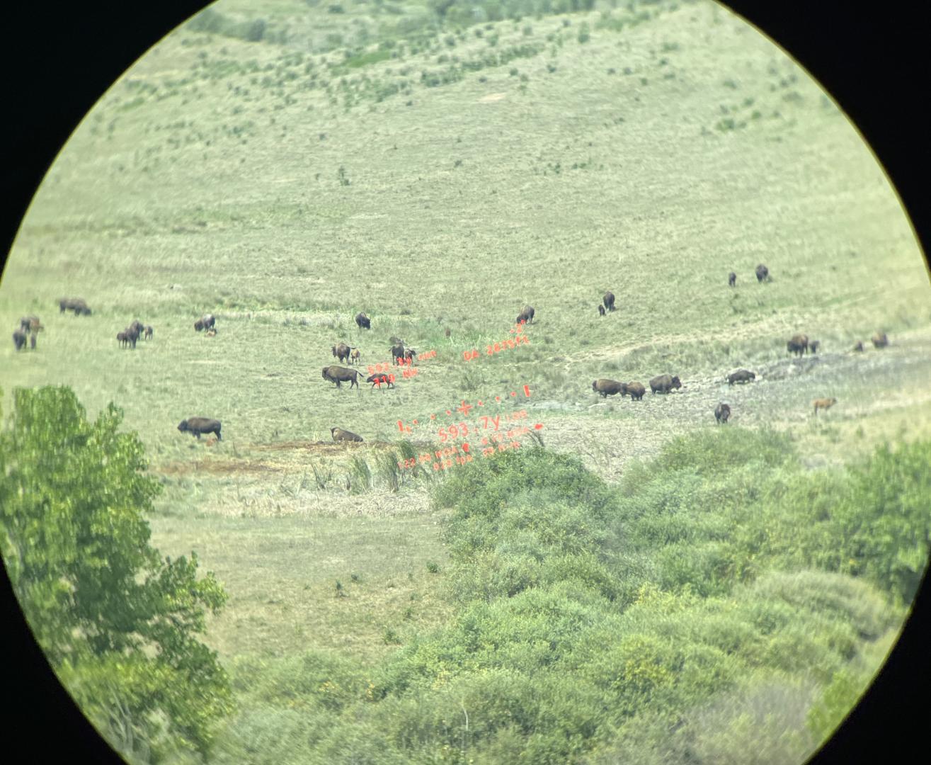

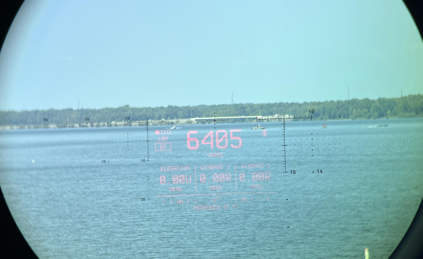

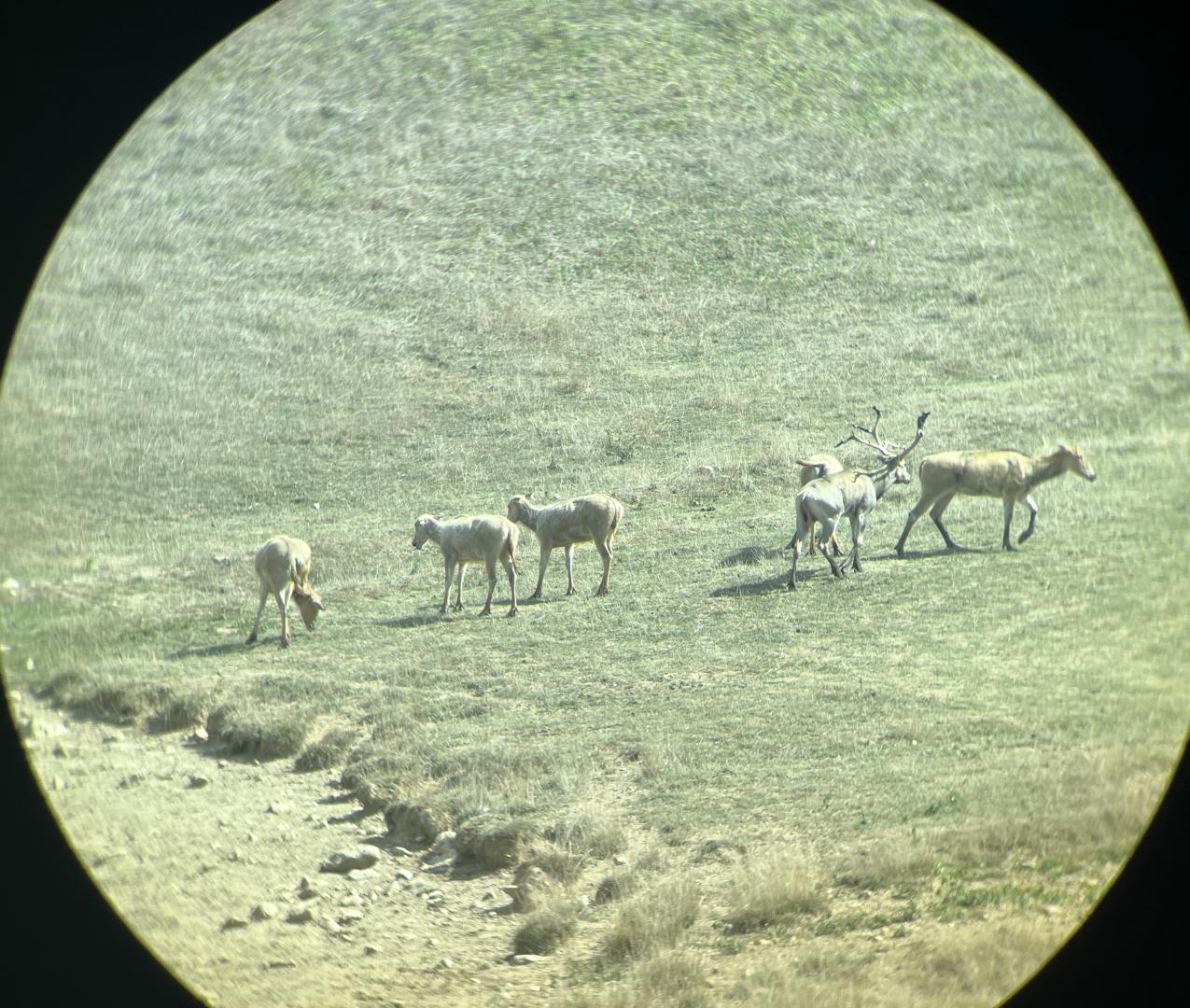

No update on the Calypso software yet but I have been playing with the Vector X some more both at the range and in the backyard and have a few observations.
First off, I took it to the range and used it as a spotter in conjunction with the screw on range extenders. In this configuration, the 10x set that I am using are 14x. The resolution, magnification, and etched reticle were quite sufficient to be used as a spotting scope. Acting as a spotting scope for zeroing will by no means be the strength of these binos. I expect most will be far more interested in spotting misses and trace at distance. I think it is still important to note that the binos did function in this role though and hunters using low power scopes can use these binos to zero their rifle at 100 without having to walk out to the target to check the impacts.
Also, take note that unlike some of the other previous through the lens photos, this one doesn't appear to have a blue tint. Go figure, it was a super bright sunny day just like the previous squirrel photo and both were south facing. Anyhow, it is looking like usually the user won't notice a tint but in some conditions it becomes more apparent and sometimes a camera makes it even more apparent.

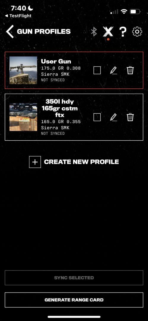

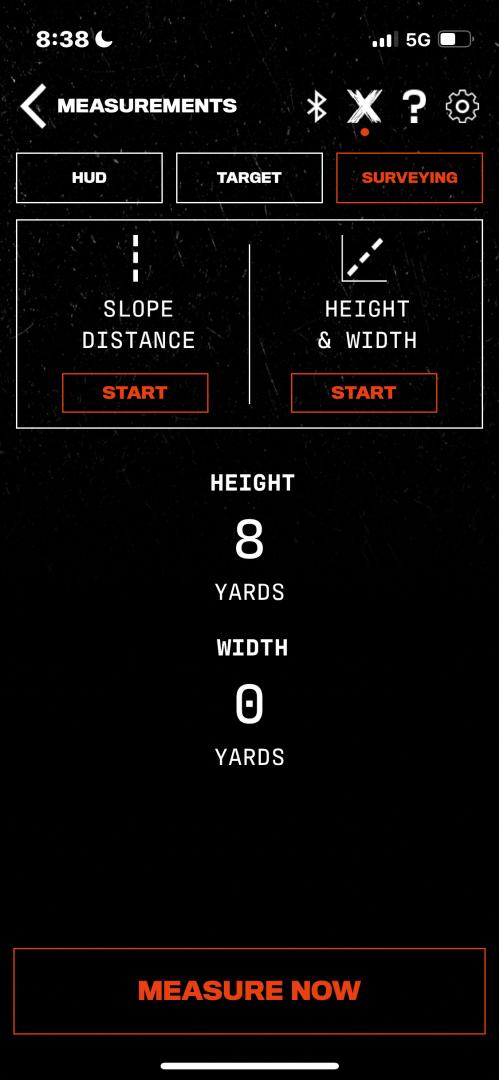

Now some stuff about the software. As I have mentioned before, Nicks crew at AB writes the software for the AB powered devices such as these Vectronix Vector X binos but the GUI on that software can vary significantly from one maker to another. So far I have liked the Vectronix flavor both in terms of the intuitiveness of it's layout and some of it's unique features. Note that this software is beta so there may be some changes and a few of the features might be coming online leading up to the release (for instance, the built in GPS drop point feature that is in the app and hooks to google maps for sat data was not yet working last week but seems to work today) I’ll post a pic of this at some point when that data would not include a satellite image of my back yard ;) Anyhow, here are a few of the highlights.
1) The ballistic profiles screen lets you load in screen shots for a profile. I know there is not a lot of function to this but I really enjoyed the feature and it looks real nice. BTW, you can E-mail yourself one of the range cards to print out and put in the clear pouch of your rangefinder case as a backup. Others also do this but it's still worth a mention.
2) A survey function exists for calculation dimensions of buildings and such by ranging different points. This was certainly fun to play with. It will be interesting to see how accurate it is as it utilizes the binos internal compass and inclinometer and neither of those instruments has to be tremendously accurate for ballistic purposes.

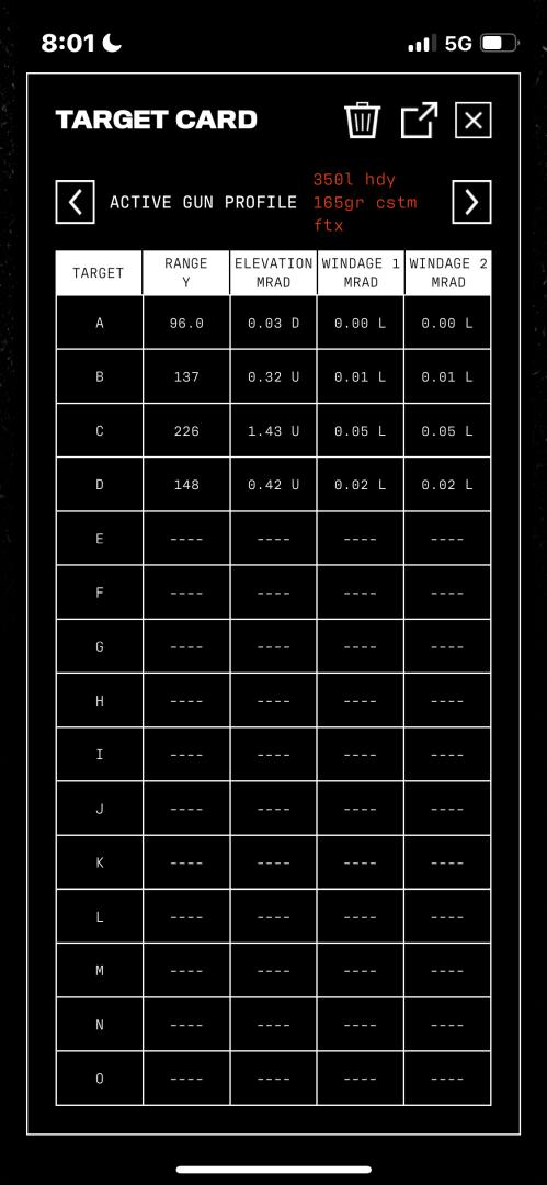

3) The target card feature in the Vectronix software struck me as a particularly good implementation with intuitive population of the ranges using the rangefinder. I will be interested to see if its windage values update in real time with the Calypso connected and if those updates take into account the different directions to the different targets and how the wind interacts with that.

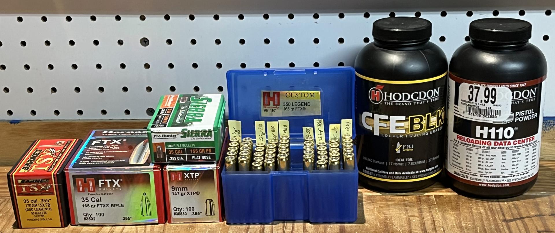

The last couple weeks have been pretty busy. I loaded up and tested 8 different bullet / powder combinations including both the most often recommended powder for 350L, H110, and CFEBLK which, is on the far slow burning edge of powders for which load data exists for the 350L. For a second powder to try, I probably should have gone with LilGun instead as it is the second most recommended powder but I was looking to shake things up. It wasn’t my most brilliant idea and has proven unsuitable for many applicable bullets. It also smells terrible just to make sure I remember that idea stunk.

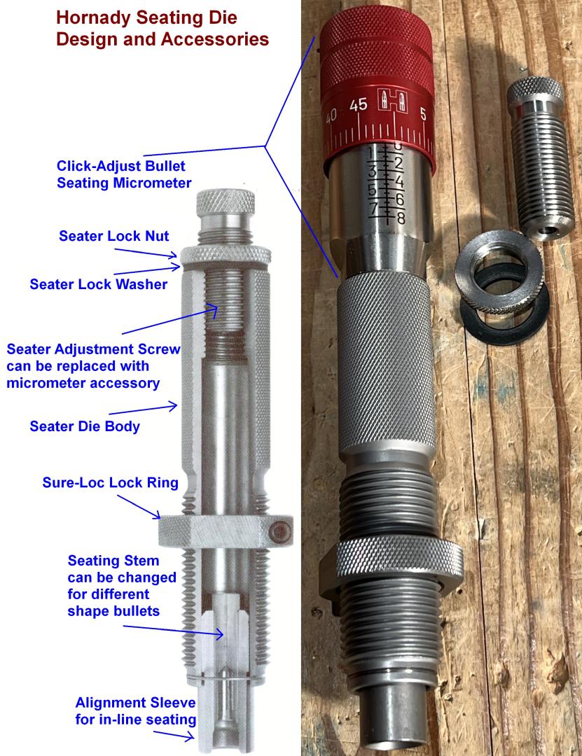

On more productive reloading topics, I need to do a shout out to both the Hornady click adjust bullet seating micrometer and their “custom grade” new dimension bullet seating die. Dialing in the amount of distance I was looking for to the lands on so many different combinations would have been an utter nightmare without the micrometer seater. It proved accurate and easy to use with repeatability that really mattered when I switched over powders and wanted to repeat all the same seating depths with the second powder. The Micrometer made this quick and easy as it is graduated and I just wrote down the numbers the first time and dialed right too them with the second powder. Perhaps even more important, Hornadys seating dies have a sliding bullet alignment sleeve. This was crucial in that it allowed me to go very light on the case expander depth so that I could load where I wanted to be on some short bullets and yet still get good neck tension without crushing any cases or getting any bullets loading wonky and off center in the process. This alignment is always crucial but even more so on long straight walled cases with flat base bullets. They really need to be straight in the seater or you will wreck that fragile case mouth and you can’t reliably get that done without a match die style alignment sleeve die. This is something only Hornady does in their standard seating dies and I think they are the only to offer that feature for a 350L at all. I could not have done the loads I was looking to do without it. Hornady has created a system here where you can have the three features most prized in any match grade seating die for any caliber you want instead of for only the very select few calibers popular in the shooting sports. The standard Hornady seating dies that come in virtually all of their die sets, the “custom grade new dimension seating die” have both a floating alignment sleeve and swappable seating stem for different shape bullets. To this seating die, you can add the click adjust bullet seating micrometer for easy and repeatable seating depth adjustments. The micrometer can also be easily swapped between different seating dies making it unnecessary to purchase one for every seating die.
A Cutaway of how the Hornady Custom Grade New Dimension Bullet Seating die works and said die with the Click Adjust Bullet Seating Micrometer added.
I guess this brings my total ammo tested in the 350L so far to 9 factory ammo offerings and 8 different bullet / powder handload combinations plus a few more significant variations on some of those handload combinations. The project has become something of a wormhole and I’m defiantly going to need to put out the SKLTN action review well before it’s done as I feel like I have a lot further to go on the straight wall investigation. So, I’m planning to get writing the SKLTN review next and hopefully I should get done in the next couple weeks.
This reminds me of a saying my brother is fond of. “Cast many lines catch many fish.”

In doing a good bit of side by side testing between the G2 Sig 10k’s and the G1 10k’s I have been surprised by my conclusions. As I mentioned in my review of the first generation of Sig 10k binos, the blue tint in the G1 units results from a very narrow notch filter and, as such, has little effect on the units resolution, low light performance, or really anything else measurable. I basically didn’t think it was a big deal. Despite this, I have found myself feeling like the G2 unit is a lot better optically. I feel this way despite the fact that it’s not actually performing any different on resolution tests or almost anything else. Basically, I’m subconsciously judging the G1 unit more harshly than I thought I was because the blue tint basically makes the image look lesser and it doesn’t seem that intellectually knowing the facts changes this. That is pretty interesting.
A squirrel though the G2 Sig 10k laser rangefinding binos

I spent some time at a nature reserve today with this years two laser range finding binos I have on hand for review, the Gen 2 Sig 10k and Vectronix Vector X. The idea was basically so spend some time in nature with the little one, get some pretty photos though the binos, and do a little rangefinder capability testing. I took a mountain of photos and quite a few very nice ones came out. I was quite pleased especially as I was only able to use a tripod for a few of the longest distance photos.
Bison herd @ 593 yds though the G2 Sig 10k binos
Un-woke male deer managing his harem though the G2 Sig 10k binos
Who knew rhinos liked swimming though the G2 Sig 10k binos
Deer @ 801yds though the Vectronix Vector x binos
Deer wallowing in the mud though the Vectronix Vector X binos
The same bison herd but now @ 1937 yds through the Vectronix Vector X binos

I believe I am finished doing the testing on the G2 Sig 10k binos and I’m probably around half way though writing up the review. I took a lot of different comparison photos between the G1 and G2 units in order to find one that I think best illustrates the color difference between the G1 unit with its strong notch filter that resulted in a blue tinted image and the G2 unit, which, I don’t think will appear to anyone as tinted. Here is that comparison photo. Fun fact, just as in the famous Monty Python "How not to be seen" skit, there are in fact two people in these photos not being seen. They are behind the dark central bushy tree, not being seen. They did not suffer the fate of any of the people not being seen in that Python skit.
Comparing the blue tinted image of the first generation Sig Kilo10k-ABS with the un-tinted second generation.
Just as I did with the original 10k unit I played around a little ranging at night and was able to range the Budweiser tower again at almost 10k yards. Interestingly, this is not actually a hard range for the 10k's to get. They will return a value every time. This is a good illustration both of the impressive rangefinding ability of the binos and of how much effect stray light has during the day on a rangefinders ranging ability. I suspect that the 10ks and probably most rangefinders are actually range limited by their memory locations when it comes to ranging buildings at night despite perhaps having at least 2x the range potential in memory locations they need to range anything during the day. The amount of background radiation from sunlight is truly massive and it's quite interesting how much it varies from day to day. Anyhow, here is that juicy 9556 yard range.

For a couple years now I have been attempting to range a giant causeway and bridge across one of the reservoirs local to me here in central Ohio. I have probably fired well over 100 beams at every part of the bridge and causeway over the years without ever getting a return in daylight. I was able to get it yesterday by catching the beam under the deck and above the pylons with the Vectronix Vector X binos at a massive 6,405 yards. That is a truly massive number to pull in daylight. The conditions seemed bright to me but they must have been pretty good from the standpoint of a rangefinder as both the Sig 10k and the Vector X were pulling ranges on trees at greater than 3,500 yards.
Ranging a bridge at a massive 6,405 yards in bright daylight with the Vectronix Vector X

I have finished up and posted the Sig Kilo10k-ABS HD Gen II review. I was quite impressed with how much improvement in the user experience resulted from the removal of the blue tint present in the Gen I units. There were a number of other improvements and refinements as well including three more buttons for fast wind input and better menue navigation, improved ergonomics, a better internal compass, more remote map point options, and cloud profile storage. Sig has also improved the warranty to a transferable lifetime for electronics and optics. That is huge in my judgement.
I have also made some improvements as well. In an effort to improve readability of my often-lengthy reviews, major background sections on technologies common to multiple products will now be found after the conclusion instead of intermixed with the unique and new review sections. As such, you will still have access to that detailed information if you haven’t read it before or would like a refresher, but it will not be in your way if you already know it and just want to get to the new stuff. This is the first review to feature this format but you should expect to see it in most new review content. I hope readers find this improves readability without harming depth.

Update 10-17-2024
So, after taking some time away from the 350L project in order to do the laser rangefinder reviews I returned to it the last couple of weeks. As I’m sure you gathered by the lack of data and updates, I had a lot of difficulties getting reasonable results with the rifle and was not sure why. I don’t like to publish anything until I am reasonably sure I have figured things out. I think I have now and have the first set of good results. I cherry picked one just for you guys. How about this .25” 5 shot group with the Proof Barreled Pure Precision 350L and factory Hornady Custom 165gr ammo. This was actually today’s first group. I’ll admit, it is a bit of an outlier in performance but all the groups were under 1” with that ammo and the rifle is now performing as expected.
The first group of the day with the Proof Barreled Pure Precision SKLTN 350 L using Hornady custom 165gr ammo.

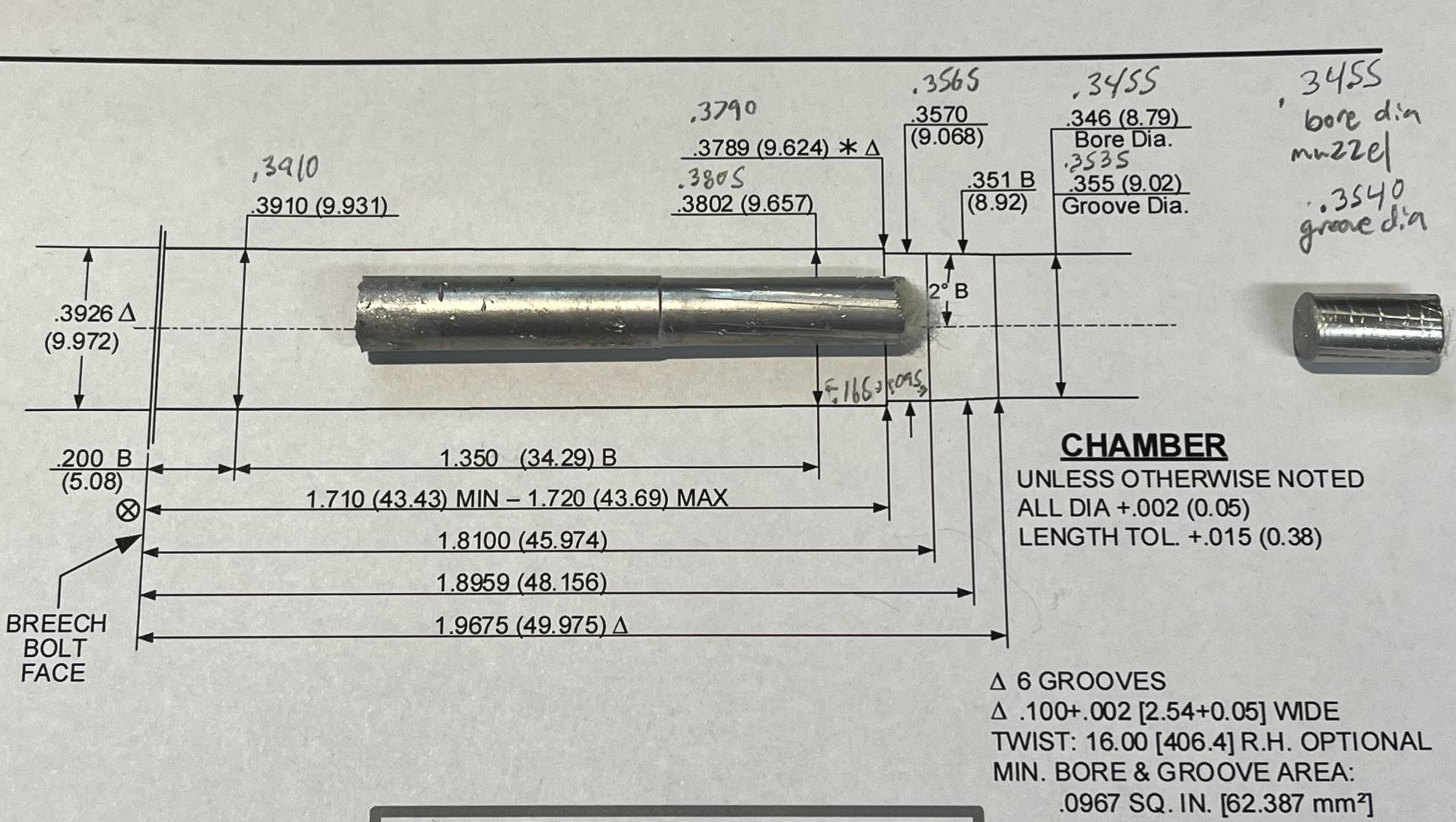

I believe there were actually three separate problems confounding my ability to figure things out on this rifle and this resulted in it taking me a long time to figure things out. I will eventually get to all the issues once I am sure about them all but they weren’t action, barrel, chambering or trigger. For a while I did think the chamber might be the culprit though and so I cast both it and the muzzle end of the rifle and measured and inspected them. They measured downright excellent. I have added those measurements to the SAAMI chamber drawing here for your interest. This was the first time I have cast a chamber using Brownell’s bismuth alloy so it was an interesting experience. I made a bit of a mess the first time. Do not over-fill the chamber, it’s a mess. Also, I used a heat gun instead of a torch. I highly recommend this as you are much less likely to damage your finish when pre-heating the chamber. Also, if you end up needing to re-melt some casting alloy in the rifle, you are much less likely to damage the temper of the steel than with a torch.
Chamber and muzzle bismuth alloy castings and measurements

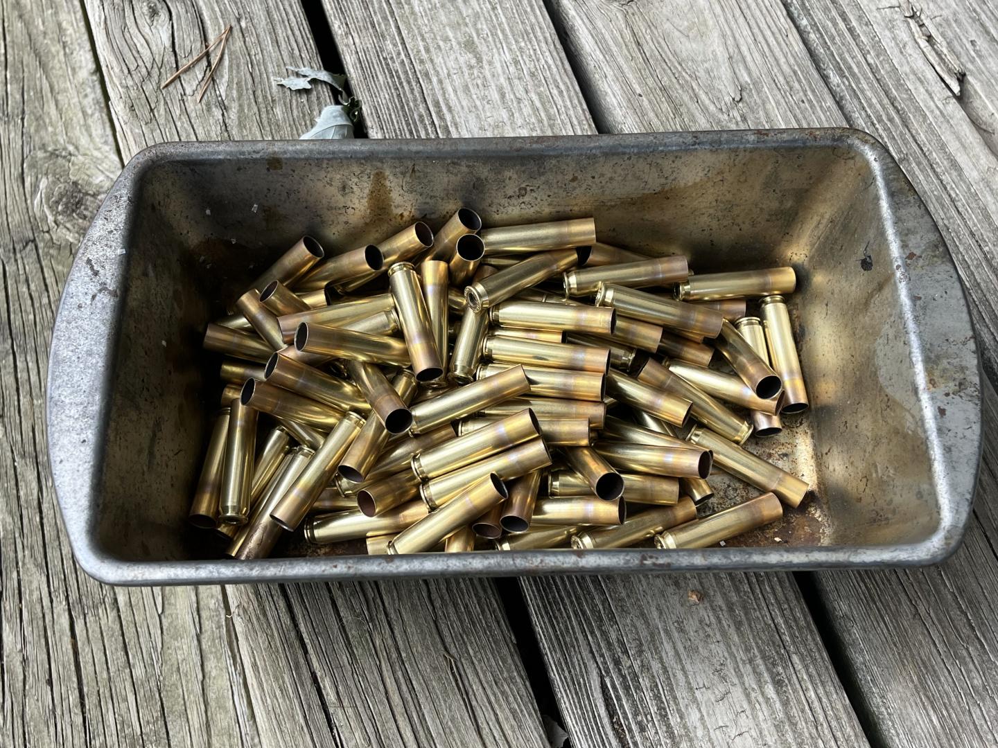

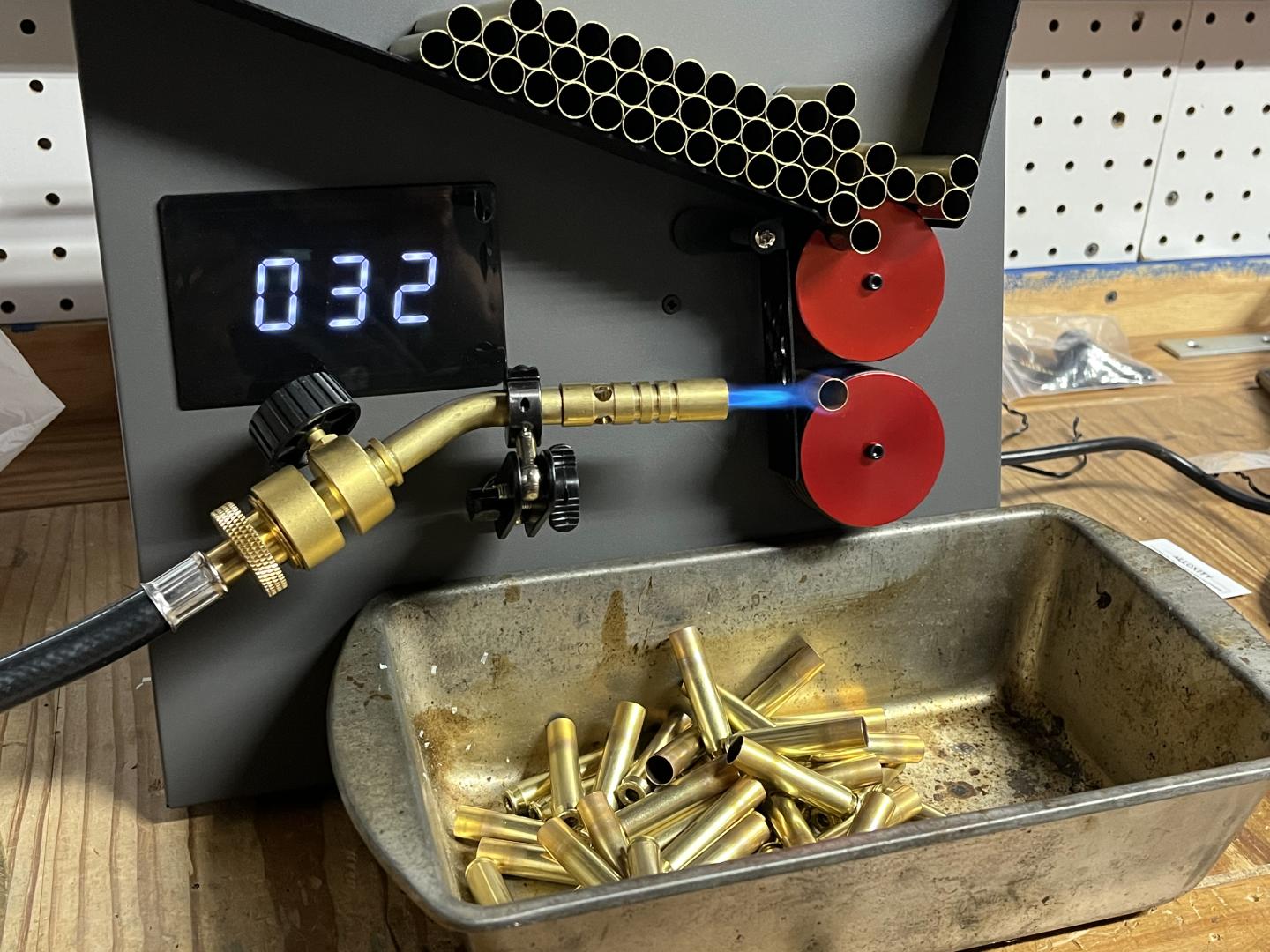

I don’t think I have talked about it yet, but I bought the Burstfire case annealer / prep center earlier this year. I had used the prep center a number of times primarily to cut the primer pocket crimp out of the 350L cases but I had not yet done a run of annealing. In fact, I have never annealed my cases before so this would be a double first time. After a couple of firings on the 350L brass I decided it was time. I think it went really well. I noticed the seating force was noticeably decreased and also much more consistent so I must have been successful in getting the area where the neck would be on a bottle neck cartridge hot enough. Since the cases neither stuck nor had the primer pockets fail I must have also succeeded at not annealing the case head area. So far so good. The machine fed the cases quite well and I’m pleased with it so far. I’m also happy I picked up their primer pocket reamer. I had intended to keep using my previous reamer but found it totally incapable of handling the crazy tight pockets that resulted from Hornady’s factory crimp. I 100% needed the more aggressive Burstfire version. I expect I’ll write something up this winter about the Burstfire machine.
Running my first batch of cases though the Burstfire annealer / case prep center
All done annealing
In other news, I have continued to develop loads for the 350L and have finished testing all of the factory ammo. I believe in the end I tested 8 different factory offerings from 4 different brands. It also looks like I have a winning handload recipe for the Pure Precision rifle. I’ll make up a bunch more of them next time to check and make sure it stays consistent. I may also try to push it a little more with more powder though I don’t think there is a ton of headroom. The primers are pretty flat though not cratered and there is no ejector marks or sticking on extraction. Of course, this recipe is not to be construed as and endorsement or suggestion. Reloaders need to read and follow manuals on their own and work up their own recipes. I do, however endorse Vihtavuori N-110 powder as the powder you should try. H110 is suggested by most but it is not well suited to the 350L probably because of it’s poor tolerance of low case fill volume. You will bet very inconsistent pressure and velocity with H110. It is a pity few N-110 recipes exist for the 350L. Hornady does have one in it’s manual though and that should be your starting point.
Expect the PurePrecision SKLTN action and altitude stock reviews soon. I’m also pretty sure I’m going to do the precision straight wall articles as a series instead of one endless text.

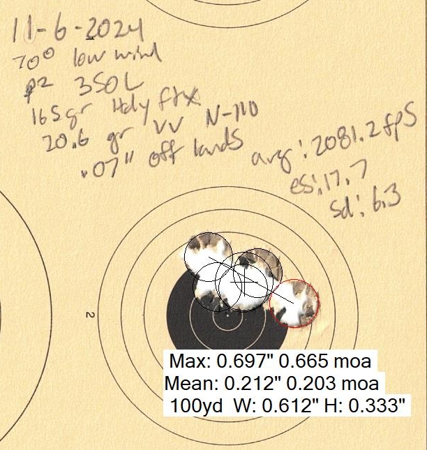

Looking like I might have a winning load for the PurePrecision 350L rifle (this is not a suggestion for you to try this load in your rifle)

The PurePrecision SKLTN action and Altitude stock review are now up. It’s a fun read because of the nice new super light action, the progression of PurePrecision from a small custom rifle shop to a much larger manufacturer and retail operation, and for the saga of what I had it chambered in.
PurePrecision SKLTN action chambered in 350L and in their Altitude stock with a Proof carbon barrel

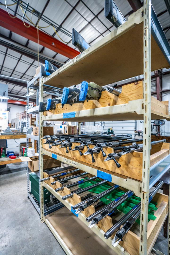

I could have had PurePrecision send me the SKLTN chambered in a well-honed caliber like 6.5CM or 300PRC and this review would have been done last spring. The rifle would have not only been done sooner as those bolt faces were ready last October but it also would have shot nice tiny little bug holes on day one. Instead, I asked them to make the review part of the Midwestern deer hunting straight wall precision rifle project and do it in 350 Legend.
PurePrecision Rifle builds mid-process
To put it simply, this cartridge is far from well tuned. It deserves it’s sketchy reputation for accuracy and then some. I’ve spent a good deal of time working with the cartridge now and believe there is a lot of work to be done from ammo and bullet makers to get to the point were a variety of consistently accurate ammo is available. Even at that point, it won’t be doing 6.5CM things as far as accuracy goes as I believe both the headspacing on the case rim and some of Winchesters poor choices in chamber and cartridge specifications will still be limiting. Still, ammo quality has a lot of room for improvement in bullet design, manufacturing quality, and powder choice. Right now, I think only a couple of makers are putting out ammo I would say is made to the standards I have come to expect in quality hunting ammo in 2024. Notably, the Hornady Custom, Hornady American Whitetail, Barnes TSX, and Winchester Deer Season appear manufactured to good standards even if I would like to change some the of the bullet design choices on some of these. They are worth checking out if your looking though.
In any case, I was finally able to get some good and consistent performance to verify the rifle build shoots well and put the review up. Of course, there will be a number of articles on hunting at longer ranges with straight walled cartridges coming up in which we will look into the intricacies of getting good performance from these rounds and hunting with them at distances requiring drop compensation. For many Midwestern folks this is a big game changer as you can now reliably take a deer across a farm field where you could never make the shot with a slug shotgun before.

It’s so cold my buddy in Alabama can’t leave his house because there is snow on the ground and your taking your life in your hands if you go out on the roads in the snow south of the Mason Dixon line. Folks don’t exactly get a lot of practice down there on how to handle a vehicle on icy roads. Of course, it is even colder here in Ohio. It was a great opportunity to test the LRF binos in really cold conditions. It has been a number of years since it was this cold around these parts. I guess that global warming that caused those California arson fires is really ramping up.
I have been following a lot of the discussion on the forums about the Vector X not handling the cold well with the standard cr123a batteries. So, I went out to test it along with the Gen 2 Sig 10k’s and Leica Geovid Pro 32s in 4 degrees Fahrenheit, -15 decrees Celsius. In addition to the factory Varta cr123a battery, I also have a Surefire 18650 rechargeable for the Vector X binos. This is one of the choices on the Vectornix approved battery list for the Vector X binos. I chose it because it was the least expensive option as it was on sale at Primary Arms for $16 and does not need a separate charging unit as it has a micro USB port on the battery. Surefire advertises that this battery model functions at –20 degrees Celsius. This is not as low as the Nightcore cold weather specific model that advertises –40 degrees Celsius function but, battery and charger considered, it’s less than half the price and –20 is already colder than I intend to be outside shooting in. As for the Leica and Sig models, I had a Panasonic and Varta CR2 and so each set of binos was tested with each battery. In all cases, the binoculars, and batteries were given an hour outside before testing to reach ambient temperature. This was done with the batteries not yet in the binoculars to make sure they were good and cold. None of the batteries used were new and fully charged. All were somewhere in the middle of their lifespan or charge. Battery voltage was also measured cold (4 degress F, -15C, and warm 69 degrees F and 21C) and a few hours later.
Sig Kilo 10k Gen 2, Leica Geovid Pro 32, and Vectronix Vector X with their respective batteries waiting to be tested in –15 degrees Celsius
The results were as follows:
Vectronix Vector X binoculars:
- Varta cr123a cold voltage 3.034V, warm voltage 3.032V. With this battery the Vector X binos would power up and show the pre-ranging screen but immediately died when you attempted to range. The LED hud disappeared and they did not return a range.
- Surefire SF18650B rechargeable cold voltage 3.464V, warm voltage 3.466V. With this battery the binoculars functioned perfectly.
Leica Geovid Pro 32 and Sig 10k G2
Both of these binoculars worked perfectly with both of the test batteries. The test batteries voltages were:
-Panasonic CR2 cold voltage 3.122v, warm voltage 3.047V
-Varta CR2 cold voltage 3.041, warm voltage 3.000V
So, obviously we all know that batteries don’t like the cold and there is some temperate where each one is going to fail you. I can second the report that this temperature is not as low for conventional cr123a’s in the Vector X binos as for CR2 batteries in other laser rangefinders. I am not sure why this is as these batteries typically share the same LiMnO2 chemistry but there seems to be a consensus this is the case. The rechargeable 18650 battery has both a higher voltage and a different chemistry (LiCoO2) so it is not surprising it behaves differently. It might be academically interesting to know at exactly what point each rangefinder quits with each battery but from a pragmatic standpoint it looks like you should just go with a rechargeable 18650 in the Vector X binos if you want it to work in the cold and perhaps the special cold weather Nightcore model if you want it to work in Kamchatka or North Dakota.

Update: 2-21-2025
The first day using the Garmin Xero C1 Pro Chronograph with the PurePrecision 350 Legend with Proof Barrel and Sightron S6 5-30x56mm scope
The Garmin Chronograph review is now up. Boy did this thing end up a lifesaver this year. Without there is a lot of data that I just would not have been able to collect on the 350L as many of the range days were far to busy to have attempted a setup of my old Oehler 35P on. Some of that data ended up pretty important for figuring out what was going on and it’s possible one even started an ammo recall. Anyhow, read it and see what all else I think.
As it is now February of 2025, this will be the last review to show up on this years blog as well as the first one that will show up on next years. You can expect the transition post closing out this one and having the link to the next show up pretty soon. I’m getting together the last of the products for next years lineup and finishing up that post.
You should also expect to see a video version of the Garmin Chrono review soon as I have shot the video and am editing it. This will be my first attempt at that format. I wouldn’t worry about the articles disappearing though. I far prefer the written word as both a consumer and producer of content.
Update: 2-27-2025
This is the last post on what is now last years blog. My 2025 blog thread is now live.
Also, I have finished my first video ever. A video recap of my Garmin Xero C1 Pro Chronograph review. I don’t even think it sucks. I think it is actually pretty good for the first video I ever shot and edited. Boy does my gaming computer make some short work of that editing as well. The video is live on youtube now and will be live on thehide.tv front page soon as well. Were still experiencing some issues with getting on the permissions and such lined up on the backend of that part of the site. See you guys on my 2025 blog thread.
