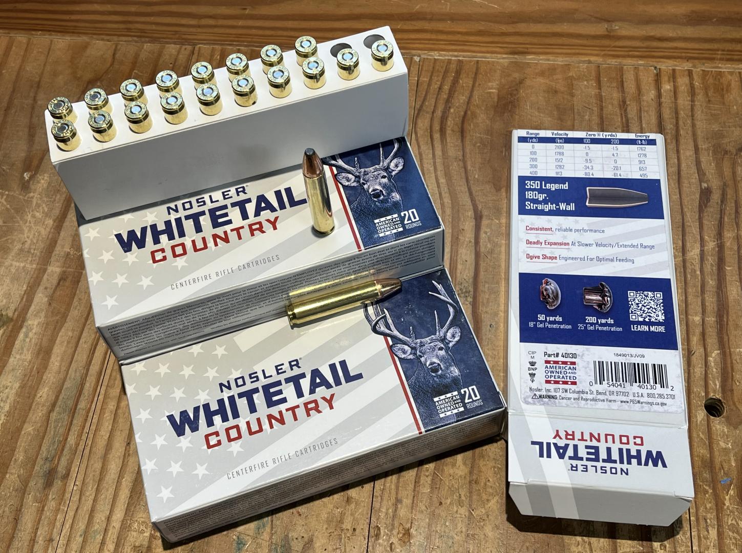

Nosler’s just introduced Whitetail Country 180gr 350 legend ammunition

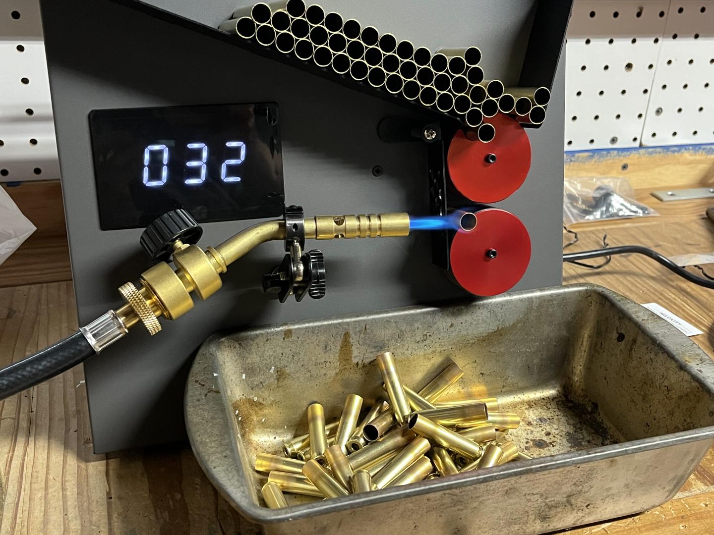

BurstFire annealer

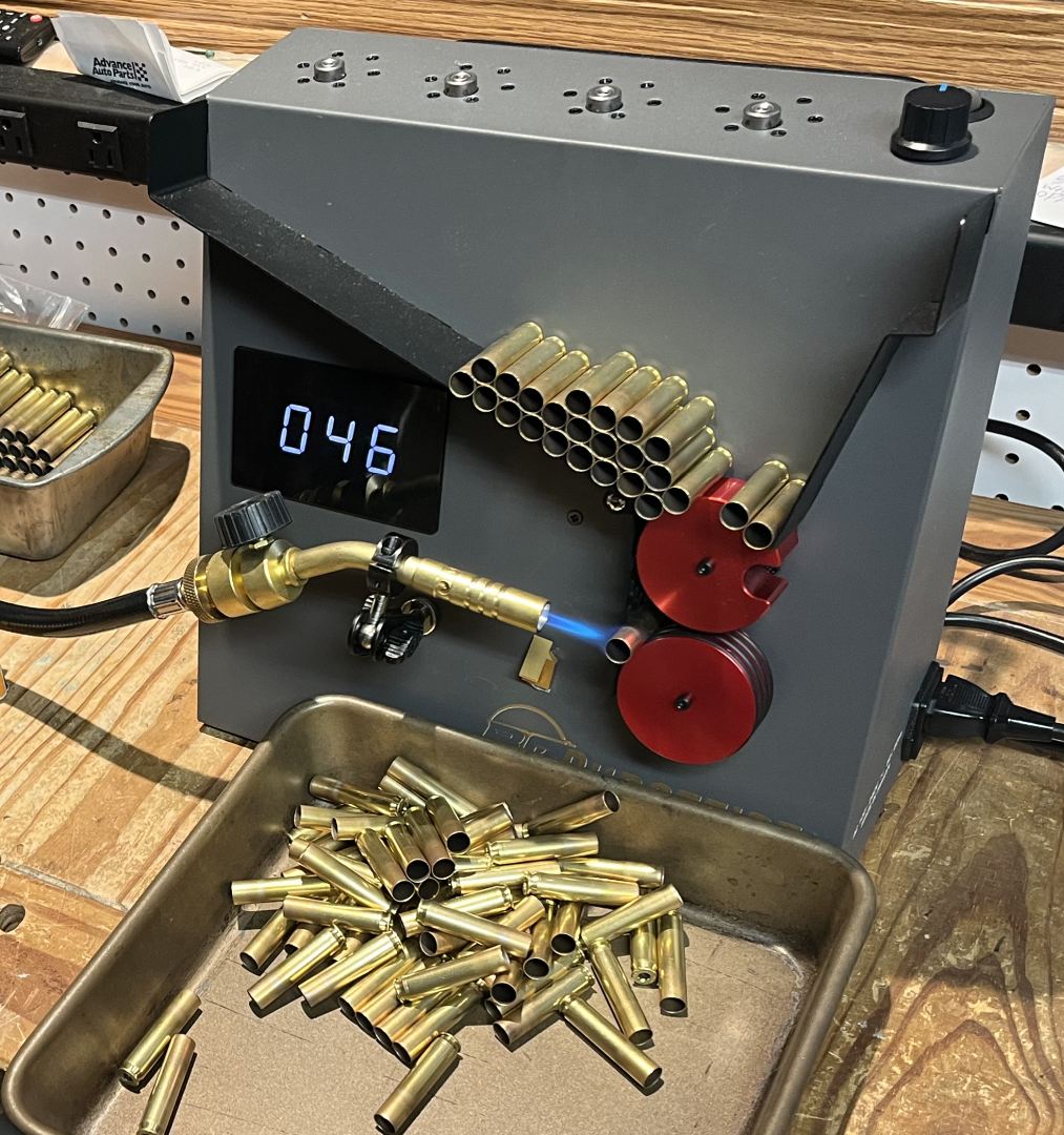

For some time I have been thinking I need to try stepping up my reloading game by adding annealing. Frankly, there was no way I was going to spend thousands of dollars on it though. After some research, I came to the Burstfire annealer. I liked the look of the design and the very clever torch adjustment system. It also features built in rotary tool attachments, and an affordable price, so I bought one. I’ll tell you what I think about it and also their military crimp cutting head. It won’t be 10 pages, I promise.
The first batch of 350L brass I annealed on the Burstfire annealer

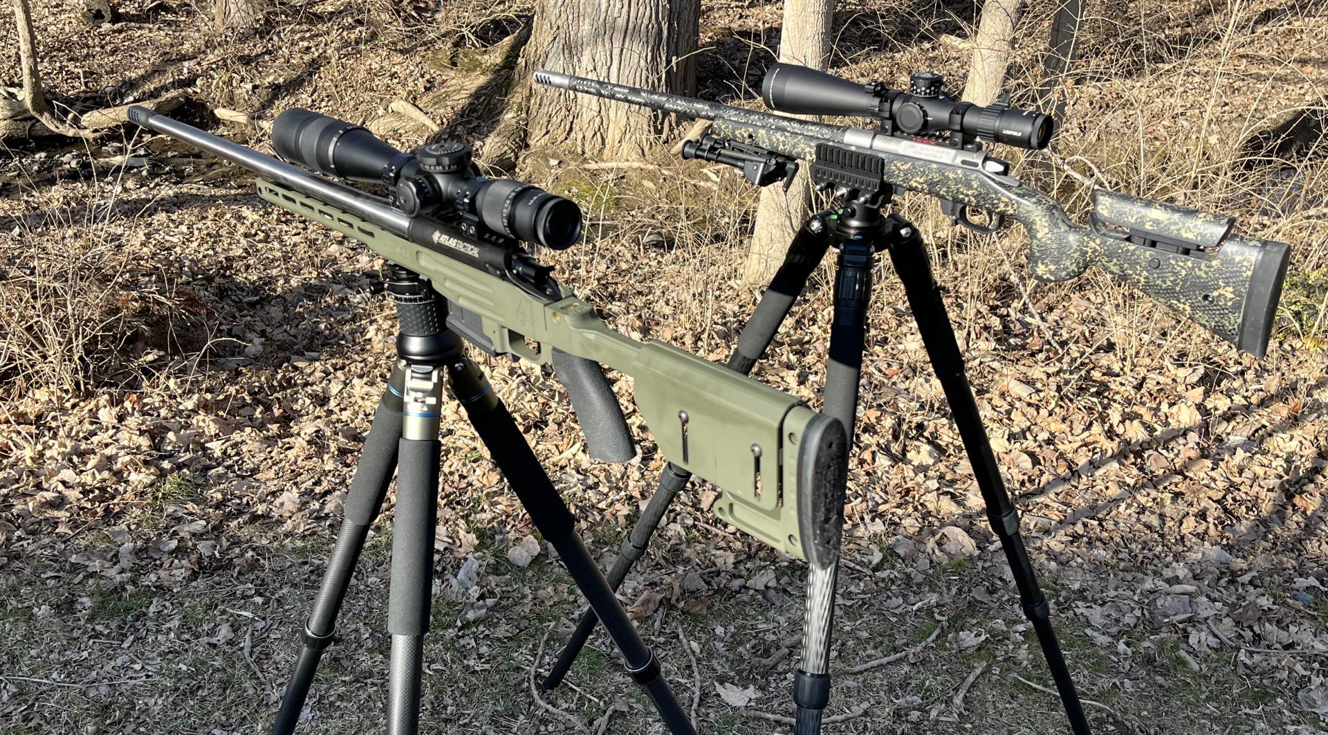

Field Optics Research Tripods
This was another shooting accessory that I had been meaning to pick up for a while. I spend a good bit of time a few years ago at ShotShow looking at different makers products and decided that I thought the design of the DomeTOP Field Optics Research models was pretty clever. I picked one of those up as well as a bowl top. I also very much liked the design of their FlexLite GunPOD rifle vice and will be looking at their gun vices as well. I am no guru of competitive rifle shooting off of a tripod, but I’ll give you my opinion and not pretend it’s worth more than it is on the subject.
Field optics research Hunter 32DTC3 tripod holding a Kelbly’s .308 and Pro39TC3-MIL ASFPL with FM570B gunvice holding the 6.5CM PurePrecision Crux.

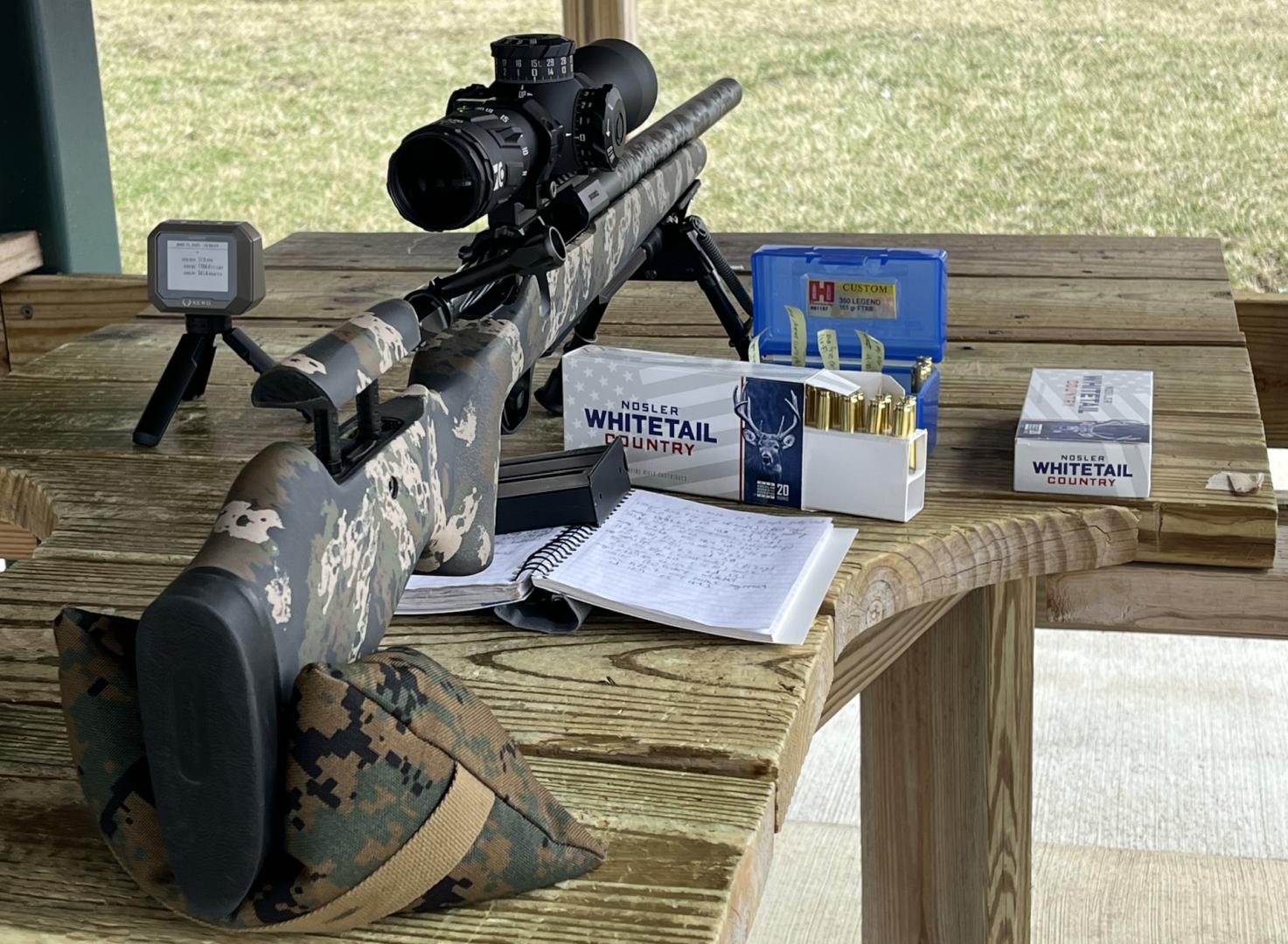

Did a range day with the 350L, new Nosler 180 grain whitetail country ammunition, and a number of handloads. The wind was downright atrocious, super gusty and variable between 0 and 30mph. It was so strong that two targets blew off the board and the rocking of the target board may have added as much as 5/8 inch in vertical movement. Still, it was one of the first sunny warm spring days and the first that I have had the day off on. So, I was going to enjoy it and I sure did. It felt great to be outside at the range.
Out shooting for the first time this year with the PurePrecision / Proof 350L rifle, Noslers new 180gr whitetail country ammunition, and some handloads.

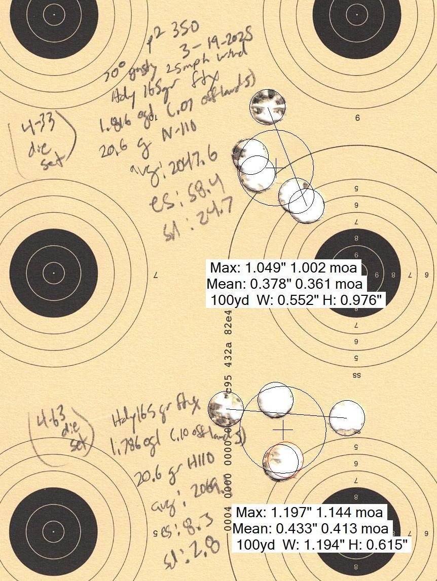

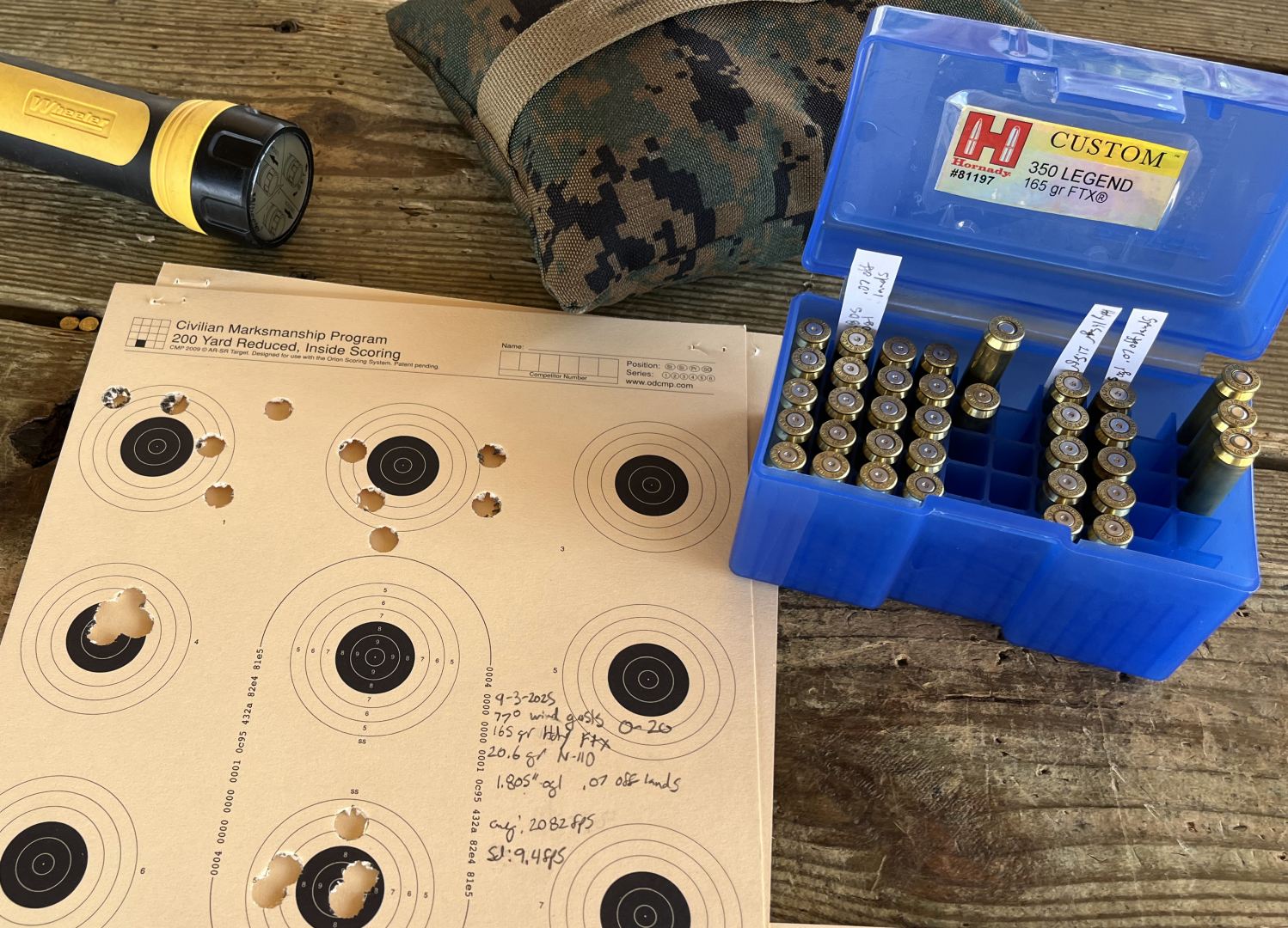

To be frank, I thought it pretty likely that all my groups today would just suck and I might not learn anything because of the wind. If it hadn’t been my first nice warm chance to be out and I wasn’t so pumped I probably would have stayed home. My calculator said I could see as much as 4” of horizontal from the wind and I could see the 5/8” of vertical from the target flopping as well. I was not overwhelmed with confidence looking through the scope and watching the target flopping up and down more than half an inch. Big groups on a day like today just don’t tell you a whole lot about how your ammo is performing. Much to my surprise, the groups weren't uniformly bad though. I got some pretty decent performance with some Hornady 165gr FTX handloads. I seem to be in a range of seating depths that this bullet is OK with and I may be nearing an end point with what I think I can get with it. I expect I will be able to put together a set of groups that average better than 1” before too long.
Handload groups with the Hornady 165gr FTX bullet and VV N-110 powder (not a load recommendation)

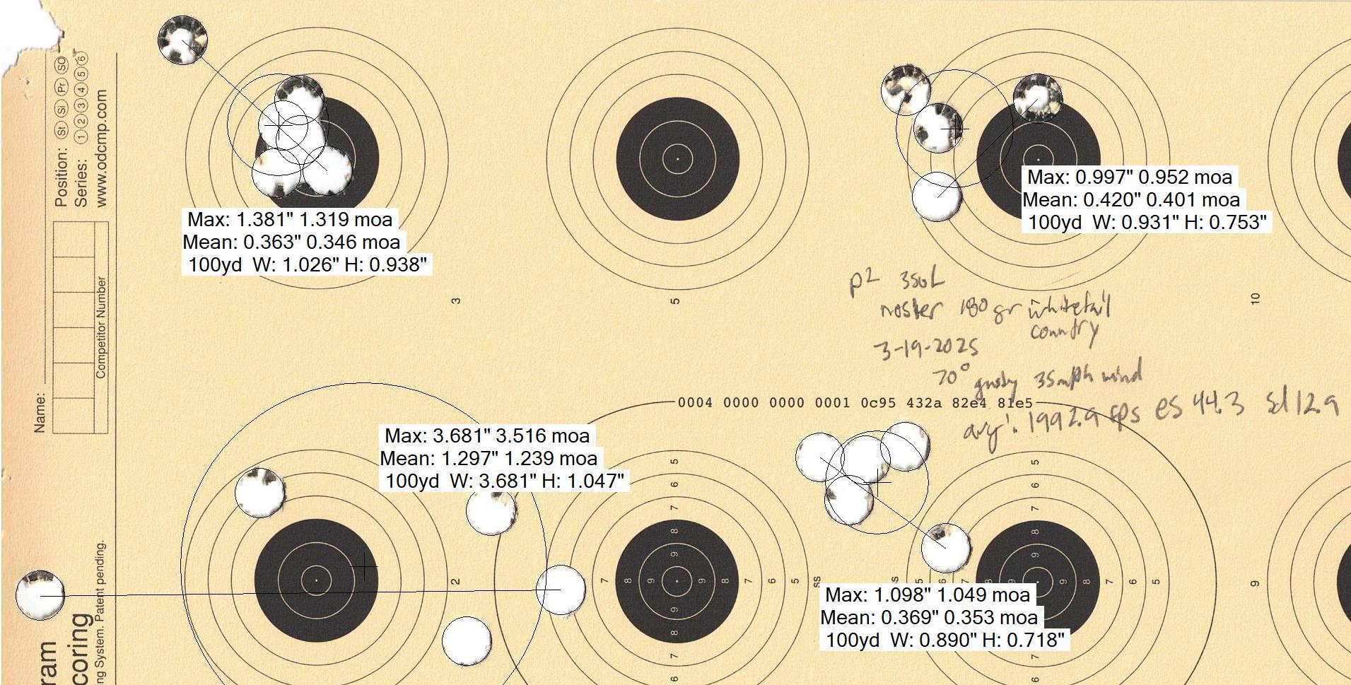

I also shot a box of the new, hot off the presses, Nosler 180gr whitetail country ammo. This ammo got the worst of the wind conditions. Both of the targets that blew off the board did so while I was testing this ammo. Fortunately, this target wasn’t one of the liberated ones and a few of the groups came out pretty decent. I won’t be surprised if I can actually average better than 1” groups with this Nosler. It’s SD was also pretty reasonable at 12.9fps. As for the one giant group, I’m surprised more groups didn’t get blown open today.
The first groups shooting the new Nosler 180gr whitetail country ammo

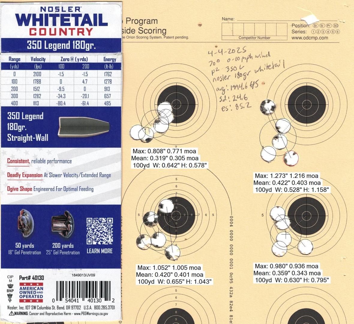

First off, I made it back to the range on a day when the wind wasn’t gusting to 30mph and Nosler’s new 180gr 350 Legend offering performed as expected in the PurePrecision 350L coming in at an average 5 shot group size of 1” and average mean radius of .38. I did not shift the turrets during these groups so the software also allows them to be combined. This results in a 20rd group size of 1.49” and a mean radius of .397”. I’m pretty happy with that. It’s velocity SD of 24.6fps and ES of 85.2 fps weren’t great though. I thought I might look through the individual shots and find one really light throw to explain this as volumetric powder dispensing sometimes gets sticky and throws a really light one but that wasn’t the case. There were a number of shots on the far edges when it came to the velocity spread and the ones on the high side were actually early in the shot string so cooking the rounds in a hot chamber wasn’t the cause either. Whether it be due to charge weight variance or some other factor such as case fill or the powder simply being a bit erratic, velocity just isn’t great on consistency. It could be worse for sure, but it’s not great. Still, I think this Nosler stuff is good ammo all around and it joins the Hornady 165gr custom and Barnes Vor-tx on my recommended list. Through the course of my ammo testing in 350L I have found most of the factory ammo offerings to be pretty terrible with many products producing occasional groups over 3”. These three have been the exception to that.
Shooting the new Nosler 180gr Whitetail factory ammo in the PurePrecision SKLTN 350L on a day when the wind wasn’t blowing the targets right off the backer.

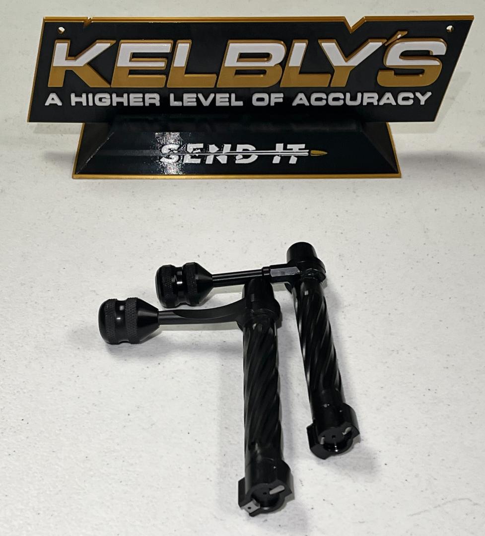

Lastly, I had a chance to go up and do a site visit video at Kelbly’s last Friday. This includes a walkthrough of the factory as well as a sit-down talk about the actions they have released in the last few years as well as the changes since I did a review of their Atlas tactical action in 2018. It has been a while since I had been able to go up and see Ian and it was great to see how things are going at Kelbly’s. I think they more than twice the machines that they did the last time I was up. They have so many more machines that they have now actually outgrown the main factory building and kicked the 4 wheelers out of what used to be the garage to fit some in there. Hopefully the video has turned out well as this was my first attempt at this type of content.
Old (left) and new (right) versions of the bolt from a Kelbly’s Atlas Tactical action.

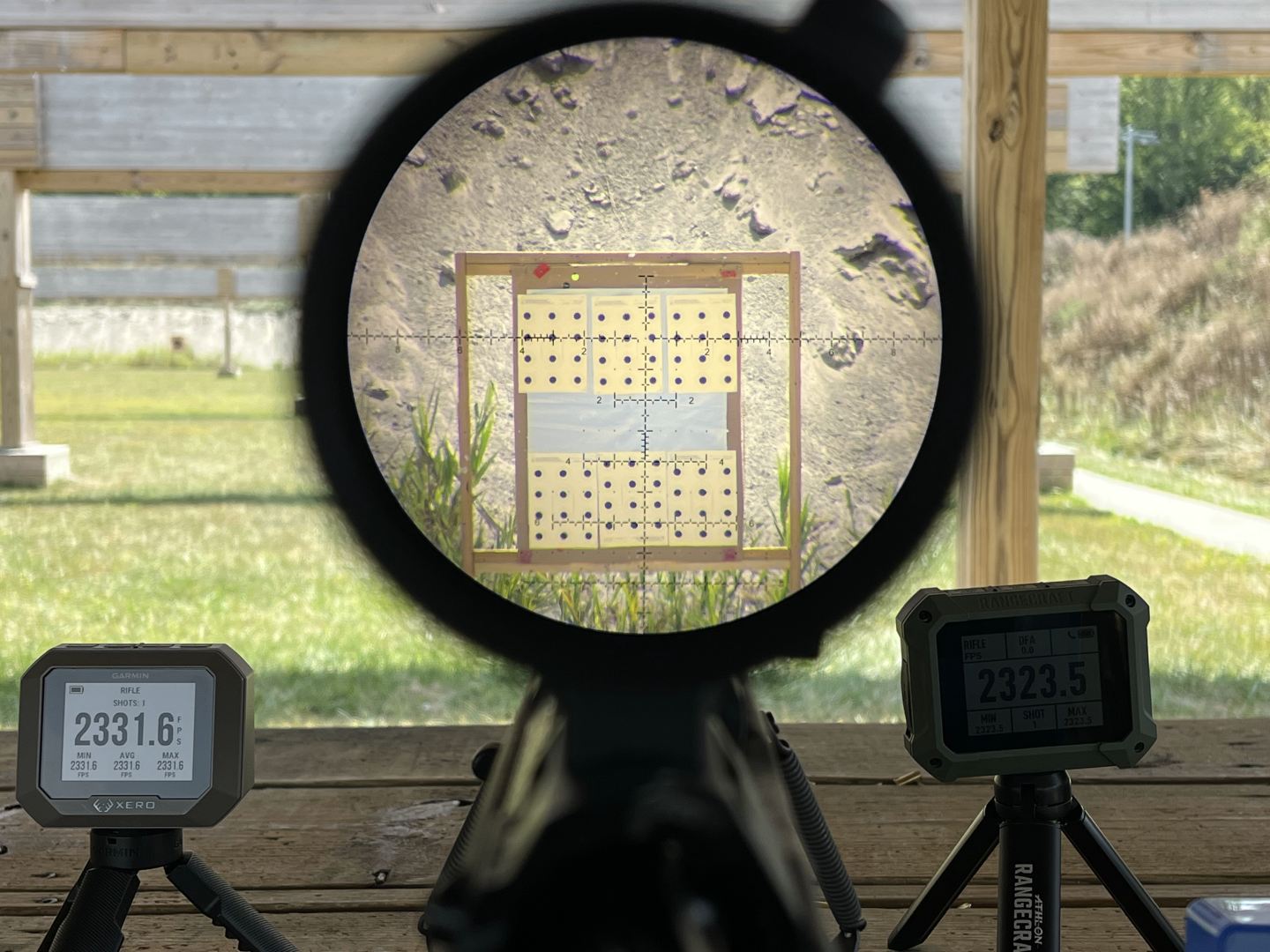

It rained me out half way through work today so I decided to jump ahead and do an indoor range run with the new Athlon Chrono today instead of waiting. Of course, I set it up side by side with the Garmin for the comparison. Boy was I in for some big surprises.
Side by Side at the range with the Athlon Rangecraft Pro Radar Chronograph and the Garmin Xero C1 Pro Chronograph
First off, the Garmin with software version 3.27 was not near as cooperative as it was the last time I was on a crowded indoor range with it back when I first got the chrono. The Garmin was missing shots left and right while also picking up other folks shots occasionally from as far as two lanes over. The Garmin even missed some 9mm shots. This is something it has never done before. Perhaps it was getting some signal interference from the Athlon when it comes to missing some shots. I don’t really know how close the operate to each other. I doubt that would explain the problems misidentifying others shots though. That is not a problem the Garmin had with it’s original firmware. Hopefully updating to the current 3.32 firmware fixes things but really I would just like to have the original Garmin firmware back. Things worked well on day one. Clearly I need to spend some time with that new firmware testing function both with and without the Athlon present. Today was a mess for the Garmin for sure.
On the other hand, the Athlon did not miss a single one of my shots despite sitting just a bit further from the barrel than the Garmin was. The Athlon did pick up two shots from the adjacent lane at the very beginning which lead to it being moved a bit to the left side of the table as the lane to the right was empty. After that point it caught no neighboring lane shots for the rest of the day. A far better performance than the Garmin both in terms of what it picked up and what it didn’t. I should also note that the Athlon displays fresh shots quicker than the Garmin. This could just be that the time to display is quicker but it also may mean that the unit can pick up shots in quicker succession. The difference was clearly noticeable though.
Summary of the data taken by the Athlon and Garmin chronographs for the same shot strings
Lastly, I had heard some folks speculating on the accuracy (more properly precision) of the Garmin vs the Athlon. As such, I compared some strings side by side on both chronos. With the Garmin dropping quite a few shots or sometimes including other folks, I only managed 3 strings where I think all the shots were the same for both chronos. In all three the Athlon showed slightly better SD and ES numbers. This bodes well for it’s precision vs. the Garmin as it should be expected that better precision on the part of the chrono would translate into lower SD and ES numbers as errors in chrono readings would stack with true velocity variance to result in bigger numbers. Of course, this is a very small amount of data in only one velocity range but it does bode well for the Athlon so far. It certainly doesn’t look like it will end up being a bunch less accurate than the Garmin.
