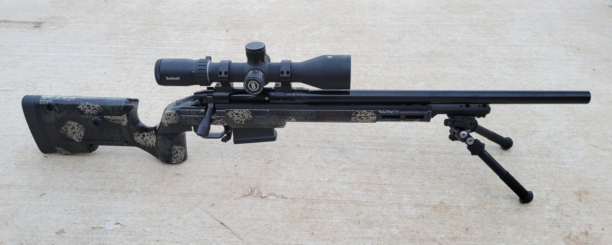

Tried something a little different this time around. Went with a .2195x.2242” barrel with the 400bb steel from Bartlein. This is forming for now. It’ll be @Jamie C prs rifle for this season. We’ll see how much this new steel can take with a prs shooting schedule.

But, they don’t always behave with feeding and ejecting. With a 22-250ai, you can stack them in a mag and feeding and ejection should be a non problem. You can run a low node, that’s more forgiving. I’ve ran this chamber for a couple years and it is nice. This is the first with a 7 twist though. We shall see how it works out:

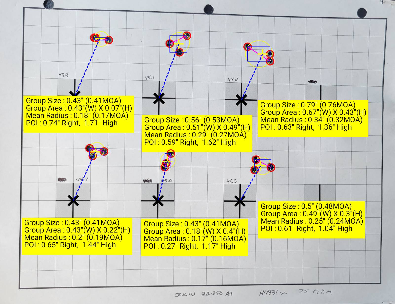

Rifle:
Origin Action
20" Shilen, 1-7.5 twist with 4 groove ratchet rifling
KRG Bravo
To get started I partially formed cases with the Cream of Wheat method. Then I selected powders for sighters & pressure testing: H100v, Superformance, H4831sc, MRP, 4000-MR.

Across the ten rounds fired, both Superformance and H4831sc shot less than an inch. With that, they were selected for the OCWs.
The fire formed R-P brass holds an average of 50.3gr of H2O.
OCW / Group Testing:
Superformance has a node between 43.6 and 44.4 and wants to run 3250 fps.
H4831sc shot well with 5 of 6 groups around 1/2" and has a node between 44.1 and 44.7. It also was running an average of 3250 fps.

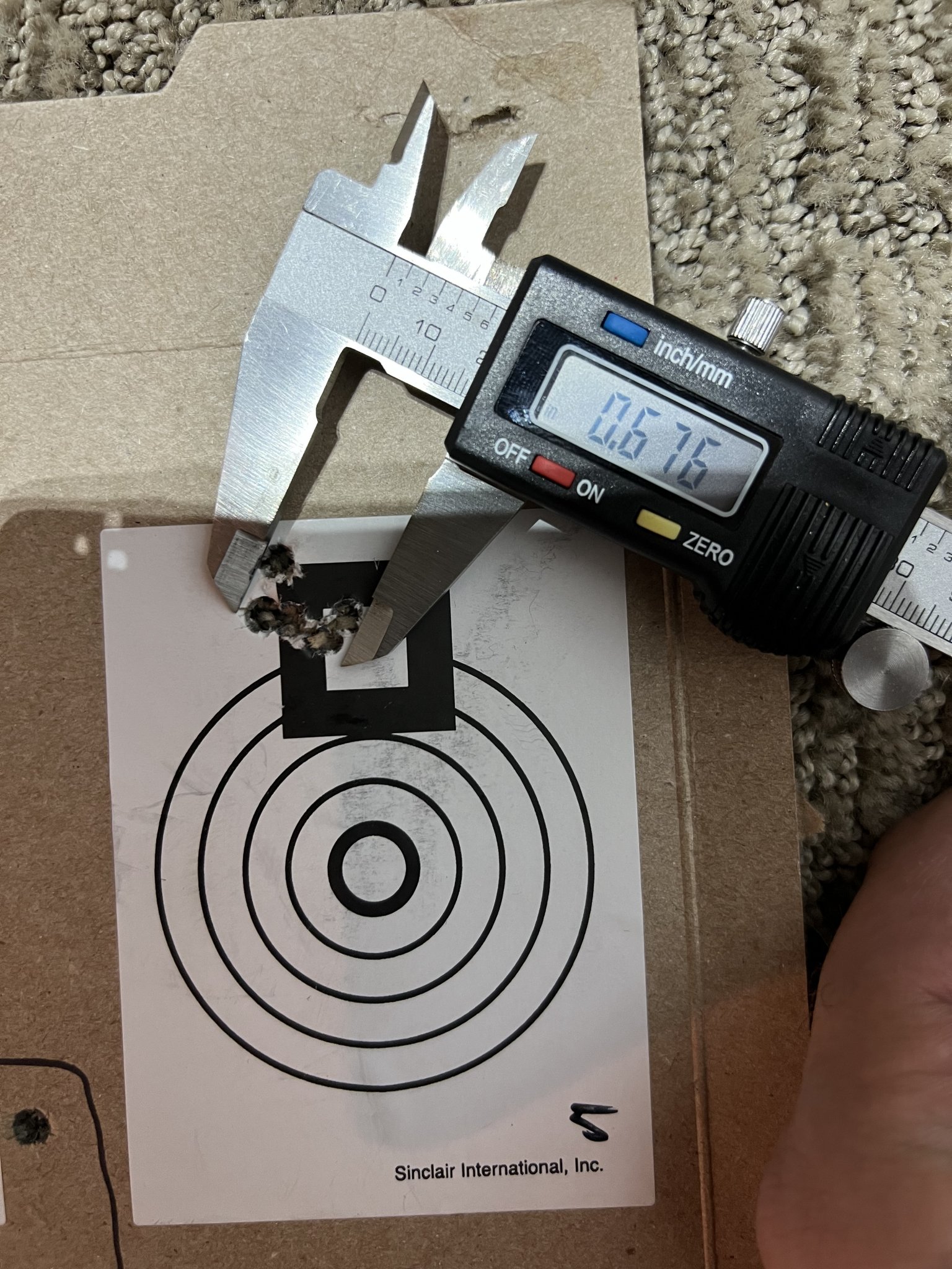

I am shooting the 69 gr Matchkings and they shoot very well. I'm not shooting high velocity, but they are consistently less than .25" groups at 100. Im loading Varget with 36grs.
