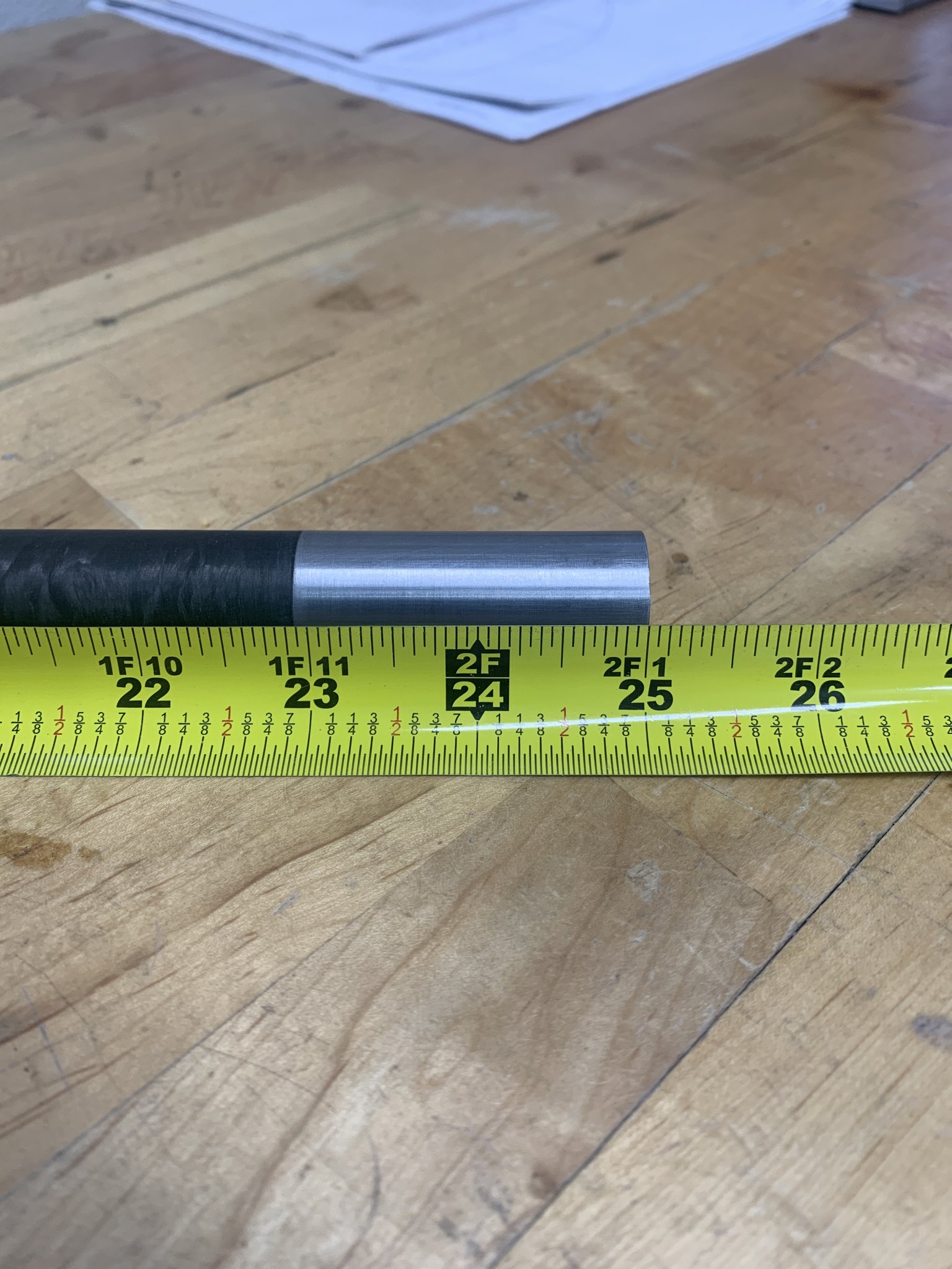

    No, you’d need to order that special to finish at 22”. Here’s how much steel is at the end of a Bartlein. Proof is even less. 1” at least needs to be removed, which means if you want a muzzle thread, you have a shade under .5” of wiggle room.
    Reactions: FredHammer
    No, you’d need to order that special to finish at 22”. Here’s how much steel is at the end of a Bartlein. Proof is even less. 1” at least needs to be removed, which means if you want a muzzle thread, you have a shade under .5” of wiggle room. View attachment 8066460
