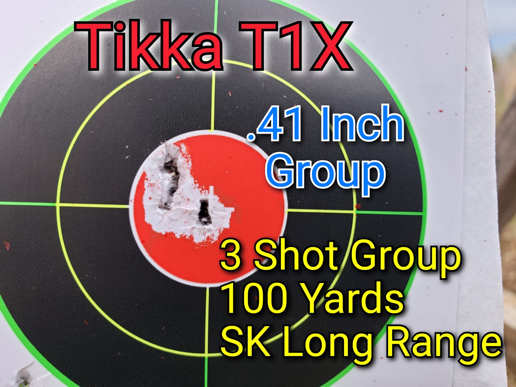

My Sako loves SK, well sub moa at 100

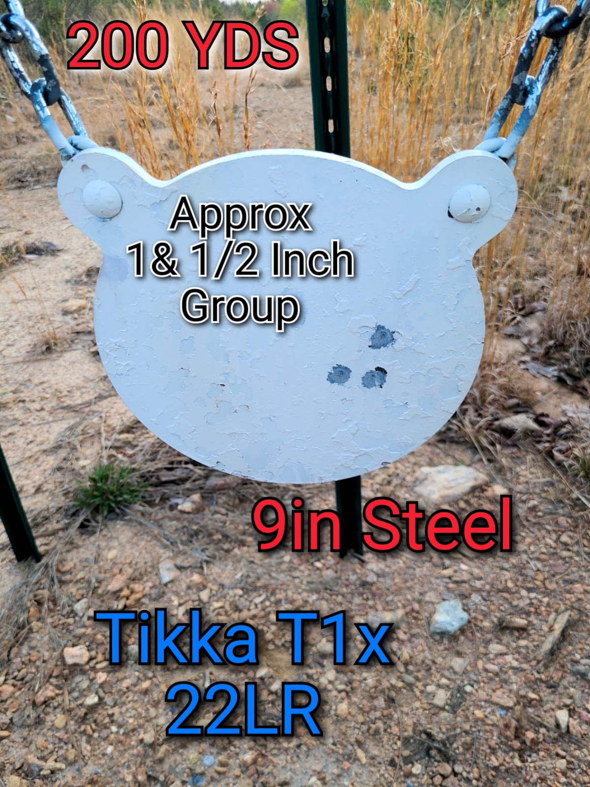

I plan to post the new videos soon, but this is some of my T1x at 475yds.
Reactions: Jefe's Dope
No need to scratch your head Tenex is designed for optimal 50yd to 50meter accuracy buy its load and bullet design dont put bets on it at 300yd you'll loose . That's the very reason I group shoot all my ammo at 300 yds I'm moving out to 600 next week. I could care less at 100 in less I'm shooting asprins.
I will say this veloicty spread or deviation at any range is your enemy, low ES cost money !
My 1517 shoots under .4 at a 100 yd on calm days but none of my 22lr will at 100yd ,but I have got several groups all 10 shots under 3 " @ my 330 target what would that backwards calculate too ?
your getting consistent 3" groups at 330 yards...not happening
the ammo ES is more than 3" at that distance
I would have to say that consistent 3in groups at 330yds would make for an incredible video if you have one available?
I'm not saying that it isn't possible but it'd be something to see, is all.

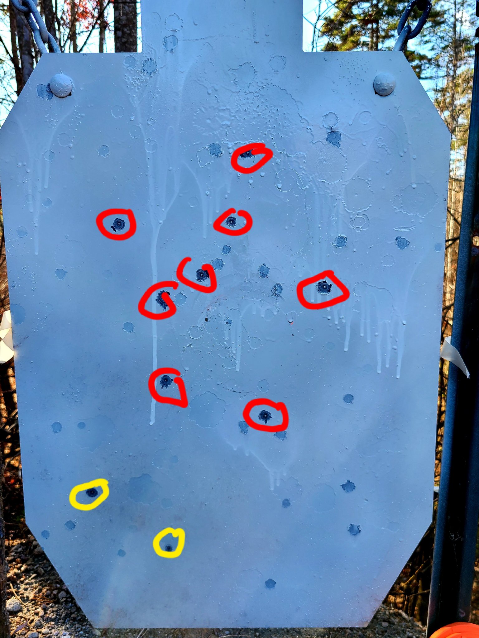

I usually get 6-8 hits out of 10 on 4in steel at 300yds with my T1x, however, on a calm day the hits might increase slightly?...
Maybe with different ammo I might get close to those results but I'm not holding my breath., lol.

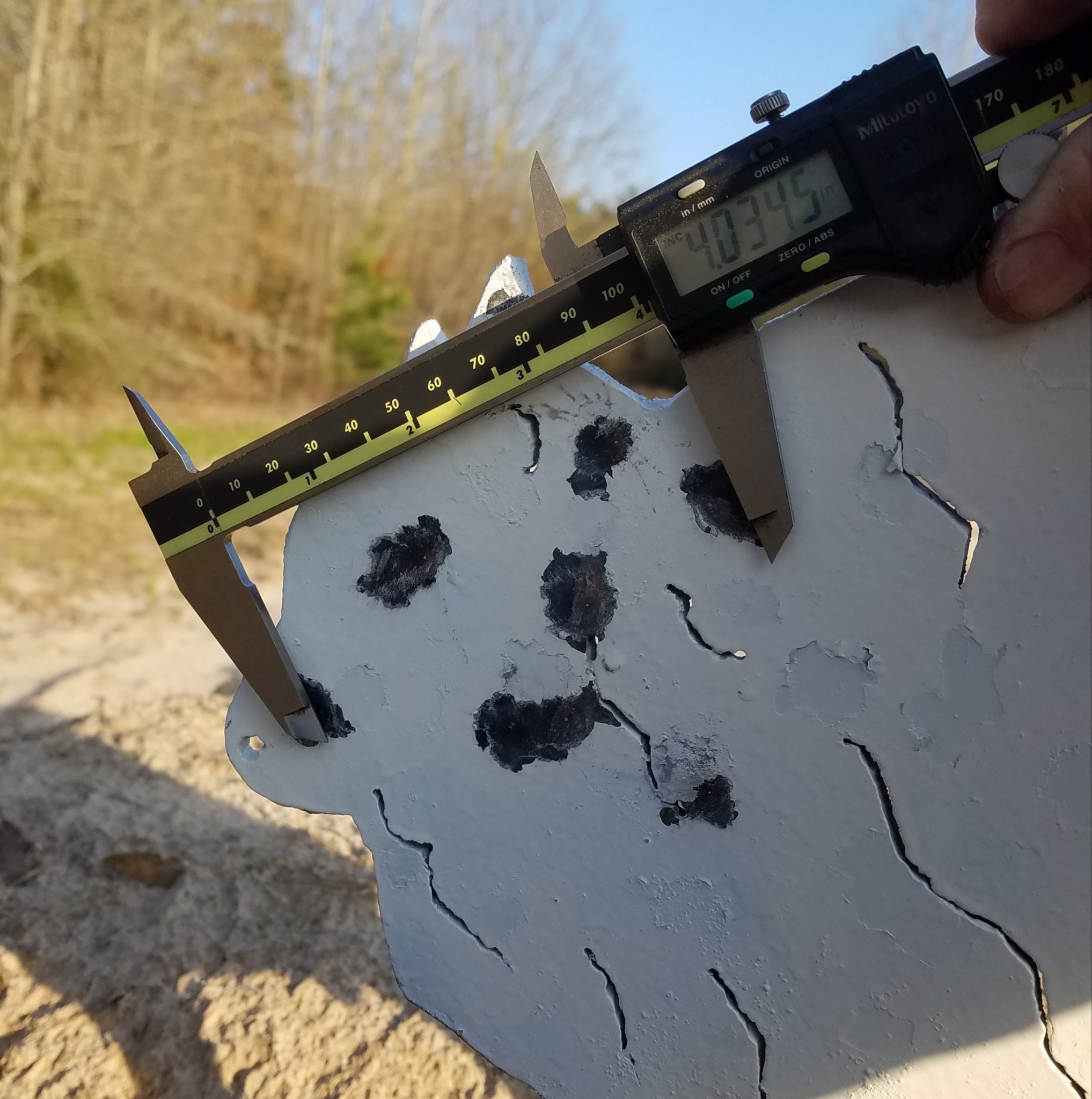

This target hangs at 220 yds this was SK HV thru a spare Black hole 3 groove Ar15 blank I fitted to my RIM X that's a
.224 / .219 bore way over the .222/ .217 but it put all 10 shots like this ? Go figure ?

I find SK LR to be the best 100yd+ ammo I've tested so far.
However, I reload everything but rimfire.
Here are my 475yd hits in red, yellow was a loved one shooting with me the same day.
I have actually grouped about 6in at times with my B14r at 475yds, once on video...
SK LONG RANGE- 475yds
12in Steel 475yds

I'm interested on hearing more on this fast twist with regular 22lr ammo. Care to share more? 🤓
I'll be able to tell you more next week 4 sure I got in another new barrel from John at Keystone I wanted to try a GM in a 25 " ,but it's a 16t the shilen 14 rachet I'm shooting now is tight with whatever I've feed it. I just got through making a 36" gridded target for 600 yard group test next week. I will say I'm still impressed with the SK HV out of the .224 bore 3 groove 9t Black hole barrel I'm shooting hand loads out of I'm gonna put it back on and run it at 600 as well and see if the improved GS shows up out past 330.
