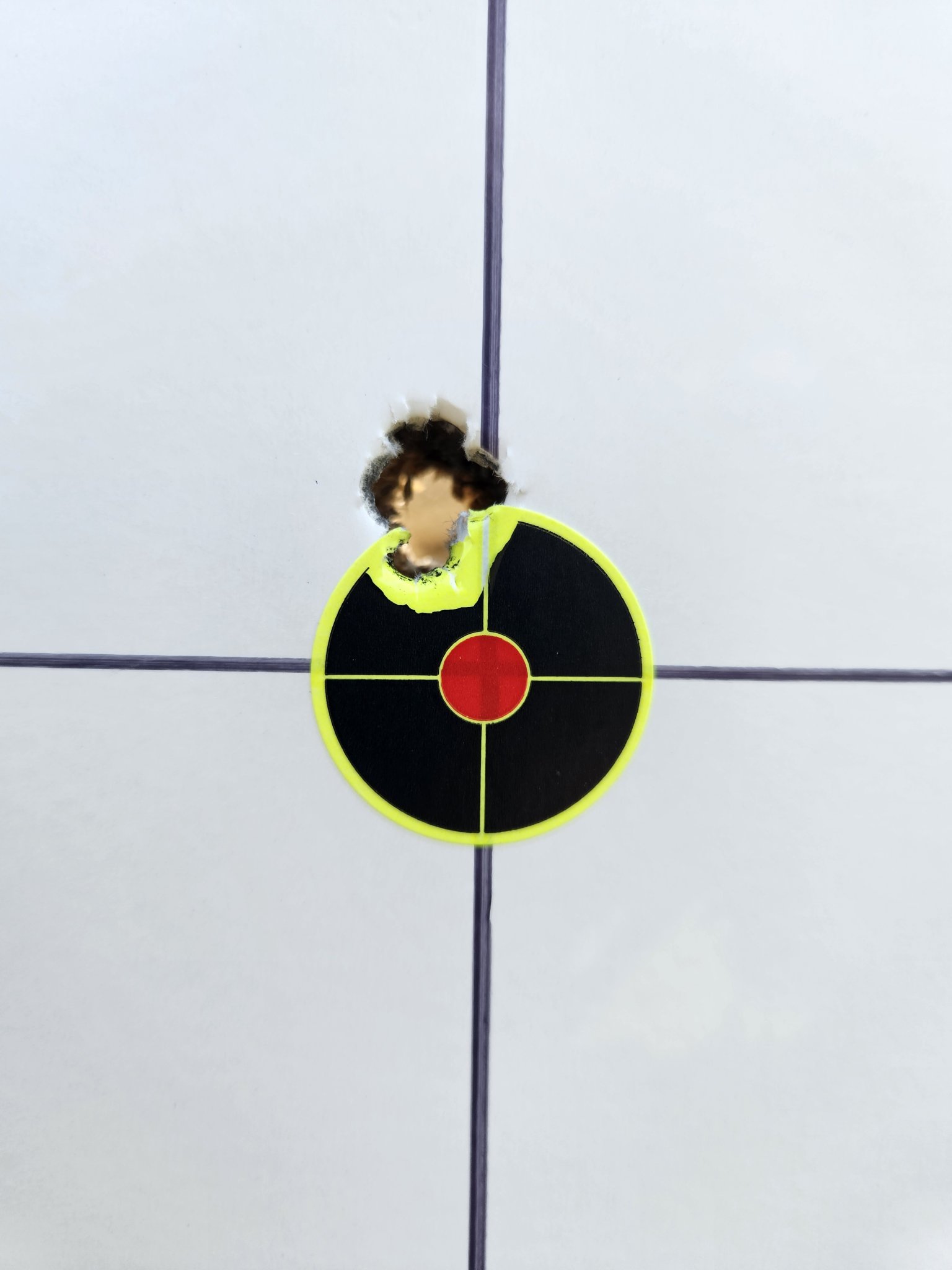

Who here has had luck on a 22 arc build and what was your recipe? I tried to cheap out against my better judgement with a ballistic advantage 18” fluted barrel and brownells type 2 bolt.
After break in, I tried 3 different ammo types, 3 suppressors and bare muzzle, gas shut off and two scopes. The best 5 shot group I’ve had was .8”@100 yards and that wasn’t repeatable. Average group size was 3” with mostly vertical stringing. These groups were shot after letting the barrel cool to ambient temperature.
At the same time, I was alternating with shooting my 6.5 cm gas gun that had an average group size of .8” with 4 different types of ammo, so I don’t believe that this is a shooter issue.
Attached is a pic of a representative group from the arc build.

I'm going to be amazed if it's the barrel. Machining is so good now that a 3 moa barrel is harder to find than a .5 moa barrel. Take it all apart and put it back together, my bet is that something is loose. Remount that optic entirely, pull the barrel and re-mount it, make sure there isn't something touching the barrel under the handguard, make sure your gas system is locked in and your gas block is functioning correctly..

Understood. The three I've had in my possession shot well under a minute. It's effortless to make a sub-moa barrel these days.

The very first thing I would check is the gas block clearance in the handguard. Some barrels whip like mad and even when it looks like there's clearance, it's not enough. One way to proof this would be to remove your handguard, paint the bottom and top portion of your gas block with a paint marker or something that will run off easily when contact is made, and then veeerrrryyyy carefully reinstall your handguard ensuring it doesnt touch the gas block during install. Then shoot a couple of groups and check for paint on the inside of the handguard.

I hope you’re right. I dimpled the barrel with the SLR jig and have ran the rifle with the gas adjusted to multiple settings, including 4 5 shot groups with the gas completely shut off. I also pulled one of my NF’s off another gas gun that will shoot .6-.8” consistently. I will try pulling the barrel and reinstalling and checking gas block clearances tomorrow. Thanks for the reply
