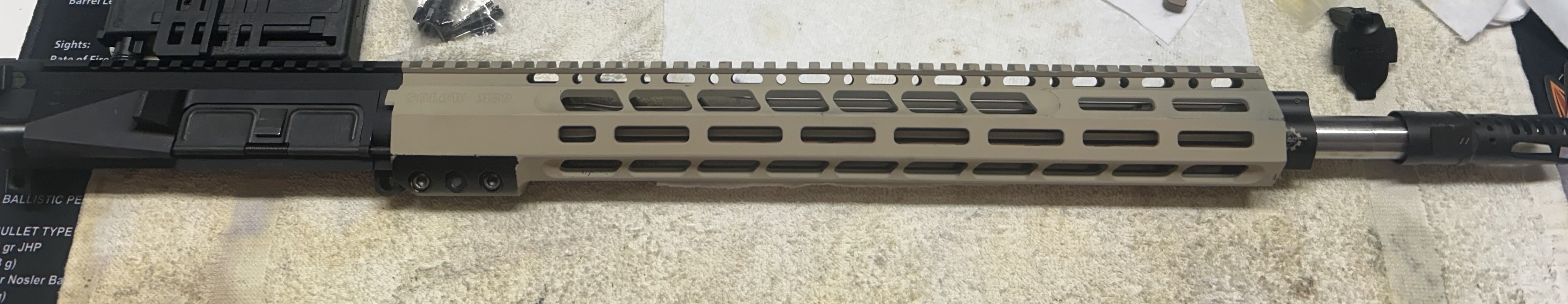

6 ARC Upper Build: 18” PVA Osprey (Rifle +2”) + San Tan Tactical Billet Upper + SOLGW M89 Rail
Hey man. I'm really going to need to go back through this thread and get caught up on what has changed, but am getting ready to start my weekly staff meeting.
Still, a good way to check to see if more gas will help would be to throw a good old fashioned baffle stack suppressor on it and see how it runs. A baffle stack suppressor will simulate more dwell time and increase back pressure. Just make sure you use one with an appropriate bore diameter. Not all 5.56 will do 6mm. Real gun guys are pretty helpful and most would be glad to let you take their can for a spin. If youre lucky, as I am, suppressors are pretty common at the range.
Thanks Tony. No worries, take your time catching up. I love your idea for using the suppressor but unfortunately I live in California so that’s not really an option.
TLDR version is it’s an 18 inch 6 arc barrel with rifle +2 gas system (.093” port) so it has pretty short amount of dwelltime already. I’ve tried shooting with different mags different, different bcg’s, checked gas tube/gasy key for obstructions, tried set screw & clamp on gas blocks, different uppers, different lube, etc. and never resolved failure to feed or failure to lock back and at best (factory ammo with clamp on block) have gotten intermittent ejection.
If any ideas pop into your head once you’ve had time to absorb the thread feel free to share them!

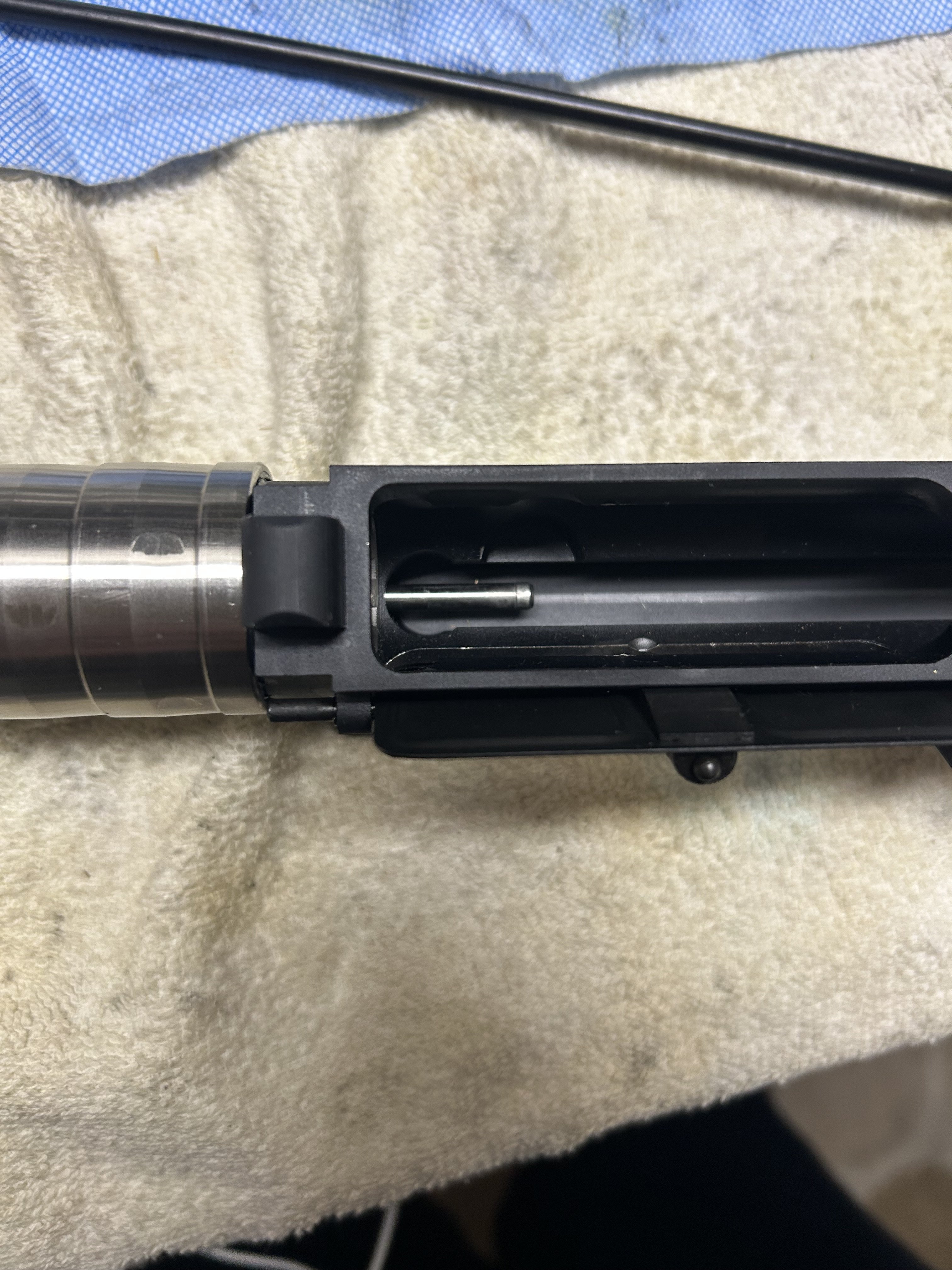

Also if this helps to see how everything fits together here is a pic of how far the tube protrudes into the receiver:
That looks right. It's probably Rainier that has an abomination of the 2" length & that barrel shipped with the tube.

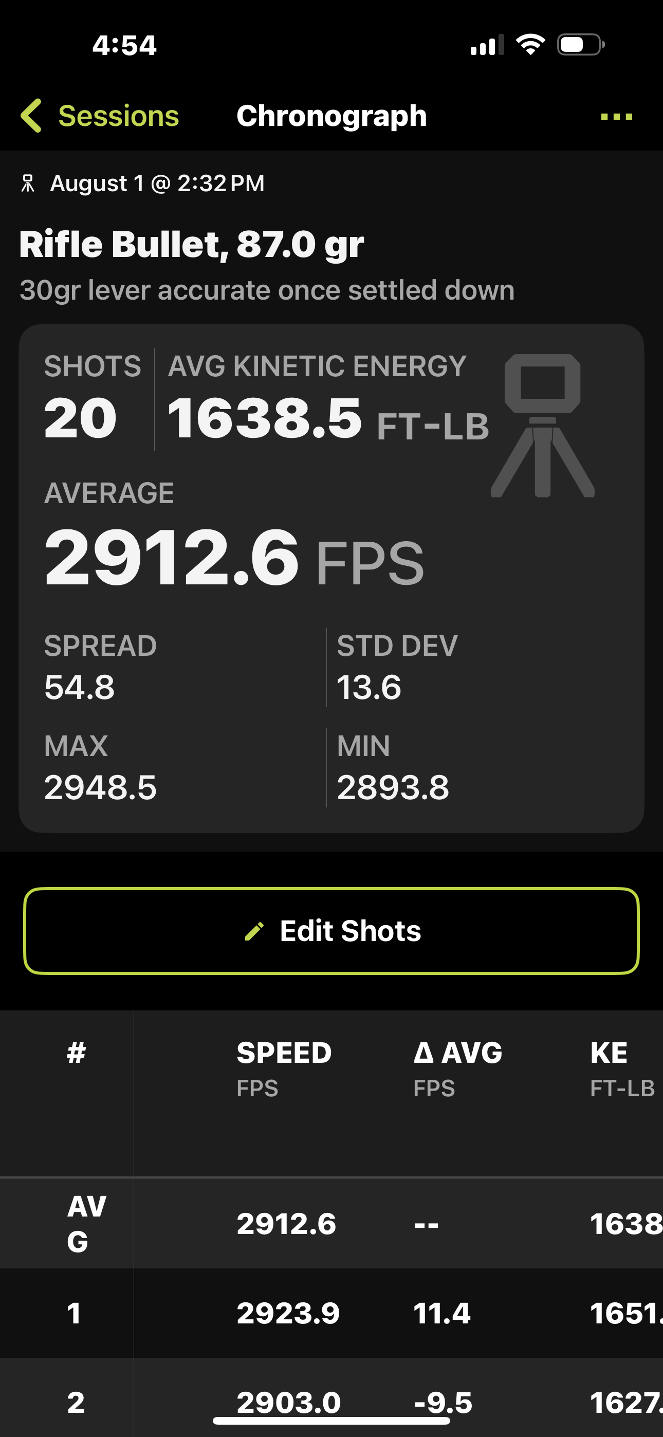

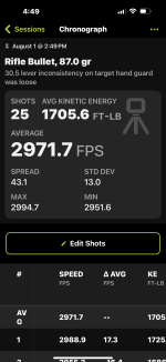

FWIW - My 6 ARC has always had a low mass carrier with std silent capture set up. I had to drill the Craddock port about .003" to get it not short stroking even with the low mass carrier.
Also Lever make a considerable amount more port pressure than any other powder I've tried. Still it needs to run with factory ammo.

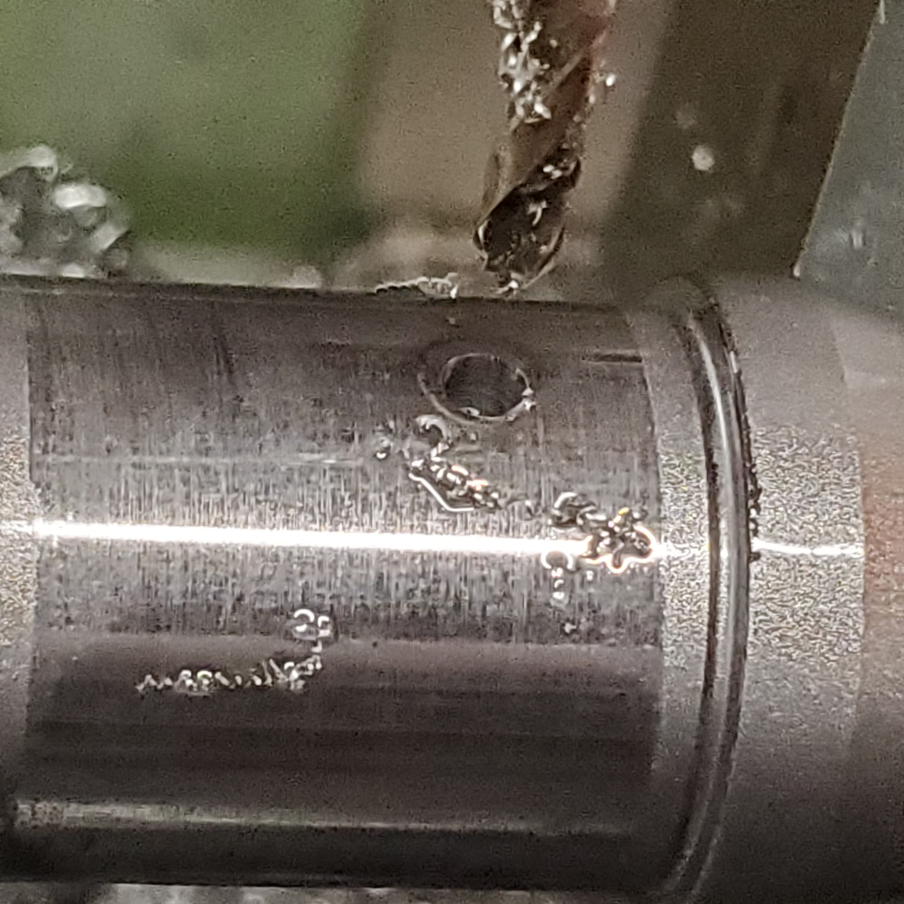

I can not recommend the hand drill for drilling out the gas port.
Those who made fun of that method are correct.
A drill press and good drill vice will get it done, along with a premium twist drill number set, quality premium dark cutting oil with lard and sulfur content for Pipe threading at Home Depot.
One way a machinist would do it, cause he has the precision tools.
I use a Bridgeport milling machine and precision ground Kurt milling machine vise, with Starrett V blocks.
Starrett level to get the barrel level, and use the upper reciever to get it perpendicular.
Set up for parallel and perpendicular drilling to the rifles bore.
When you are dead center of the barrel, (I use an edge finder, ) check the factory drilled hole to see if it's actually in the center of the barrel and perpendicular.
By running the orginial hole dia drill upside down in a quality collet, it should have no interference going through the original hole, binding in any direction as it is slightly smaller than the drilled hole.
You can set the depth with drill stops on a milling machine as well as most quality drill presses.
I use small collet set up to get the drill to run true, as many cheap drill chucks have a lot of runout.
Some are really bad, and need the next largest drill to cut off the swaged out metal in the bore and rifling.

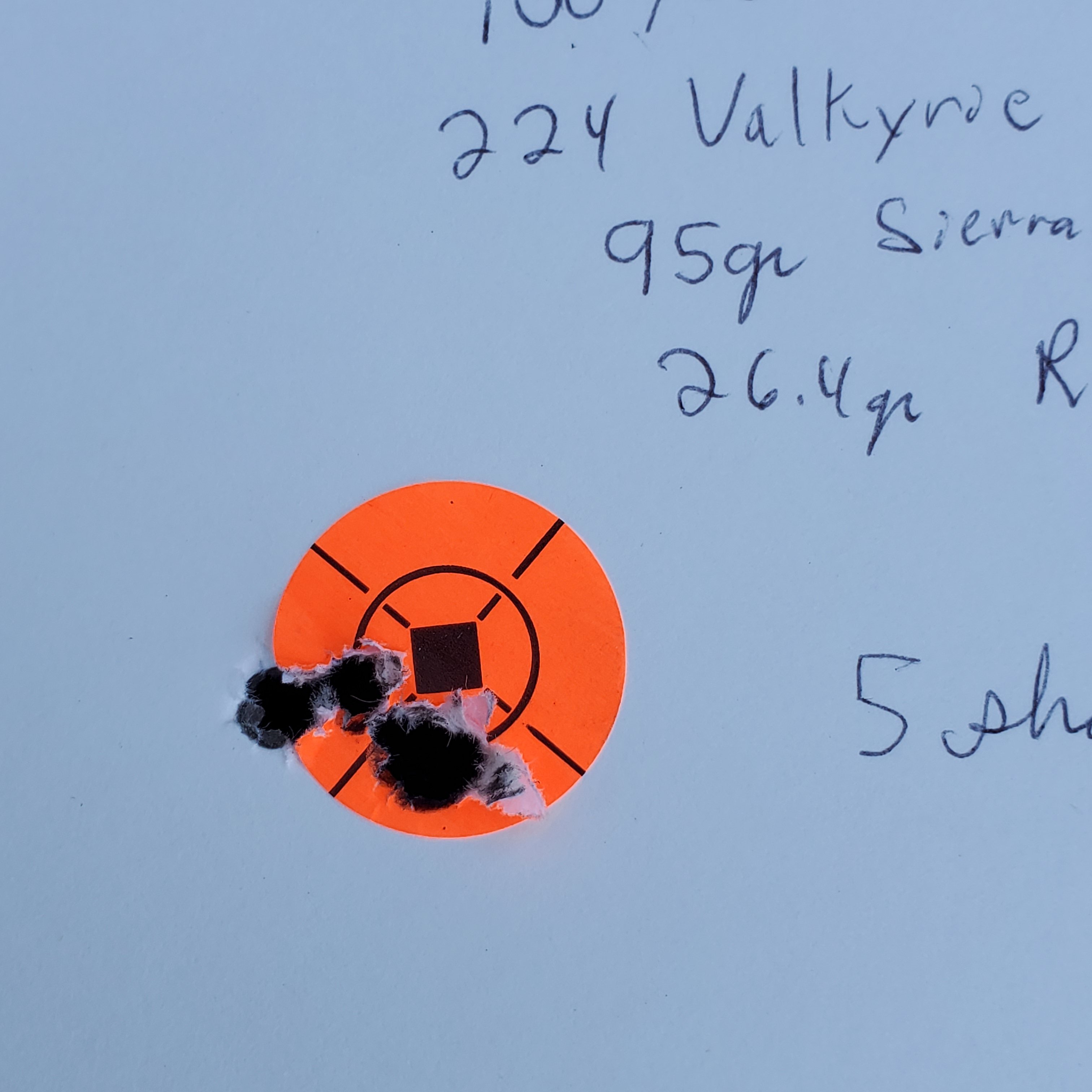

To smooth it all out like the center pic ya need to lap the area of the gas port.
Go aggressive with silicon carbide lapping compound in that area only for a bit then polish the bore in that area then blend out ..
Less toward the muzzle and never exit the muzzle.
So you end up with a slightly tighter bore toward the muzzle.
This barrel is now capable of 1/2" 5 shot groups, especially if ya do all the other accuracy enhancements.
The 224 Valkyrie was one of the hardest AR calibers to get to shoot good, but I didn't give up on it... now it shoots tiny groups.
Sometimes it's surprising what makes an AR work well...going back and centering the bolt carrier did the trick, along with the taper polished bore, squaring the reciever, glue in, etc....and no muzzle device, no threaded muzzle. It's a heavy AR in 224 cal, no muzzle device needed.
It's your rifle... do with it what ya want, and how ya want.
This is what I do for good results, use any part of it ya want, or discard the whole thing.
Maybe it'll help someone in some way....like...

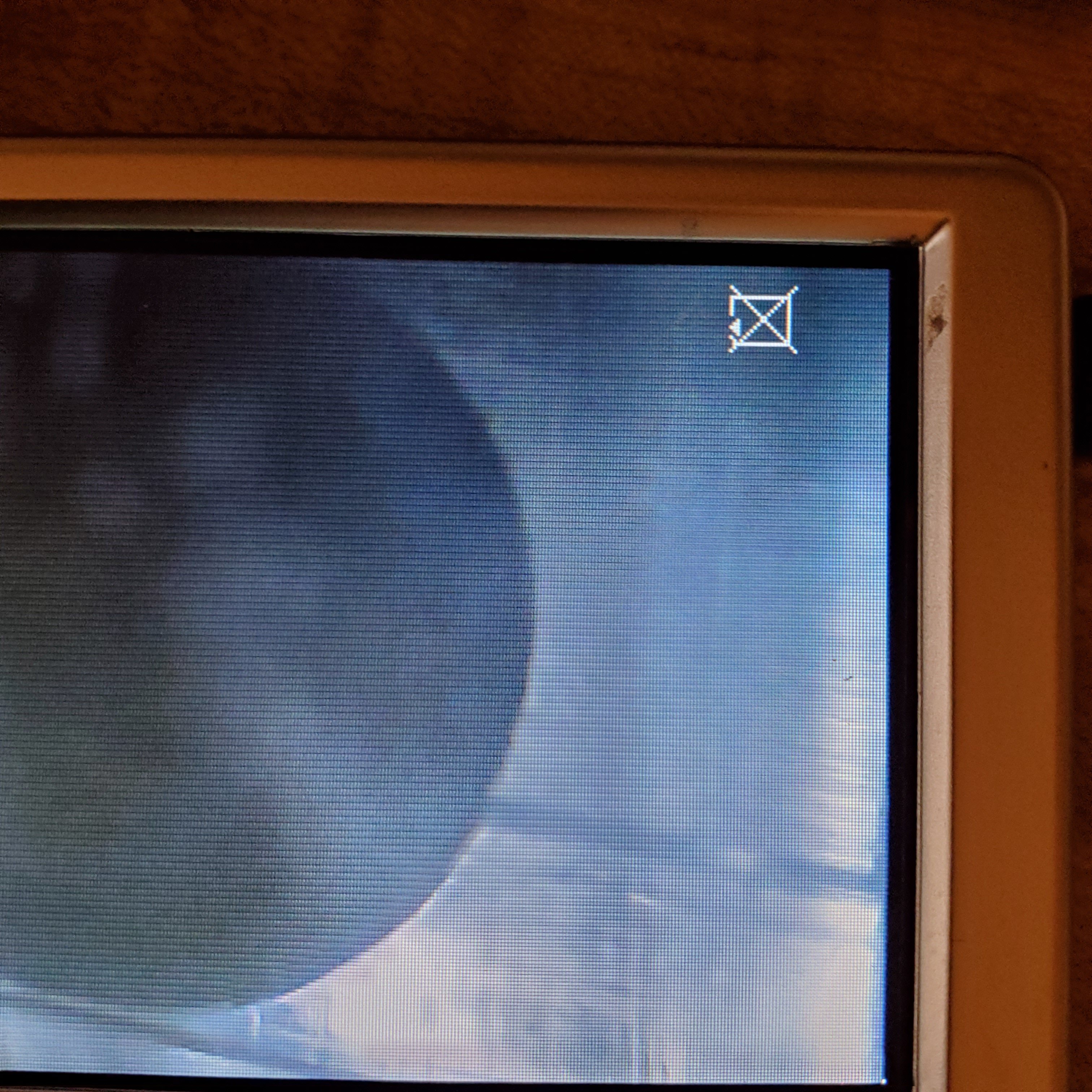

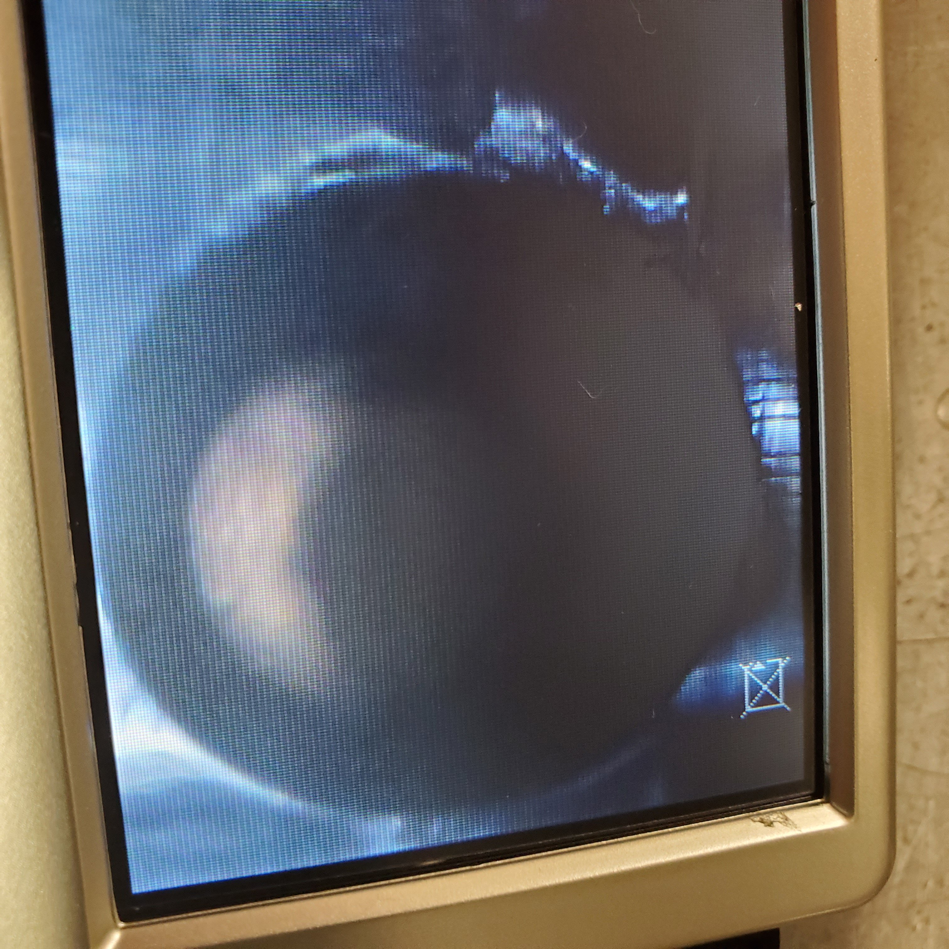

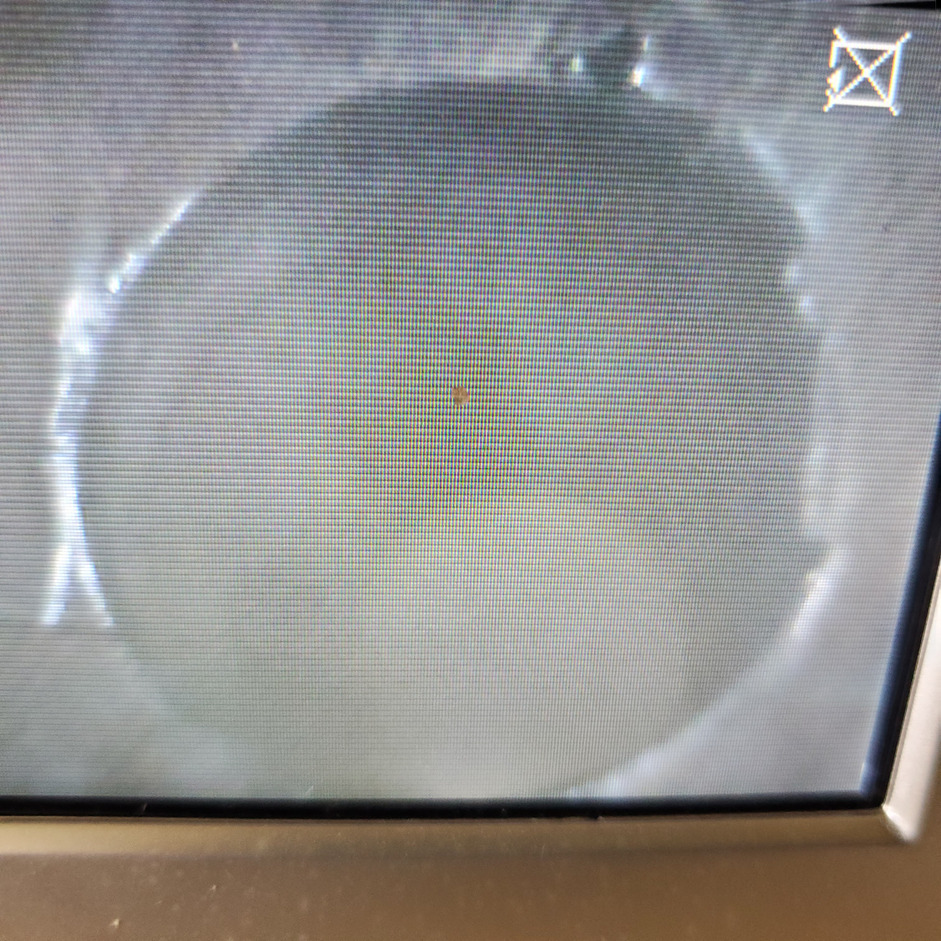

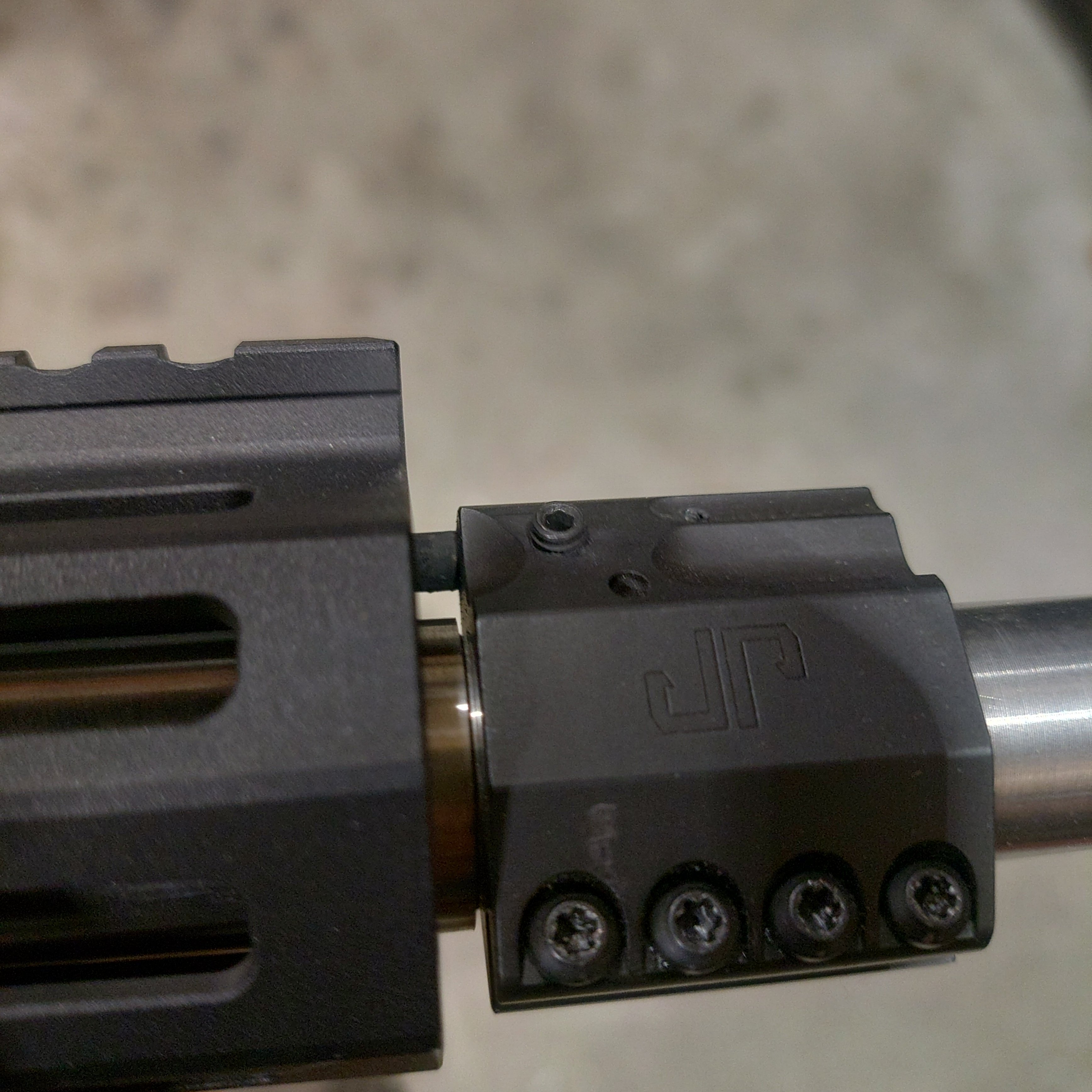

Maybe I missed it but are you certain your gas block and the gas port are lined up properly?
The JP on my barrel is slightly off the barrel shoulder to get it lined up.
Yeah I verified gas port alignment with a borescope for both the set screw and clamp on gas blocks when I tried them. For both of them it didn’t matter whether I was on the shoulder or not bc the hole in the gas block was big enough for full coverage either way.
Reactions: flogxal and dk17hmr
The gas block does not always butt up against the shoulder.
SA adjustable gas block instructions state a .025" feeler gauge between the gas block shoulder on the barrel and the gas block itself, when tightening in place....be sure to read manufacturers instructions. Then check with borescope.

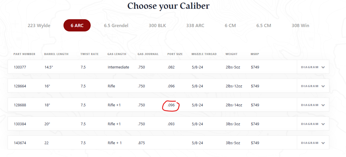

I’m far from a guru like the rest of these guys, however my Proof 18” rifle length + 1 has performed flawlessly
Thanks for the feedback. Looks like proof is using .096” gas port on their 18” rifle +1 barrels. Would you consider your barrel to be over gassed, under, or just right?
My 18” rifle +2 is using a 0.093” port so that might explain the short stroking. From my research there are a few other barrels (odin and maybe faxon) that are 6 arc 18” +2 systems and their gas ports are all well over .100” (but they might be over gassed for all I know). The proof barrel port sizes seem to offer a good baseline/reference point to compare to though as they are generally not considered over gassed from what I’ve heard. So extrapolating from there, a 18” rifle +2 (less dwell time than a +1 system) would need to have a bigger port size than the +1 (.096”), something closer to .098” or .100” is my guess.

Josh at PVA responded to my email this morning and we are working through a solution. I'm likely going to send the barrel in for some slight tweaks or I can just try running it with a reduced power spring/LMOS.
Thanks for the suggestions Tony. It's definitely hard to troubleshoot something as complicated as AR gassing issues via a forum thread haha.

I just got the barrel back today from the guys at PVA and everything looks good. They re-torqued the barrel extension to ensure the gas port was top dead center and also were able to drill out the gas port a little from 0.093" to about 0.099".
I will treat this like a brand new barrel and re-check headspace, clean the bore/chamber, etc. and update the thread once I get everything put back together. Then I will re-test cycling with the factory 108 eld-m's and maybe some handloads if the factory loads cycle ok.
Thanks @bohem for the quick turnaround and taking the time to drill the port out a little for me, it's much appreciated!
Good deal. Looks like he went up 2 wire sizes. That should leave you a bit of headroom too.

Based on what has been posted. Open the gas port to .110 from .099 and use an adjustable gas block. I like some head room for gas.

One other thing I noticed recently was the San Tan billet upper’s ejection port size is slightly smaller than all my other uppers which obviously isn’t ideal for 6 ARC cases. I don’t think its causing my issues (cases are able to eject fine now with the gas port opened up a bit) it’s more of an annoyance bc I can’t use my chamber chiller on it so im tempted to switch to an entirely new upper receiver. If I do that I will also look at using a different +2 gas tube as @Kocher suggested.

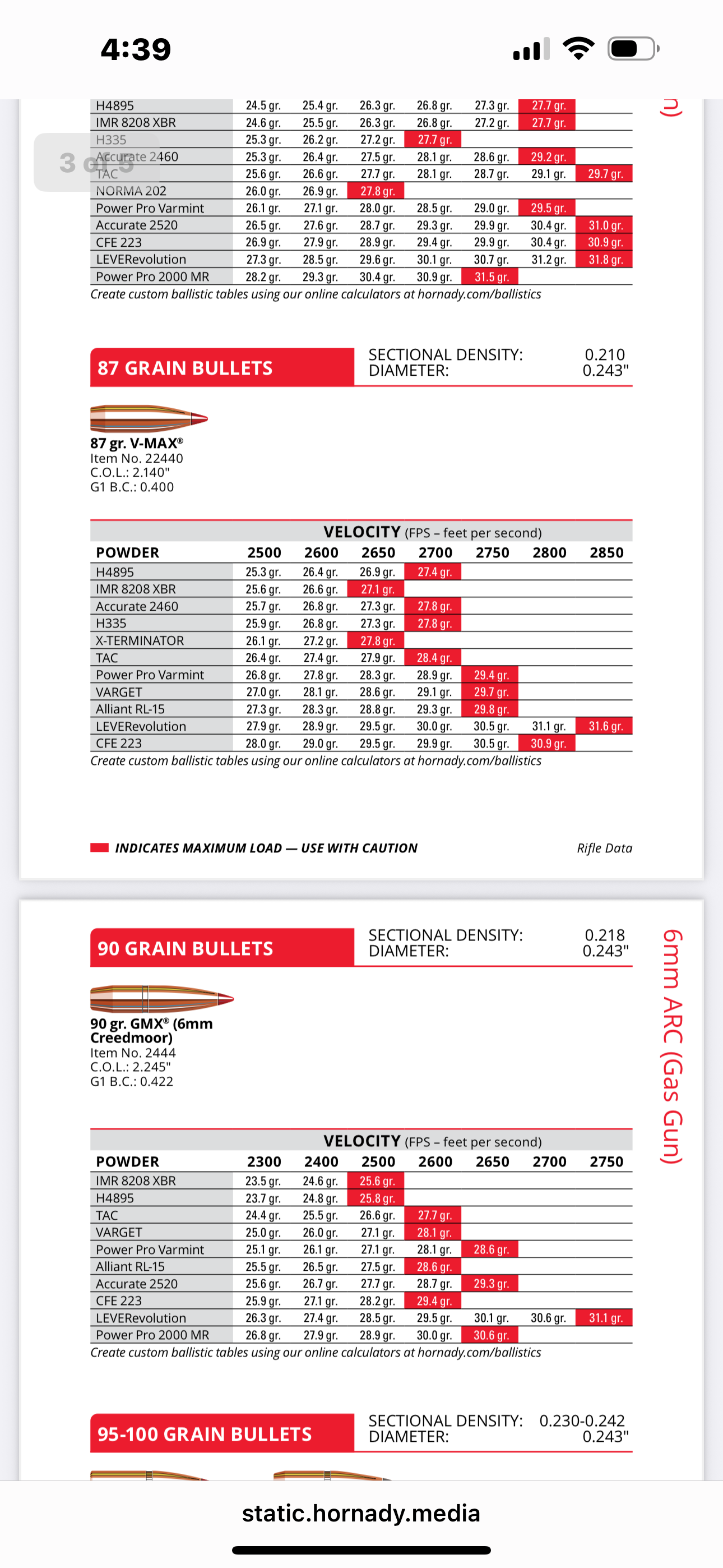

being other people have used the rifle set up and barrel I’m guessing it is worked for them otherwise especially if PVA couldn’t get their +2 Gas block to work they would not have set it up that way….

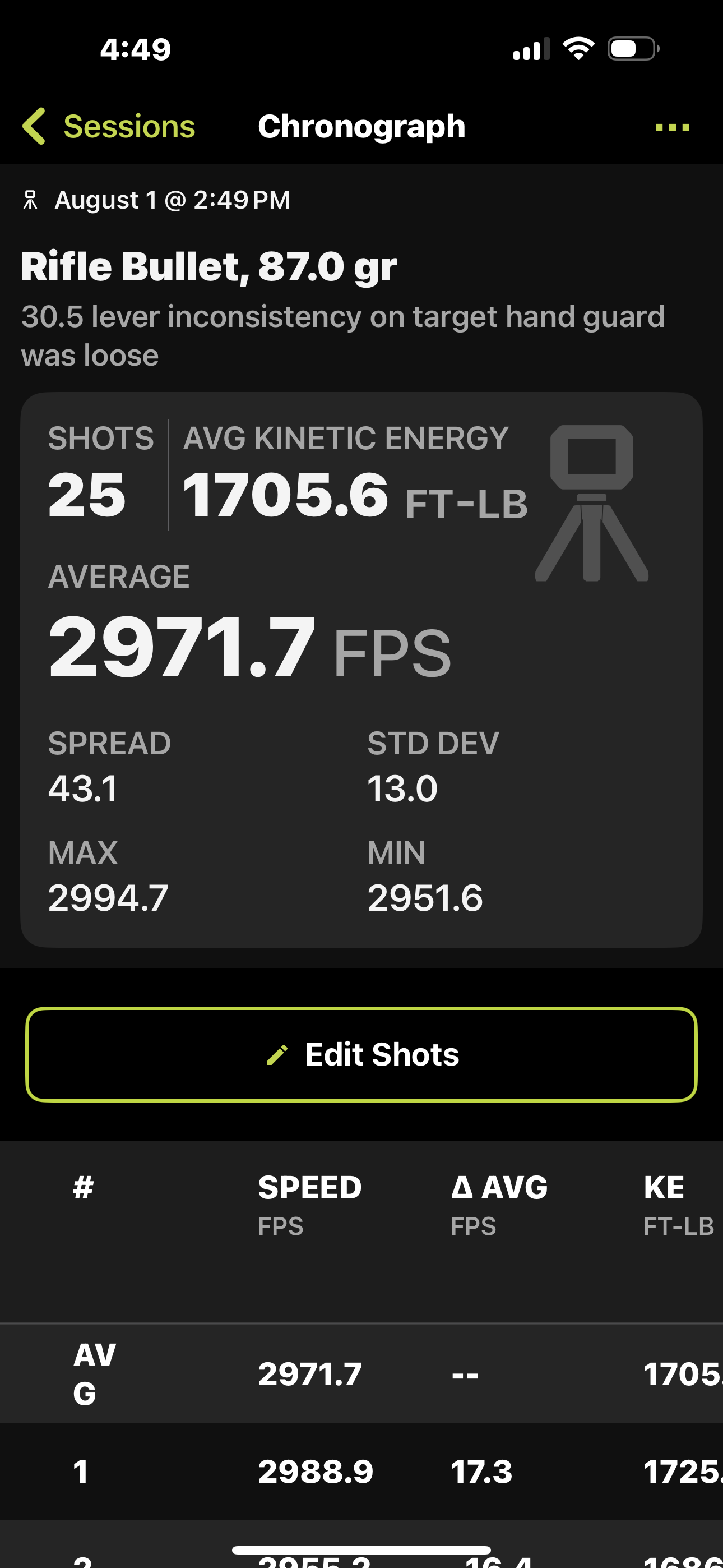

I have a 22 inch six ARC Cradock w/a+1 rifle gas block.
I can’t remember if it was Varget or shooters world precision powder .. the gas block fully open..Not overgassed ... I don’t believe it was very stout loads though. .. otherwise everything runs just fine with the standard powders.
Leverlution= gives me max speed with under max charge for a gas gun. I am using Starling brass and I believe Hornady gives more volume in their cases so maybe it is considered a max charge for Starline brass? Definitely gives plenty of gas to run the system.
30-30.5 gr leverlution and 87grVMax. Gives approximately 13 STD and 2912-2971fps using a Lee perfect powder measure 25$…
According to Hornady, it says I should only get 2700 ft./s. Their max load is 31.6 gr Leverlution
And that USA 2850 fps…
It is very possible, though that I had the bullets too close to the lands and that’s where the extra speed came from so I have to double check things.. primers look like they were light loads so don’t know what to say. I guess it’s a fast barrel… the primers looked like when shooting a 223 light rifle load…
( I use the expensive Canada electronic powder measure for the stick powders..)
I don’t remember.. the loads that you did load up where they close to max for those powders? I’ve not run a A2520 power pro 2000 Mr or N140..?? So I don’t know what the charges would look like…
I’ve been there with AR 15 chambered in 17Rem. running IMR 4198 = works great for bolt action, but not enough gas to cycle in an AR15 gas gun..started switching everything around and couldn’t get it to work. Switch to CFE 223 and Vaget and no more issues.
I hope you get it sorted ! AR 15s can be a bit of a PITA… after all, we’re shooting calibers that were not designed to shoot in a AR15!

Looks like Hornyday (copy the best ideas and take all money away from the little guy who came up with the original great idea on the first place and copy their equipment and then make statements “like nobody else has anything like this we’re original idea”) included the 87 grain Vmax with their load data as it was not previously in the book when I purchased their latest edition for reloading.
Go look at the YouTube page from Buffalo boar ammunition, he explains HornyDay’s business model quite well.
