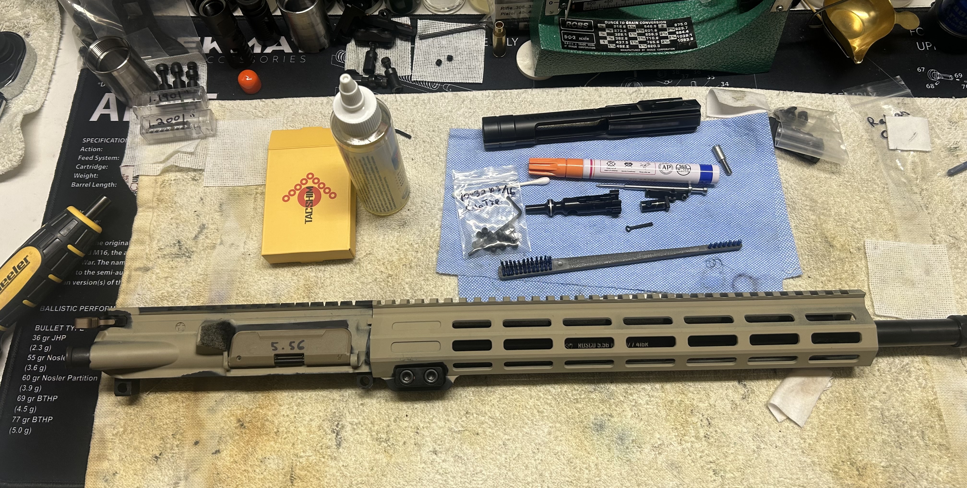

The use case for this build is a low cost shorter length SPR made with some parts that I already had on hand except for the barrel and gas block.

Build steps:
Part 1:
  1. When the barrel arrives clean the chamber and bore with 91% Isopropyl alcohol then take measurements for weight, gas port size, gas block journal, and barrel extension
  2. If you have a borescope, inspect the barrel and take pics/videos to document the initial state of the barrel. If you do see something like weird coloration, damage on the lands/grooves/crown/etc. still try shooting the barrel. If it doesn’t shoot and you think it’s from a documented defect you can always send the barrel back in to the manufacturer
  3. Using a 1.4636” min headspace gauge and 1.4736” field gauge make sure the chamber is within min/max headspace specs by checking if a fully stripped bolt will close/twist on the gauges
  4. If multiple stripped uppers are available find the one with the tightest fit on the barrel extension (I prefer thermofits)
    Part 2:
  5. Once the upper is selected (if needed) install the dust cover and forward assist
    Part 3:
  6. Clean the barrel nut threads, inside of upper, and barrel extension with some alcohol to remove any debris, etc. before installing the barrel into the upper
  7. If building an accurized upper that’s not thermofit apply Loctite 620 to barrel extension then slide it into the upper (optional: apply a little aeroshell to the barrel nut threads to protect them from the loctite)
  8. If thermofit, heat upper threads with heat gun on high for about 2 to 2.5 mins then quickly slide the barrel into the upper making sure it fully seats. Wipe any excess loctite from the barrel nut threads and inside upper near barrel extension
  9. Allow upper to cool (note the loctite needs 24 hours to cure before shooting)
    Part 4:
  10. Before torquing the barrel nut down examine the area where the barrel extension feed ramps match up with the feed ramps in the upper. Use a toothpick, etc. to see if there is any snag when going towards the barrel, if so use a file to smooth it out
  11. Apply aeroshell 64 assembly grease to the barrel nut threads and shoulder of barrel extension
  12. With upper secured internally by the lugs with Midwest Upper Receiver Rod, Magpul Bev Block, etc. season the barrel nut threads by tightening close to torque spec and loosening a few times then torque barrel nut based on handguard manufacturer’s specifications (KAK says 35-55 ft-lbs, I use upper end)
  13. Attach gas tube to gas block using Midwest Industries lower receiver block and White Oak gas tube spiral roll pin with 5/64 punch
    Part 5:
  14. Attach gas block with cup tip set screws @ 15-20 in-lbs then verify gas port alignment w/ scope. After test fire replace cup tip screws with knurled tip screws and optional threadlocker (Loctite 246 or Rocksett) then make witness marks on screw heads
  15. With upper secured internally via the lugs, oil the muzzle threads and attach the muzzle device (torque to ~15 ft-lbs). Note if muzzle device will be used as a suppressor mount don’t put any oil and instead add a few drops of Rocksett to the muzzle threads before attaching muzzle device (let cure for 24 hours before use)

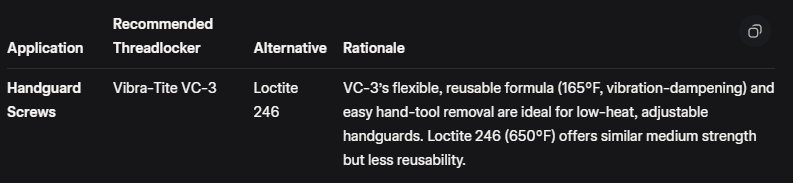

  16. Attach handguard by following manufacturers specs re: use of threadlockers, oil, etc. on handguard screws and torque specs. Witness mark each screw head (use Vibra-tite VC-3 or Loctite 246, KAK spec: alternatively tighten each screw until you get 45 in-lbs)
    Part 6:
  17. Before test firing check the following: gas tube is far enough inside of upper, carrier mates well with the gas tube (no hang ups or friction), m-lok screws aren’t touching the barrel or gas block, check bolt extractor rotation on pin, and check if firing pin has any friction sliding inside of bolt
  18. Attach upper to lower and do a full function check and test fire

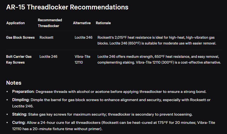

Threadlockers and grease:
Good point on degrease before threadlocker, any oil/grease tends to render the threadlocker useless. I've had fasteners come loose in other situations (mountain bike fasteners) where I'd missed some oily residue. Knew a guy who crewed in top fuel 1/4 mile who was obsessive about threadlocker prep with that big bomb of an engine!
