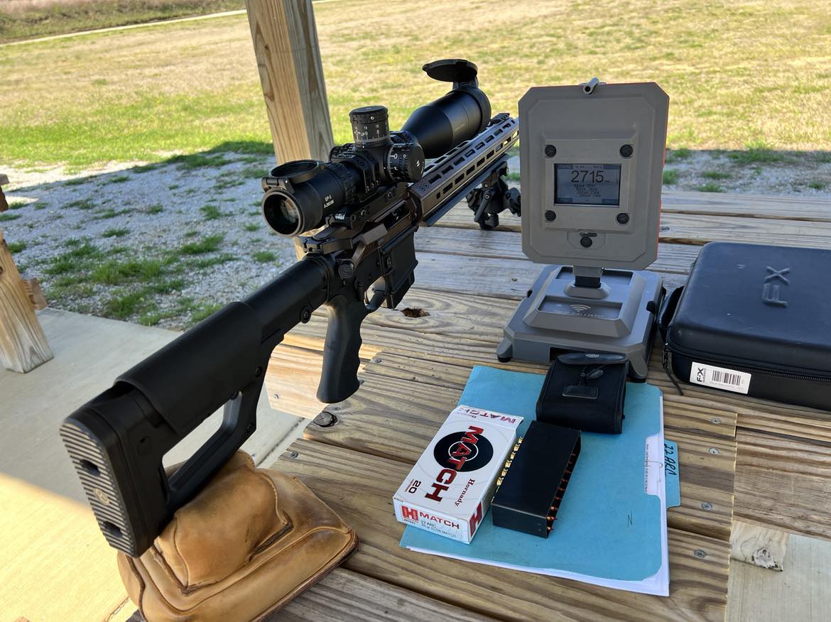

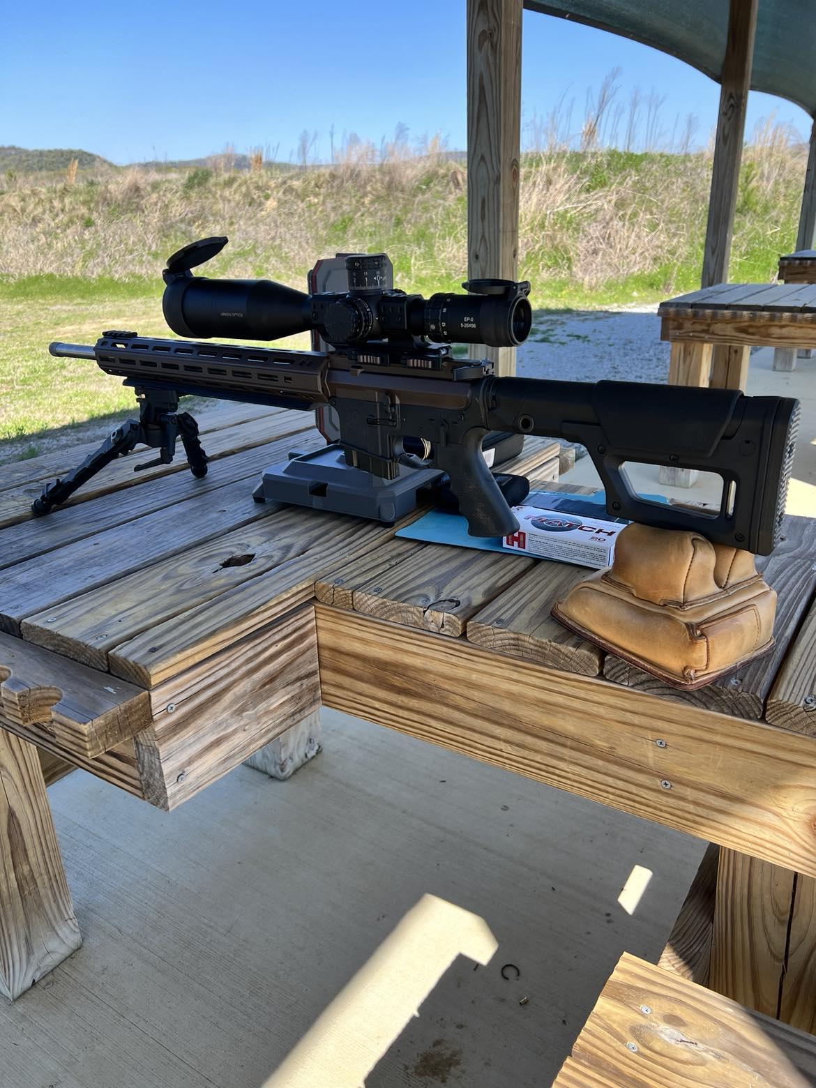

Finally got the Sgt of Arms barrel in. Went to the range to perform break-in procedures and sight in the scope.
Rifle Spec:
Aero Precision upper with 15” Enhanced M-Loc Hand Guard
Barrel: 20” 416 SS 5R rifling, 1-7 twist, +2 gas with Superlative Arms .750 Adjustable clamp on gas block. Head spaced Bolt included.
Tread protector (5/8x24) at present time debating on suppress it or not will determine what muzzle brake will be attached.
Anderson Lower with Strike Industries AR enhanced LPK.
Trigger: Velocity 3lb Drop-in Single Stag. (soon to be changed out to LaRue Tactical MBT S2 two stage trigger).
Hogue Grip
JP Enterprise Silent Captured Spring Gen 2 H2.
MAGPUL PRS Lite Stock.
Arken EP5 5-25x57 FFP Scope in SPUHR QDP-45-16 20.6 quick detach mount.
Round count: shooting two days: 85 rounds total (including 15 rounds of reloaded 52gr SMK HPBT).
