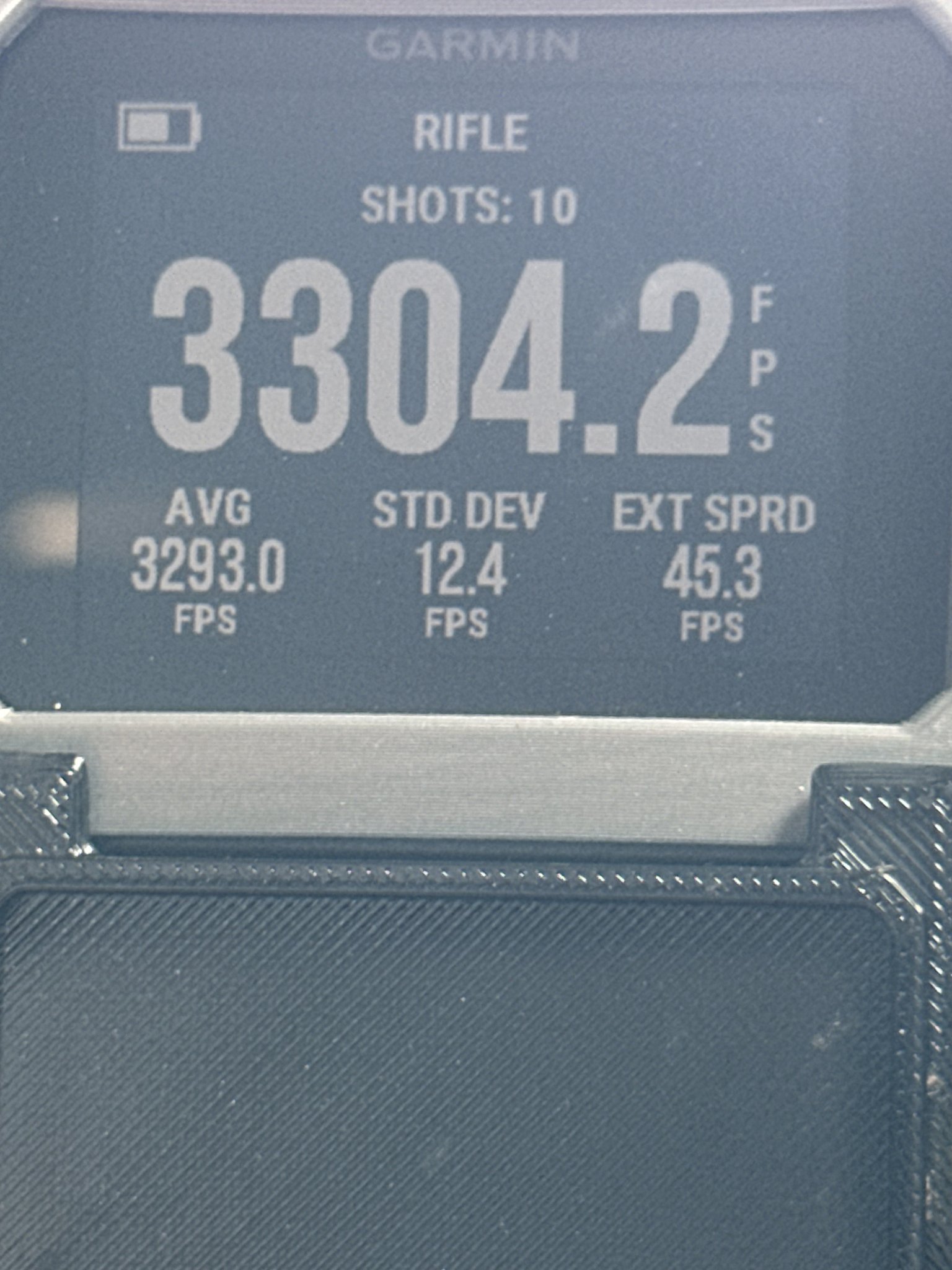

This is my 22 ARC with the factory 62vt ammo. I am loading with Accurate 2230 and started at 28.5g and worked up to 29.4. I think I'll hit 3300 fps at about 29.2g but looking for a consistent node.

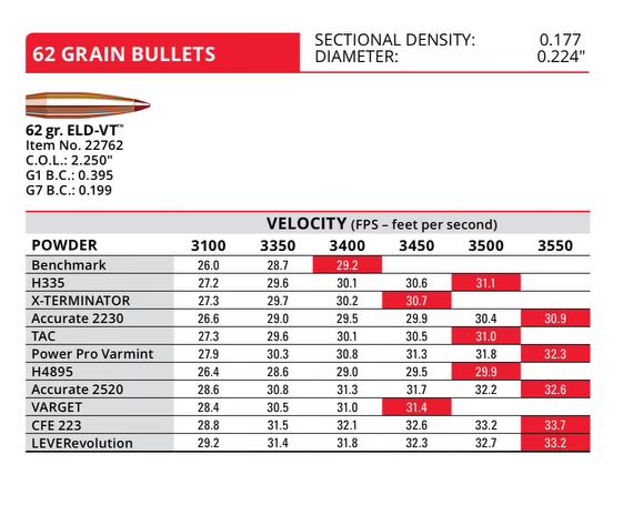

Also, with H4895 non-existent, has anyone tried IMR 4895?

CFE223 & Accurate 2230 is all I have tried as it was powders I already had.
I know 30.9 Grains of Accurate 2230 is *** MAX*** not a place to be although it does shoot flat as hell out to 600 with that charge and bucks the wind very well. I was noticing a heavy bolt lift and it did not have a comfortable recoil on a tripod.

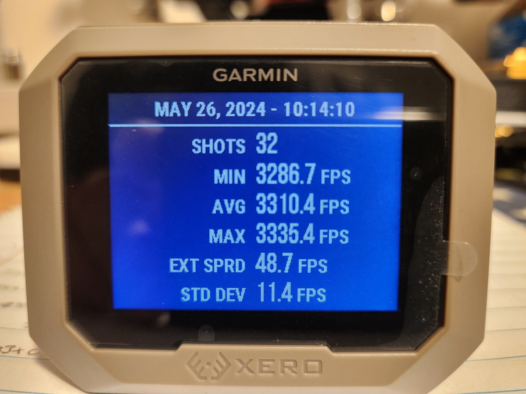

I did some final testing for me on my 62g load with Accurate 2230. This is a Predator & Deer rifle for me w/ predators being the primary. I wanted a soft load near 3300fps for tripod shooting.
The load felt good off of the tripod. It sounded good suppressed & that's all I truly need.
62g ELD-VT
Accurate 2230
Hornady 22-ARC Casings
CCI Primers
COAL 2.262
Average Velocity 3235
SD-7.2, ES-25

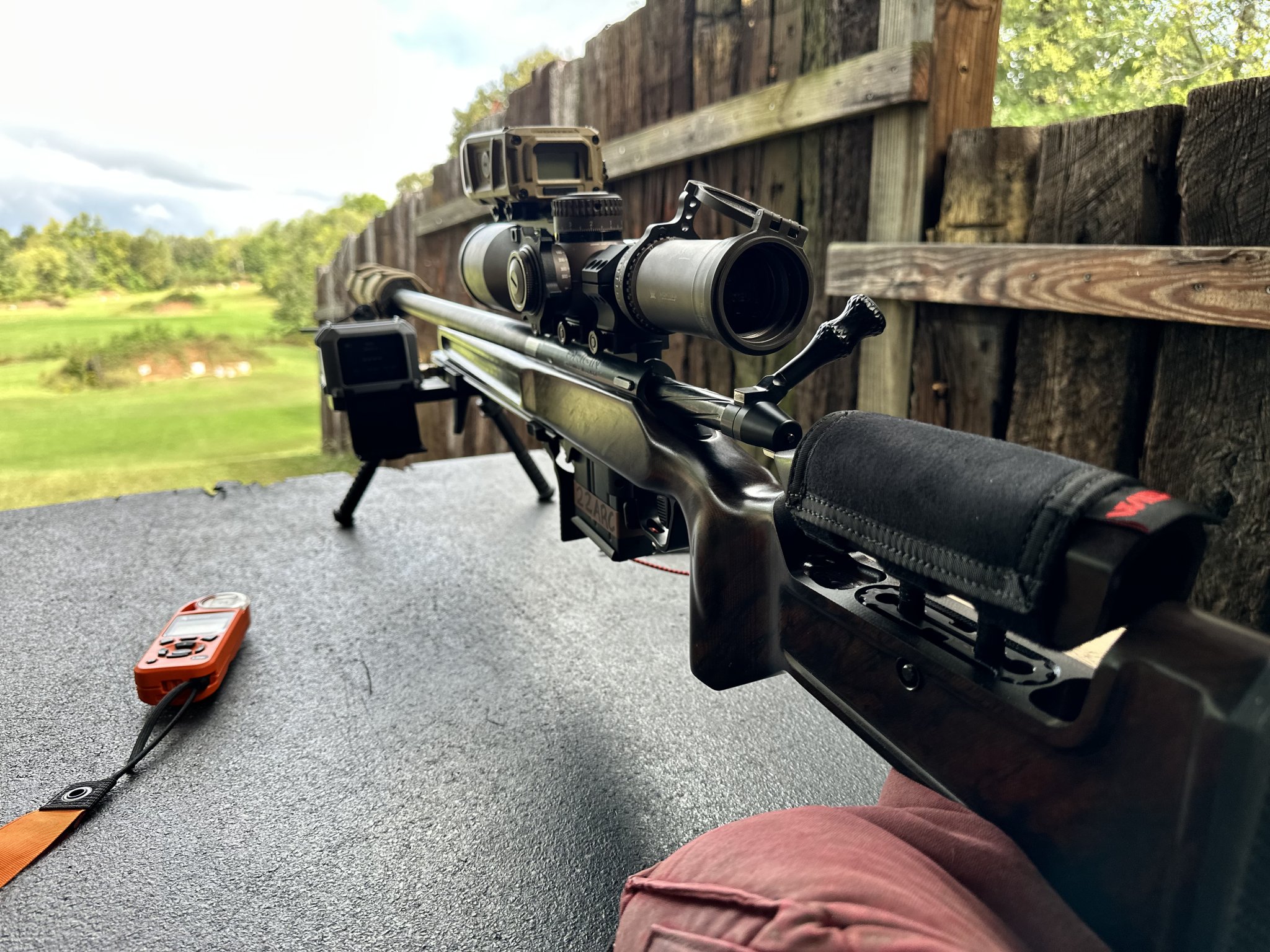

** Rifle **
Zermatt Origin Action w/ WTO Switch lug
Carbon6 22" 22-ARC barrel
Foundation Revelation Stock w/ MDT Bottom metal
Gen2 Razor w/ Impact 4000 on top.
** Work your load at your own risk. Dont trust my numbers even though I am WAY below max powder charge. **
