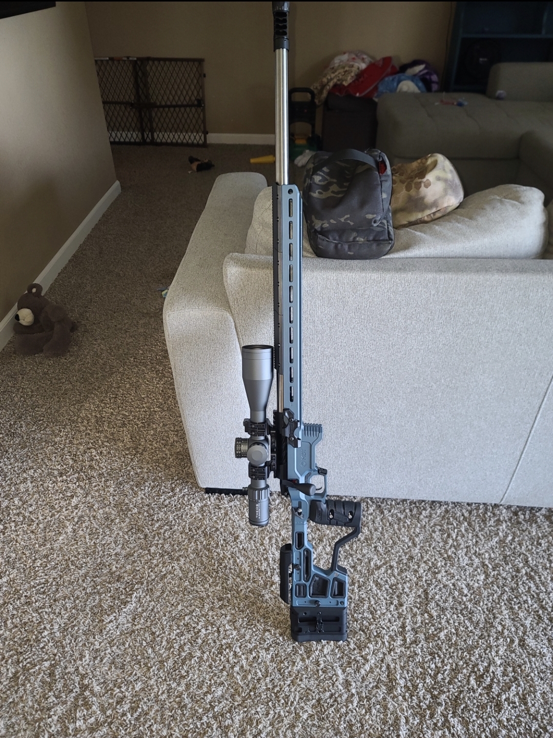

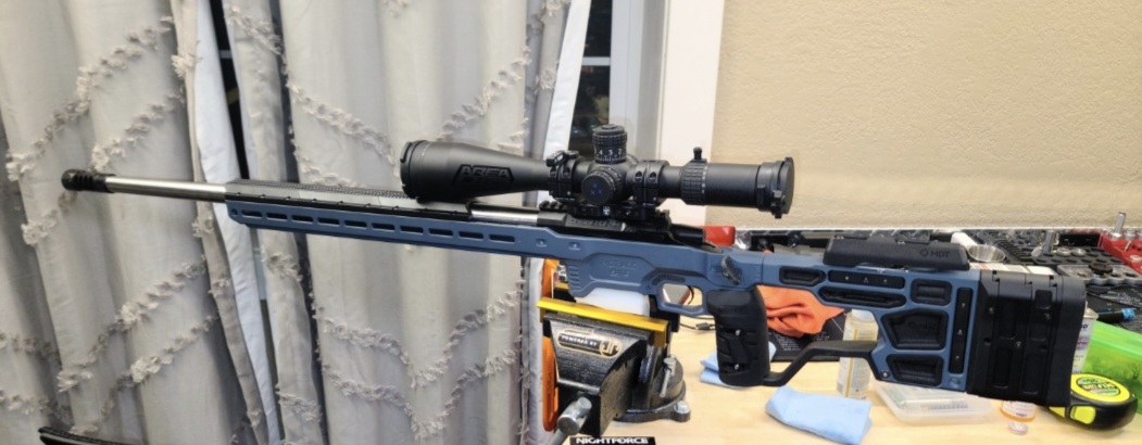

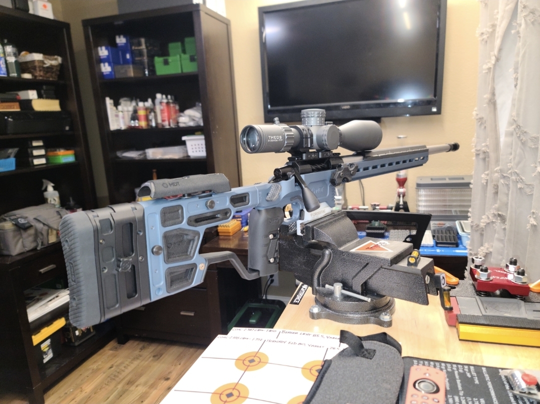

.22 BRA
Bat machine hammerhead and bartlein barrel all done and ready to go! Big thanks to blagg rifles for the 1 week turnaround time!
Finally my build project is complete!
Bat hammerhead action 22BRA
Bartlein MTU 7.5t 28"
Element Theos 6-36
MPA BA mount
MDT ACC Elite
TT Diamond Pro Curved
Accutac FC5
EcTuner Next Gen brake
Huge shout out to Blagg Rifles, Matt at 1791, TylerN, and SCR for helping me get everything I needed!
Element Theos 6-36
MPA BA mount
MDT ACC Elite
Accutac FC5

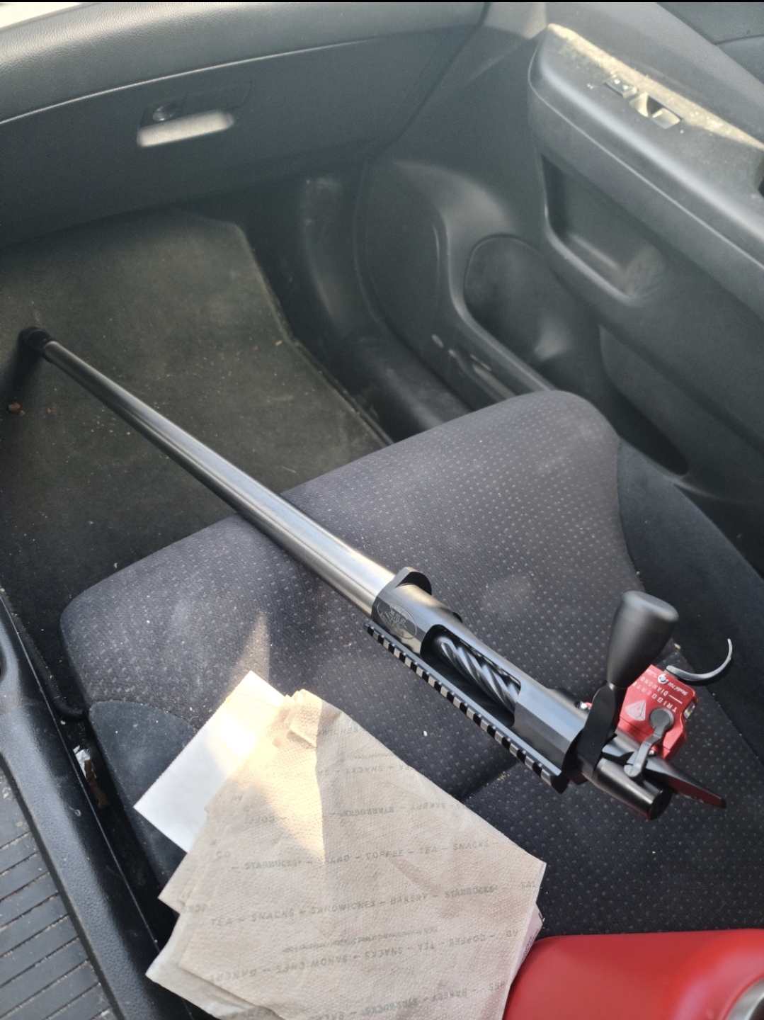

View attachment 8384242View attachment 8384243View attachment 8384244
Gotta report back now it shoots soon.

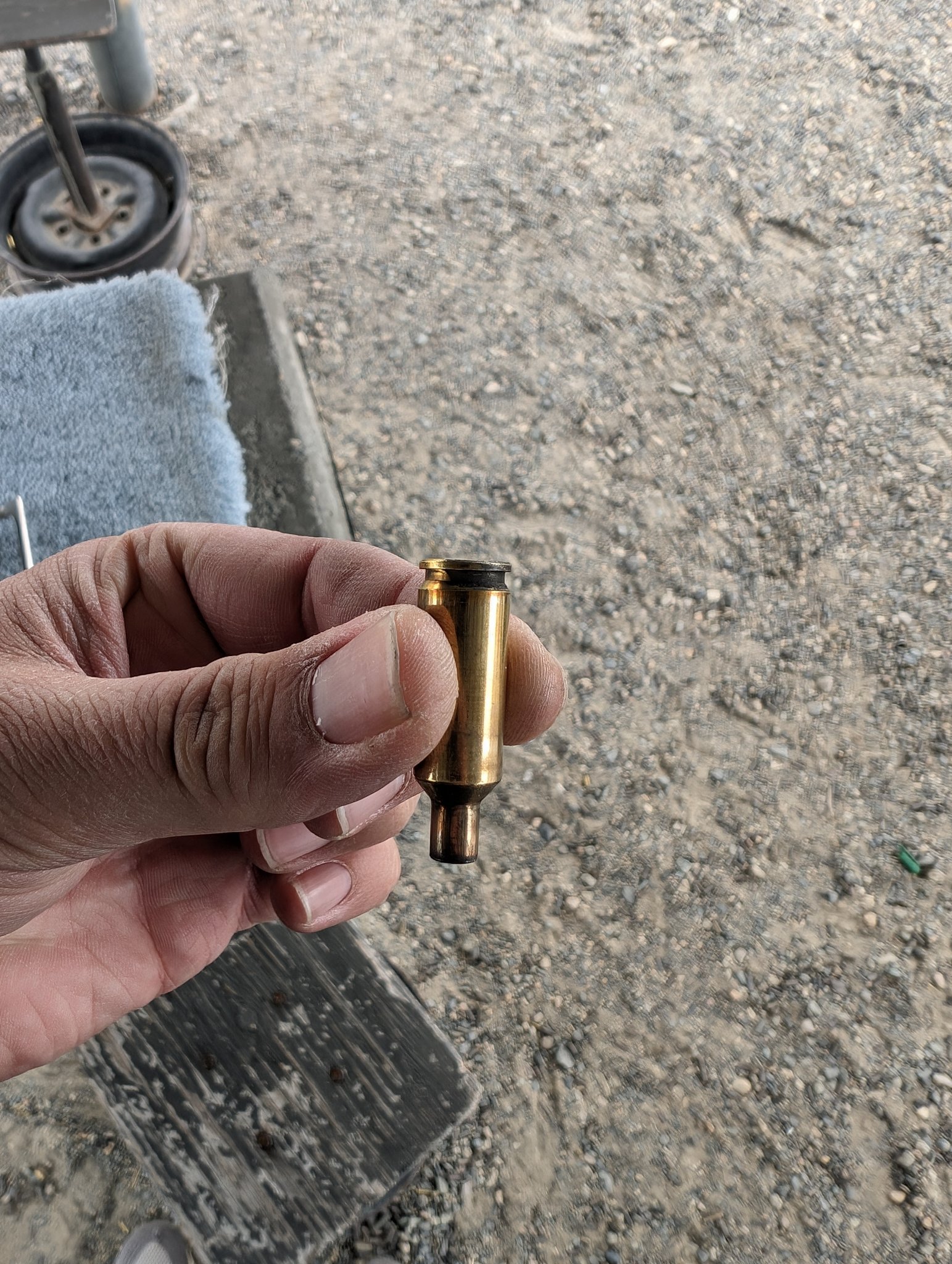

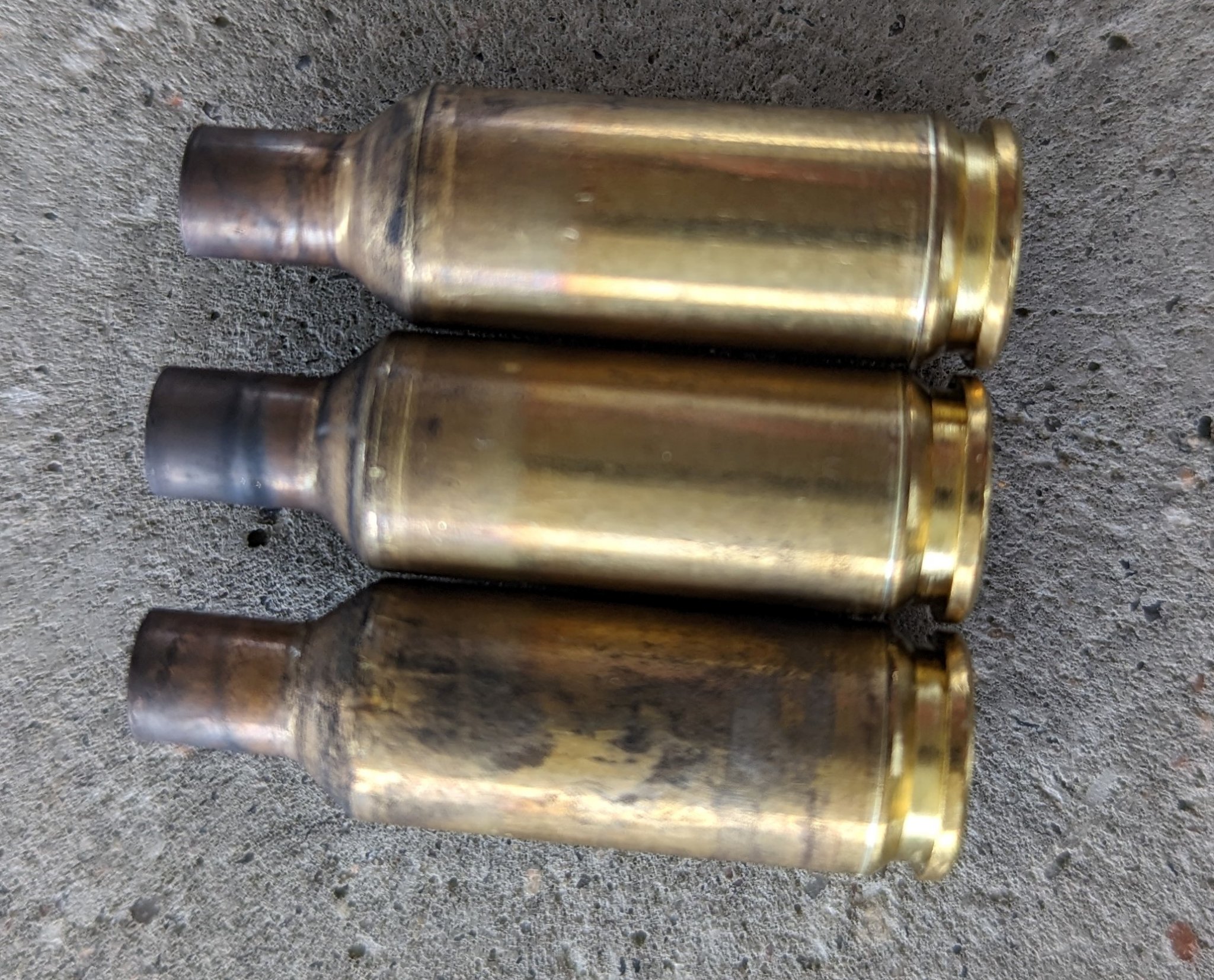

This alpha brass is weird. So on my SAC comparator for the 40 degree shoulder 22cal the go gauge measured 1.109. I created a false shoulder on the brass and it measured 1.116 so that it would maintain contact with the bolt face. Which is felt like it did and had a hard bolt close but idk about that method because if you do chamber one and then take it out (which I had to do because it wouldn't fire) and then measure it again and it measured 1.104. I think probably the best way to fireform this is to jam the bullet in the lands and pray it fires so I don't make a huge powder mess in my action. Also a fired piece of brass is now measured 1.115. It seems weird to me how a fired piece of brass is now measuring .006 longer then the go gauge. And trust me I checked the go gauge I couldn't get the bolt to close on the go gauge with a piece of tape on the head or with a standard 6br gauge which is .004 longer. Anybody else had issues like this with alpha bra brass?
I a really just got 2 boxes of Lapua BR brass. I'm curious Tyler when sizing down the lapua to 22 do you also leave a slight false shoulder to where it's like .004 longer headspace than the chamber?

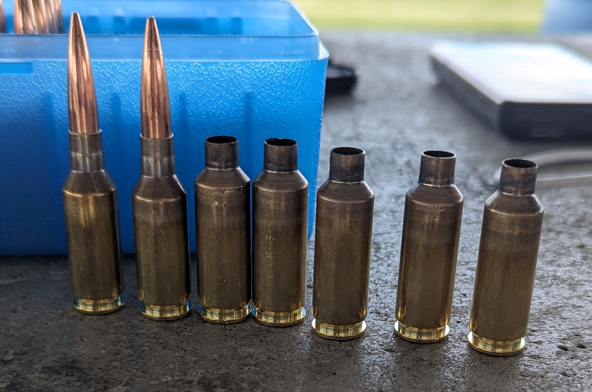

I didn't understand the 22 BRA reamer on my first batch of brass and I didn't leave a false shoulder. I incorrectly assumed fireforming 22 BRA was like fire forming 6 BRA where the neck-shoulder junction will already have a slight crush fit on the brass. So I fireformed my first brass all wrong and ended up stretching the base of the brass and having all sorts of pressure issues because of that. Here's an example of some of that brass I ruined, if you look at the base you can see a "belt" like a 300WM where the weakened base wall of the case is budging out with a charge that shouldn't be doing this.
Whoops... lesson learned. NFshooter150 knows where I went wrong here, but for everyone's benifit.... There is no standard 22 BRA reamer of course because it's a wildcat, but I think a common reamer design places the neck like this. First the original 30 degree shoulder of a 6 BR is projected down to the new 22 cal shoulder diameter, and this moves the start of the shoulder-neck junction forward. Then starting from that new-forward neck-shoulder junction the Ackley Improved 40 degree shoulder is drawn. The result is the shoulder is pushed out more compared to a 6 BR to 6 BRA fireforming. The key to fireforming the 22 BRA following this reamer design is to jam it or crush fit it good then fireform it out.
@NFshooter150, next time I fireform for my 22 BRA I'm going to crush fit the shoulder by not necking down the 6mm neck very far. I've had good success fireforming 6 Dasher from 6 BR this way. And I never measured with calipers how far out my false shoulder is from the new shoulder but it's a lot more than 0.004". I set this false shoulder distance by backing out my die 1 revolution. The result is a very forgiving false shoulder. Here's an example of 6 BR being fireformed out to 6 Dasher, expanded out with a 25 cal. mandrel, sizing die backed out 1 rev then resized to 6mm.
I'm going to follow that same process for 22 BRA once I get some new 6 BR brass, I'm watching out for Lapua to come back in stock.
So I went out today to fireform lapua br brass and had 75 of them and they ran flawlessly no pressure signs all of them formed out to headspace of 1.113. And just ran great I'll share the target pic but man I'm so much more pleased with lapua then I was the 6bra alpha brass. On the alpha I had 11 of them not fire and they ranged from 1.113 to 1.118. And had alot of pressure signs and everything.

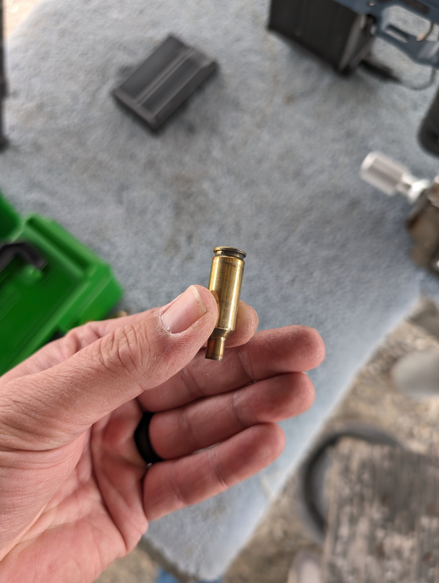

Hey guys so I'm having some issues that I can't seem to figure out.. so some shots that have been fired once and resized with the sac modular die are firing and the bolt lift is very light almost like nothing is in there.. then the cases have carbon down the case and all around usually have of the case head I will attach some pics. Thanks in advance

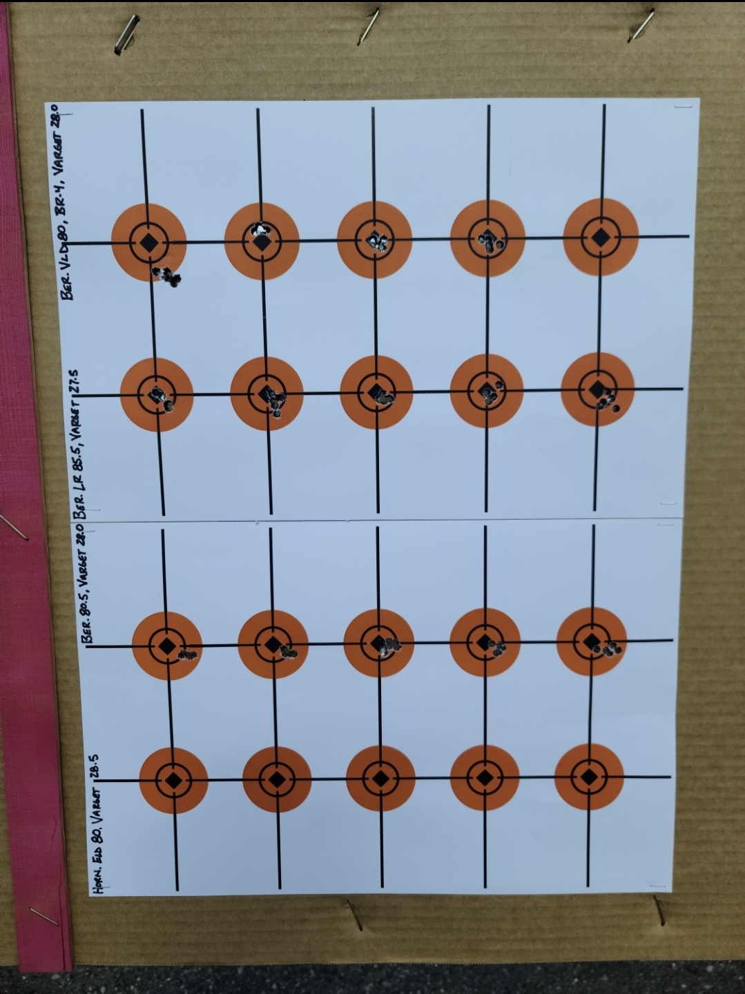

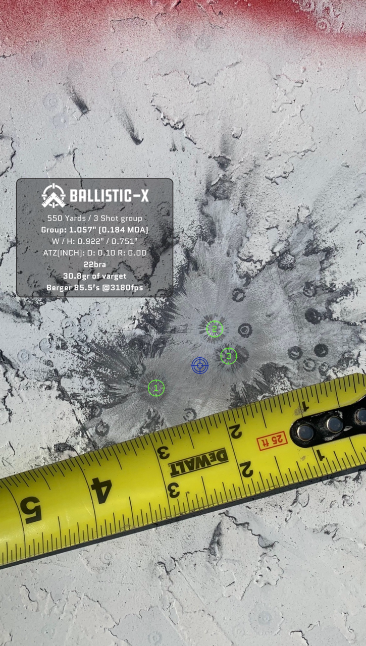

What kind of comps do you shoot your 22 BRA in and what are your thoughts ?
I love the 22BRA, I built a hunting purpose 22bra but have been strongly considering doing another barrel in a heavy steel pipe as well.
Im looking at testing a few more bullets over the next few months but ive been shooting 85.5’s at 3100-3130fps range for this past year.

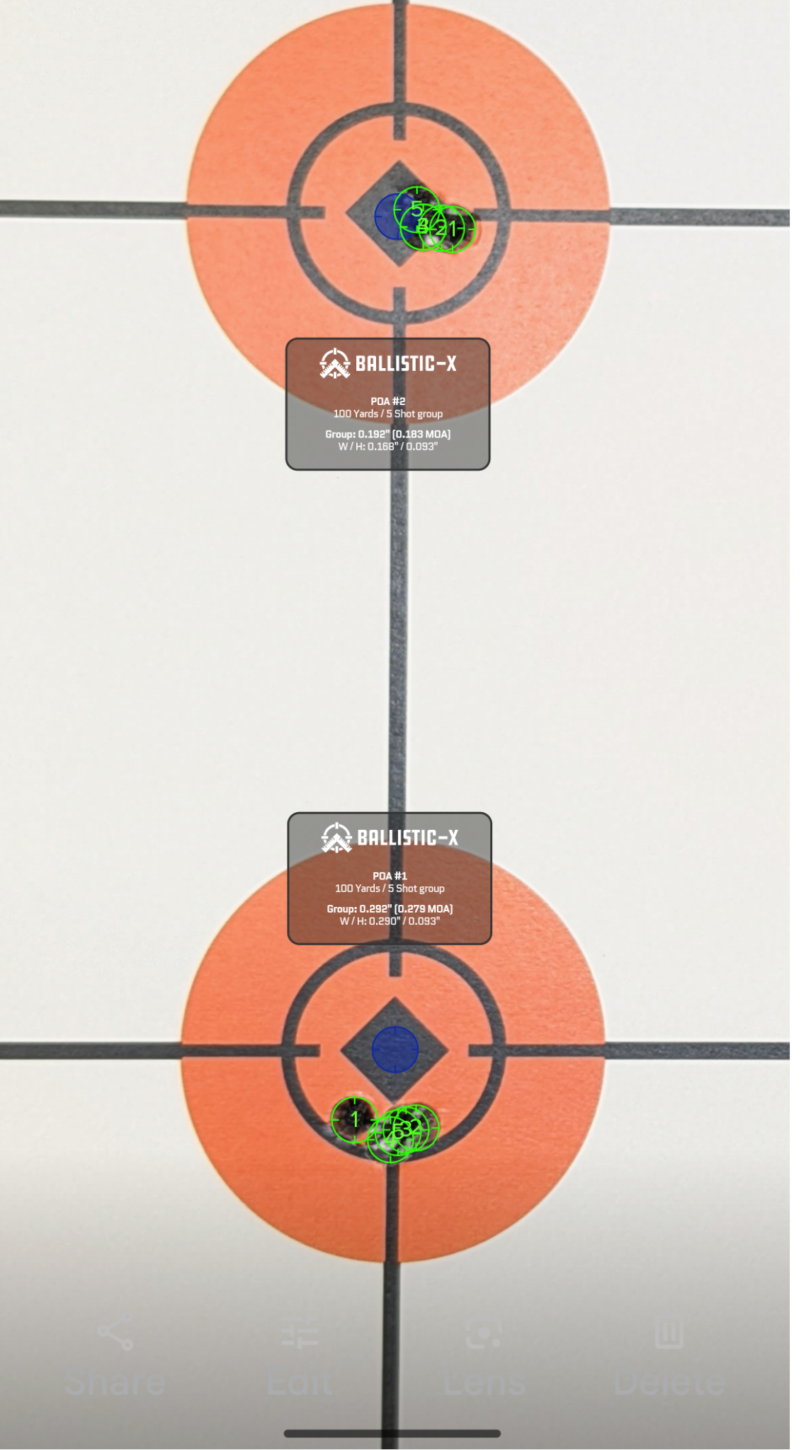

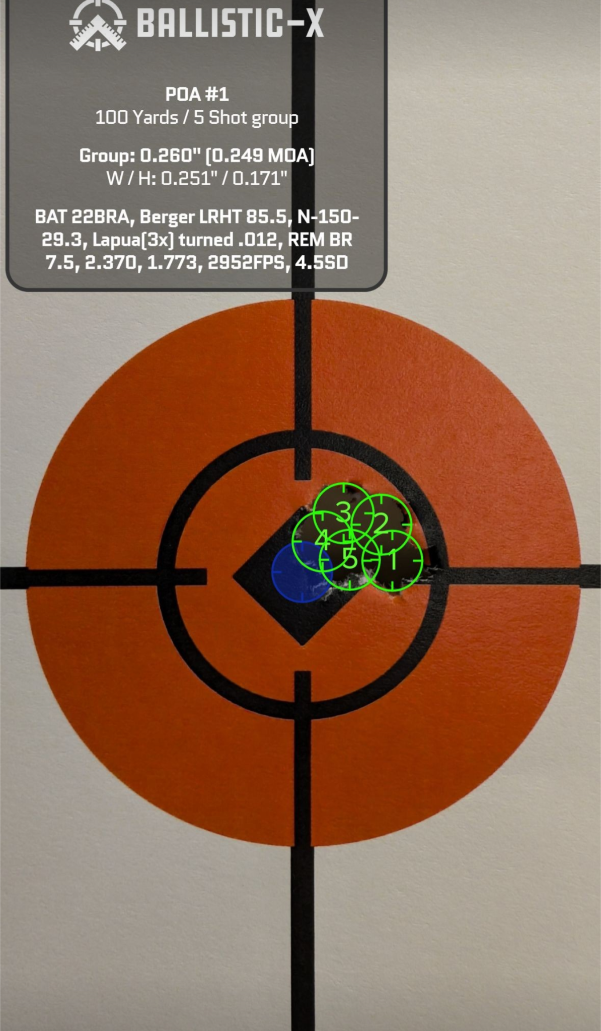

Ballistic-X-Export-2023-09-06 10:29:59.582560.png
Ballistic-X-Export-2023-06-29 19:07:32.581460.png

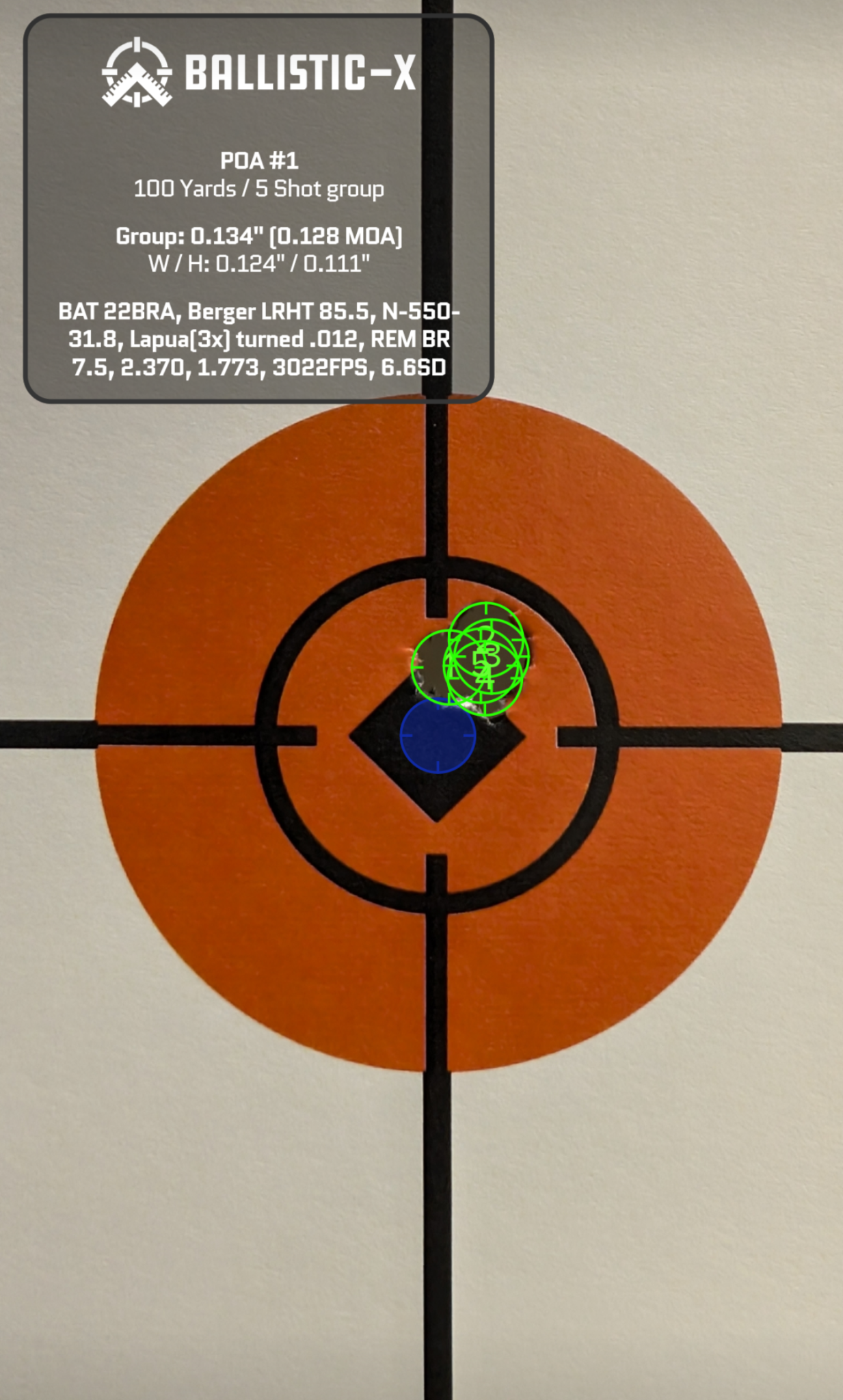

I shot ladders with alpha 6br brass, necked down and formed to 22bra with 85.5’s with n140, n150, varget and 8208 xbr. I ran the 85.5’s from 2935fps up too 3309 fps in the different ladders.

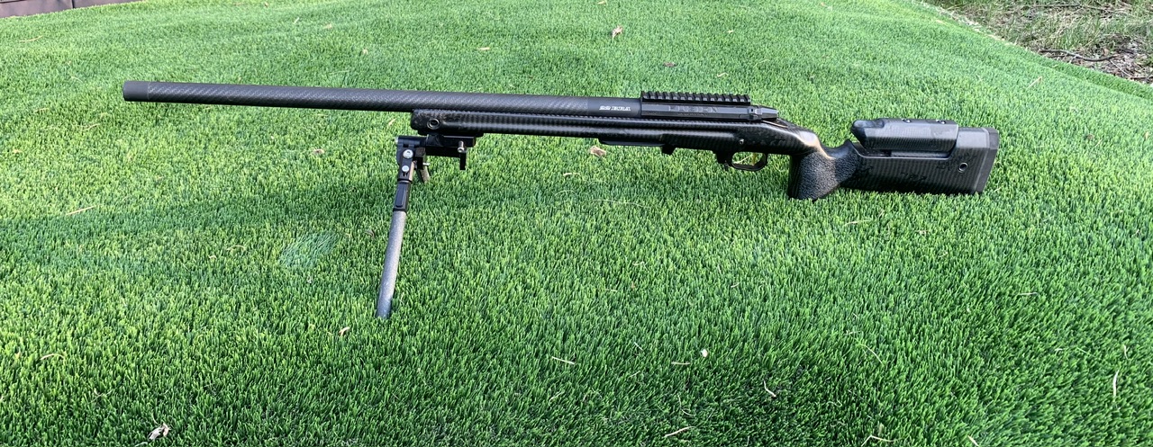

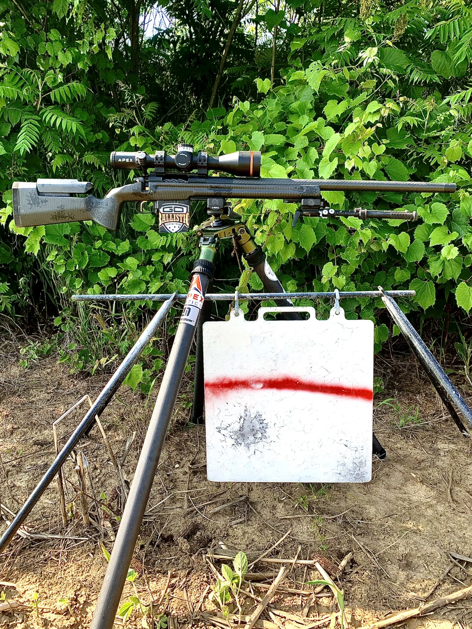

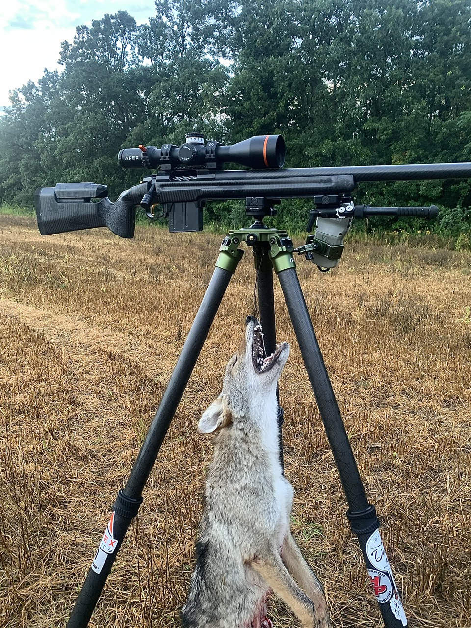

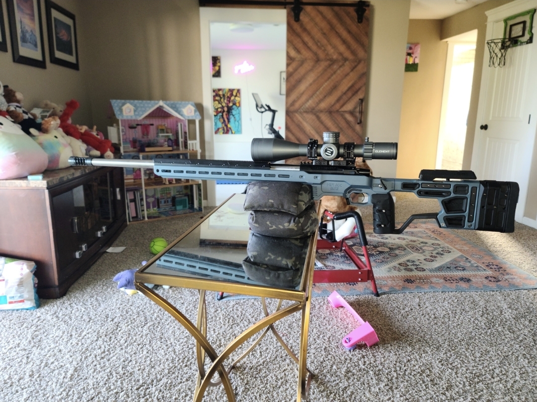

Love this little cartridge.
Build specs;
- lonepeak fuzion
- ibi carbon tactical 26” 1:8 twist
- manners lrh back in black
- Hawkins dbm
- mdt mags
- tt diamond flat
- apex rival 4-32x56
- alpha 6br brass
- arc m-brace rings
Reactions: TylerN

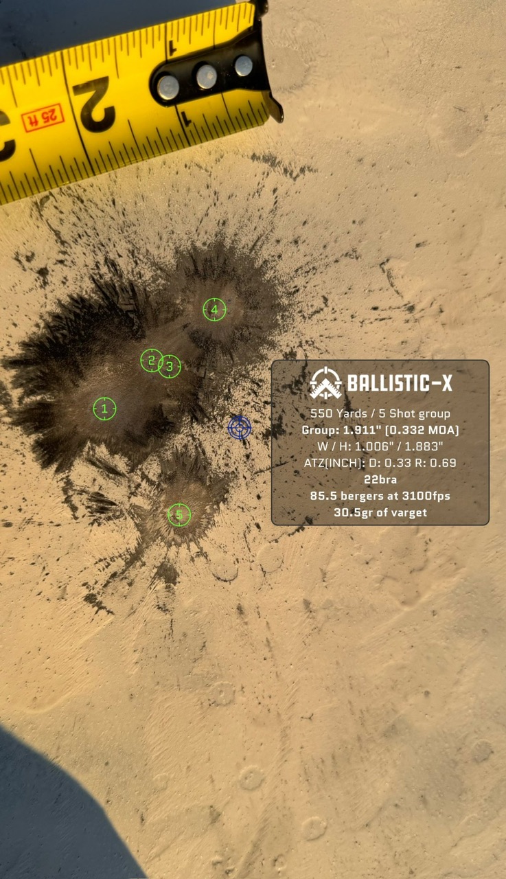

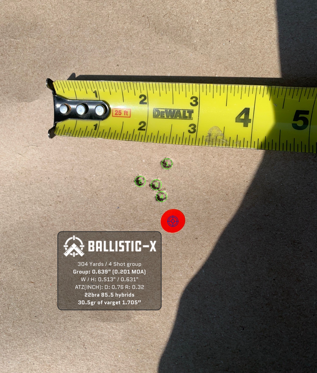

Awesome stuff man I never pushed mine past 3100 but am kind of curious now. What primers do you mainly use? Also what about barrel life? I'm still on my first bartlein barrel but I'm at like 1400 rounds and I've been seeing some flyers here and there. It still shoots sub half moa consistently but the flyers I never had before
I’ve spent the most time with varget and tested varget to 3250 in my set up and while I didn’t feel I was at any dangerous pressure it was where I decided to call it max. I believe I could of squeezed more out of it but didnt see the point.
when I did a comparison ladder N150 I found the slowest of the powders and n140 matched varget quiet closest with my lowest charge of n140 being 2993 and varget being 2988 and the high charge was 3226 for n140 and 3214 for varget. I believe n140 might be another really great option and want to explore more with this powder.
IMR 8208xbr was the fastest by far and hit 3309 with the same grain charge as the others. I recommend working up at a lower charge in comparison to the other 3 powders.
All 4 powders showed potential though.
I use cci br4’s almost exclusively as I stumbled across a bunch at an amazing price when primers were hard to get. As far as barrel life I’m unsure where it will go but I’m expecting no less than 2000 to be honest and 2500 I believe should be doable. Reason being is I have 1 friend with 2300 on a 22br and it still shoots .2’s, and a guy at the range has 3900 on his and it’s still .5’s most of the day. I believe his to be a fluke or maybe miss count on rounds.

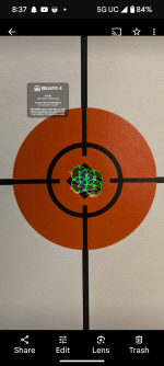

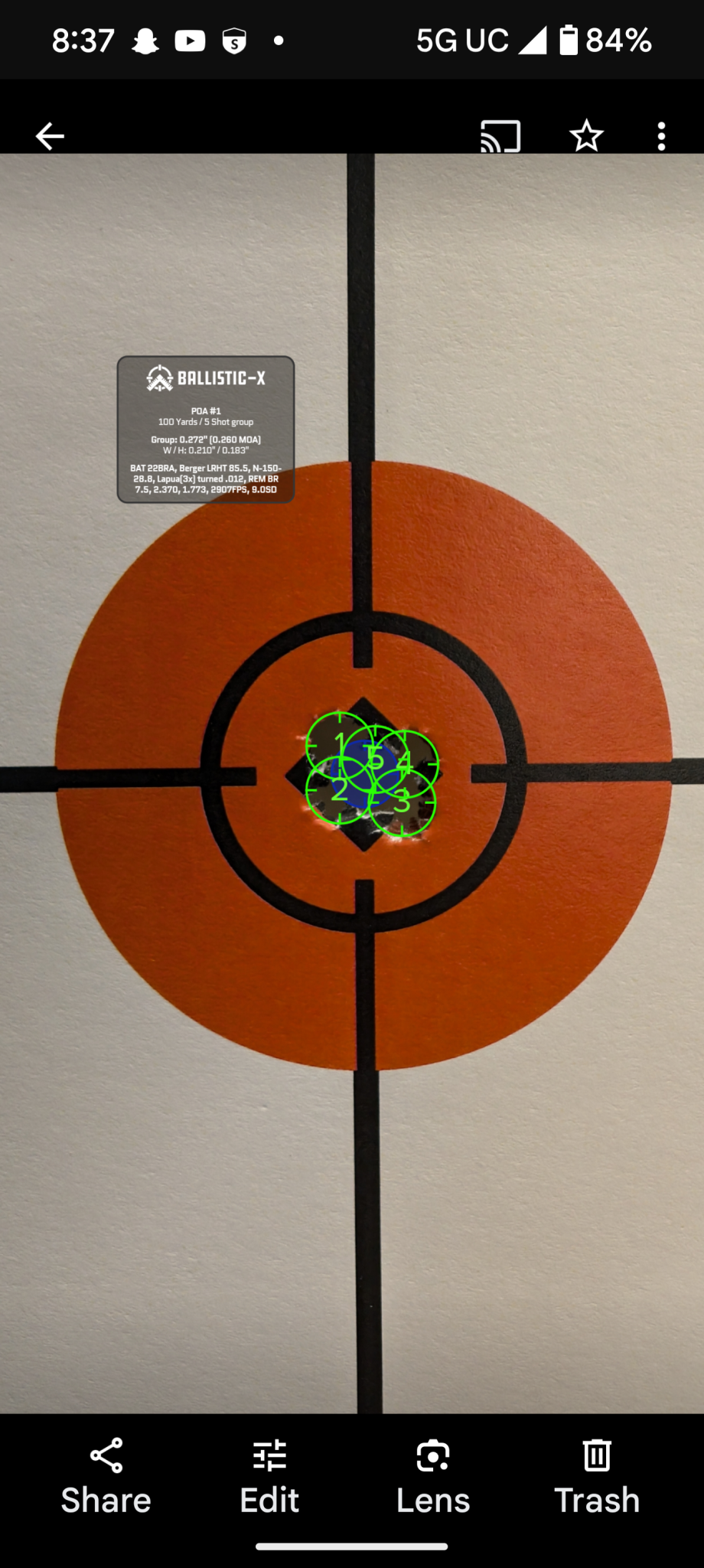

This how mine has been going, these groups were at around the 1500-2000 round count mark. I have started noticing a dropoff in velocity. It still groups great but I have 2 brux blanks and 1 Bartlein blank so it might be time to get a new one spun up.
