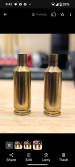

So turned the necks on 100 pieces of new Alpha brass down to 11 thou for my chamber, just to realize after I neck them down to 22bra the thickness is now 12.2 thou.. it still chambers with a loaded round but there is only like 1 thou clearance total may e less.. my Smith says send it.. what do you guys think?
Hey guys so I'm trying to troubleshoot an issue, when fire forming new Alpha 6bra brass to 22bra I have been doing the false shoulder method so that there is always a good lockup on the bolt. I recently did 25 pieces and had no issues with firing. However in the picture you can see 1 had a pierced primer and al.ost all of them have a mark from the ejector. My load was 26.8 of Varget and the avg across all 25 pieces was 2880. I've pushed this cartridge to 3100 before so it seems weird that I'm seeing this but maybe that is still too hot for the 1st firing since my headspace does move .010. what do you think
Have you fire formed a lot of brass with the barrel? I've had barrels do that after jamming a few hundred false shoulders. In my case I think the neck shoulder junction was rounding out with use and the crush fit was becoming loose.
No this was the first batch I have done. I will say I rewatched Greg from primal rights video on it again. And I never took my ejector out to check fitment of the false shoulder I always checked it with it left in which I wanna re do now

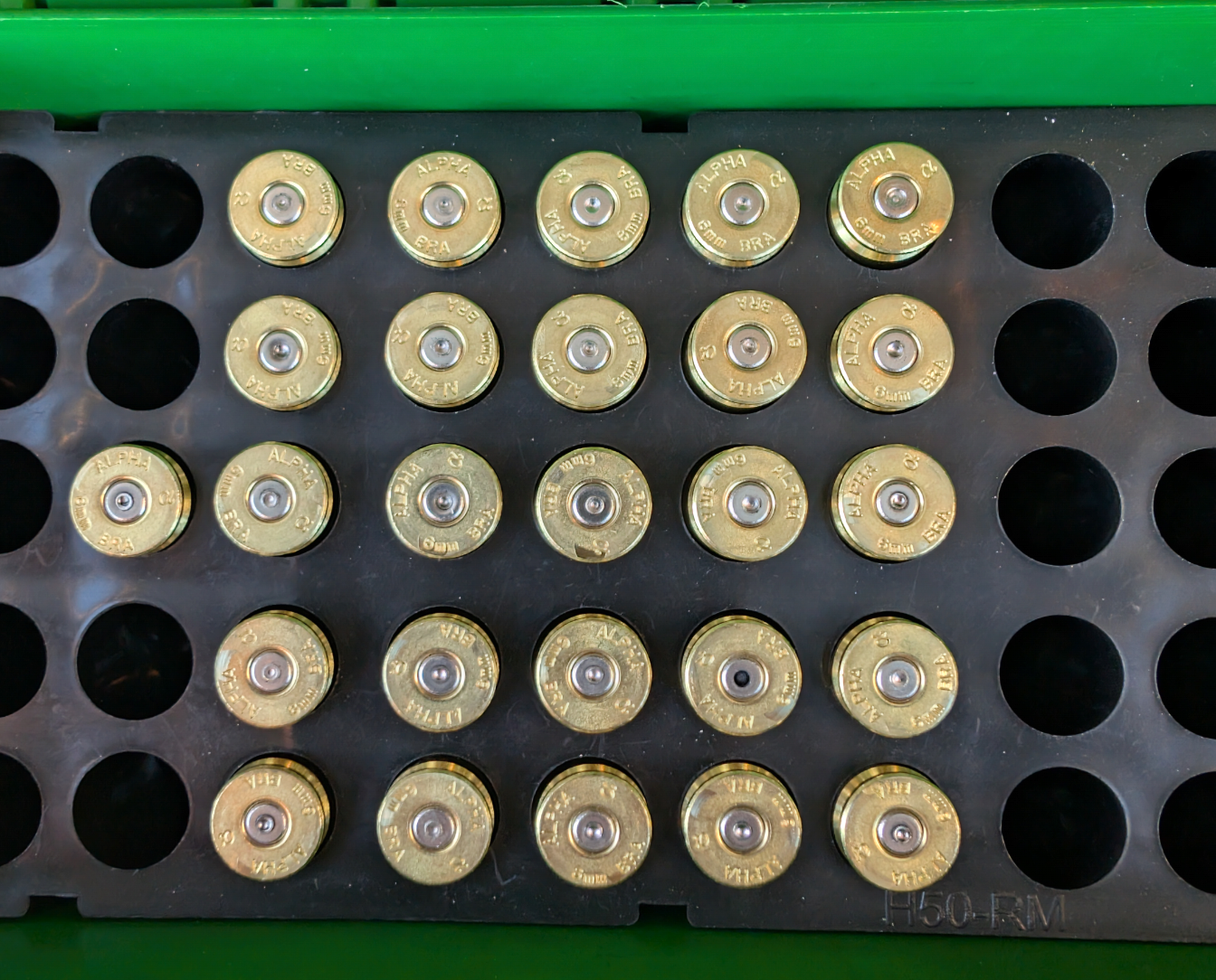

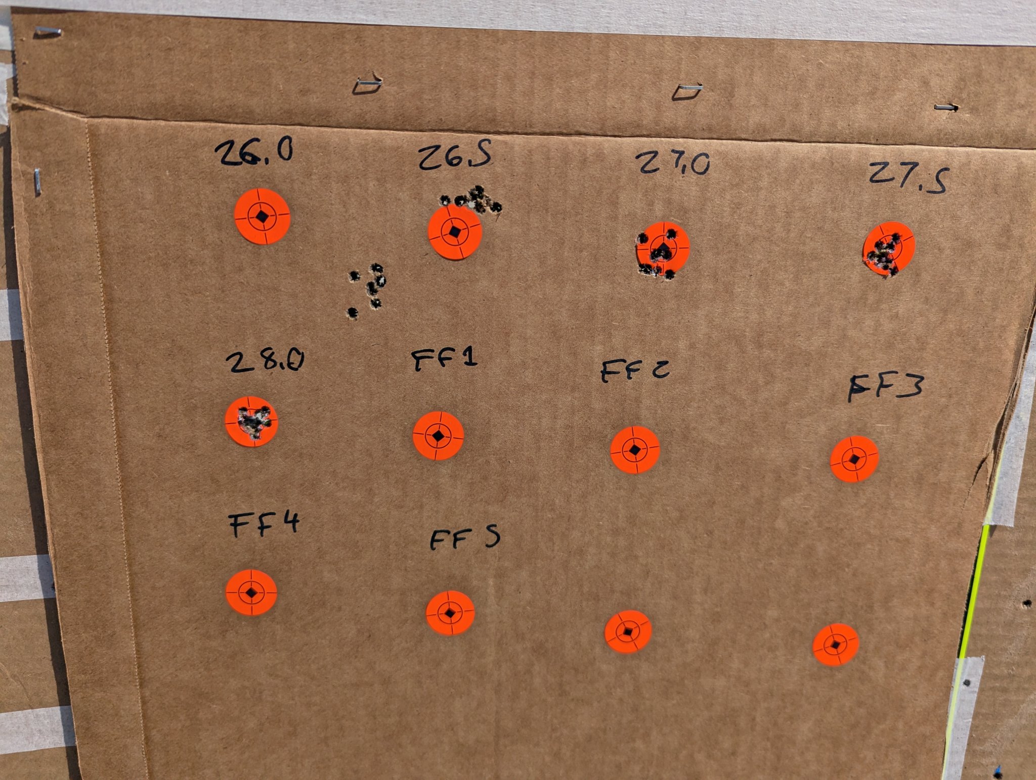

All my fireforming groups; 10 rounds each:
My best fireforming group; I had to stop this one after 5 rounds or else this wouldn't look as good :cool:

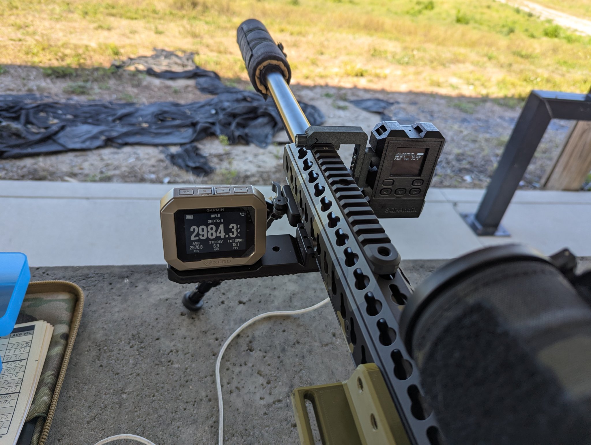

Testing my Andiscan vs. a friends Garmin. One read constantly 10fps or so higher which was interesting but not enough of a difference to matter so I forget which was slower or faster :p

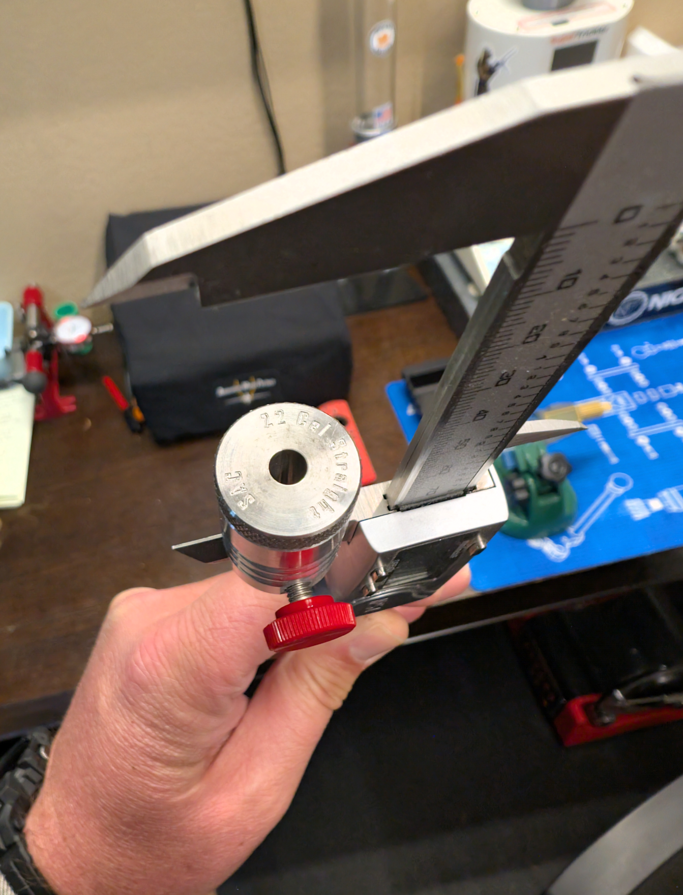

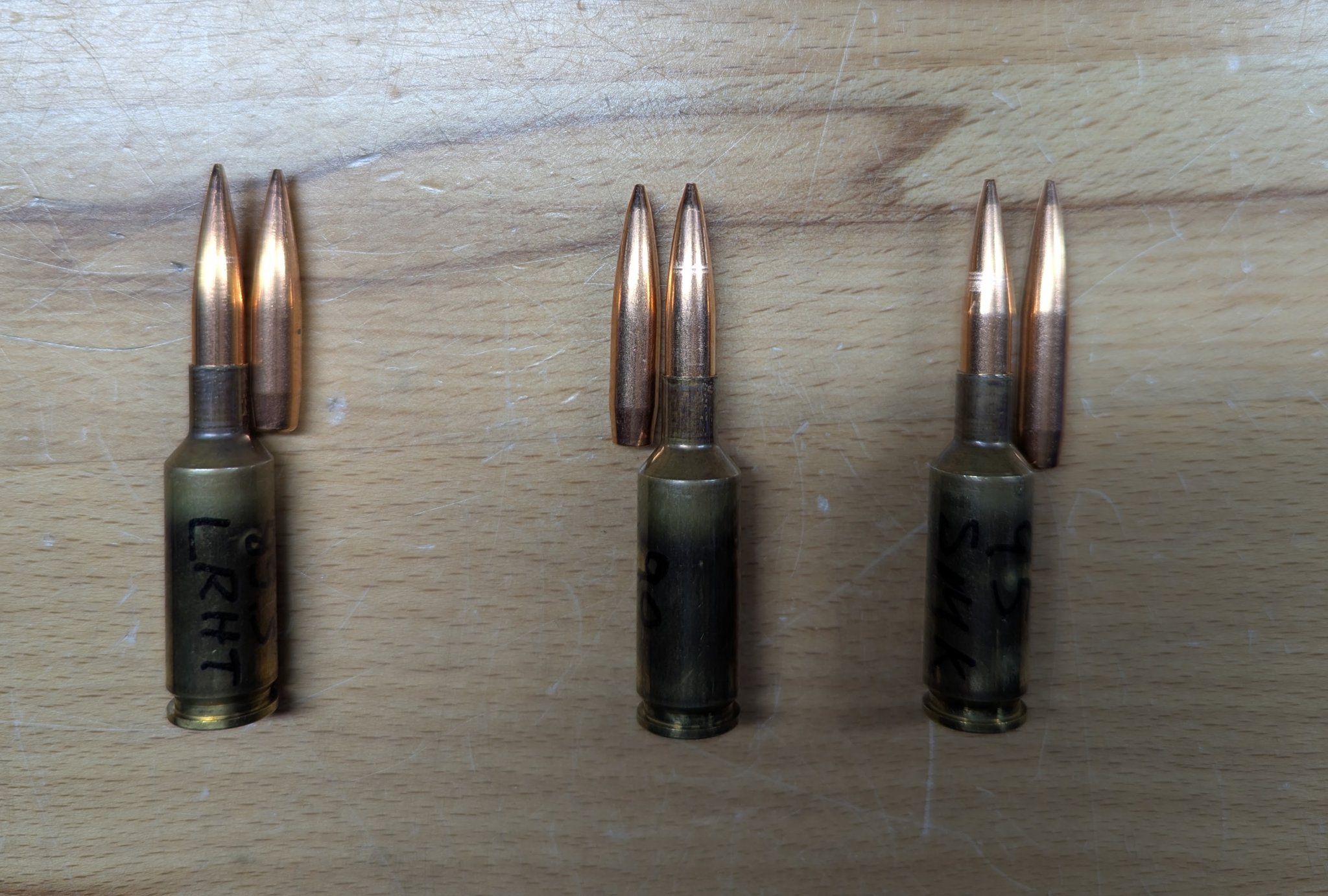

1.763 CBTO by my measurements with a Berger 85.5gr would be 0.002" into the lands; does that seem right to you? I measured my distance to the lands with the 3 bullets I'm testing and got these measurements:
Berger 85.5gr: 1.761
Sierra 90gr: 1.777
Sierra 95gr: 1.763
And here's what those 3 dummy rounds look like: 85.5gr, 90gr, 95gr:
Sierra 90gr: 1.777
Sierra 95gr: 1.763

Also this is the insert I am using my 85.5 CBTO when new on a hard jam was 1.819. so I was jumping like 50 thou because it was 1.773 actually. My new reamer is a .100 freebore and my hard jam 1.767. so now I jump them about 25 to 30 thou off jam
Reactions: TylerN
So my guess Tyler is that you are using the other insert listed as 22 caliber bullet, I checked the difference and it's about 70 thou so that measurement of 1.773 should really be closer to 1.703 for where I was at.
Reactions: TylerN
You're correct. I have the standard SAC 22 cal bullet comparator so that explains the difference.
