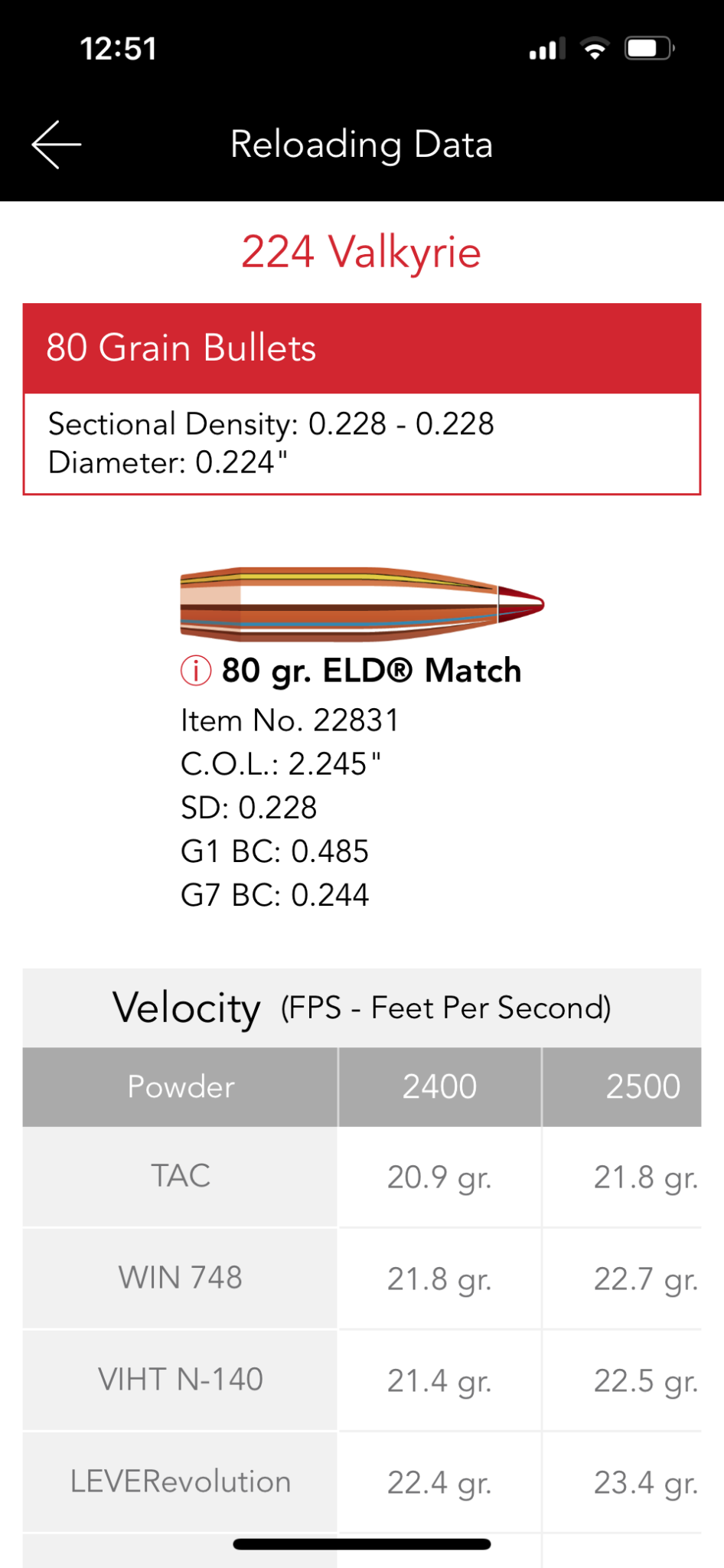

Am I missing something? The new Hornady 11th edition load manual list COL at 2.245" for my 224 Valkyrie and 2.255" will cycle great through all my mag's. Shooting exceptional groups with 25gr of CFE223 seated at CAOL of 2.250 through a 20" 1:7 AR barrel. Great coyote load with ELD-M or X. Have to say ELD-M's have less fur damage.
Talking mag length for 223/5.56. It can be mag length for 224 valk and 22 arc just fine
So, the answer is “Yes, it can be loaded to Ar15 mag length, with some limitations based on the specific cartridge in question…”
