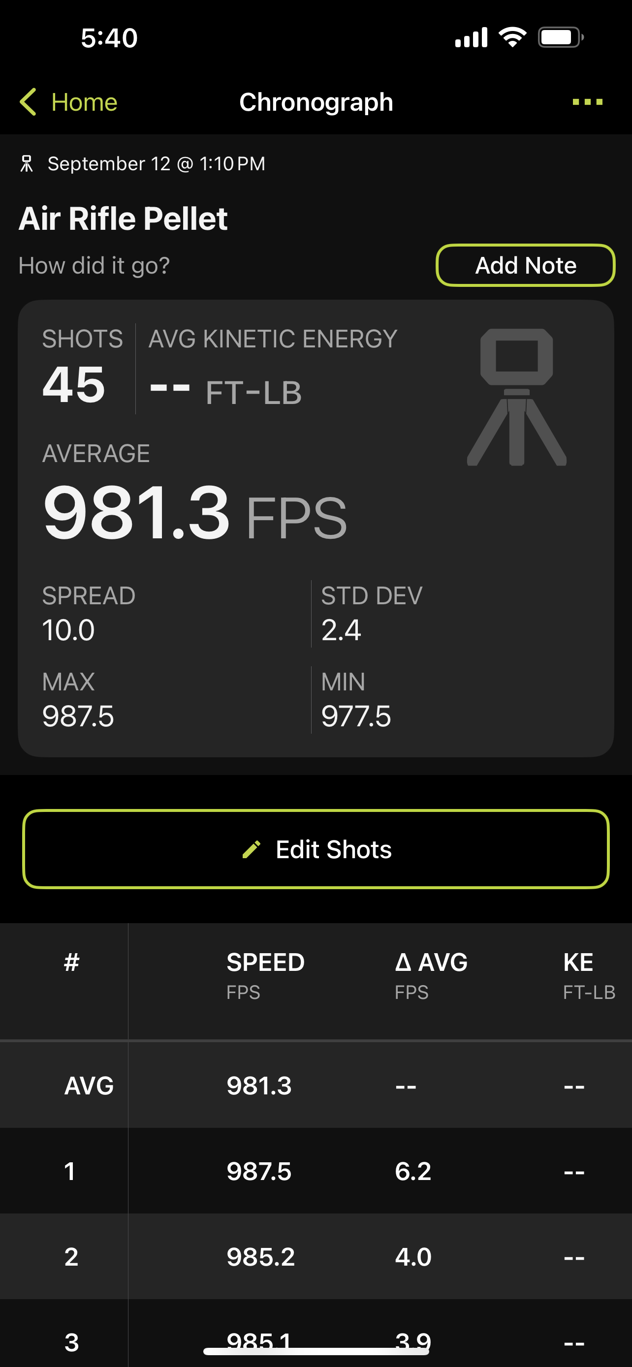

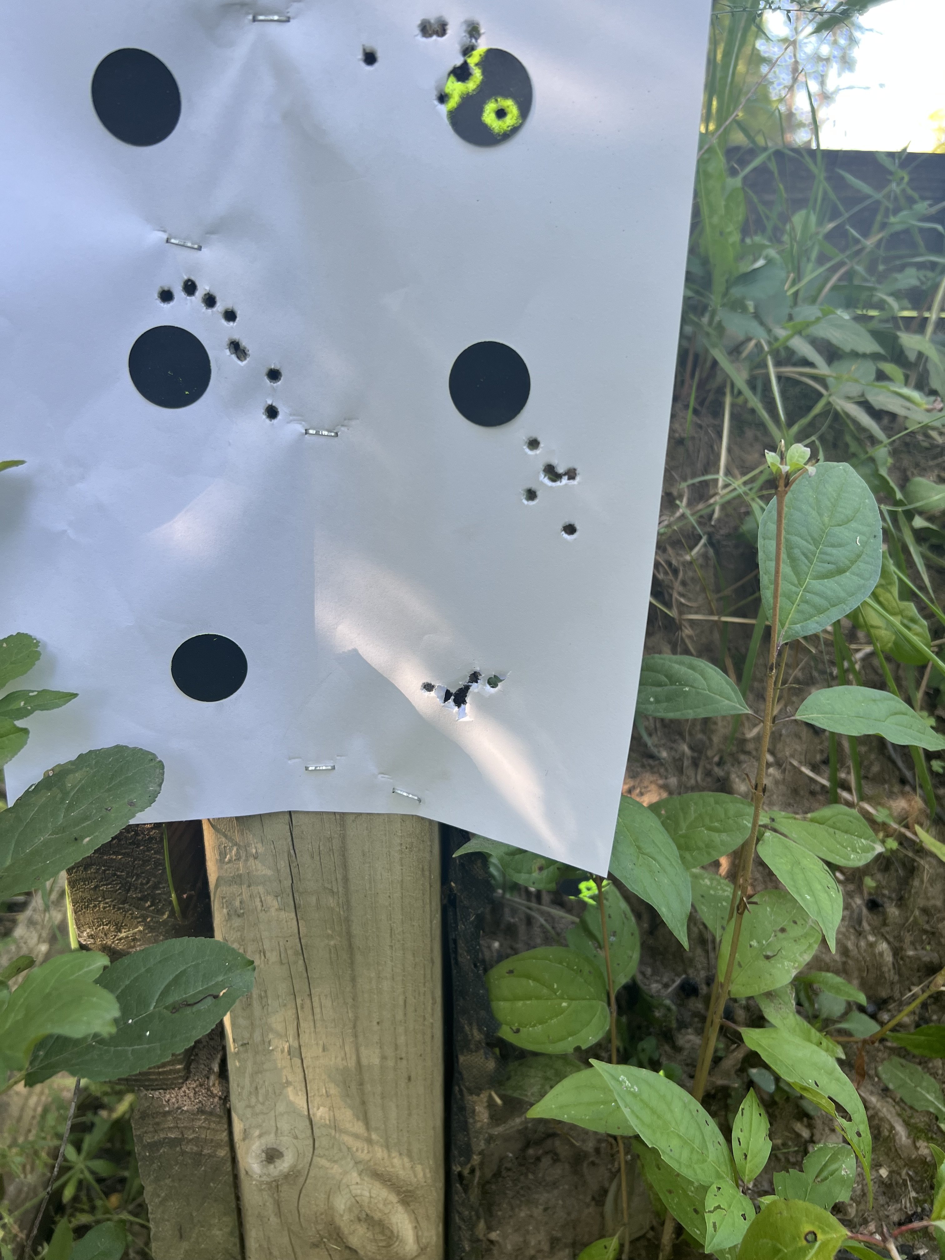

Got some of the new ace 40.1 grn slugs. Finally was able to get out and tune them. This target is at 100 yds. Was a little 3-5 mph left to right. The bottom right is the best tune I found. That 6-7 shots. SD of .6 which is crazy low. I forgot to take a pic at 50 yds. But it is pretty much one hole. I put an G1 of .210 in the kestrel. That worked for 100yds. I’ll have to try it farther out still. Air rifle is the Fx panthera 700mm in 22 cal. It shoots better than my rim-x. And I don’t have too spend a lot of money, finding the right lot of ammo for it.
