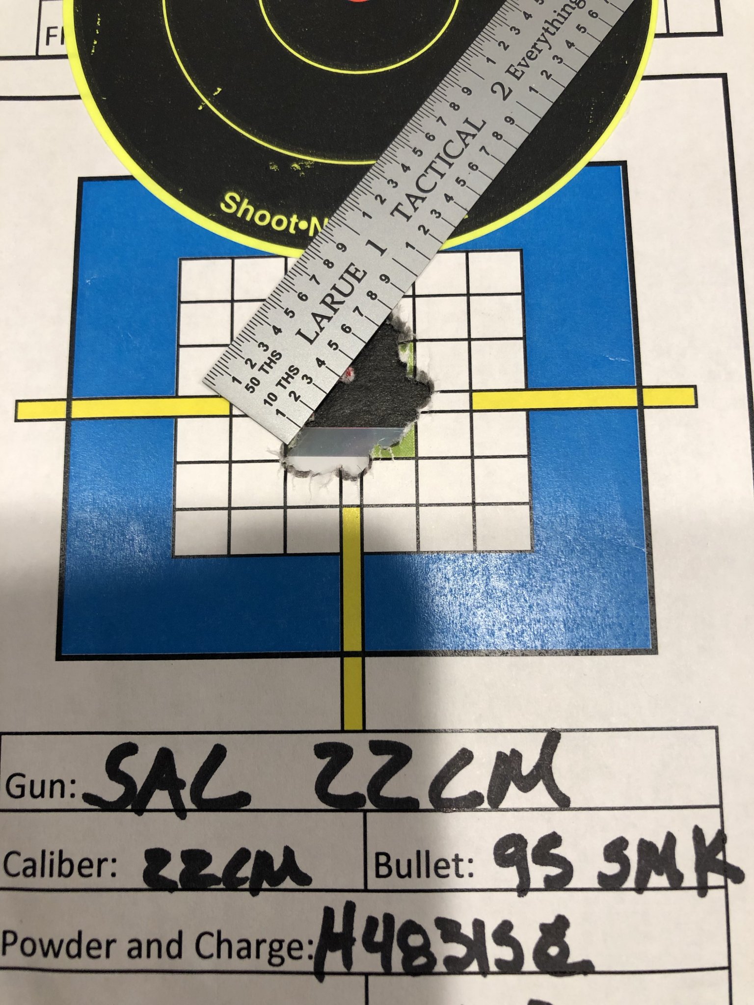

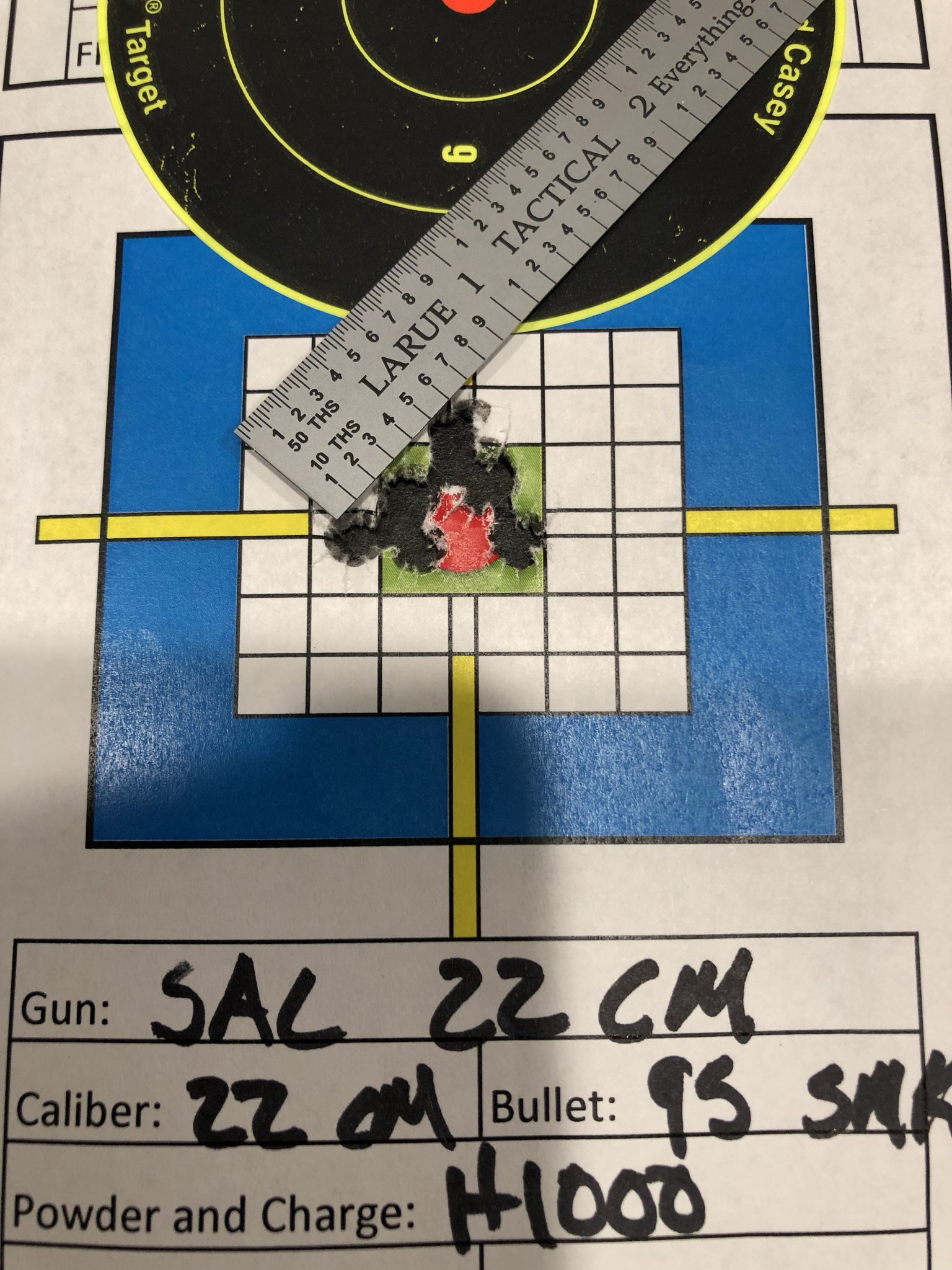

I hope the info helps, couple picts of the second round of testing.... 10 shots at 100 yards, looking for some data. Hopefully can shoot at distance soon.
H4831SC 41.4 to 42.3

H1000 43.4 to 45.2
