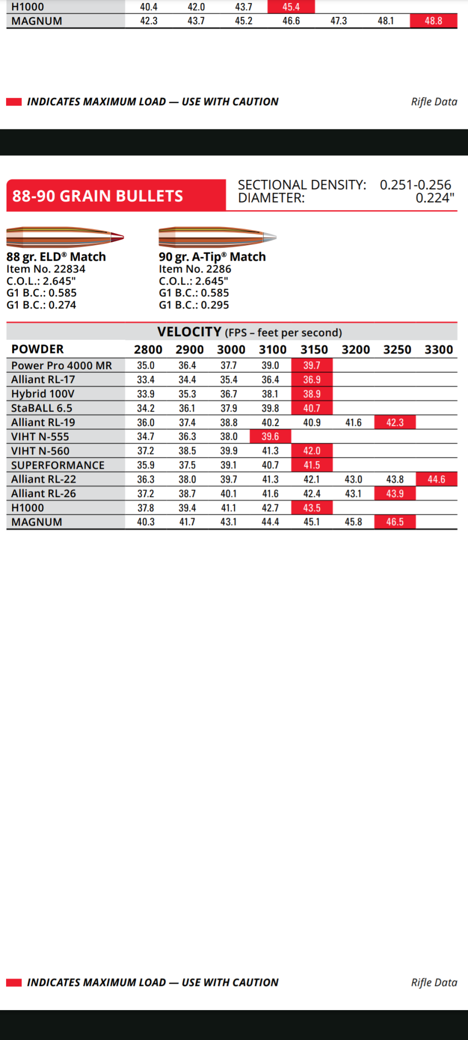

The hornady load data's starting load with 6.5 staball is below their max load for 22gt with an 88eld, so I I suppose the real question is would it shoot worth a darn at that velocity.
If so idk why it would get the >= 2k rounds the 22gt guys claim to get.
