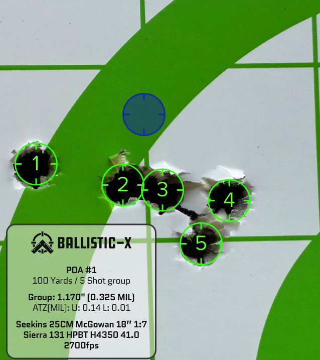

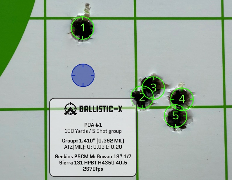

Yeah it’s not a SAAMI cartridge yet but seems the common thought is that it will be. I already built one and am just breaking it in. My specs are a few posts back.
Promising start with Sierra 131 HPBT and H4350.
Edit:
Well not awesome but will keep playing with them.

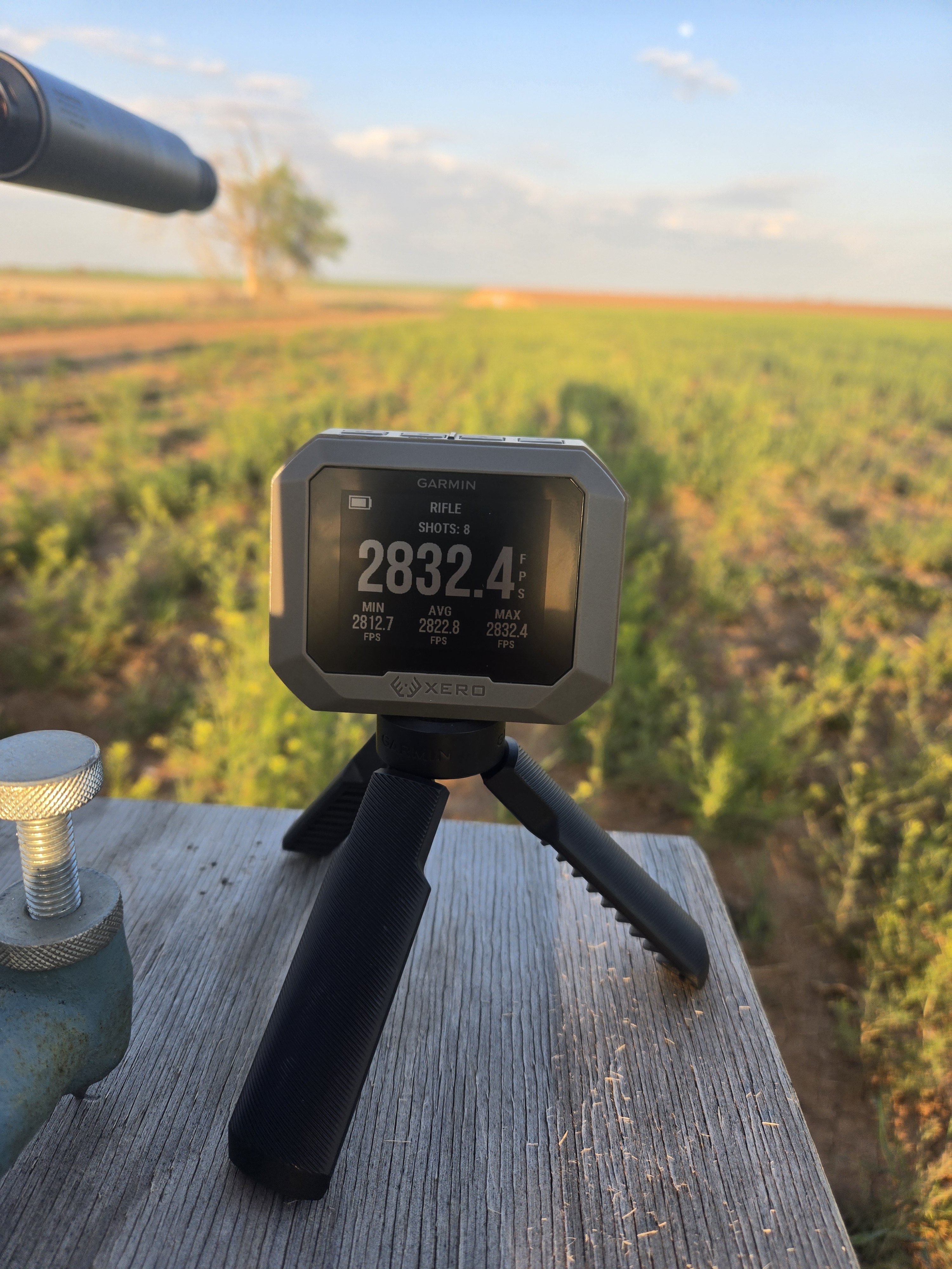

These 25 Creeds just shoot. Alpha brass,134gr eldm, H4350 on a Aero Solus. Need a touch more powder to get 2850 fps
