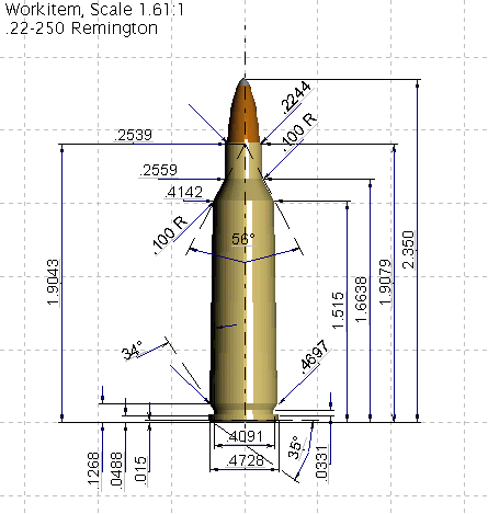

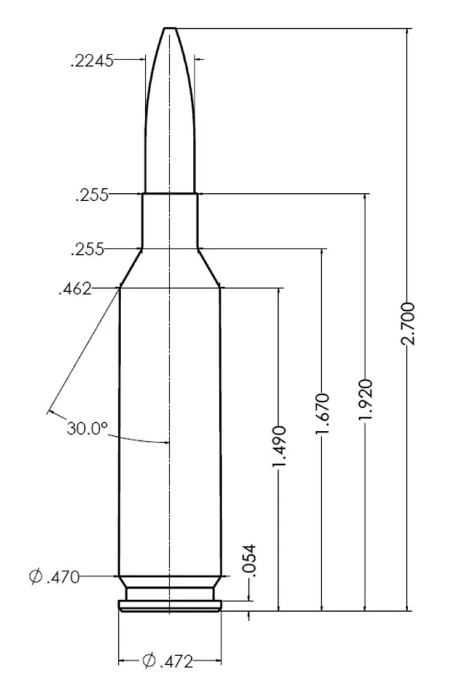

    Look at these two drawings carefully... pay special attention to the neck-shoulder junction and total length. The Creedmoor is an improved modern 22-250.

    Am I wrong in thinking a big advantage of the 22 Creed would be the sharper should of the case keeping the brass from growing as much as the milder shouldered 22/250? Trimming brass is a pita and it’s always seemed to me sharper shouldered cartridges get more firings before I have to trim them. I don’t know if this is unique to my experiences or an inherent trait to cartridge case design.
    How does shoulder angle reduce neck length growth?
    If you're concerned with length growth from shoulder datum to base, that should be fixed with headspace, no?
    The problem with the 22 creed is you're limited on brass selection, unless you want to get into neching shit down and turning necks.
    You could consider the .22-250 AI and that would net you more brass options and end up nearly identical in case design.
    The .22-250 is already overbore and burns barrels quickly, the .22 creed will only be worse.
    I’m not sure if it does. It was just my experience with what I have loaded for in my time shooting; likely a result of an overly large chamber or slightly looser headspace like you said.
    I think most neck growth comes from brass flowing from expansion during firing and dragging an expander ball out through it. I don't have numbers to put to it, but I'd say 90% of the growth comes from bass flow during firing.

    Body taper is still an issue. Due to the body taper the shoulder has a smaller diameter thus less area to hold the brass against the flowing brass.

    So I’m not crazy in my experience with having to trim 22/250 and other similar shallow shouldered cartridges needing trimmed extremely often. . . .

    I may be wrong, but I believe the case taper has a bit to do with it as well. It is much harder for the cases to grip the chamber walls with that much taper.
    The 6.5SE is similarly afflicted.
    PO Ackley (as in Ackley Improved, or AI cartridges) blew out the bodies of cases/reduced case taper and blew out the sharper shoulder angle. As mentioned above, the 40 deg shoulder will prevent the brass from flowing and you won't have to trim brass much, if at all. His experiments made him think the 28 degree shoulder was the most inherently accurate, though. So you see that on lots of cartridges, though I don't know how well-documented the testing and science behind it is.
