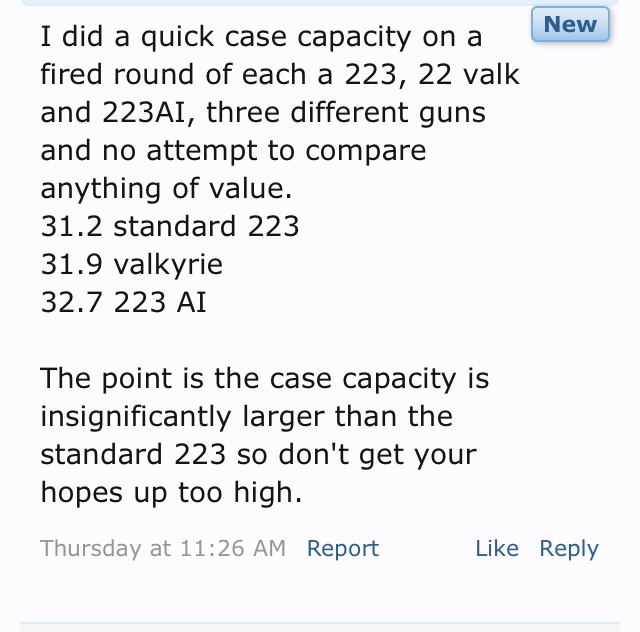

I'd have to go back and see what other people think of the cases. I do know I've had problems with both issues, rebated rim and Norma softness.

I don’t see the 224 getting any better barrel life than a regular 223. 22creed is not in the same league. Closer to my 22-250ai

My 223AI gets 2813 fps with a low pressure load using 88's in a 28" barrel, but the OACL is 2.614. Too my knowledge there's no mags available for 223 with long enough internal latitude to work for that long of a OACL. Of course forming is a extra step so that's a downside. I can get 2900 fps + in the high node though with 26 grains of Varget. My current load does surprisingly well at 1000Y.
BTW my 223AI load above totally crushes a load I tried yesterday at longer distances in 6mmBR, which is a 90gr TGK/.49BC at 3045fps! by 933Y the 6br load was faltering. That .545BC the 88's have makes a huge difference farther out!
