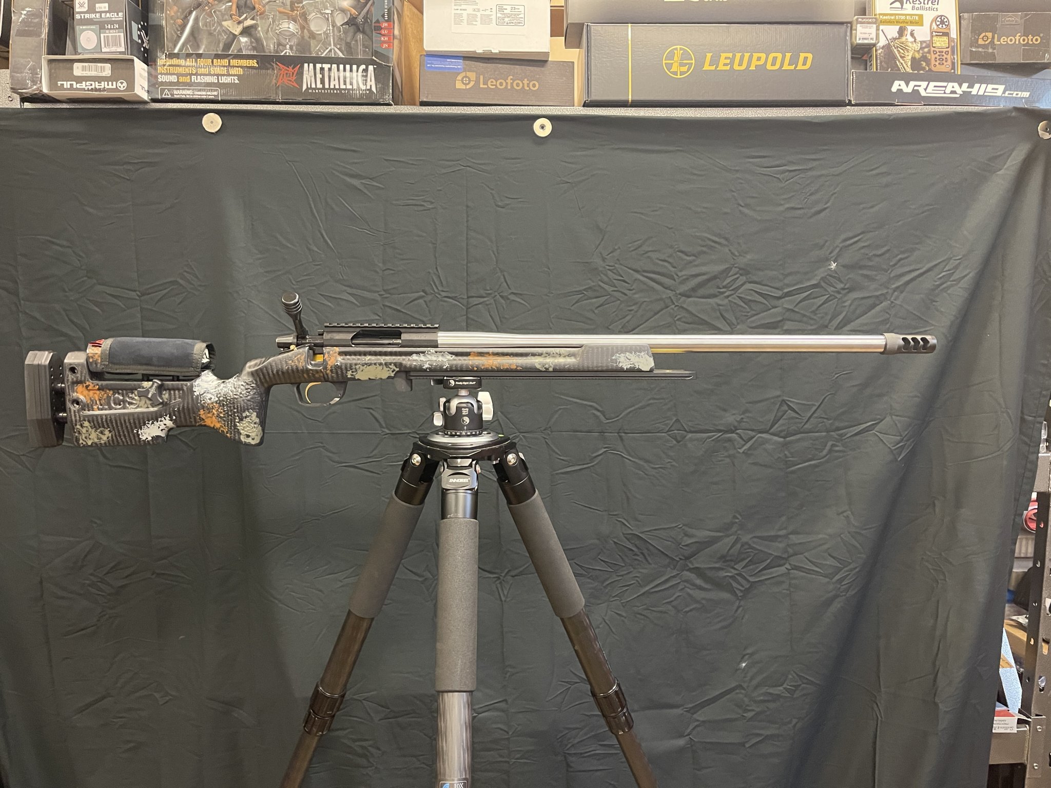

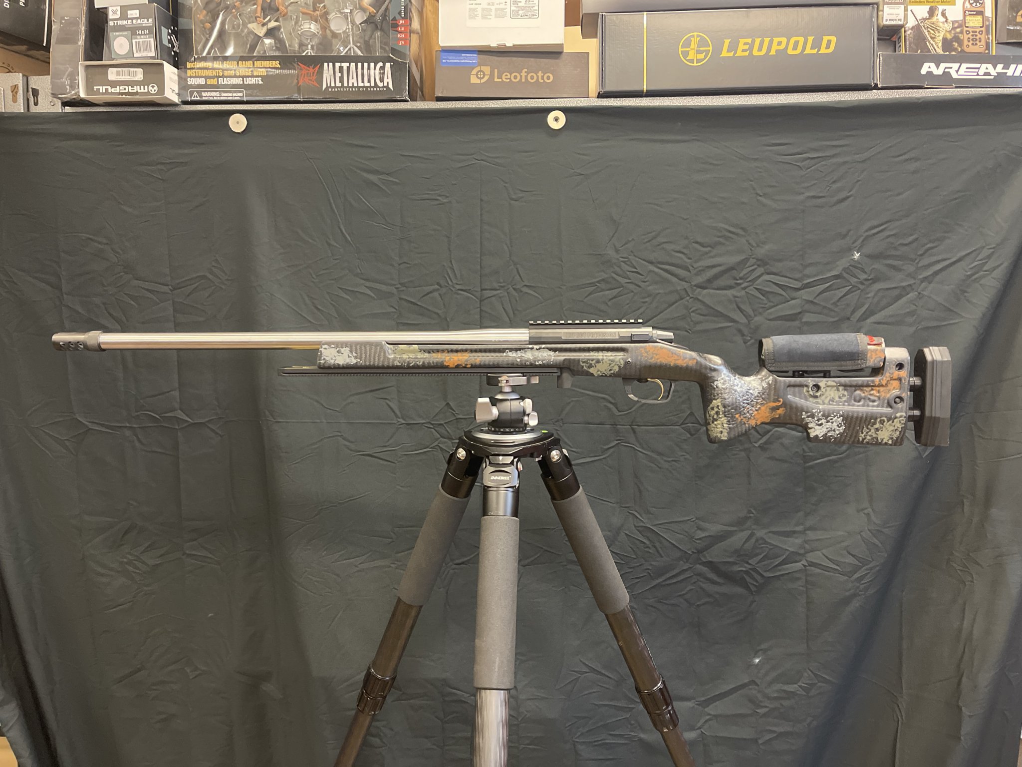

I just built a .224 Valkyrie today. 833639C5-5528-4D7D-9298-2327C2BB9DE2.jpeg17EF50C1-46AF-4D33-8894-EBF5AC485B0C.jpeg
