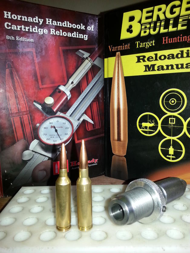

had Dave at PTG make me up a finish reamer and a full length die reamer as well and started building :)
.22 on the left with a 90gn and the 6.5 on the right with the berger 130
currently building a bolt gun and the AR is right behind it. Looking forward to seeing the results myself

Looks like I am going to have to make a new FL size die!! LOL!!
I will also have to think about what free bore this case will need for the 75-80 grain bullets. .100 I am guessing? Good read. thanks for sharing! Lee
