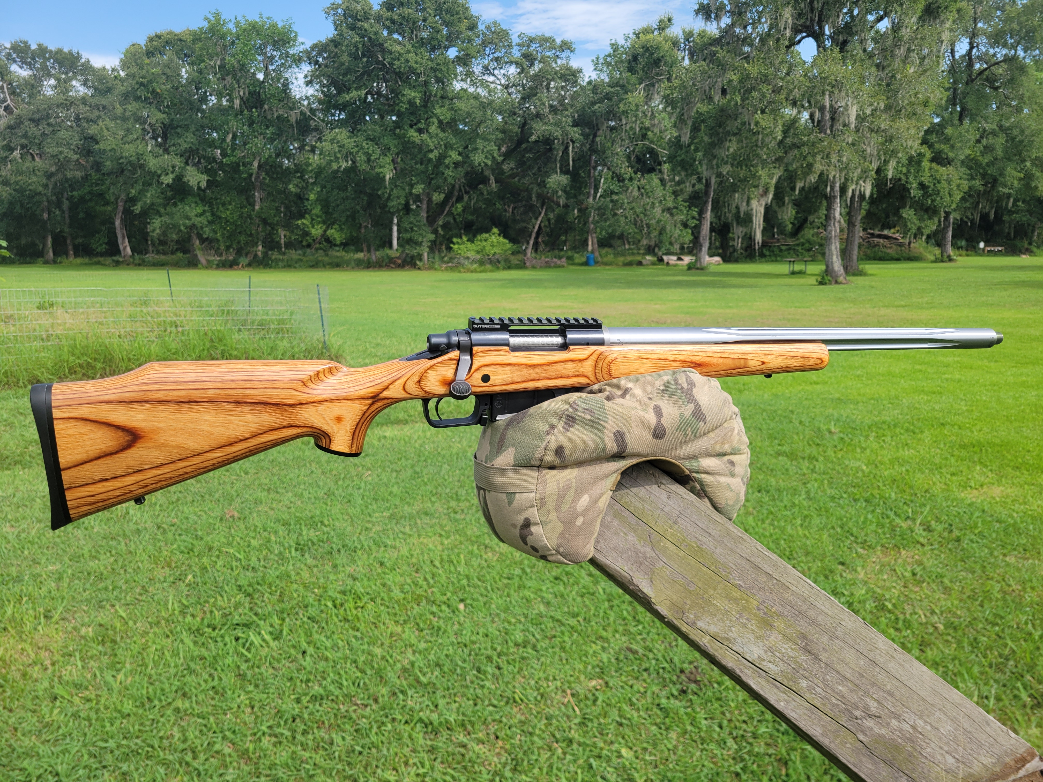

As to why dasher ? I like shorter barrels running suppressed. Just finished two 6 dashers, one at 22" for myself, and one at 21" for a friend of mine.
This 22 will be for my brother, though I may build myself one down the road. He was looking at doing a 22 arc before I built these dashers. Instead of having his bolt face opened up he opted to just buy another bolt and go dasher instead.

I still haven't shot mine yet but I think it's quickly going to become my go to. I haven't had a small caliber go to rifle since I shot out my 22-250 some years ago. Really just been shooting 22lr and .30 calibers for quite a while. Depending on how much I like this one for my brother, I may spin me up a 12 twist for the 50gr range of bullets.
In the last couple years I started playing with a 243AI that I'd almost forgotten about and I really became a fan of the 6mm.
This dasher is a handy length, and I think with 85-95gr bullets I think it's going to be pretty deadly. The smaller charge in the dasher should suppress better than the 243AI also. Which was another reason I didn't go that direction again.
