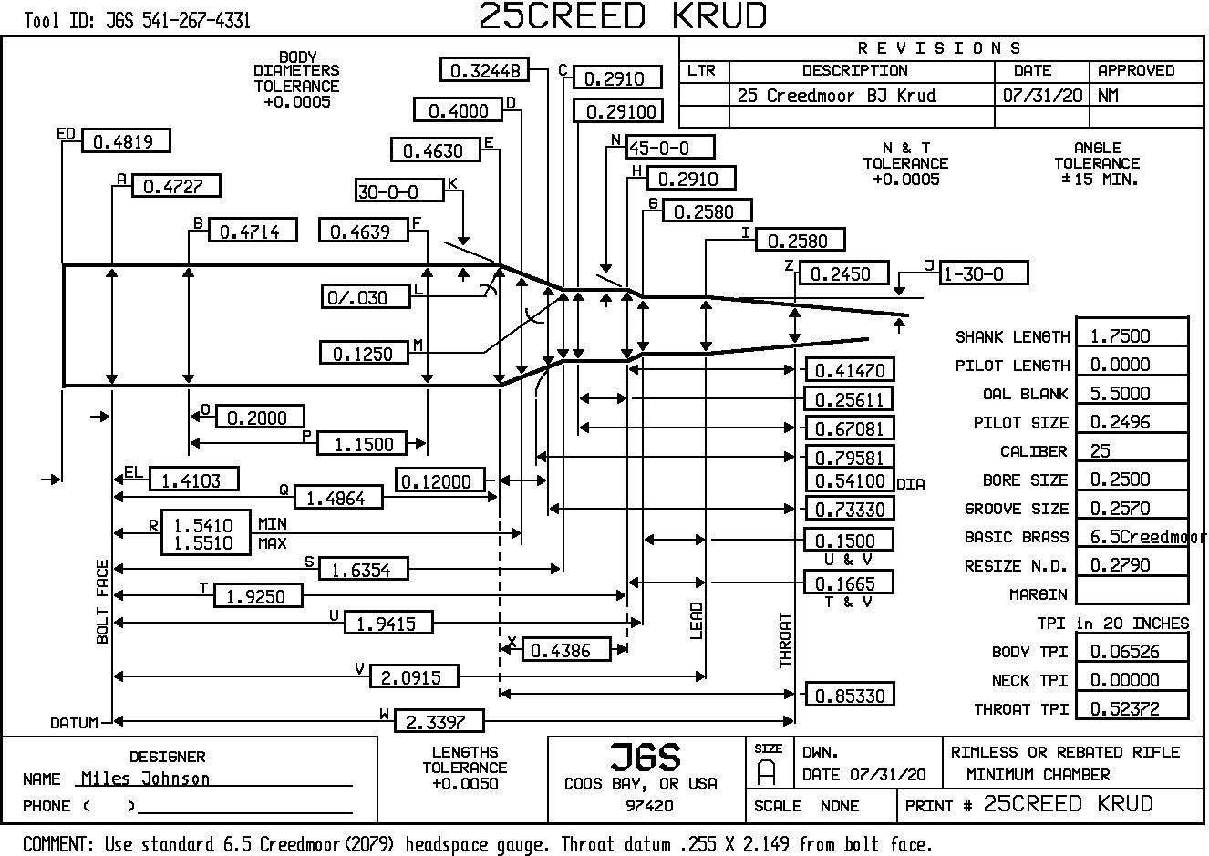

The reamer you might be looking for is the KRUD reamer with .150 FB. Designed by Keith Rudasill. Blackjack posted it on FB. Looks like JGS did the original.
I'm running this reamer with 134 ELD-Ms with 41gr H4350 at 2800 in a 25" barrel. Seated around 2.820 to make sure it feeds without issues. Not sure on top end pressure as I was only looking for low 2800 for speed so I only loaded an initial ladder from 40-41gr and barrel sped up to exactly where I wanted it.
Solid info thanks man
