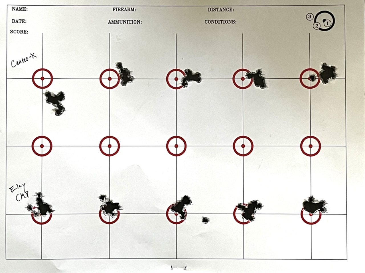

Looking for reviews of the Eley .22 CMP standard bulk ammo. What are you getting for average velocity, SD and ES. I was thinking to order some as practice ammo. I currently am shooting Eley Club.
I couldn't find any recent info on the CMP bulk ammo myself, so I ordered it anyway to try. Supposed to get delivered tomorrow. But, I am sure FedEx will screw that up somehow.
Their shipping estimate is spot on though. Ordered on 10/15, shipped 11/12.
Reactions: BOISCOID

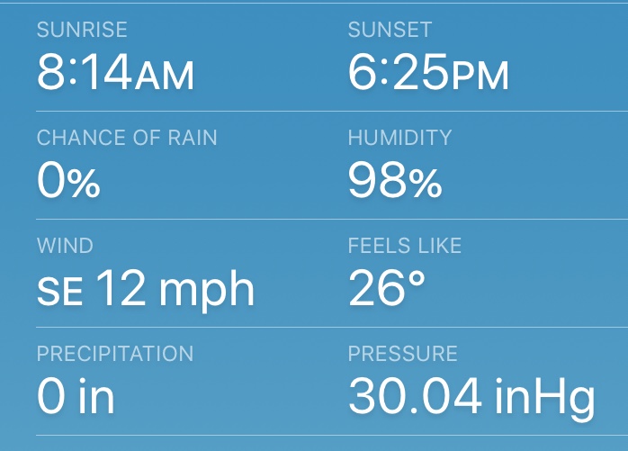

Ran some through my T1X at 50 yards when the weather was a little chilly with a decent breeze.....
I may pick up another case for the heck of it....

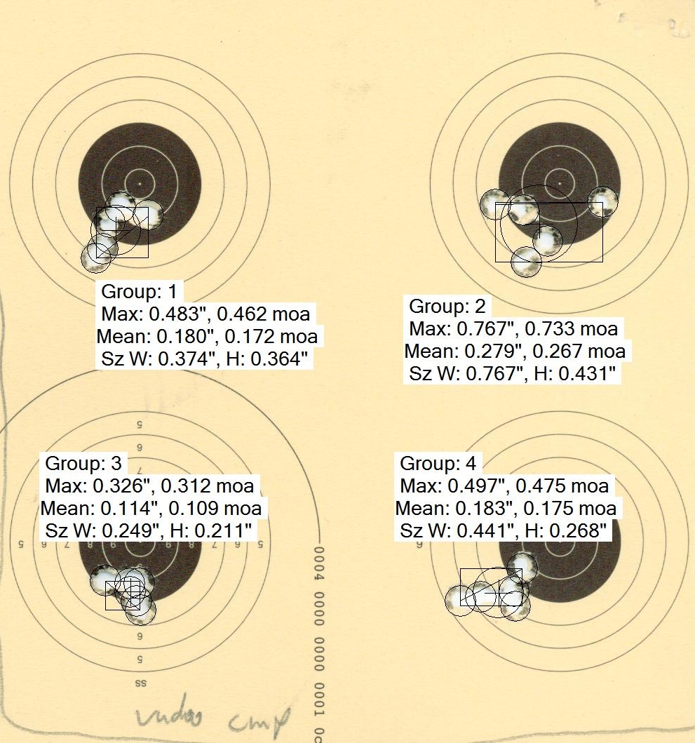

I bought a box of 500 from a friend just to try them out. It's certainly NOT match quality. I weigh my 22 and sort by tenths of a grain. This stuff was ALL OVER the map! MUCH higher weight range than the SK Long Range Match and SK Rifle Match that I normally shoot in my Bergara B14R. At 50 yds I normally get at least 1 MOA groups and often 1/2 MOA groups (1/2" to 1/4") but the Eley CMP stuff was around 2 MOA, it was so bad I didn't even take a picture of the groups. I will use it for plinking with a pistol or maybe for Steel Challenge matches.
Reactions: Busyhawk
how long ago was that case bought and do you know the lot #?
Did you shoot it in more than one rifle?!
In at least one Anschutz, 457, and a Shilen barreled Keystone AR, it fucking hammered at 50 yards. 3 barrels from 2 continents with 3 different chambers...
I mean it shot WAY out of its weight class.
Further out it suffered, but at 50 yards, it hangs pretty tough with your mid-grade match ammo like SK RM, Wolf ME, or Eley Club/Target.
For a “match” round in .22, it’s one of the best deals out there if your rifle likes it.
I guess I’m just lucky to be 3 for 3?

I got my shipment. It was pretty windy but it looks like it’s only slightly worse than Center-X in my Vudoo. These are ten shot groups at 50 yards, and the inside of the red ring is 0.5” for scale. However, it’s hard to chamber in the Vudoo, sometimes very hard. Hopefully it shoots well in my CZ 455.

Average group size is just about right on .5" @50yds with my Vudoo. One lot was slightly over .5" and one slightly under. Bolt close is hard in the Vudoo but the one I have had fail to fire did extract live. Firing pin marks are pretty light on the hard Eley Brass with the lighter weight Lapua calibrated firing pin string. Group size was similar out of my Anschutz 1710. It chambers a bit easier in that rifle and has had no failures to fire.
In the Vudoo (20" proof barrel) Mean velocity was 1075fps with an SD of 8fps and an ES of 35fps.
In the 23" barrel Anschutz 1710 Mean velocity was 1051 fps with an SD of 10.4fps and an ES of 38fps
Each rifle had a different lot.
At the price this stuff was excellent. I wouldn't call it match quality, but really good practice fodder at a bargain basement price. Hopefully we will get a chance to get more in the future though I did notice that all the lots I have seen posted about as well as my own appear to have a 2017 production date so this may have been a Trump slump special not to be repeated. Given the performance, I wouldn't be surprised if this was just Eley Target sold in a bulk pack for half price.
Anyhow, here were the groups I shot thorough the Chrono today with the Vudoo
