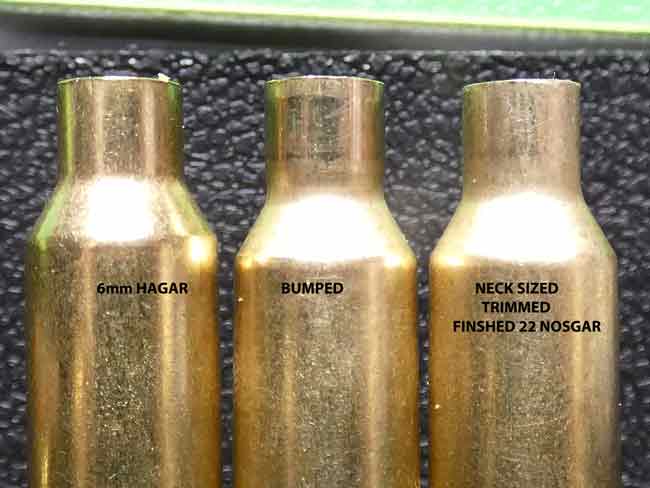

    Here's what you do with the Hagar brass (22 NOSGAR is a little shorter than the 22 NXS)

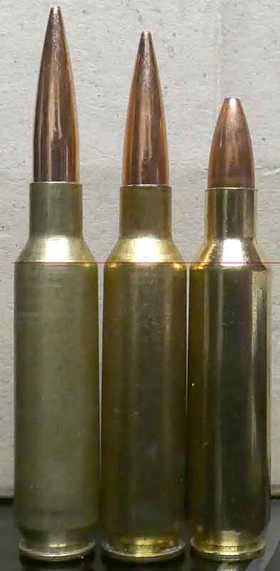

    85.5gr 22N (Dogtown), 22 NOSGAR, 22N Factory 62gr.
    An MOA or a little less @ 300yds.
    300 yds, wife on the left, mine on the right.
