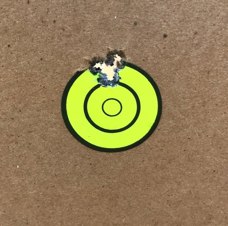

I have the 18 AR Stoner Barrel....not getting the FPS I had hoped for but it does shoot well with 77 TMK
27 Grain Varget
77 Sierra TMK
2784 FPS
