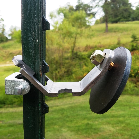

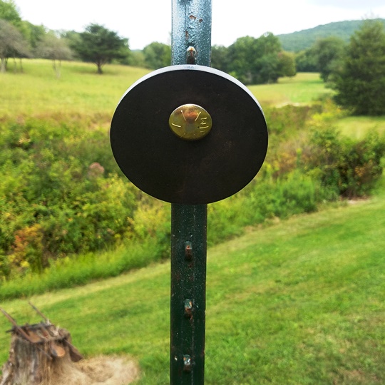

Is it safe to assume you are shooting sub sonic ammo? If yes, 1/4 mild steel is fine. I shoot 1/4 mild steel with 22 all the time at 50 yards and after thousands of rounds there are just barely getting a little beat up. Shot them with 17HMR at 100 plenty as well.
That being said.....i've gone to mostly AR500 because it seems like an idiot friend or relative forgets and shoots an AR at them and goes right through 1/4 mild. I've had good luck with Hang Fast Steel-Norcal911

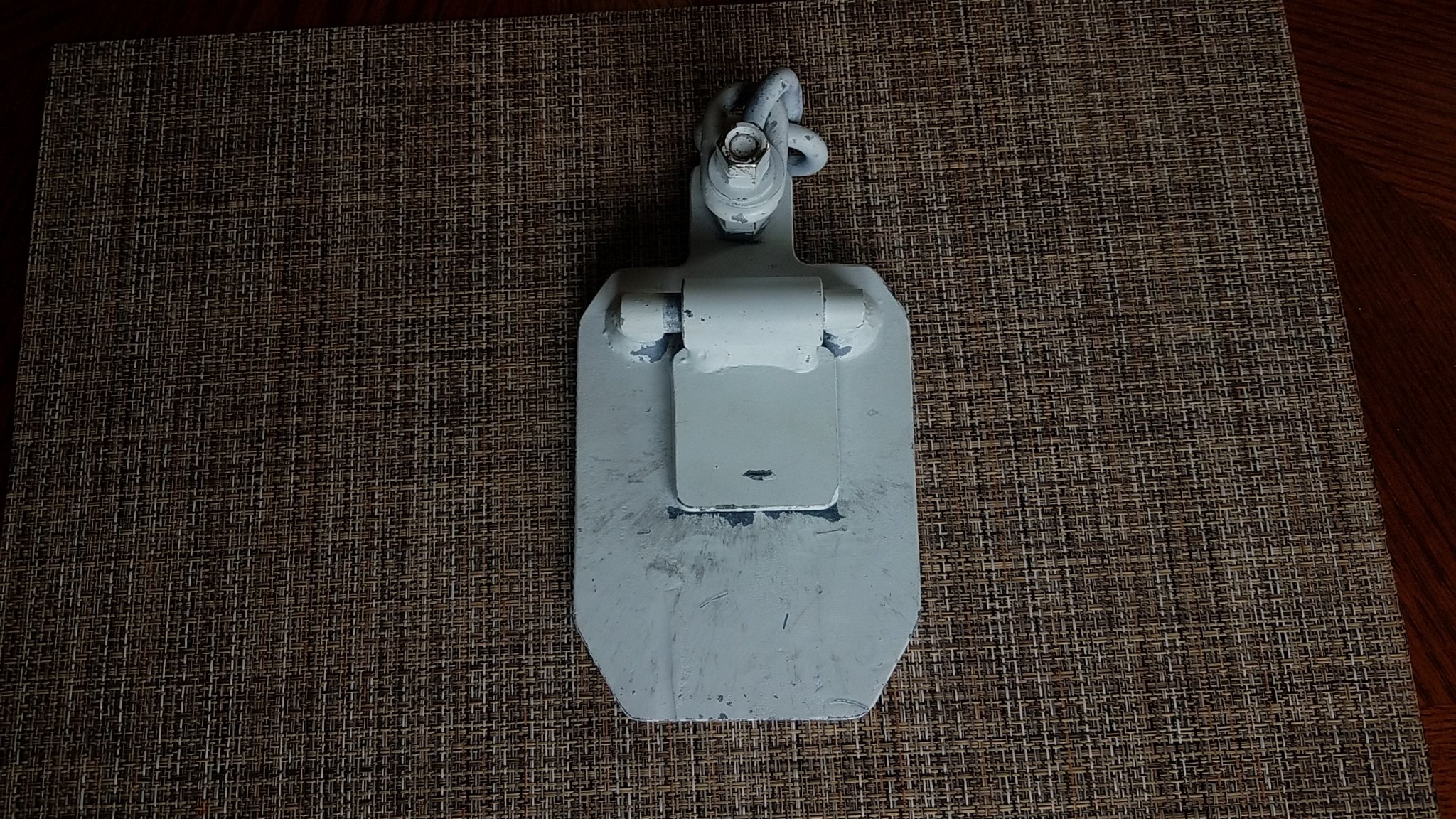

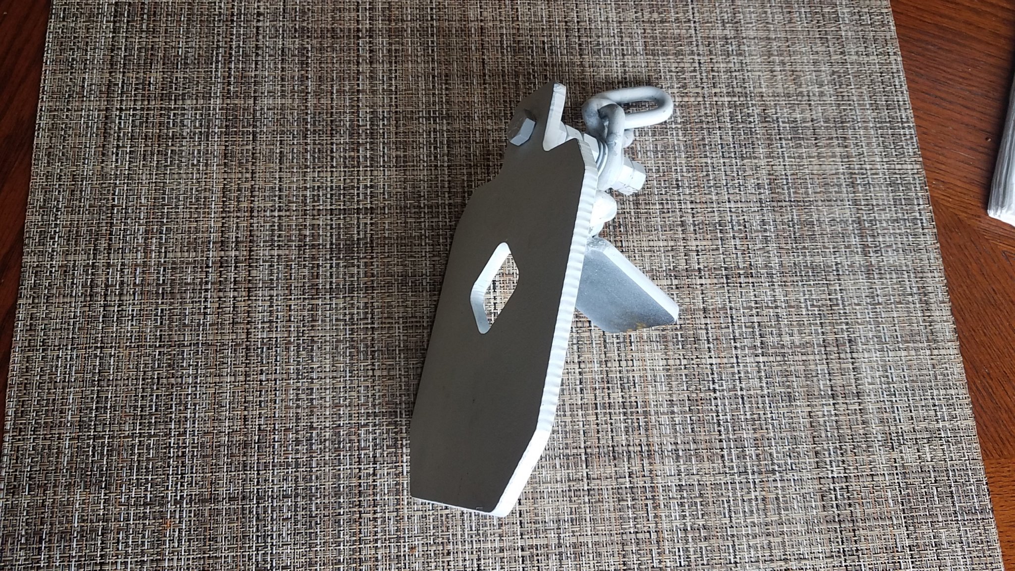

I like the reactive / flapper targets. Big Dog Targests has few couple of rimfire options, 25% IPSC is fun. I ended up cutting the mount off and drilling a hole
http://www.bigdogsteel.com/rimfiretargets.html
I don't recommend that flapper 25% IPSC target. It's very unreliable because you have to get the distance just right for the power level of the ammo to get the flappers to go back and forth even somewhat reliably. Bigdog should have thought about the design of this much much more!
Yeah, I noticed that on the web site the flapper goes side-side, but both of mine swing up when hit then gravity does the rest. Fully agree, if they go side-side, that would be an issue.
