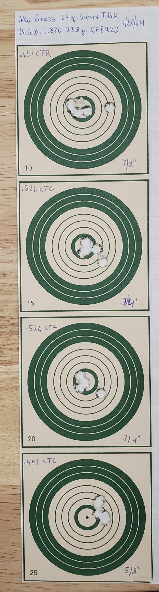

These are the 5 shot groups from my last visit. I started at 100 yards and the starting powder charge. I want to achieve more consistancy (i.e. tighter groups without flyers). My current twist rate handles bullets up to 70 grain, a 1:8 barrel will go up to 80 grain which should be better for longer distances. I want to consider all options before adding more hardware. So please keep the suggestions coming.

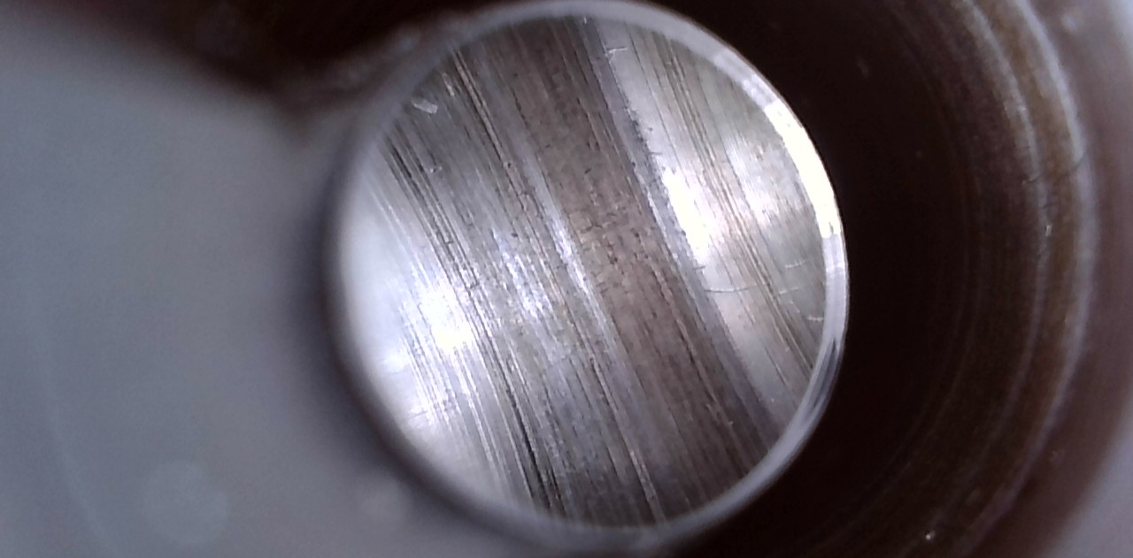

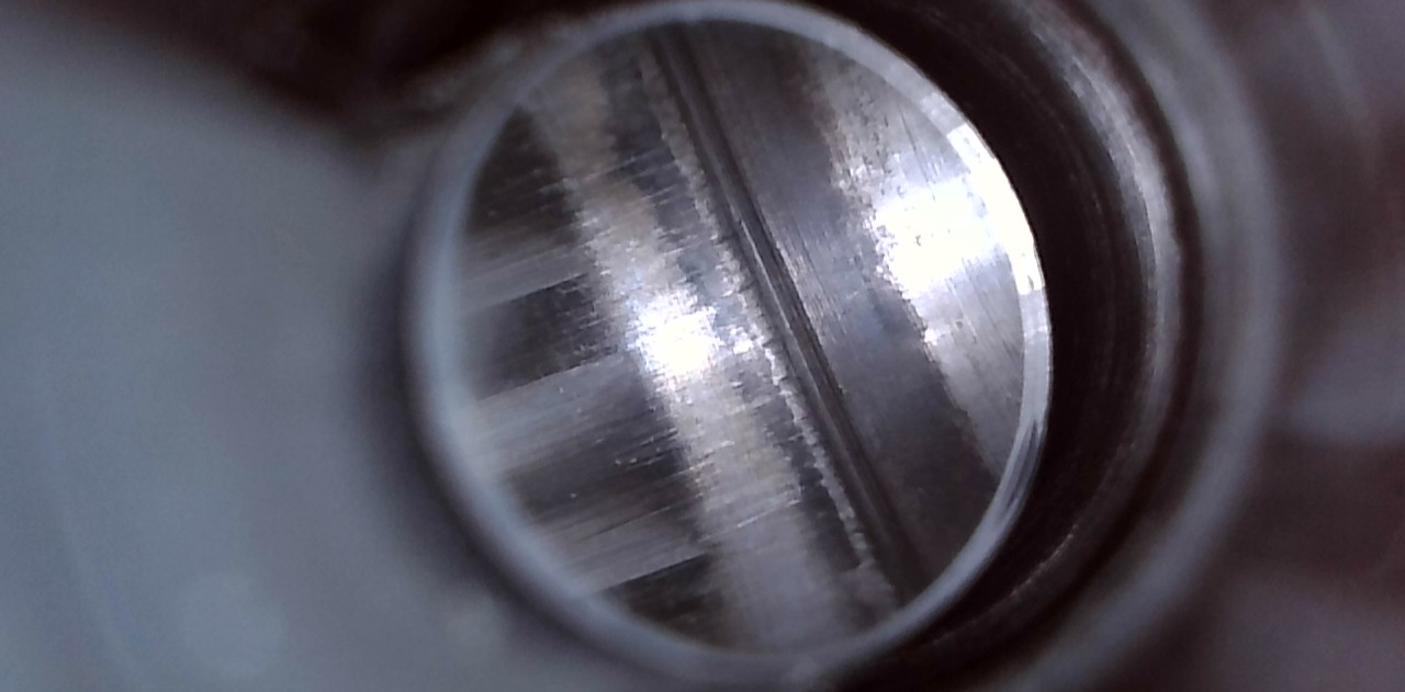

I also ran the bore scope tonight and found these two rings, the first right before the leads and the second maybe an inch back into the chamber. I assume the second ring forms at the case mouth. Do you have any thoughts on these?
Cleaning down to bare metal after every 25 rounds is probably overkill. Ask 100 different people though, and you'll get 50 different answers.
Personally, I go after the copper fouling between rounds 100 and 125, and I remove all of the carbon (clean completely) at 200 - 250 rounds. I haven't seen a degradation in accuracy across many barrels yet, so I'll stick with this process for now.
your first pic looks like the "carbon ring" that forms at the case mouth. I'd research that because there is already a ton of good info on it within this site.
The second photo could be one of several things, including a case that is charged to the lower end of the spectrum and isn't expanding enough in the chamber that gasses are able to flow back around the mouth and down the case...but that diagnosis requires brass inspection and I'm just spitballing based off of one photo.
Thanks, I didn't expect anything significant when I put the bore scope in last night and was surprised to see the two rings. The accuracy fell off just a bit at the last range visit and that combined with how difficult it is to clean the rifle each time made we wonder what's going on.
