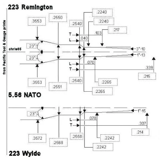

So i'm understanding three options to achieve this:
  • use either a custom reamer with the longer throat, say .100-120? What brand reamer?
  • cut the chamber using a .223rem SAAMI spec reamer and use a throat reamer to push the throat to the desired dimensions after chambering
  • cut the chamber using a .223 wylde reamer and use a throat reamer to push the throat to the desired dimensions after chambering
Also note, I already have a .223 Rem SAAMI reamer.
any preferences one way or another? Is it better to start with the .223 Wylde, with the wider tapered neck dimensions, or .223rem SAAMI spec?

The Wylde chamber just tightened up a NATO in the neck and freebore. It's really not a match chamber. It does work well in an AR though. In a bolt gun using a tighter body and freebore will work better.
If you already have the 223 SAAMI, then definitely just add the 224" throating reamer to push the freebore out to .125" or a little longer.
