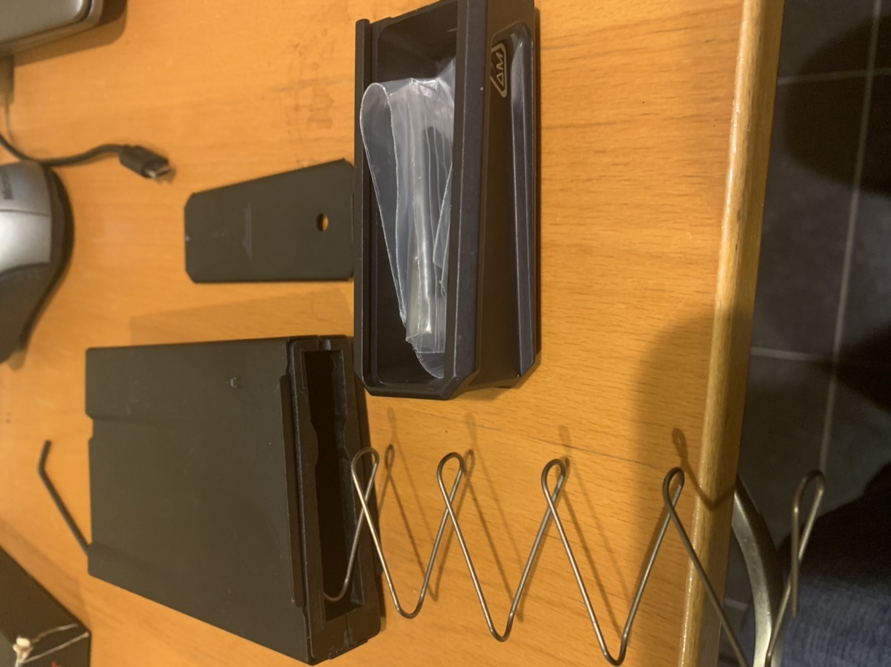

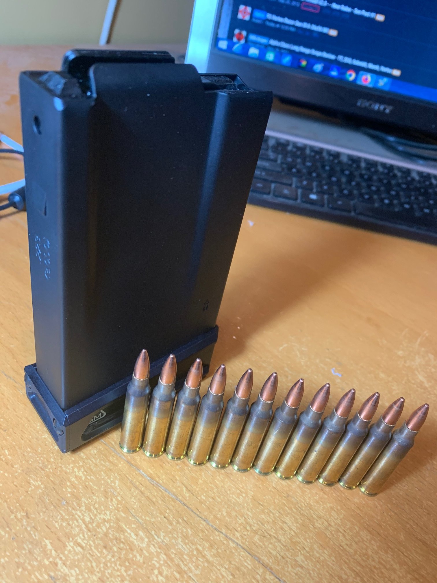

Just wanted to follow up on the mag. With a little effort the Accurate mag extension can be made to work.
Delrin filler in extension milled to 2/3rds depth of extension.
Holds 12 rounds with 1/2 round extra clearance & spring pressure is good.

We really need someone like MK machining to print 223 fillers for AICS mag extensions. I think they would be a very good seller.
