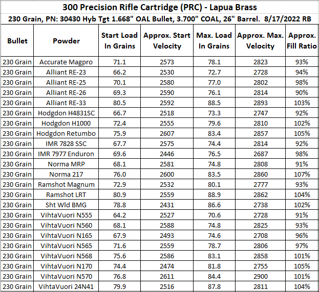

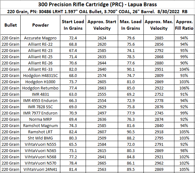

Maybe you should try 25" and N568....
if anyone has access to Quickload, would be keen to see what it spits out... just having heard about it...
300 PRC
ADG Brass (93.2 gr internal volume/water)
Federal Magnum 215 Large Rifle
Hornady 230gr ATip
24" barrel
Option #1 Vihtavuori N565
Option #2 Hodgson H1000
G

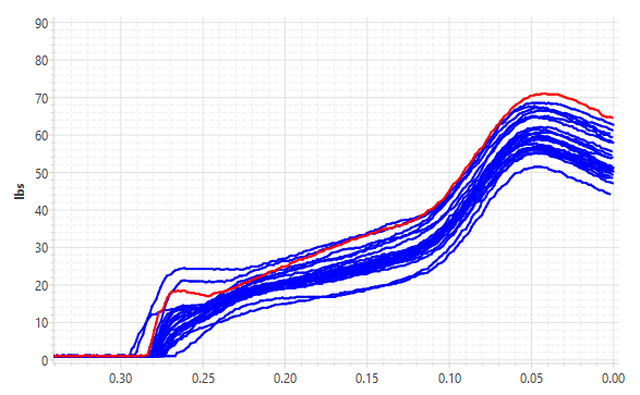

So you barely have any neck tension?!
It gives me plenty of neck tension ... here's my last seating force curve from my AMP Press. I've observed that terminal force of around 60-ish pounds is just about perfect. I anneal everything, shrink with the bushing, and expand with the mandrel that gives me the spring-back I need for the seating force (AKA neck tension) I'm looking for. It's a myth that a .308 mandrel will give you a .308 inside diameter. Well-annealed brass will always spring back ... and for me that .308 mandrel springs back to just the neck tension I'm looking for. Make sense? Others may do it differently, but this is what works for me.
20's and 30's ... I worry about the rifle recoil impacting my seating depth in the magazine.
80's and 90's ... I worry that seating force is high enough to impact bullet release.
50's and 60's ... I don't worry about seating force or neck tension and that frees me up to worry about lots of other things.

graph looks good, as long as it works for your application. I only single feed. Did you try different neck tensions to see how do they affect the vertical?
I did tests with larger and smaller mandrels for all of my competition calibers. The results for literally all of them indicated that this profile (50's and 60's) gave me the tightest seating curve, and the best SD's. Never got around to testing down to "Group Size" granularity. Zero'd in on my best SD's, declared "Victory", and moved on.

This is very interesting. What is your process to ensure your getting spring back the correct way? Ie. If your brass wants to spring back to a larger diameter than the bullet (like from a fired case matching chamber diameter) when using the 308 mandrel vs a smaller diameter so it will hold your bullet and maintain that 50-60 psi?
First ... just for accuracy, the AMP Press measures "pounds of force" ... not PSI (pounds per square inch). That said, I'm not sure I understand the question. But let me try answering it by saying I've got the full set of 21st Century mandrels, and a bunch of different bushings, so I've been able to test combination to derive the right seating force. Smaller bushing means tighter neck and more ram pressure to open up to a larger mandrel size. Larger mandrel sizes mean looser neck tension. And so on and so forth. Bottom line, I've learned that the .333 SAC Bushing used with the .3080 21st Century Mandrel ... gives me the seating force curve I'm looking for, single-digit SD's, and good accuracy at distance. Once I hit that "sweet spot", I stopped testing and locked it in as what I call my "Reference Load". Does that help?
Yes it does help. My question wasn't very clear though. Let me try to ask it in a better way-
If your getting spring back what is the required status of the brass to ensure it gives you spring back that makes it spring smaller rather than larger. For example, you have to resize it a certain amount forst first and then mandrel to the .308 diameter. Does the bushing size in your sizing die matter in relation to your end result of 50-60 lbs?
I get it (maybe). You're looking for "the answer" and I'm talking about "the process". First point is that I've never experienced "spring back" making anything spring in the same direction as the force. For me, when you stretch (or compress) something ... like my .3080 mandrel stretching a smaller case neck ... the result is always adjustment in the opposite direction of the force. In this case, the force is to enlarge the case neck, so the spring-back would, on a properly annealed case, tend to move to an opening smaller than the mandrel once the mandrel is removed. Now I could use a bigger bushing and not use a mandrel. I could also skip the bushing and only use the mandrel ... but that second one would require different dies than the Redding Type-S FL Bushing dies I use, and either of those would likely damage my concentricity, which is almost always sub-one-thousandth on the finished necks (and "NO" I don't neck-turn and I don't let my friends neck-turn). The bottom line here is that for each of my long-range calibers (6.5-CM, 300-WM, 300-PRC, 300-NM, and 338-LM) I have a bushing that shrinks the neck slightly below what I want for my final neck size, and a mandrel that takes me slightly (very slightly) larger than my final neck size so that my well-annealed brass, in its final act of mutual cooperation, springs back to slightly less than the .3080 opening and gives me the end-state seating force I'm looking for. It's just by coincidence that for 300-PRC, I get this result with a .3080 mandrel. That's not the case for all of them, and for my 338-LM, I have to open the neck quite a bit more than I would with a .3380 mandrel. The bottom line is that "seating force" on my bullet seating (measured on my AMP Press during bullet seating) is the end-state that gives me the best and most consistent velocity, SD, groups, and accuracy at distance ... so I start with that, and work backwards to get the properly-tuned bushing/mandrel combination that gives me the seating force I want.
Caveat ... this is how "I" do it, and what works for "me". I'm sure there are at least 837 people reading this that believe I haven't seen the ball since the kickoff, and that I'm doing it all wrong. They may be right, but as long as I can hit a mile target with my hand-loads ... they can kiss my fat hairy ass and just watch the red light pop on the target as they heckle me from the cheap seats. LOL
Very fine, sir. Very fine.
It seems as if you have to tune your process with the type-s neck bushings just as much as with the mandrel sizes before you have it the way you've found works the best
True statement. The question I always wanted to answer was ... "I have this used case with a big neck ... what's the least I have to size down (with a bushing) to give myself the least I have to expand (with a mandrel) ... to give me the seating force I want for the bullets I prefer?"
I know ... it's a complicated question ... but it works for me.
