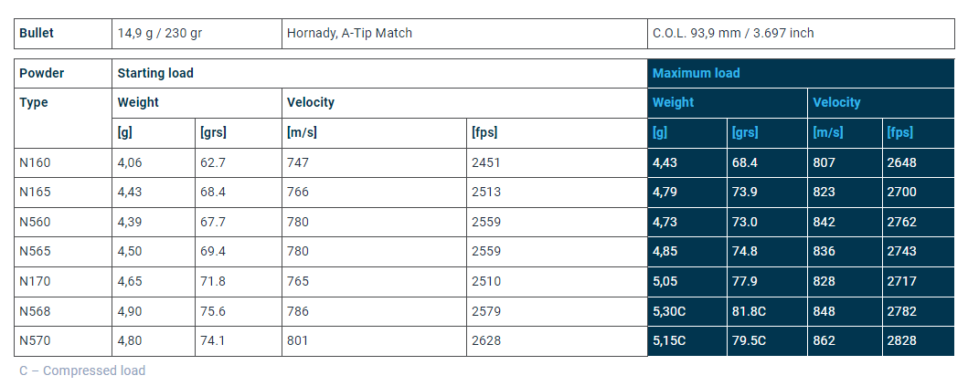

I finally got off my butt and started working up a load for Vihta Vouri N-568. I'm basically seeing a trend similar to that shown on Vihta Vouri's website:
So VV ran ~7 grains more 568 than 565 at max load and got 39 FPS higher muzzle velocity. I only have limited muzzle velocity info from my gun for 565 at low temps. It's a little freaky seeing their max for 565 at 74.8 grains while I'm running 78.0, but I digress. For 568, I only pushed a ladder up to 82.5 grains and I got about a max of a 15 FPS bump in muzzle velocity, but remember the 568 rounds were shot around 50F and the 565s were shot in the 80-90F range.. So consider this a preliminary bit of info. I'm planning to load up an OCW with narrow bumps in charge in the 81 to 83 grain range. Not sure how high I can go because I've never tried to push the limit on compressing a load.

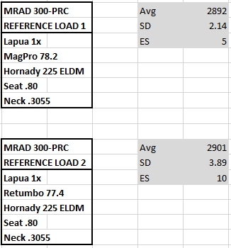

I have two "Reference Loads" (AKA: OCW's) for my 300-PRC ... a Barrett MRAD. Figured I'd share them here. One is with Accurate MagPro, and the other is with Hodgdon Retumbo. Both shoot sub-MOA and hit 1-mile targets (when the human functions correctly). Developed two options due to supply availability. I also have a recipe for Berger 220's, but (a) I can't find anymore, and (b) it's slightly less accurate (SD's of 5-ish).
So...my load for the 1 mile Benchrest Tactical Division....Record Score of 39....was shot with a 245gr Berger at 2925fps with 76 grains of RL-26. Still my personal pet load. I'll stick to that as long as I can keep getting more Bergers.

80.0: 2774
NOTES: started a little low in absence of published load data, none of the 4 signs of over pressure, yes i see the anomaly in MV and will continue gingerly, as I only have so much case space.
