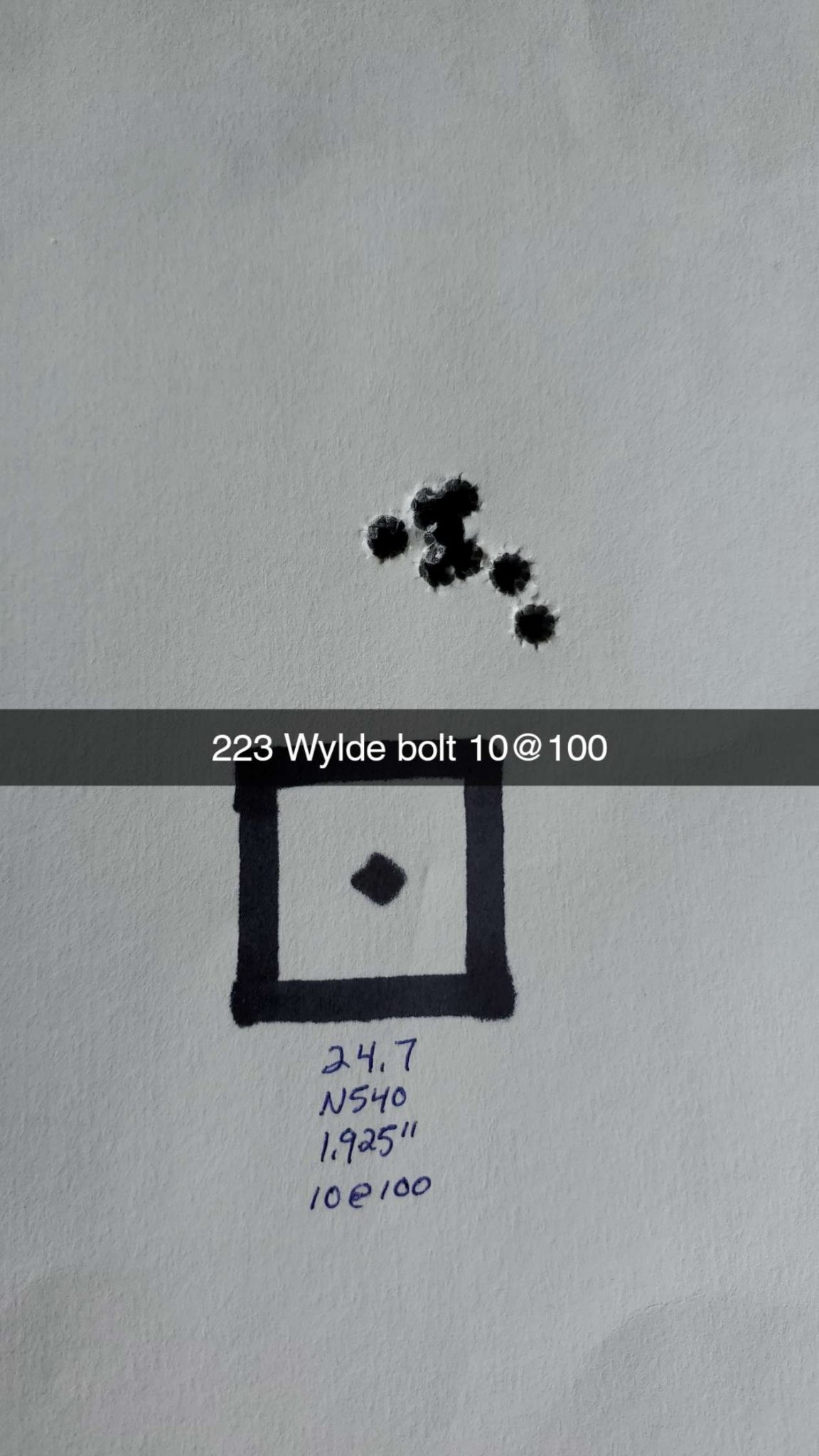

Loaded up 10 rounds to shoot a 10 shot group at 100 yards. Figured if it went 1 MOA or better I'd run with it. First 5 were a ragged hole, then had a couple stragglers, followed by the rest in the same hole. 8 shots went 1/2" with the other 2 making it .85" Velocity is 2975fps. I blame Hornady bullets. They aren't exactly match grade by match standards...I may give the 80.5 Berger a try and see how much more accurate/consistent they are. These 75g ELDMs have been pretty picky and touchy. But I can live with it for now I guess. Time to load up a 100 and get a good dope chart from 300-1200 going.
