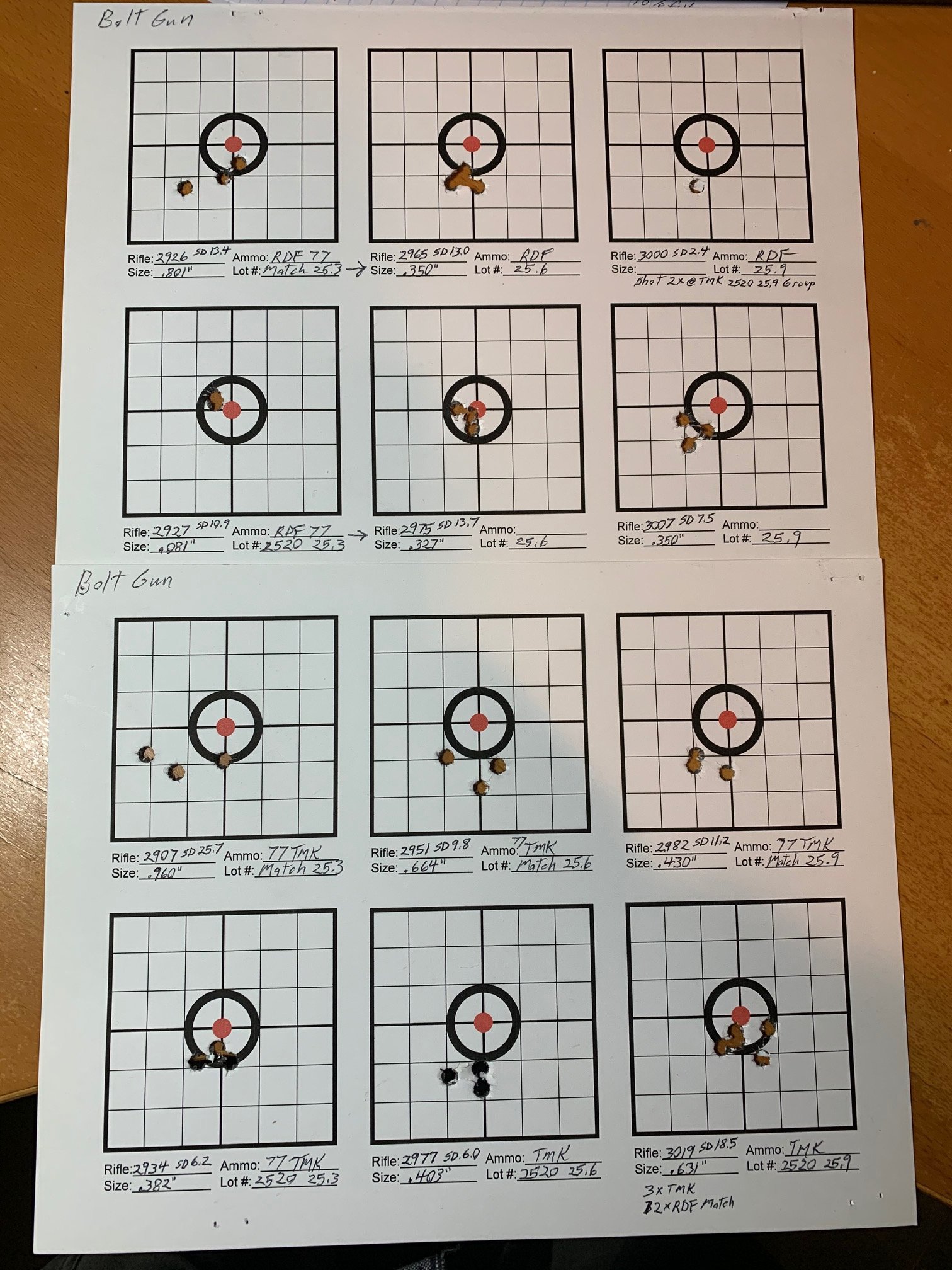

Here is a first attempt comparison in 8T 223W 26" Bartlain bolt gun.
No load development. This was first loads comparing Staball Match to 2520 & 77TMK to 77RDF.
FWIW 25.3 of 2520 behind 77 SMK or RDF is lights out in my 18" AR also.

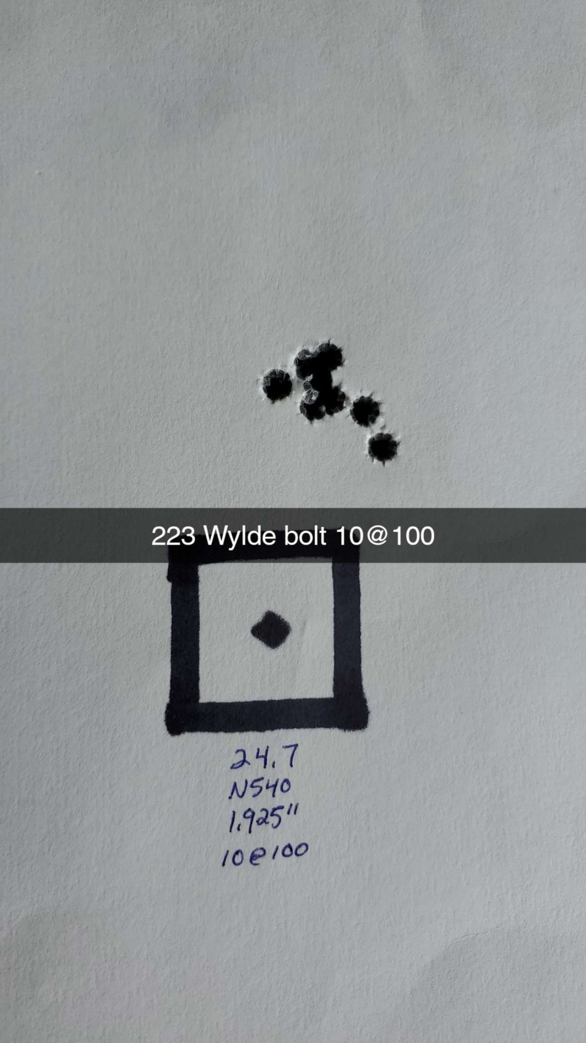

I should be able to run the 80.5 around 2900 accurately from a 28" tube and N540, but we will see here shortly. If I can get it to 2900, at my low elevation of 500 ft, that's get me to right at 1K before I go trans sonic. The 75g ELDM at 2975 gets me to 1050. The 75 ELDM still beats it in drop/drift also, but it is what it is. I definitely don't want to shoot a .400 BC bullet from it when I'm trying to shoot 1K, that just doesn't math out at all, and puts me around the 800 yard mark before going trans sonic. I'm willing to pay the little extra for Berger's if they'll shoot a bit better and a lot more consistent than the 75g ELDMs. So stay tuned, I may have 1500 ELDMs up for sale here soon haha.

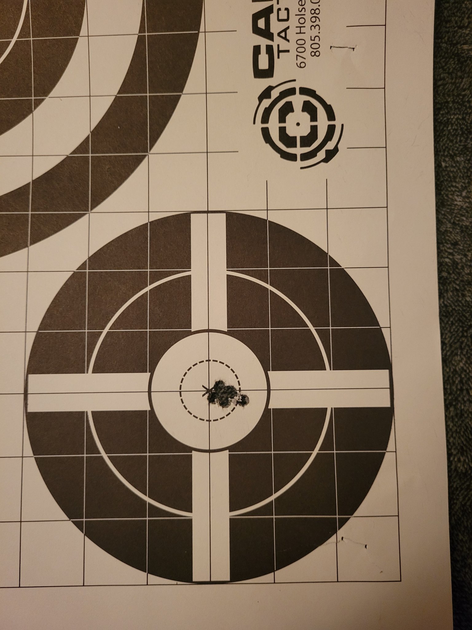

I was able to get out last weekend and try the sierra 80 smk loads. This was with 24.5g of varget and about .020 off the lands. Well known high power load. Also for comparison I will put up the pictures of my typical groups with the hornady 80 eld. Orange targets are the hormadys. I will be sticking with sierra.

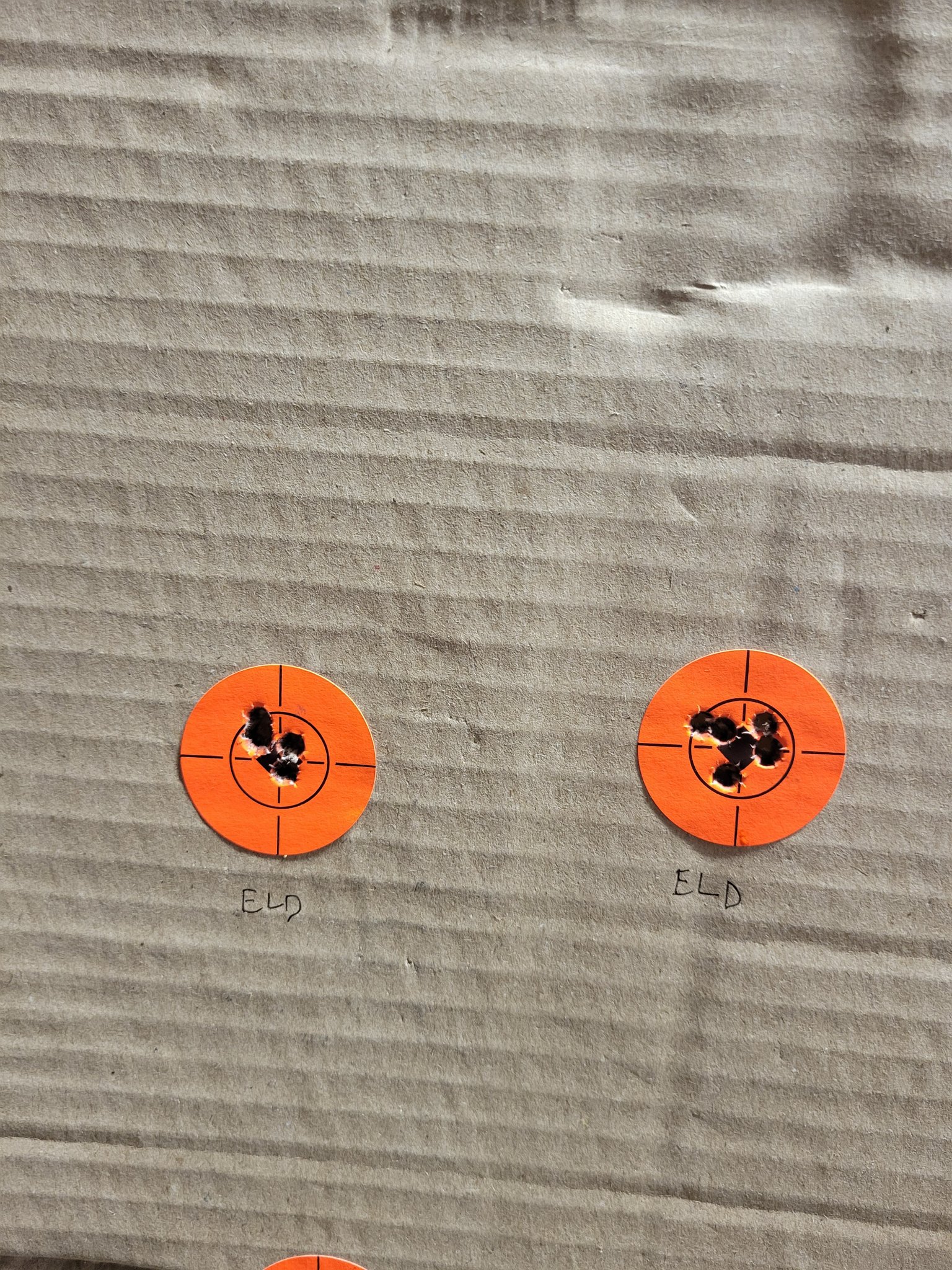

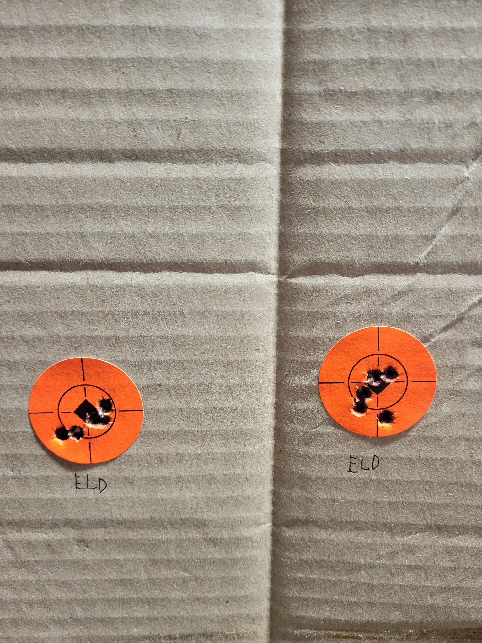

I just did a 10 shot group at 100 today with the 75 eldms. The first 6 made a ragged hole, and the last 4 opened it up to what you see. As it is, 8 went into .5" with the 2 lower right making it .85" It's about as good as I can do with these 75g ELDMs. Not great, not horrible, but I'll take it for what I'm doing. Still might try the 80.5 Bergers just to see how much more accurate/consistent they'll be. I think anytime you can get 10 shots sub MOA, that's pretty alright though, especially for Hornadys haha.
I'll shoot the rest of my hornadys but I won't buy anymore. I've shot the 77 smk with 3 different powders now and they've all shot excellent at 2.260" oal. Jumping a mile. The 80 smk seem to shoot just as good and my sd/es was low teens. 24.5g of varget put them at 2750 fps out of a 24" barrel. Could probably go hotter but I don't really see a need. I can clean the plate rack at 600 yards with the 77s at the same speed so the 80s will only be better. I'll take that and have better brass/barrel life.
