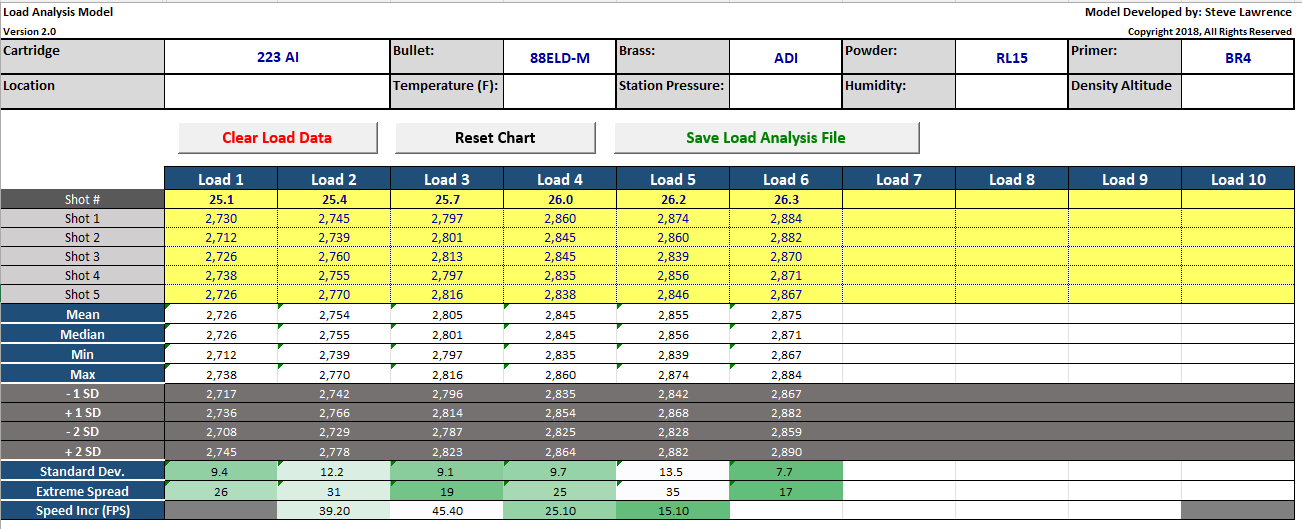

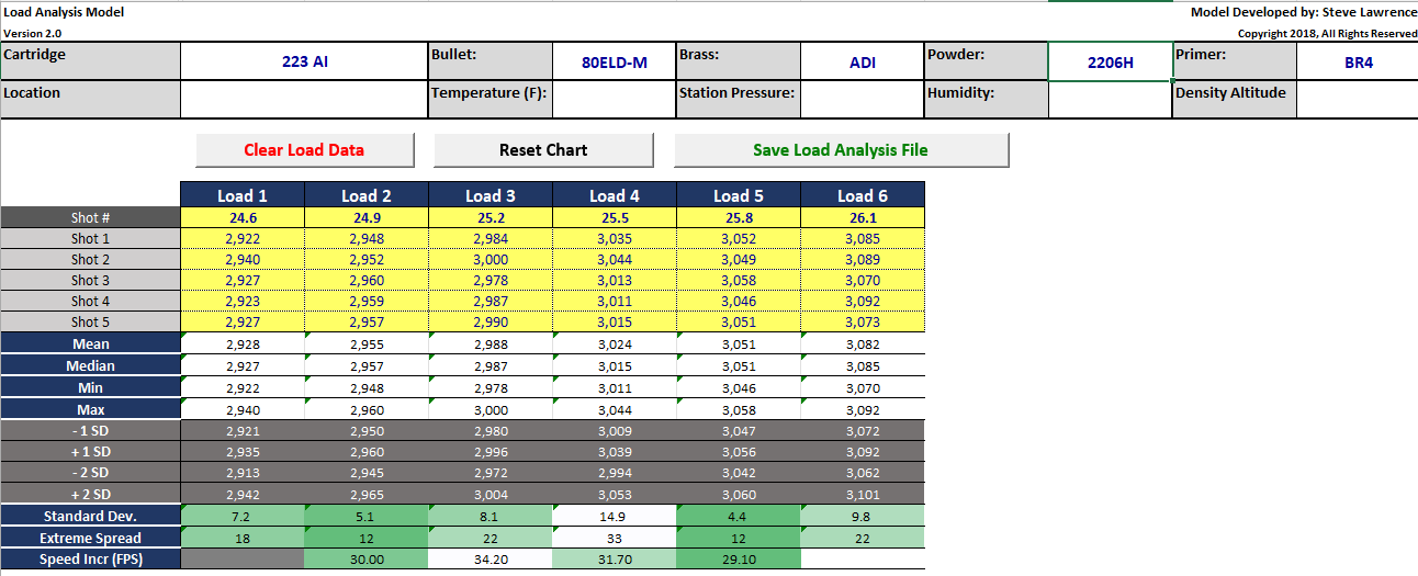

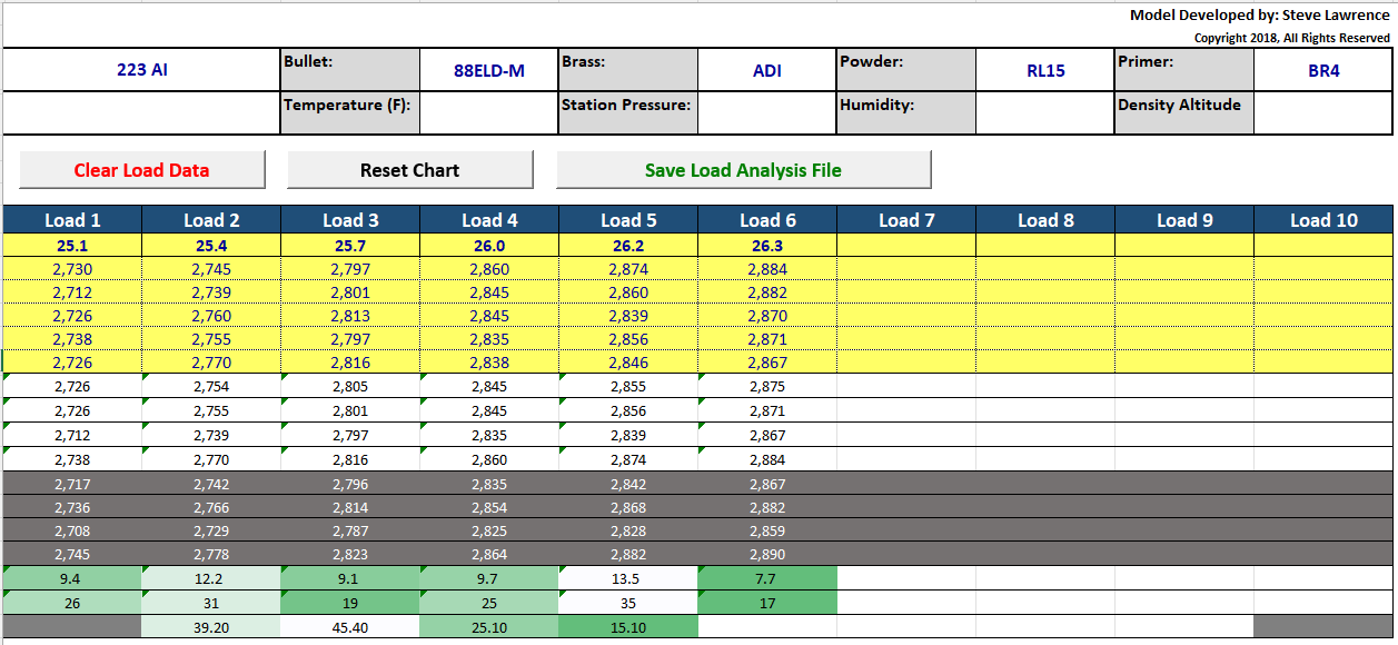

These are the load development tables for what I use, for 80 and 88 gn ELD-M's. Both are with ADI brass and BR4 primers in a 25" 1:7" twist IBI barrel. Powder is ADI 2206H (H4895) for the 80's and Reloader 15 for the 88's. I fireform with 25 gn of 2206H and an 80 gn bullet, or just use factory buffalo river ammo (which uses ADI brass). They pop out perfectly with either. I use the 25.8 load for the 80's and the 26.3 for the 88's. Both are really accurate.
Reactions: camocorvette

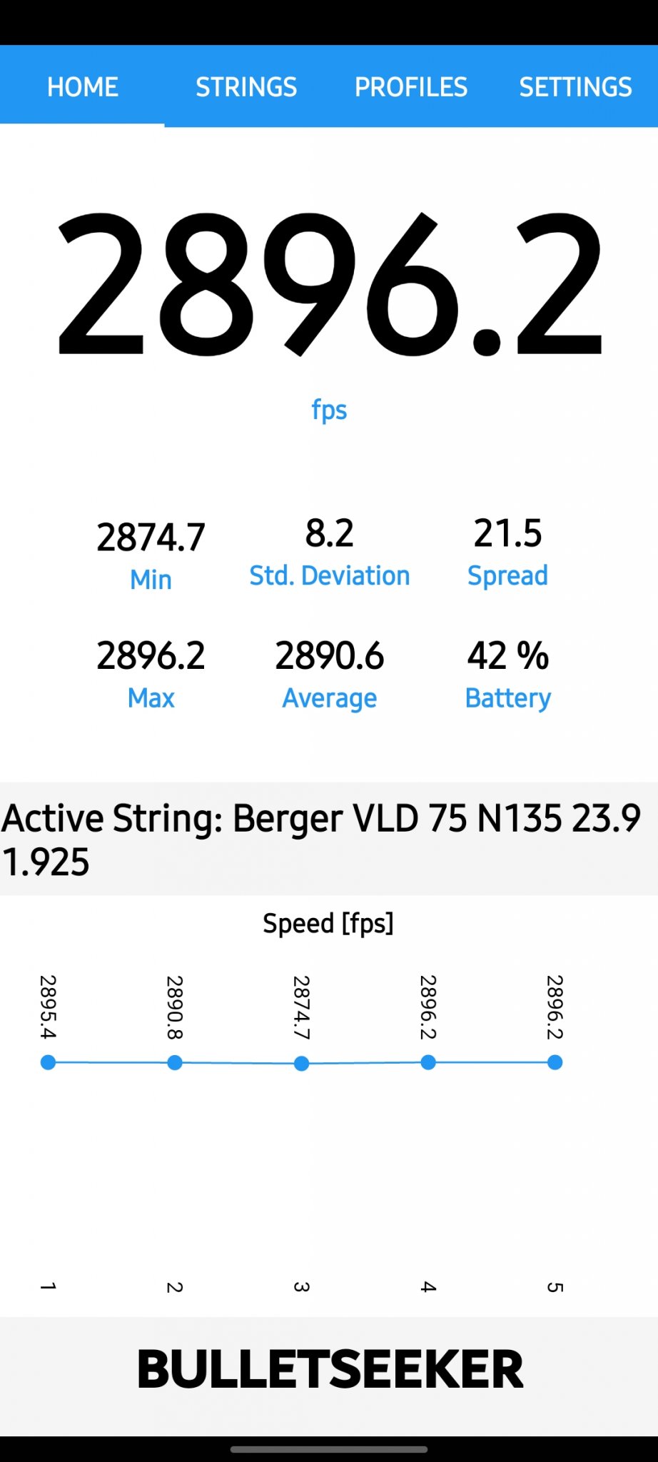

I loaded up 25.1 of n140 with Berger vld75 and lapua brass for fireforming. I'm curious though about some lapua brass I have.. its been fired 6x still looks great and I anneal everytime is it safe to fireform it to 223ai? Current chamber is 223 wylde
I was getting 2850 with that XBR load. But it was hot. Some of these loads I can only shoot with Lapua brass as LC and others blow out. The n140 load can be a bit hot, but that h4895 is low pressure and just stupid accurate.

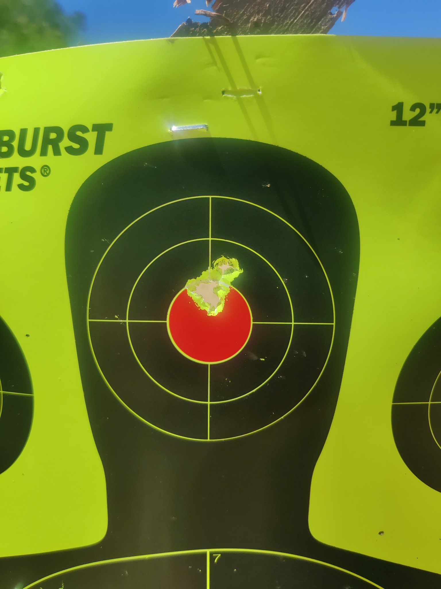

Here's 10 shots as fast as I could get them off. The barrel has 2k+ at this point and just as accurate as when I started.

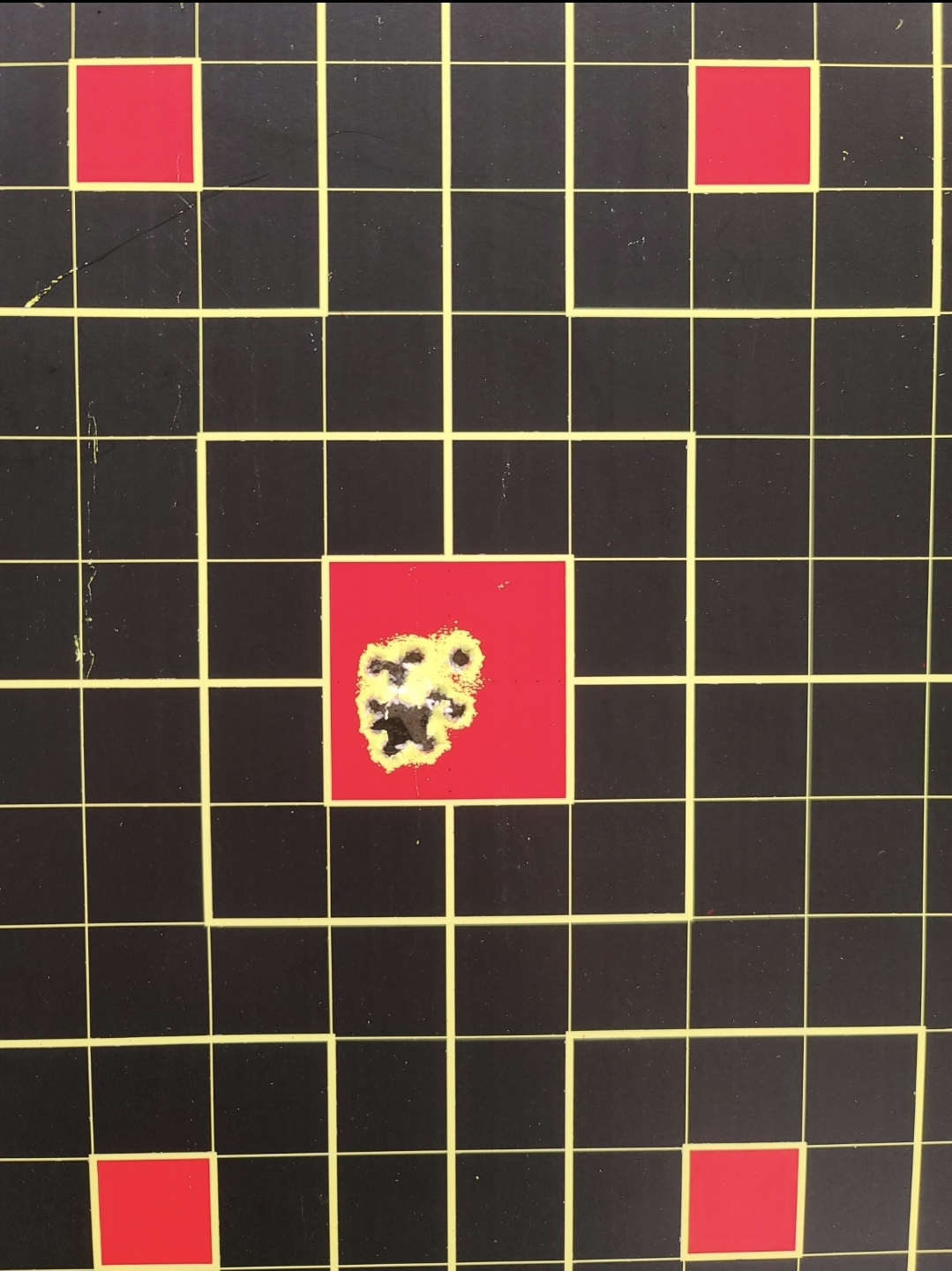

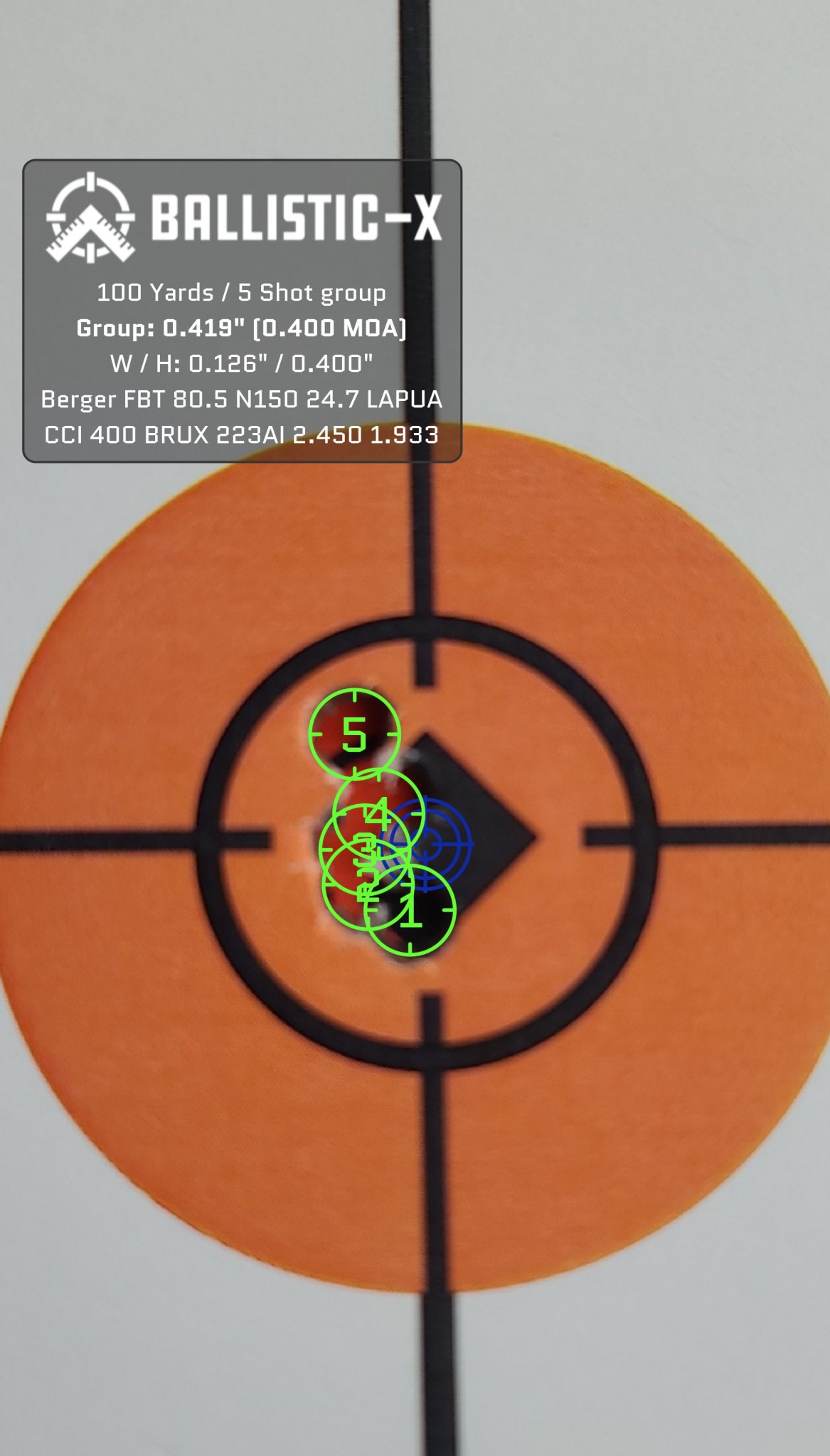

I ended up getting out to the range and got 101 rounds fireformed for the brux 223ai. Sight n see is the first 25 rounds in a break in cleaning regimen. Then the group shown was toward the end.. I'm pretty excited to get some loads worked up for this.
