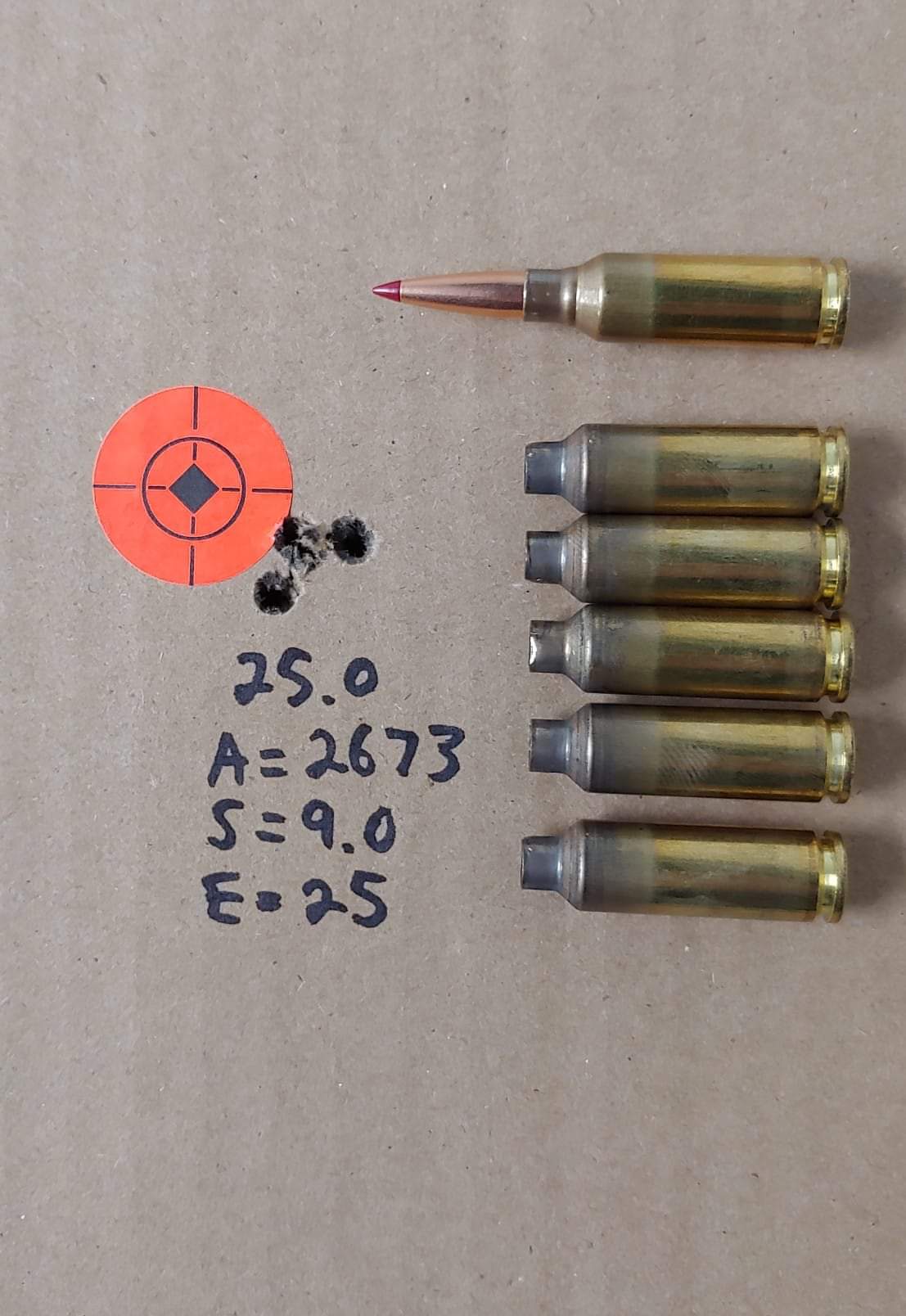

I chose .224 Valkyrie because of the availability of factory ammo. It's nice being able to just grab a box and go instead of loading. Unfortunately I just now got my barrel (ordered December) and this is my result with factory ammo.
JP barrel and internals. Mega MML receiver set. JP sent a memo about factory 90 SMK not meeting their 1 MOA Guarantee. I was under the impression it was shooting 1.5 MOA or so, not 4.

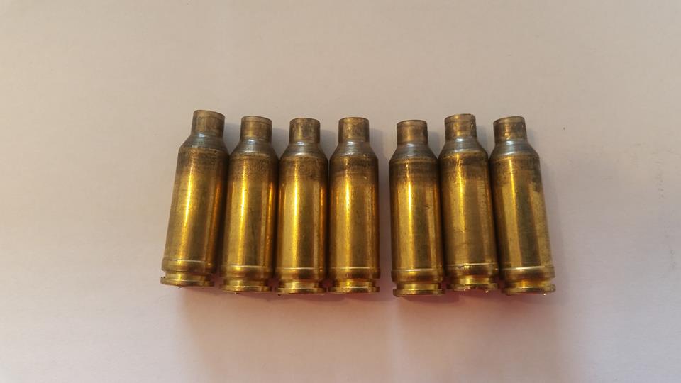

This is a 224 Grendel blown out. Works in both an AR-15 and a boltgun. You get 6 Dasher ballistics out of the AR-15. It can send the 95 SMKs at over 3000 in the boltgun if you throat it for them.
Not hardly. A 6mm Dasher or BRX in an AR15 will push 105s to 3100 out of a 22" barrel. A 224 Grendel RAT will barely push 80s to 3100 out of a 22" barrel with accuracy. I've been shooting several Grendel cats since 2007 when Whitley first made the 6mmAR. This is what happens when you push Grendel cases to hard...the dreaded Grendel belted magnum

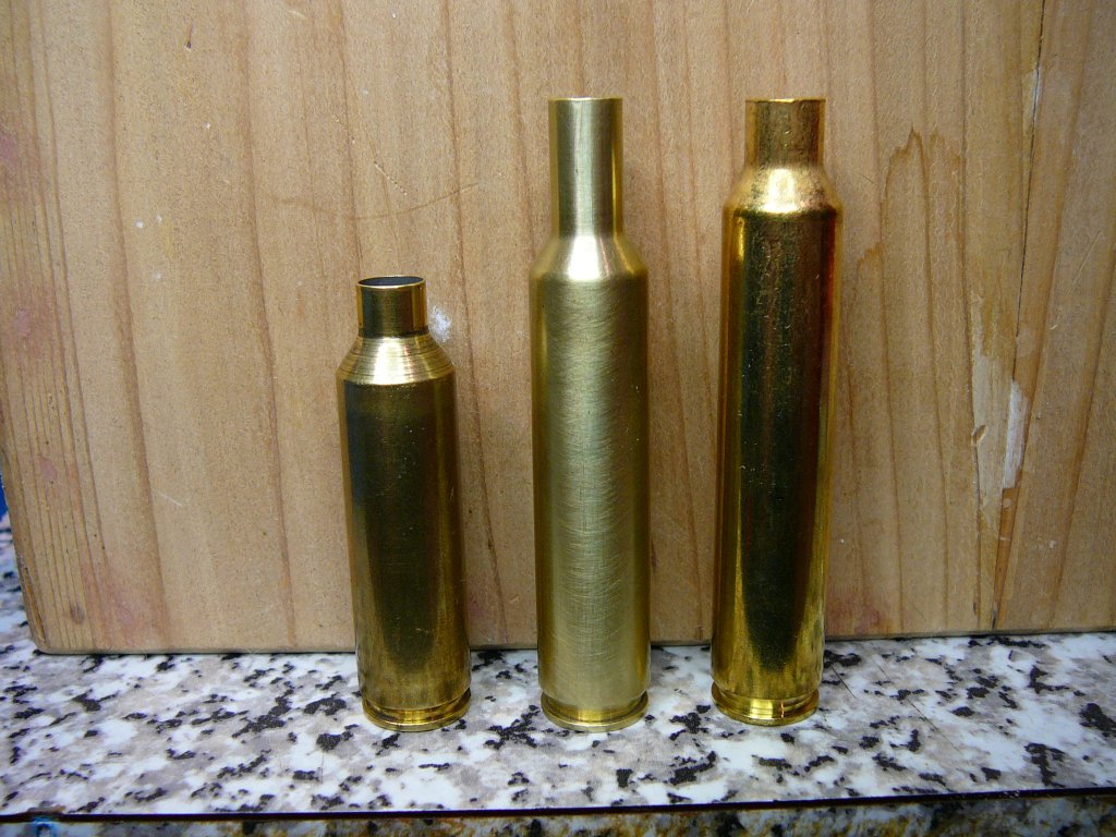

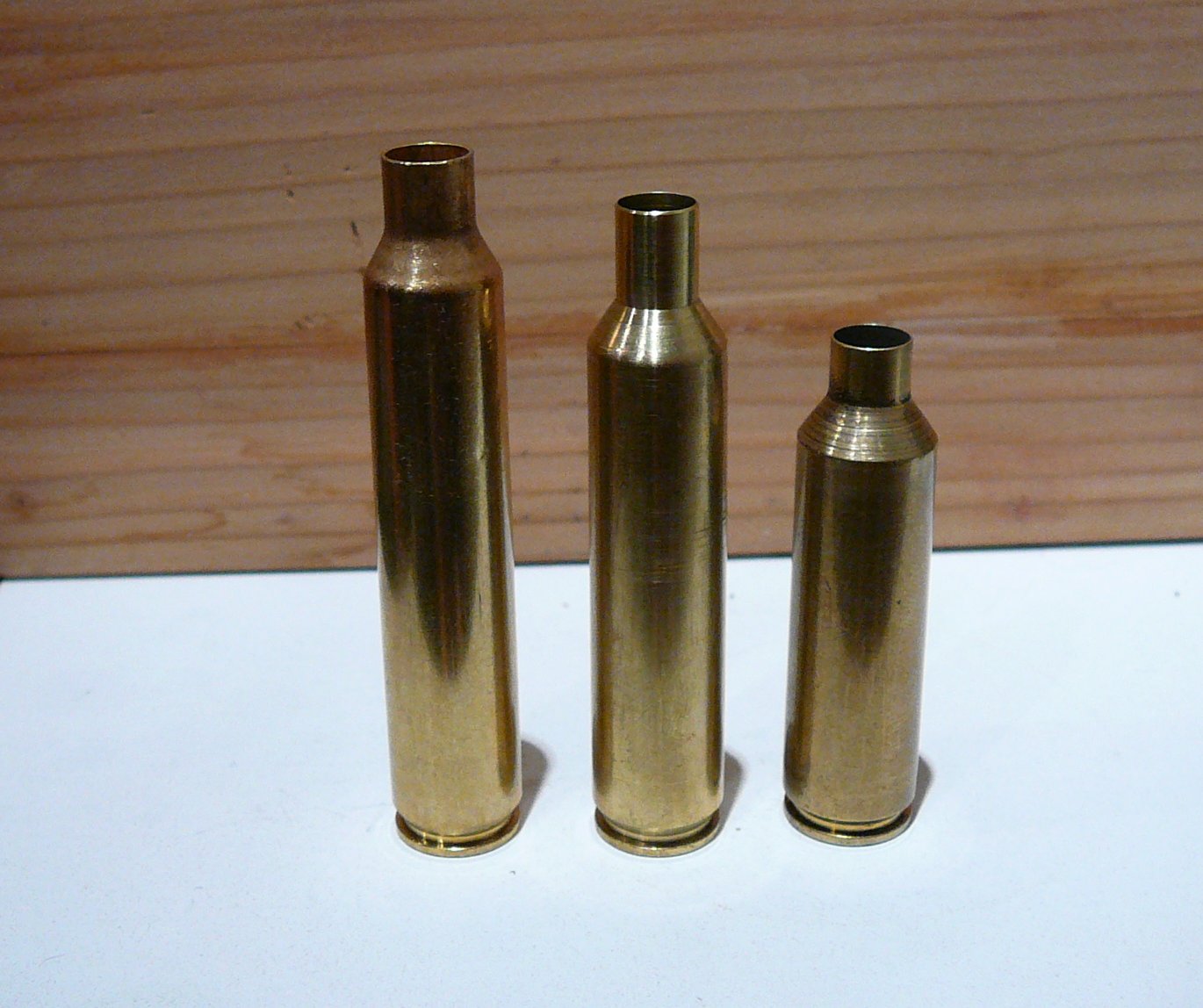

I made a long neck + shoulder bump bushing that replaces the internals in a Redding Competition seater die. The shoulder is set at 20 degrees. I adjust it so that the false shoulder is in the right location. I just lube the neck on a piece of 6.5 Grendel and run it into the die, then wipe off the grease and load it. If I run a mandrel into the neck, then run the case into my 6mm Fat Rat sizer with a 0.251 bushing it'll shoot a little better. But, I don't really find the need to do that on fireforming loads... Any 22 cal. sizing die with a 20 degree shoulder would work if it accommodated the Grendel case. Just cut it down to fit. The Lee 224 Valkyrie seating dies works perfectly with it without any modification. I modified a Lee 224 Valkyrie Factory Crimp die to work with it, but haven't found the need to use it yet. I have a Whidden 6mm Fat Rat set I use on my Co-Ax for the boltgun. I use the Lee dies on the Dillon for the AR.
If you want to move brass easily use 20 degrees. Here is a die I made for a Custom 7mm round I created that used a 300 RUM as the parent case. It was between a WSM and a RUM in size and had a 35 deg. shoulder. I bumped the shoulder down in steps at 20 deg. then formed the shoulder. Ended up with cases that were equivalent to factory brass without having to do any major fire forming.

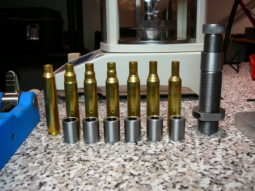

Can you give us run down on how you're prepping brass?
On lapua Brass I turn the necks to .013”, lube brass with imperial die wax, I have 3 Redding type S FL bushing dies set up in my 650 with my expander mandrel in last stage. I use the same two bushings you started with but use a 251 final bushing on starline and lapua ( I don’t neck turn starline or Hornady) for .002” neck tension. I then tumble to remove wax. Anneal the brass. Trim, chamfer, debur, prime, drop powder, seat, shoot, smile

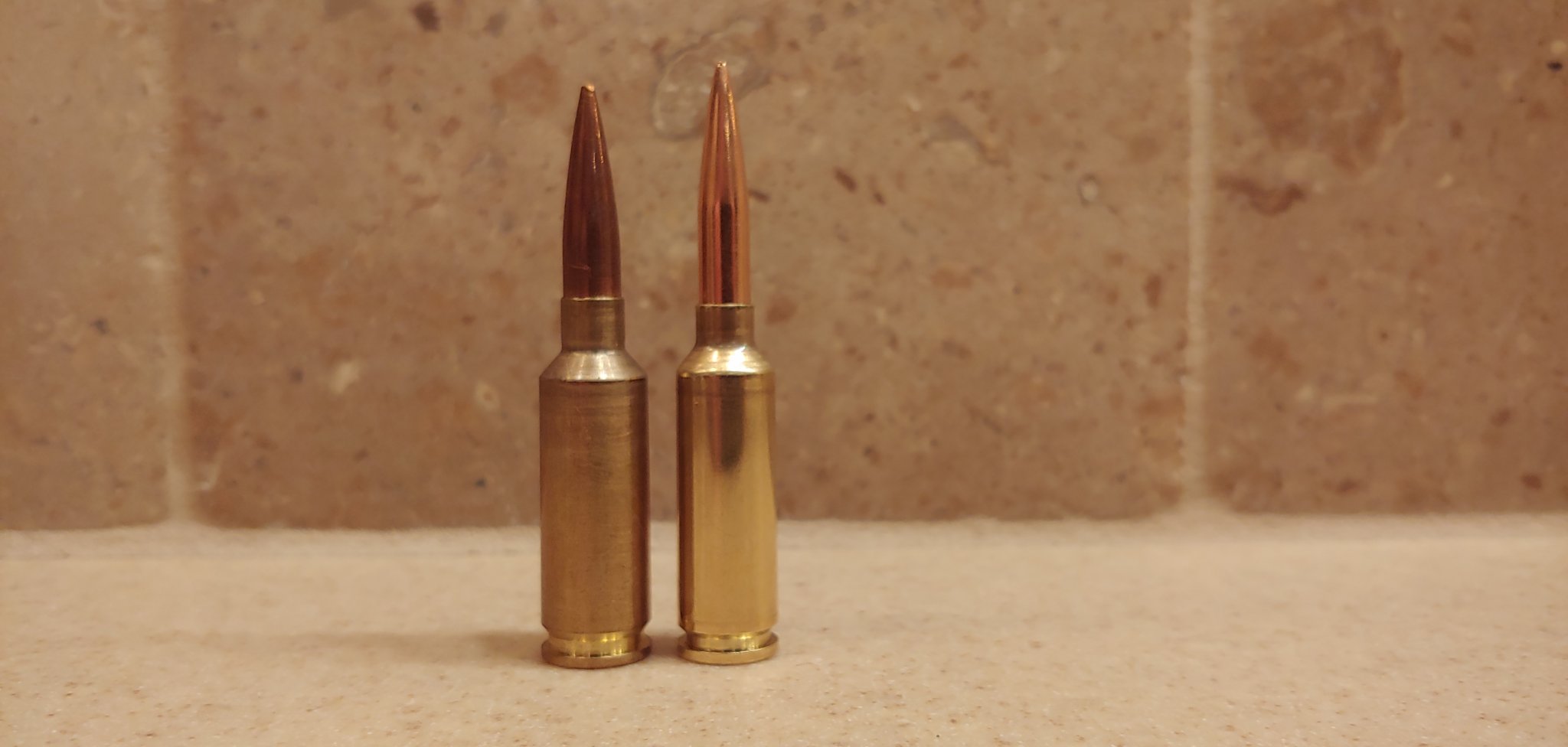

It is a 224LBC reamer from JGS, should be the same as all the other 224LBC and 22 Grendel reamers. I didn't try any 88s but this is what I was loading to.
95smk
2.273​
80 berger VLD
2.224​
80.5 berger
75 Horn
2.085​
80 Amax
75 Amax
2.22​
75ELD
2.24​
77TMK
2.17​
