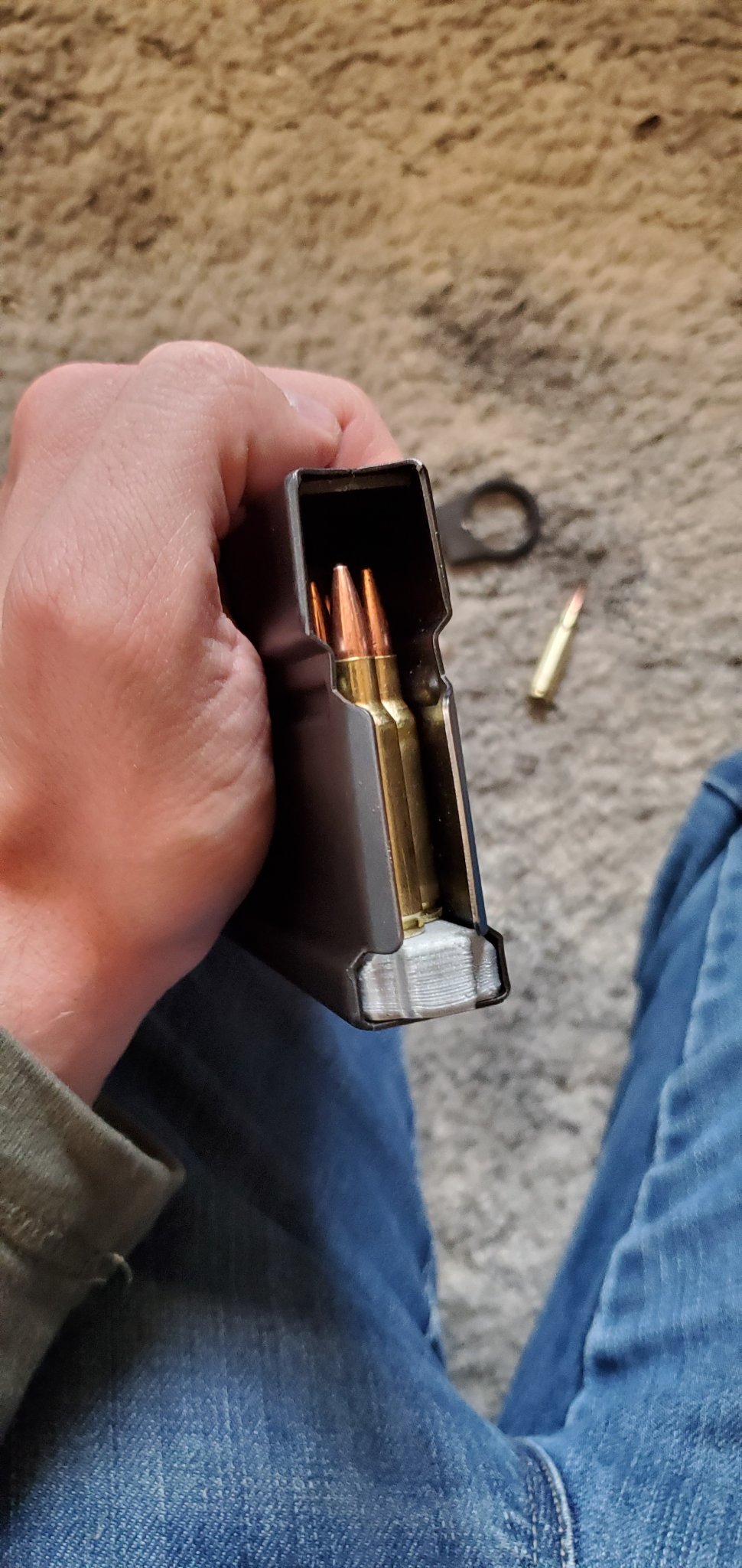

Thanks for the ideas, I did quickly hit the feed lips to smooth them out.
One thing I forgot. The second round almost always is loose and can be removed and the rest of the rounds are froze.
So now that I'm thinking about it... it might be the pressure on the 3rd round causing it to catch. I'll grab my gun and play with is some.
Starting to sound like the follower is binding or trying to turn sideways or something.....when I did mine I did all kinds of things to work and it works really well actually. I fiddled with everything, squeezed the mag, bent the feed lips, sanded ect., it has pliers marks all over lol, but fully functional from first to last round.
Keep fiddling with it until you either get tired of it or it works.
Is that a 5rd mag or 10rd?
It's a 10rd mag, I'm fairly convinced it's a follower issue. I recreated it and felt with a my knife and the rounds were loose as far as I could feel. If I were to load 9 itd work flawlessly.
Ive read about some people using dry lube but I dont know if there is a kind that works better than others in regards to magazines.
Quick follow up in case anyone comes here looking for answers. I used some graphite lube on the follower and the front (lobe?) of the box and it's working nearly 100%. I used the spray on lock lube that dries and leaves a film.
