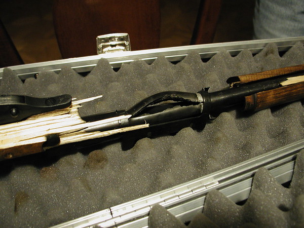

My 18" Grendel gets about 2530fps with Hornady factory ammo, so it is about in line with what you get out of the 20" barrel. I am close to sea level to it goes subsonic right around $1k or just after if I end just a bit higher in altitude. That is really pretty nice for a comparative pipsqueek of a cartridge. It is a little more accurate with the 123gr SMK though and it stays tighter with distance.
I never really push pressures with it, since I am very particular about avoiding this sort of thing:

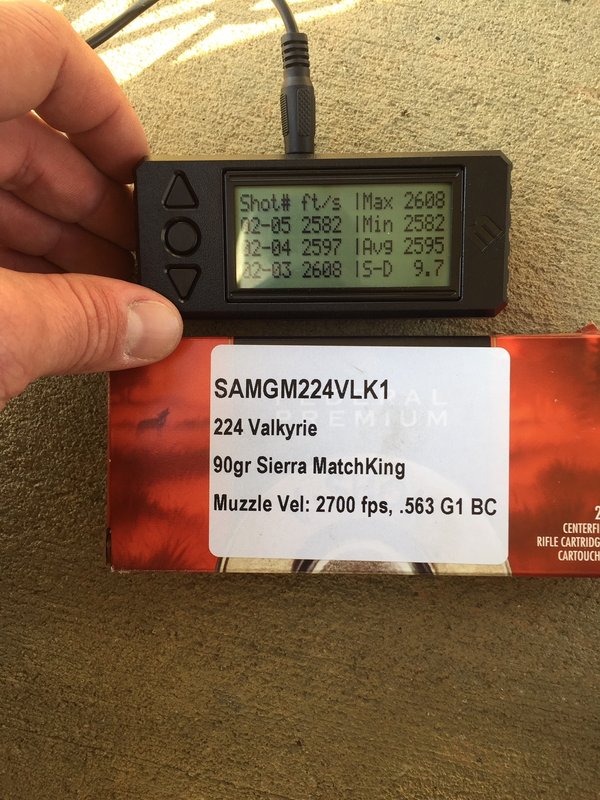

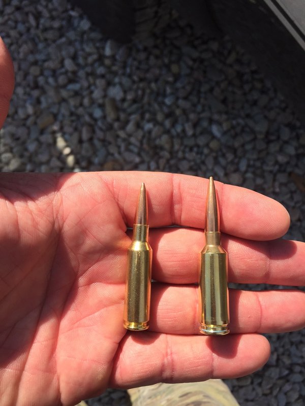

Buddy shot one today. 18" barrel with federal factory 90gr SMK 2580~2600 It's on the left, the right is a dasher.
That seems a little more down to earth. That's only 25fps faster than my Grendel. Using local environmental data it stays supersonic an extra 15 yards over my 123gr Hornady SST. So where is the advertised 2700fps? Which lead my to using my Google-Fu to finally figure out where that 2700fps figure came from?
I finally found this article stating the test barrel was a 24" 1/7" twist barrel. 6th paragraph down.
https://www.ammoland.com/2017/10/224-valkyrie-long-range-shooting/#axzz4z0tHp9KF
So if we're talking 24" barrel here it does change the comparison statistics somewhat. I have seen a lot of 24" barrel data posted up from various Grendel forums where they are getting 2650fps and a little north thereof. That's really not that much difference out there. Using local DA of 2343 and a 48.2 degree day, 9mph wind from 9 o'clock, they are only 40 yards apart in supersonic flight. The 123gr SST Grendel at 2650fps goes sub at 1140 yards, the 90gr SMK Valkyrie at 1180.
Pretty interesting.
I think the 2700 is from no shorter than 20/22" idk though, maybe it was a misprint. Still 2600 out of an 18" barrel with factory loads is very applicable to me. Might be able to squeeze a little more with reloading. Not to mention downsizing to say a 77gr SMK or 73gr ELD-M and getting near 2800fps.
