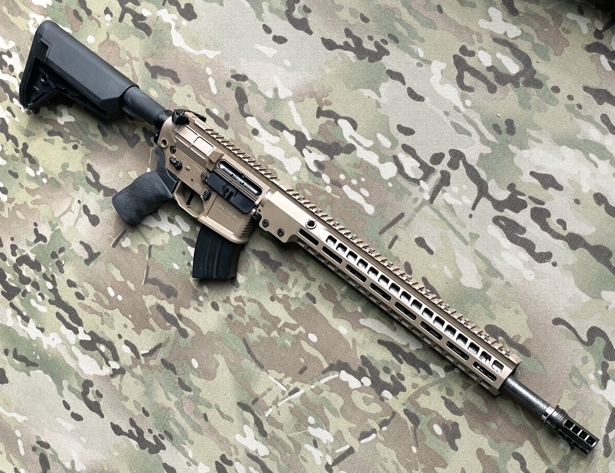

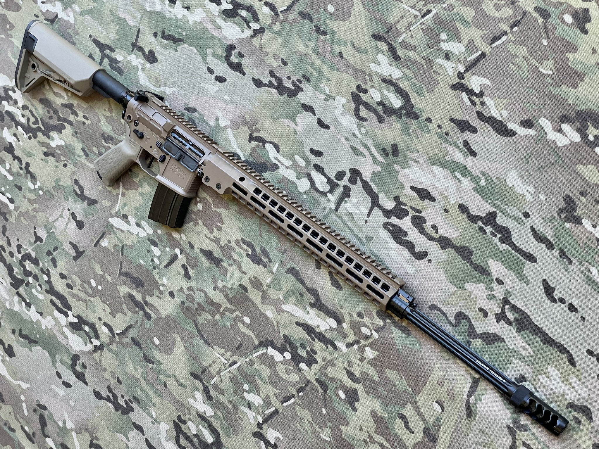

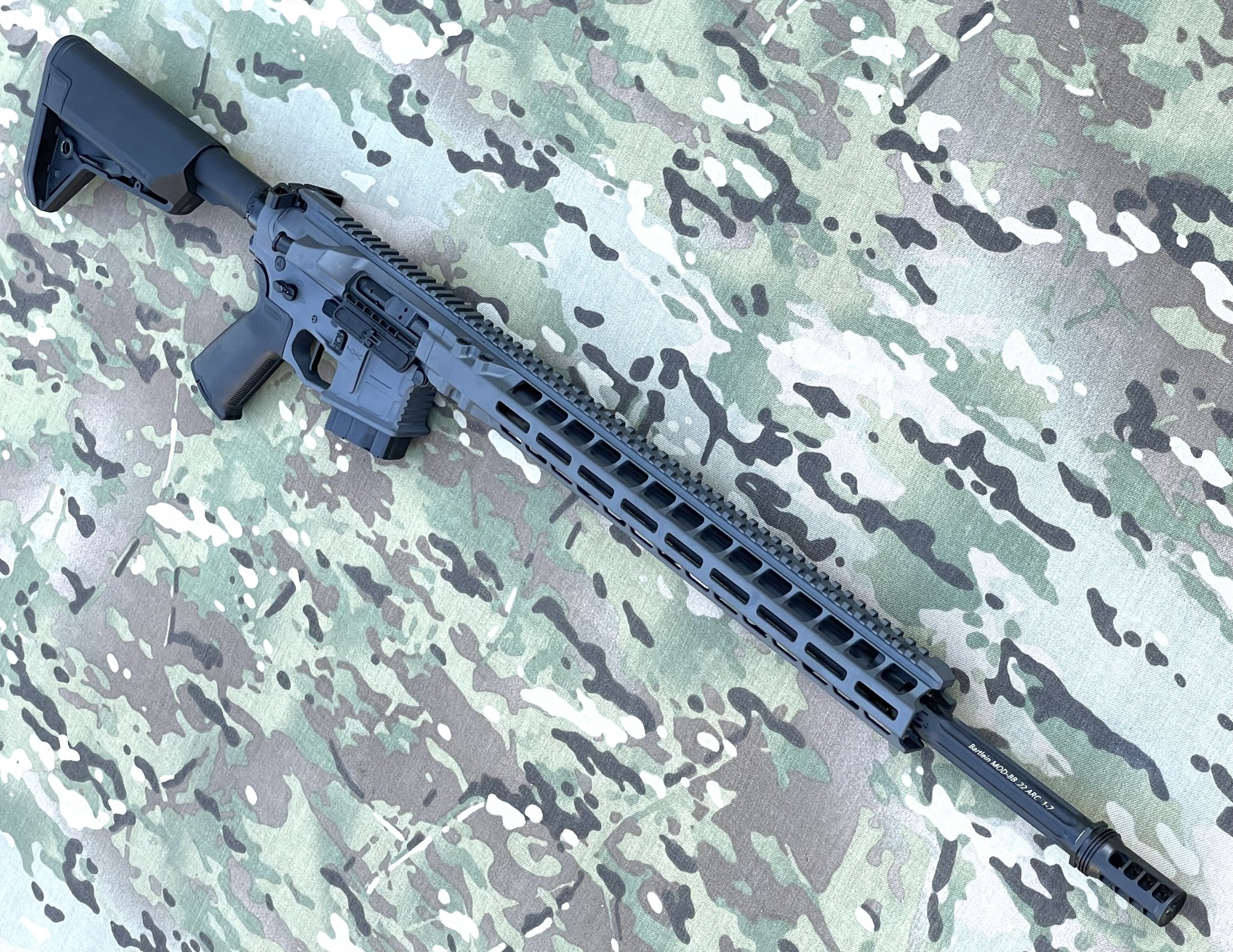

    Here are a few 22 ARC rifles built up with the BCM MK 2 recoil system using the T1 weight recoil buffer. They all seemed happy with this recoil system.
    Here are a few 22 ARC rifles built up with the BCM MK 2 recoil system using the T1 weight recoil buffer. They seem happy with this recoil system.

    If you plan on using flow through suppressors like hux, they will be much easier to tune using the standard springs/buffers, or a standard A5 set up. Definitely use a superlative arms adjustable gas block, or any adjustable block you like to give that option.
    At most you might need a slight increase in buffer weight due to the use of the suppressor, but I do think the A5 systems run better and seem to tune better naturally.
