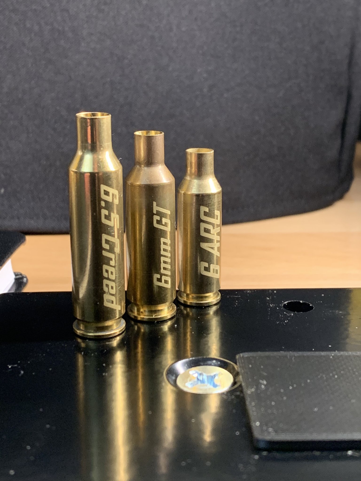

Would love to see them do a short mag seating die. 6.5 SAUM/PRC, 7 SAUM, 300 WSM are all in my stable and one die for all of them would be awesome.
Correct me if I'm wrong...doesn't the SAC "The Seating Die" work for those you have listed? I see it advertised as one stop shop for seating bullets to all ranges of cals with the 2 seating sleeves.
The Bullet Seating Die is designed to be the only bullet seating die you will ever need for a family of cartridge bodies. For example, with out purchasing any additional parts, you can easily and precisely seat bullets in any cartridge body which has a base diameter (.200" above the bolt face) of .470" to .473" in diameter. That is virtually every short action, standard bolt face cartridge!!!
Reactions: PFG
I have their seating die that I set up for 6BR. I didn't figure I'd ever really use it for other calibers but did the other day with 22 Creed. I just pulled the ball from the die and it was set up just about perfect. Once a WSM/SAUM seater comes out I'm in for that as well.
I checked on getting the Dasher sizer but it's late summer/early fall.
