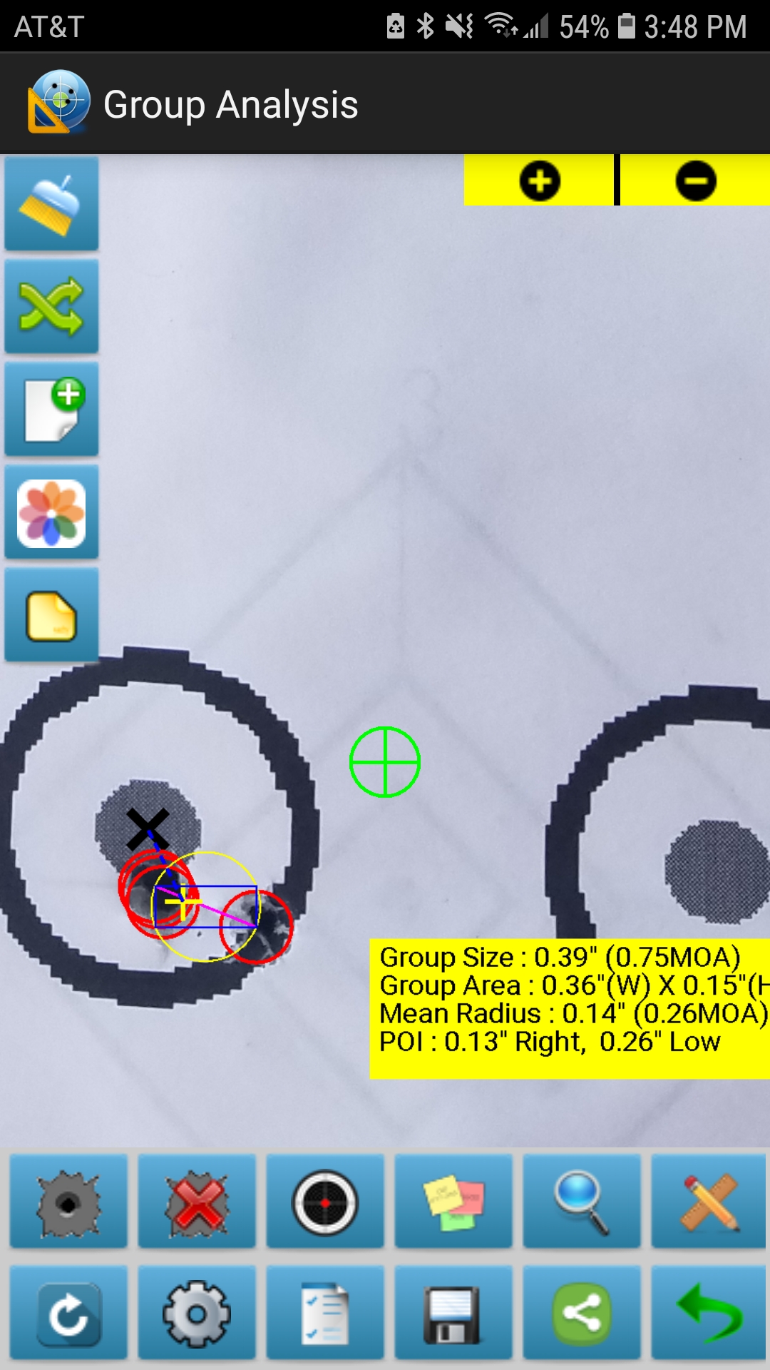

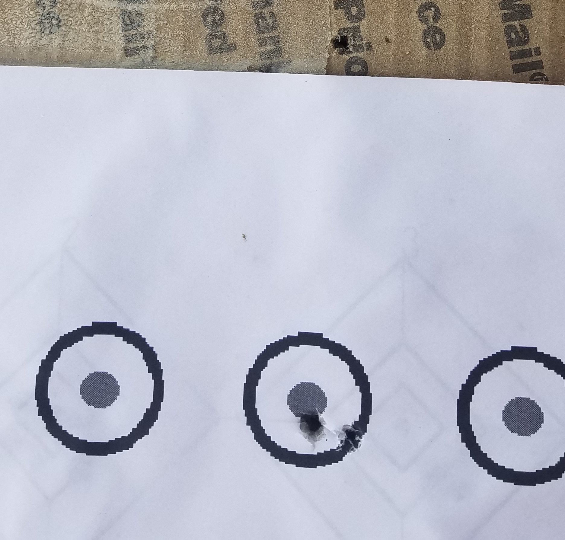

Well I just got my gun zeroed and my final load worked up for this evenings pig hunt.The 9 twist didnt do to bad here ,but it's a over bore barrel Black Hole .224 3 groove. I did get a couple .500 groups with SKLR while getting the scope on. I used pulled RSW50 brass for the my reloads the bullets are heel turned 40gr ballistic tips. My last group was 4 shots that left me with 2 rounds for tonight and I have to load them single shot! I'm carrying a pistol with me! 3 rounds went .060 then I slipped one right to open it to .390 I believe it will get me a pig at 50 yds.
  • Love
Reactions: pingunit and jafo96

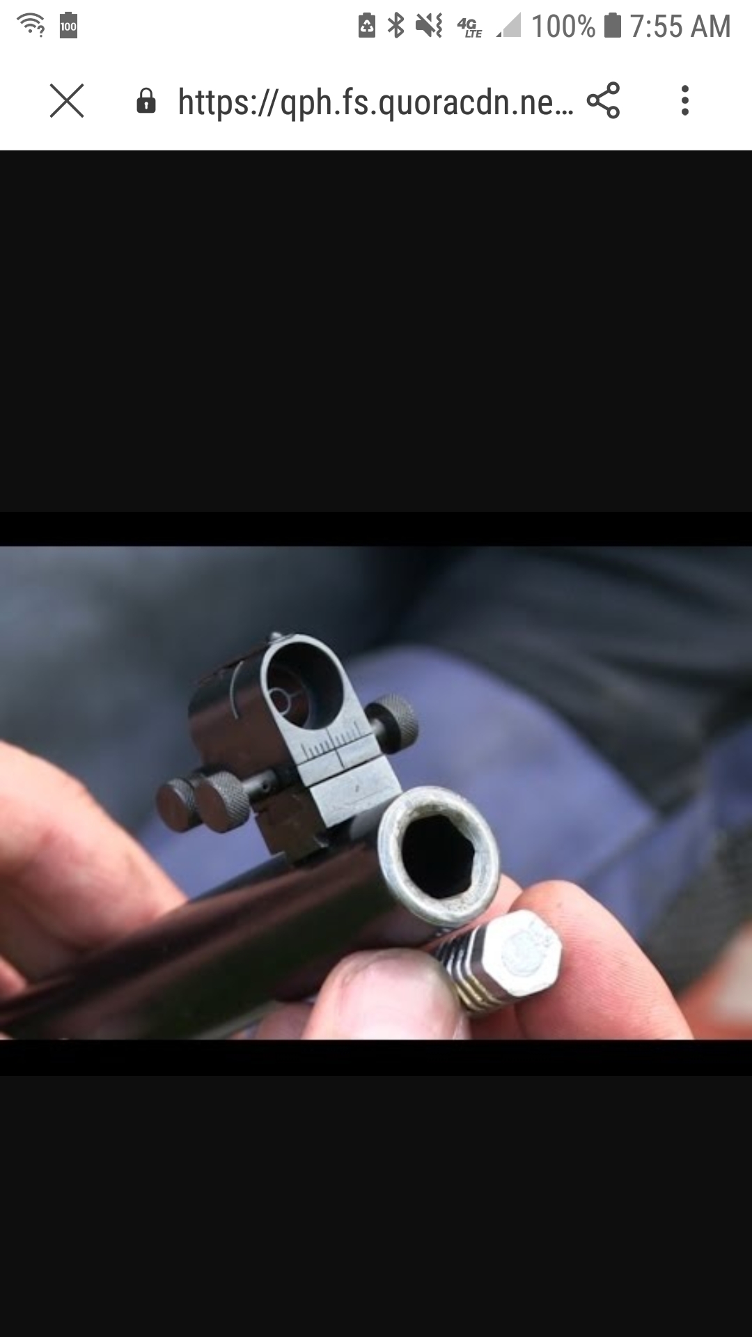

Let me translate all of this had it not been for a man by the name Whitworth ,stepping out of the norm his gun he designed would not still be rated in the top 20 longest kill shots what did he do let's look back 155 or so years. Whitworth's bullets were more stable at longer ranges than the shorter and larger diameter bullets found in other rifles of the time. Whitworth also engineered the barrel with a 1-in-20-inch (510 mm) twist, quite a bit tighter than the 1-in-78-inch (2,000 mm) of the 1853 Enfield, or the later 1856/1858 variants with five-groove barrels and a 1-in-48-inch (1,200 mm) twist. The extra spin the tighter twist imparted to the projectile further stabilized the bullet in flight. ' OH I see he more then doubled the twist rate Wow and this gun grouped 9 feet at 1400 yds from a fixed rest wonder what those 48 and 78 bangers were doing 30 foot ?
Reactions: jafo96 and ZG47A
Thanks for that interesting bit of history,
My knowledge of Whitworth was for a standardisation of threads, I had no idea of anything firearm related.
Look at that beast ! Full face rifling I bet it sounded like a helicopter coming at you. Talk about rotational drag !
