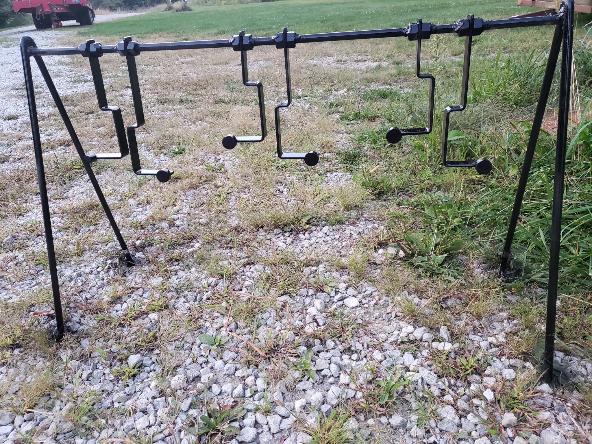

I made a new target rack this year for my matches for the 37 yard line. That's a weird distance that nearly everyone hits high on, if they don't pay attention and study the trajectory they will miss them. They are intentionally small and the hanger comes in from the side so they can't hit the hanger bar.

Any way to get a pic of that rack, sounds interesting....
37 yards is a weird distance for 22 rimfires with a 50 yard zero. Some of my racks have a smaller gamble target they can shoot for more points but is usually smaller instead of the regular target and are usually added at the end of a rack to let you get zeroed in as you progress across.
This rack will have the gamble target first and they can't be off with their elevation hoping to hit the hanger bar.
Should be interesting till they get it right. Gamble is 1/2" others are 1" which sounds easy enough but might surprise you at that particular distance.

I really like those targets, that’s a neat idea. The 1/4” from the NRL gives you a lot of leeway on elevation, but only 1/4” of windage.
