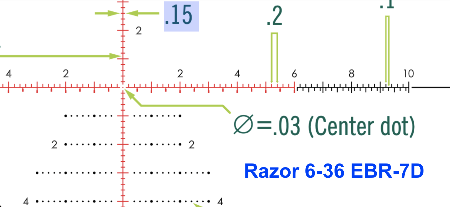

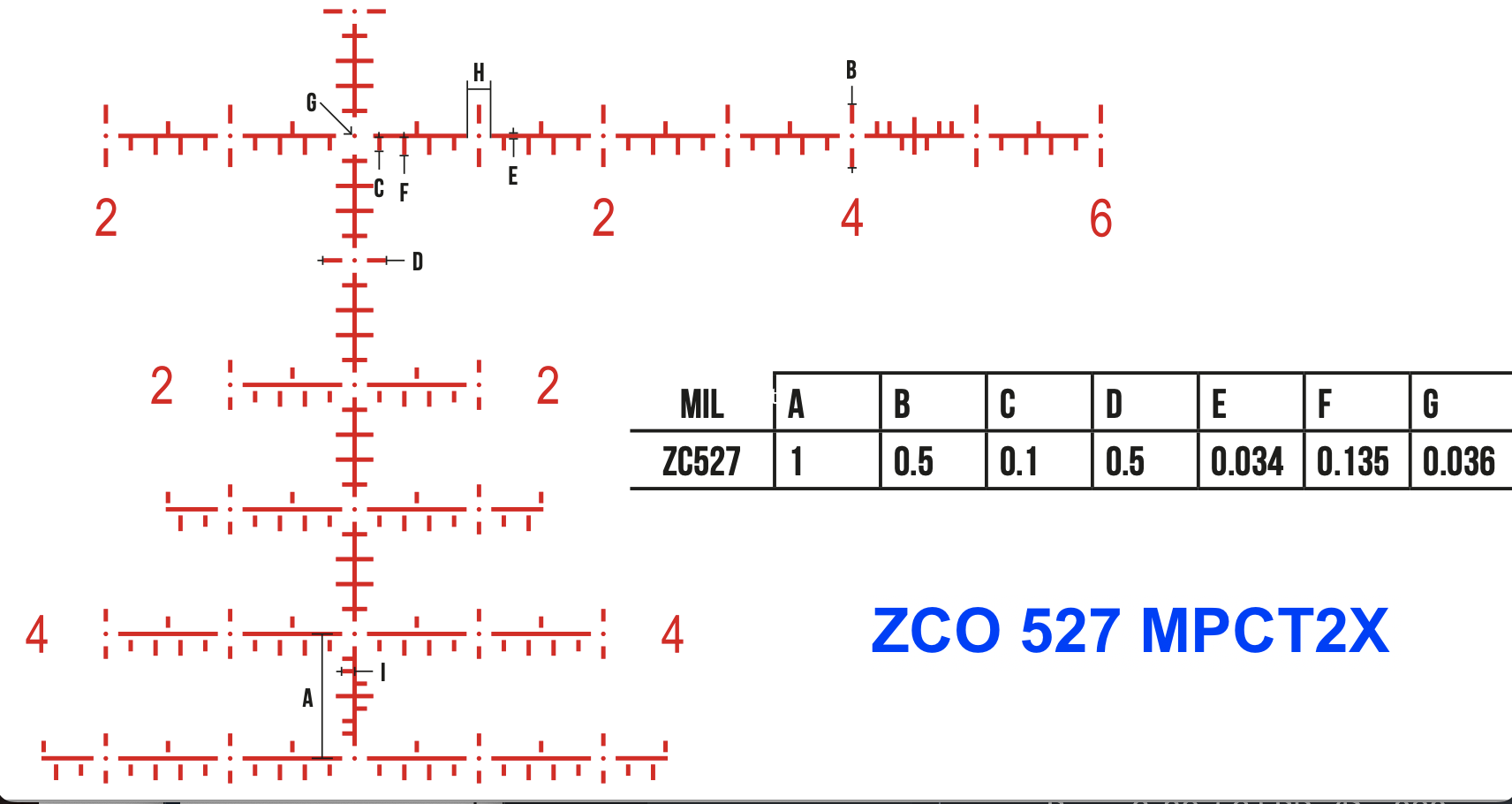

I think the screen shots of ZCO 527 MPCT2X and Vortex Razor 6-36x56 EBR-7D reticle manuals verify/validate my statement about reticle thickness appearances - I just explained myself quite poorly in earlier posts.
At any given magnification, the ZCO 527 MPCT2X reticle is indeed thicker/larger than the Razor 6-36 EBR-7D.
In the screen shots below, note the "size" in MRAD of the center dots:
  • Razor 6-36x56 EBR-7D: .030
  • ZCO 527 MPCT2X: .036
  • Razor 3-18x50 EBR-7C: .040 (not shown)
So the ZCO center dot is 20% larger then the 6-36x Razor's (and corresponding reticle elements) at any magnification setting, and validates my statement. The Razor 3-18 EBR-7C (not shown) is even thicker.
