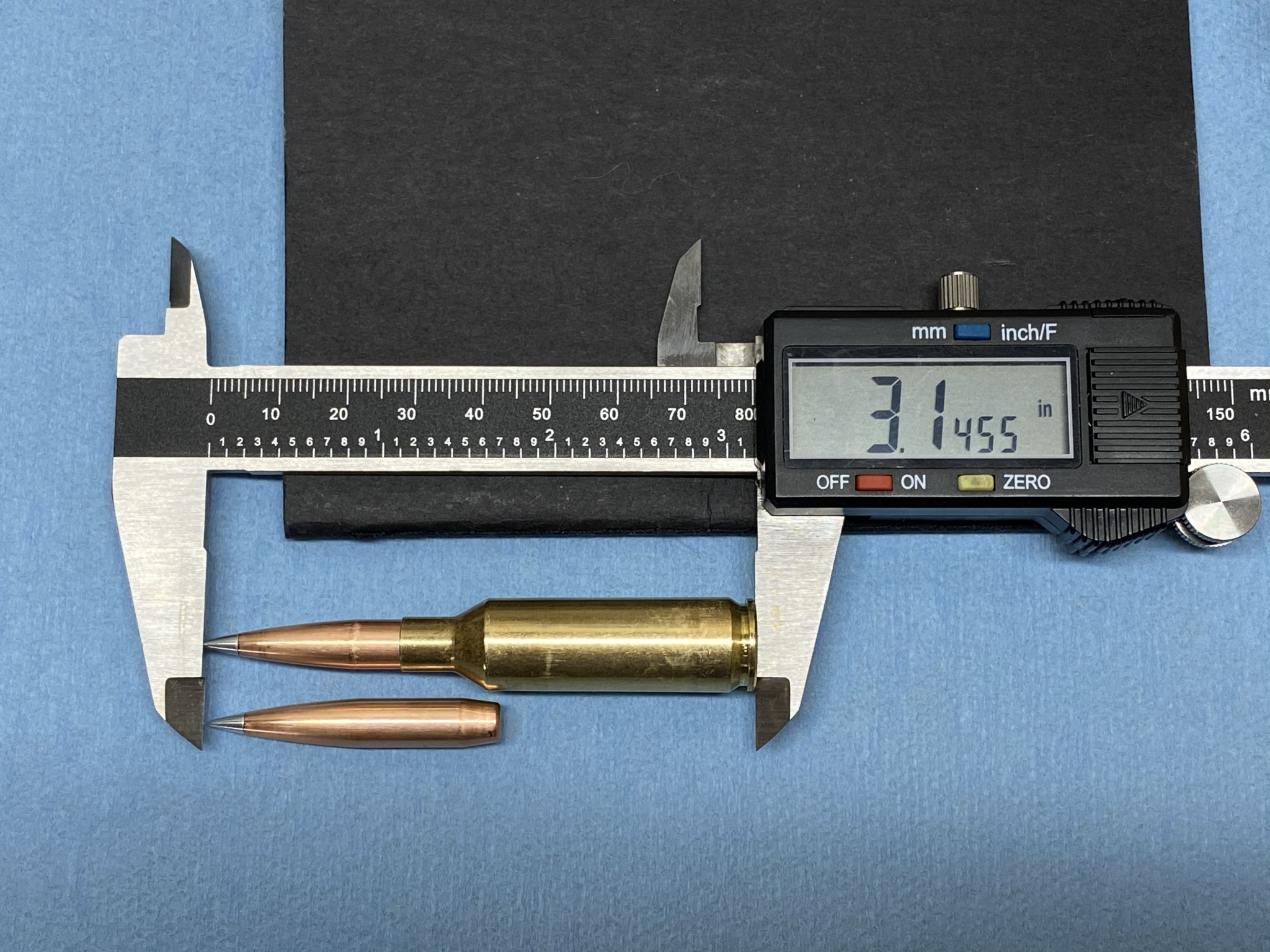

It is a long action but I think the freebore is the problem. You can't seat the bullets past the lands! This is about where the 190 A tips touch the lands and you can see that it's seated way past the neck/shoulder junction. I've ordered a throating reamer.
Well I’ve shot about 2000 7mm bullets seated deeper than that and never had any issues with accuracy or vertical.
