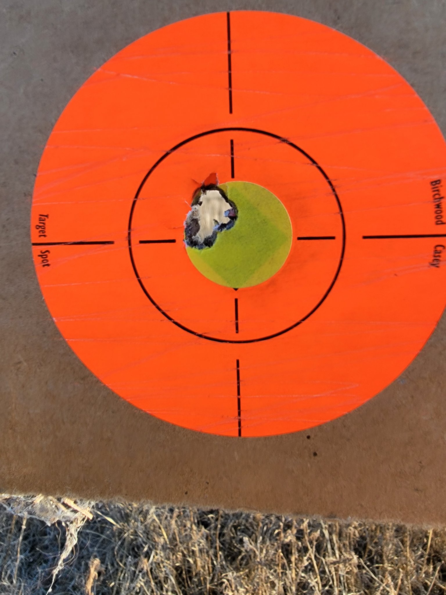

Is anyone having luck with these? I have been having a hard time getting a load to shoot consistently.
Using Peterson LRP brass (that had been fireformed with 115 vld hunting bullets and shot great), I started off with charge weights of H4350 starting at 40.5 to 41.5 and shot over a magnetospeed. My best sd numbers were starting to show up toward the upper end but had pressure signs (sticky bolt lift) so I backed off and settled for 41.1 grains giving about 2900 fps, and an average SD around 10.
Next up was seating depth I tried everything from .005 jam to .080 jump in .003 increments. (Yes I pissed away a lot of time and money so far).
Any help would be appreciated!

What is your load? I think I'm all set now. I went to the range and verified at 550yds yesterday. My load:
Peterson srp .25 creed stamped brass
Cci 450
40.8 gns Rl16
135 hybrid seated 2.167 CBTO (.014 jump)
I have yet to chrono these yet. My guess is they are running 2850 based on load workup.

My 25 dasher was what needed 90 off to shoot , good news is the AB Doppler confirmed .334 G7 and .7 bc variation so a great bullet if you can get it to shoot.

I'm running a Bartlein 5R 7.25 twist barrel. New Peterson 25CM brass, BR4 primer, H4350. Jumping .020 - but .050 essentially grouped the same, so I stayed at .020 and will enjoy the jump tolerance as the throat wears. I'm running them pretty mild, because I started to get pretty frank ejector marks on the brass as I pushed toward 2900 fps (not swipes, and no heavy bolt lift - I'm guessing that the brass is taking a running start at the ejector because this is new brass, and I might be able to push them harder with no marks after they're once fired).
41.0gr gives me 2826 fps average with a 6 SD, and it's shooting 1/4 MOA or so consistently. I worked this load up with no drama - ran a quick pressure test ladder, an OCW with .4gr intervals covering 40.6-43.0, and then an OCW at 200y at .2 intervals centered around the node at 41.0. Then a quick seat depth test. Probably a total of 65-70 rounds (would have to go consult notes to figure out exactly) - all while breaking in a new barrel.
I've got a bunch of ACEs on backorder, but I'll probably be buying more Bergers to tide me over until Sierra comes through for Blackjack.
