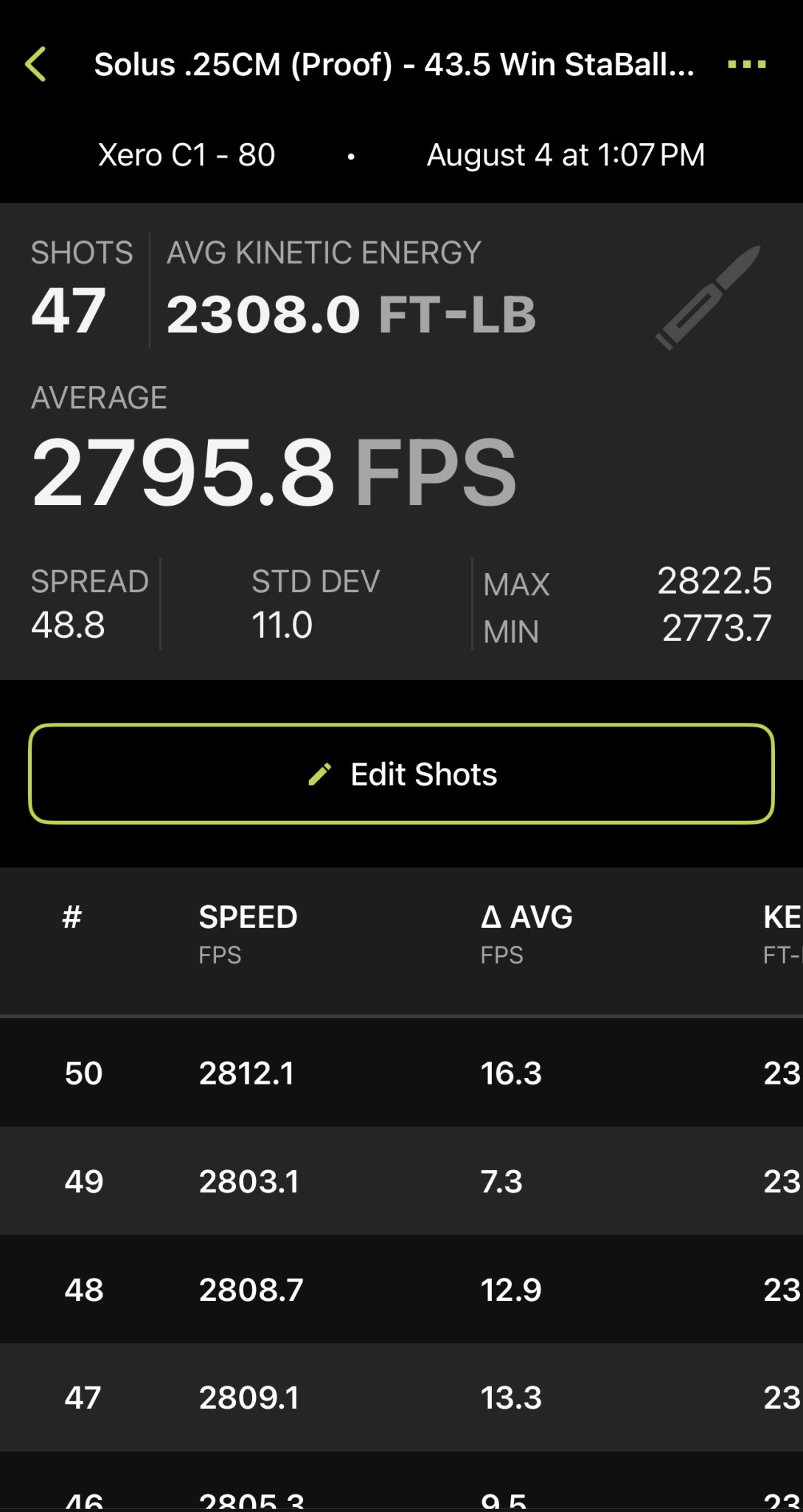

That’s money. I’m running a 23 inch barrel so curious to see what it will do once it has 100-200 round through it.
I removed the first 3 shots from the measurement, as they were cold & clean bore. But the rest of them were all factored in.

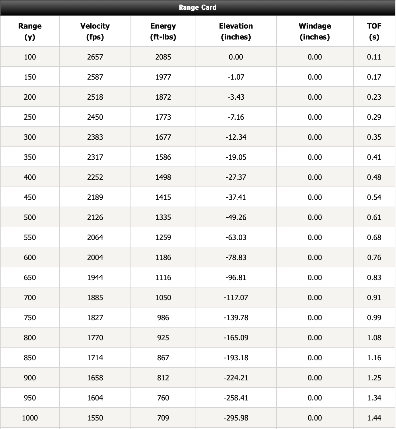

Better than the 6.5 140 elite hunter at 2,950?
Well, no, but that's not comparing apples to apples for my setups. From a 20" barrel my .25CM with 133's is averaging about 2800 FPS MV. And from a 20" barrel my 6.5CM is pushing 140's at about 2780 FPS MV. If you run those numbers with the same conditions (750' elevation), distances, etc... The .25CM beats the 6.5CM by a small margin.
.25CM w/ 133 Elites...

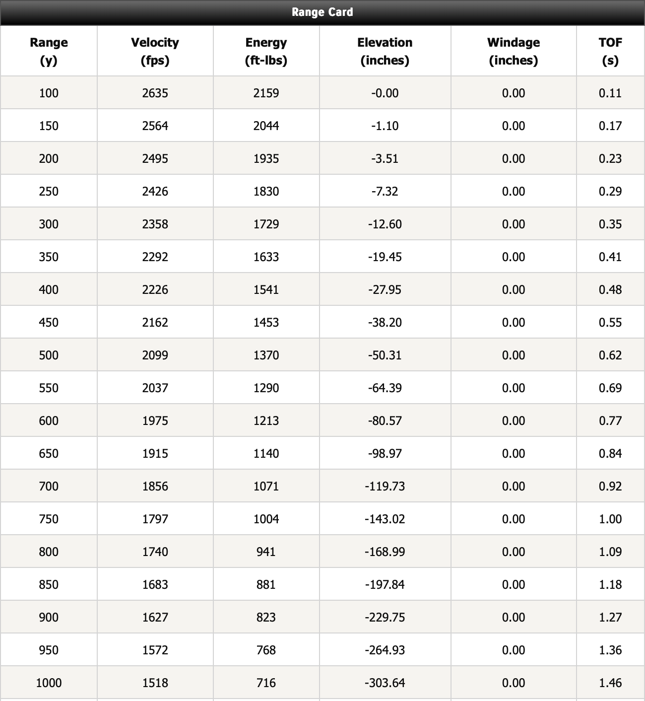

6.5CM w/ 140 Elites...
