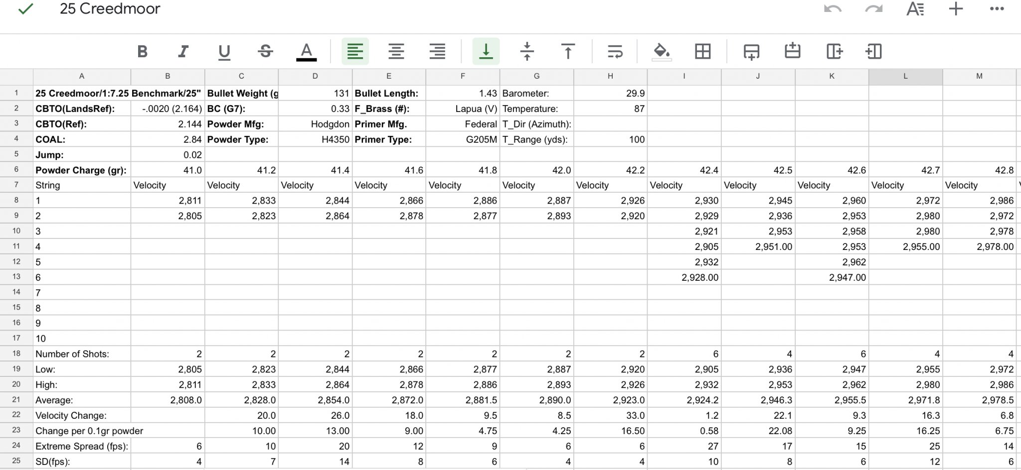

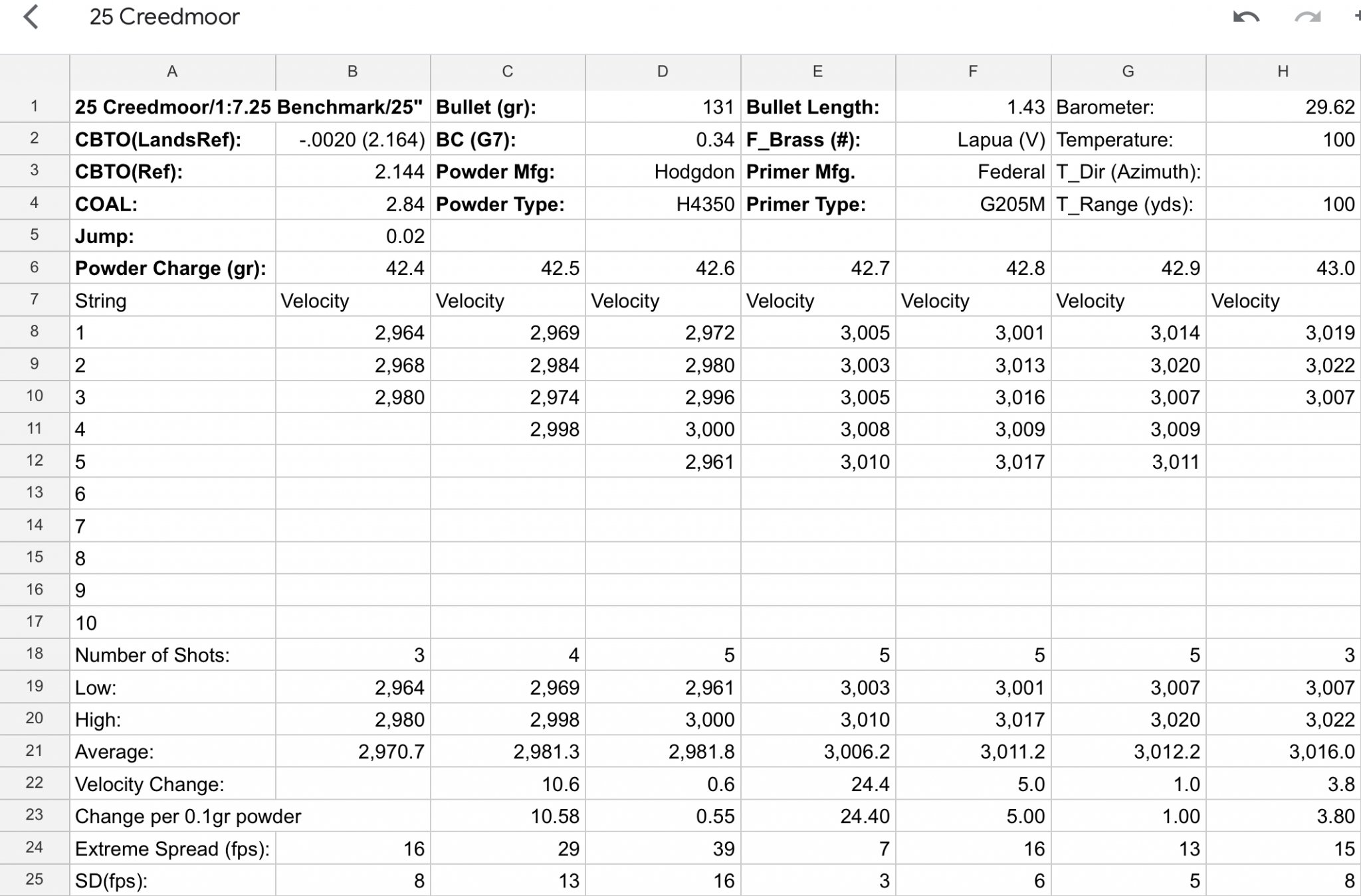

Here’s where I’m currently at with mine. I’m not happy with the 205Ms for the SRP Creedmoor case but I haven’t ran into any CCI #450s in stock when I’ve ordered other hazmat stuff. Shots 33-50 are in strings 1-2 on even numbers from 41-42.6, then I ran 51-70 from 42.4-42.8 at .1 increments 4 shots each. Shots 1-32 are not included because it sped up 50-60fps for same load/needed .6ish less grains to make the same velocity.
New 6mm Lapua Brass expanded to 25, no other work. A tad too long for my chamber, unfortunately, so I’ll probably bump the shoulder back and do one more test before picking something and running with it. No real comments on accuracy yet as I’ve been shooting off a folding table and messing around with swapping between a 6mm and 6.5mm brake. Probably should just put on the 6.5 and be done with it but that would make too much sense.

Ran essentially the same charges again (rounds #76-100) after cleaning. Did it in the afternoon at 100* vs morning at 75-80*. At around 100fps gain/1gr less for same velocity relative to the initial loads I ran up to 43.9gr.

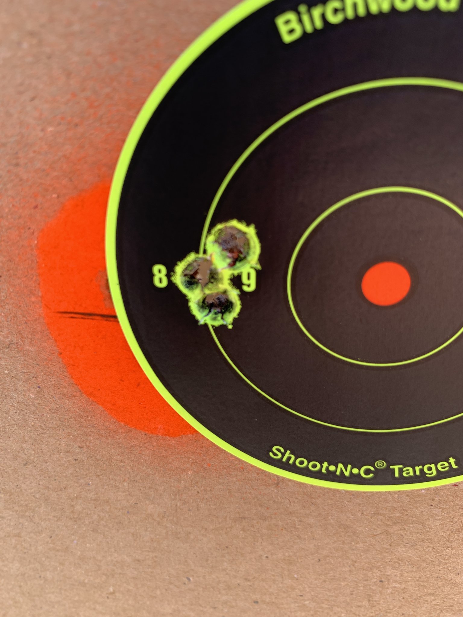

How was the group with 42.7?
Would’ve needed a fancier target stand that actually held the target still with the wind today to give you a proper answer on that. Previously, these all shot around .5-7“. I’ll be back at it later this week to confirm a few groups, BC, and then zero out without the Magnetospeed on there.
Reactions: levi8599
That 42.7 definitely looks promising. I also would love to hear how your group sizes turn out with that load. I'm amazed how much faster this is than the first time you did it.
