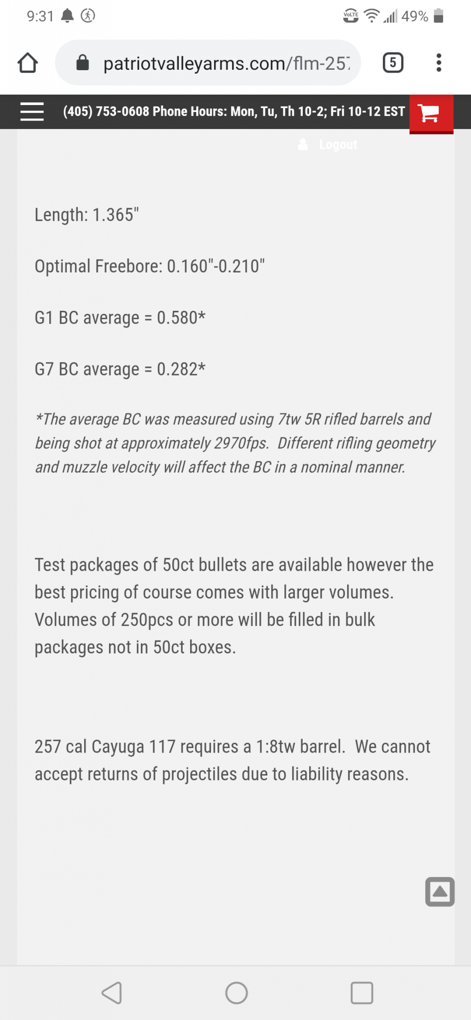

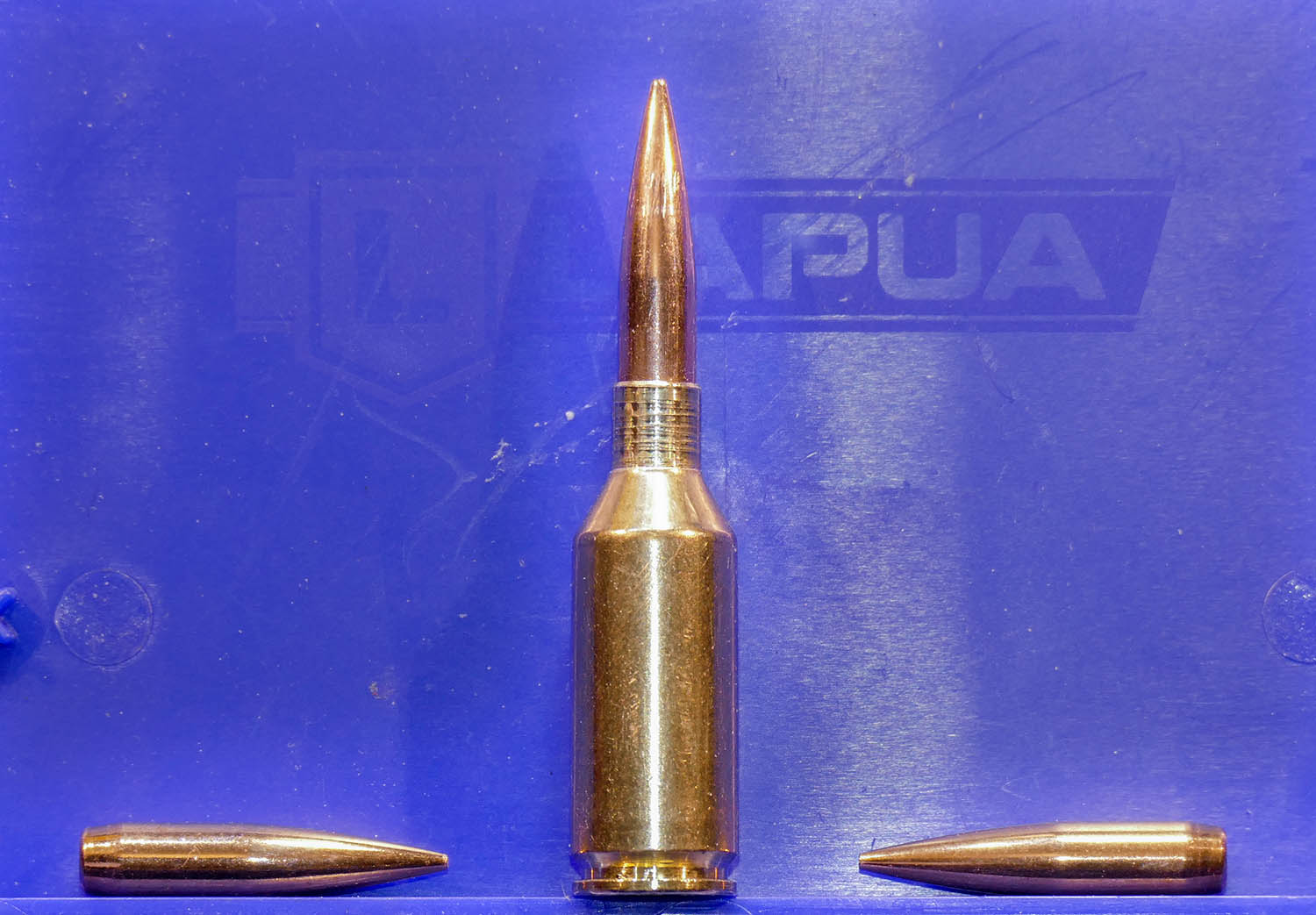

    What is the length, BC, and twist requirement for the Pva 117?
