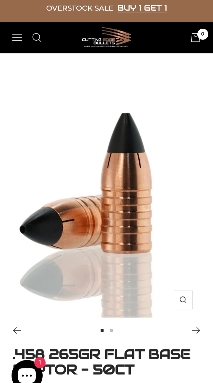

Can anyone help with load or some starting data on this round ?
458 socom ,256 grain Raptor
H110 or LiL Gun powder
Might be helpful to state what your overall length will be. Never tried this combo, but quick load says they are in the low 30 grains range. But the pressure changes quite a bit based on the overall length. 2.1 inch vs 2.0 inch and the max charge changes by 2 grains (lower max charge with shorter overall length).
I got a hold of someone at
Teppo Jutsu and got a good starting load..dropped a few grains to start from max and running them at 2,083 fps. Average so seems to be a screaming good round.
I found the bullets after shot and they do what they say they will
